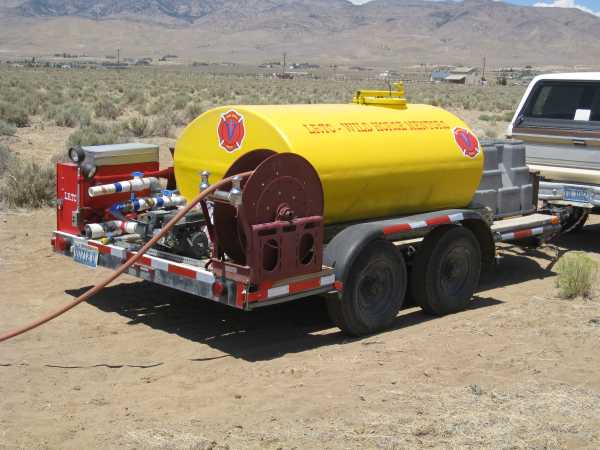

Here's a spec sheet on the portable water supply unit we built.
Portable Water Supply Unit: LRTC Horse Emergency Response Team
It was originally built to provide stock water in remote locations, then adapted for defensive fire service, then adapted for large animal rescue. It now serves all three purposes.
