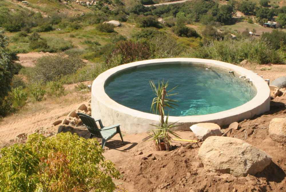

Update, Phase I is done. It took me over a year but I now have a 7000 gallon resevoir. Now I am installing the pump, foam system, hydrants and the mister/sprinkler system.
The tank is 9.5 ft deep and 13 ft diameter. The walls are 12 inch concrete block. The deeper four feet has a 4 inch inner wall. All done with a mixer.
The pump has been upgraded to a Hale 18 hp capable of 100 gpm at 150 psi. The Honda WH20 will be used as a backup or as a transfer pump if I install more water.
Zeuspaul

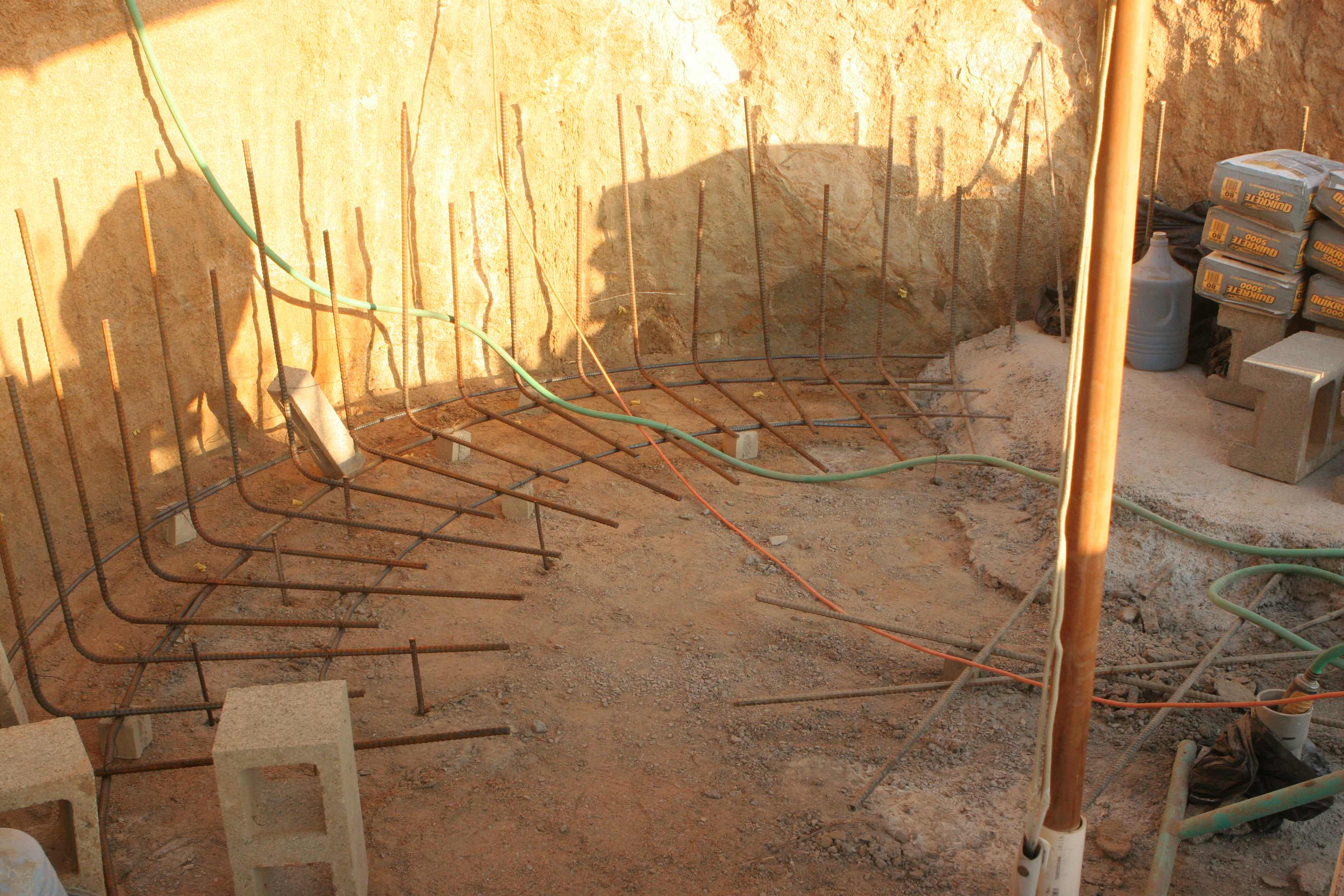

I was able to remove a little dirt with the box blade. Then most of the digging with an electric jack hammer and the front loader to move away the spoils. 5/8 vertical rebar in every hole. A Harbor Freight pipe bender ($70) mounted to the bucket was used to bend the rebar.

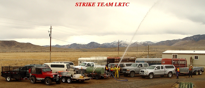

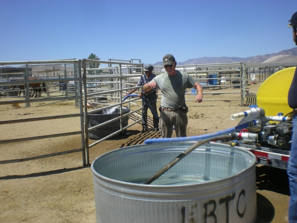

The two inch "blue" utility hose will provide some pretty good protection if used with the correct nozzle. The issue you will have is with the smaller gasoline pumps. All hose suffers friction loss and the smaller pumps have limited capacity, so the amount of hose (distance) you can use is limited to about 75 feet or so to maintain a really solid nozzle throw. We use a 1-1/2 inch 65 GPM combination straight stream - fog nozzle on a 2 inch to 1-1/2inch reducer on our 2 inch "blue" line for our large animal emergency response team. You can move enough water to bore a hole in hard ground with the nozzle while pumping from the tank or at draft. We used it one time to blast mud off a city road. The same setup is very useful around the ranch. Hope this info is helpful. Willis
   / Fire Water Pump Hose... NPT and Industrial Pipe Thread the same? and NST? #39
In the third picture - your desert air must be really dry for that hose stream to vaporize and disappear before it turns downward.
