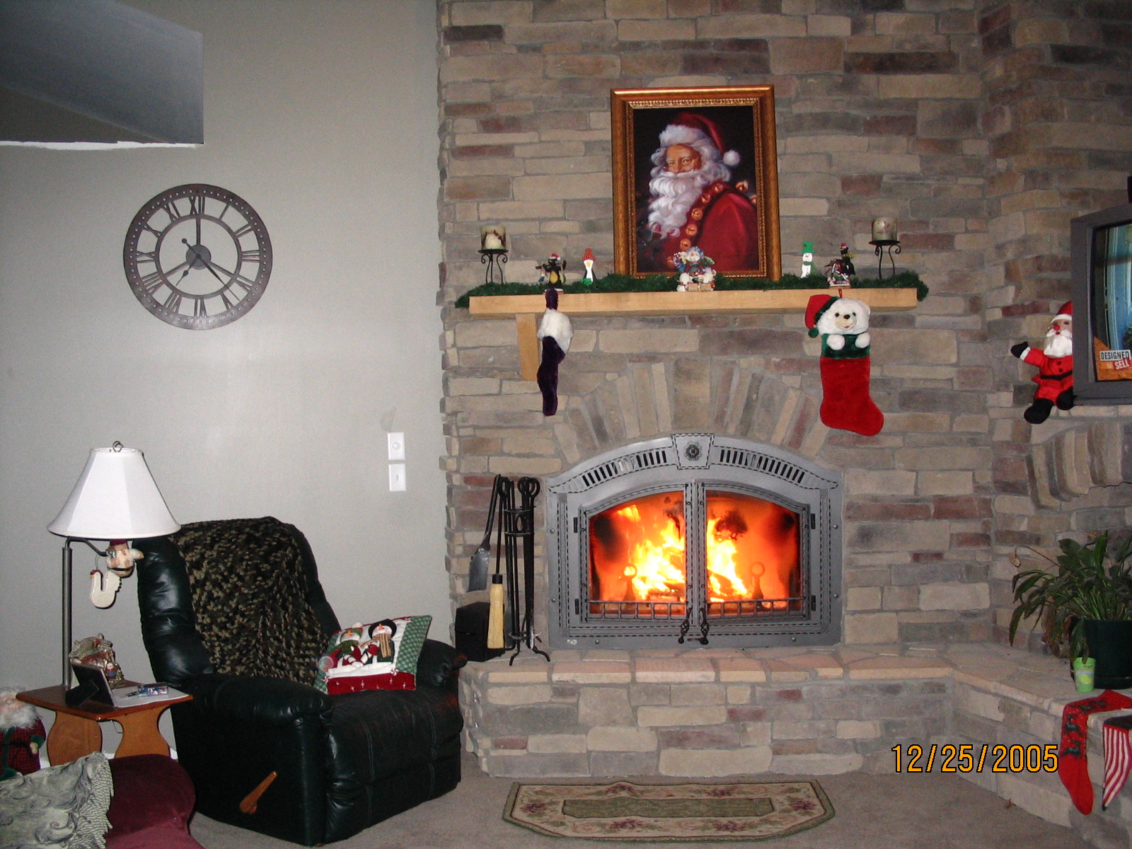

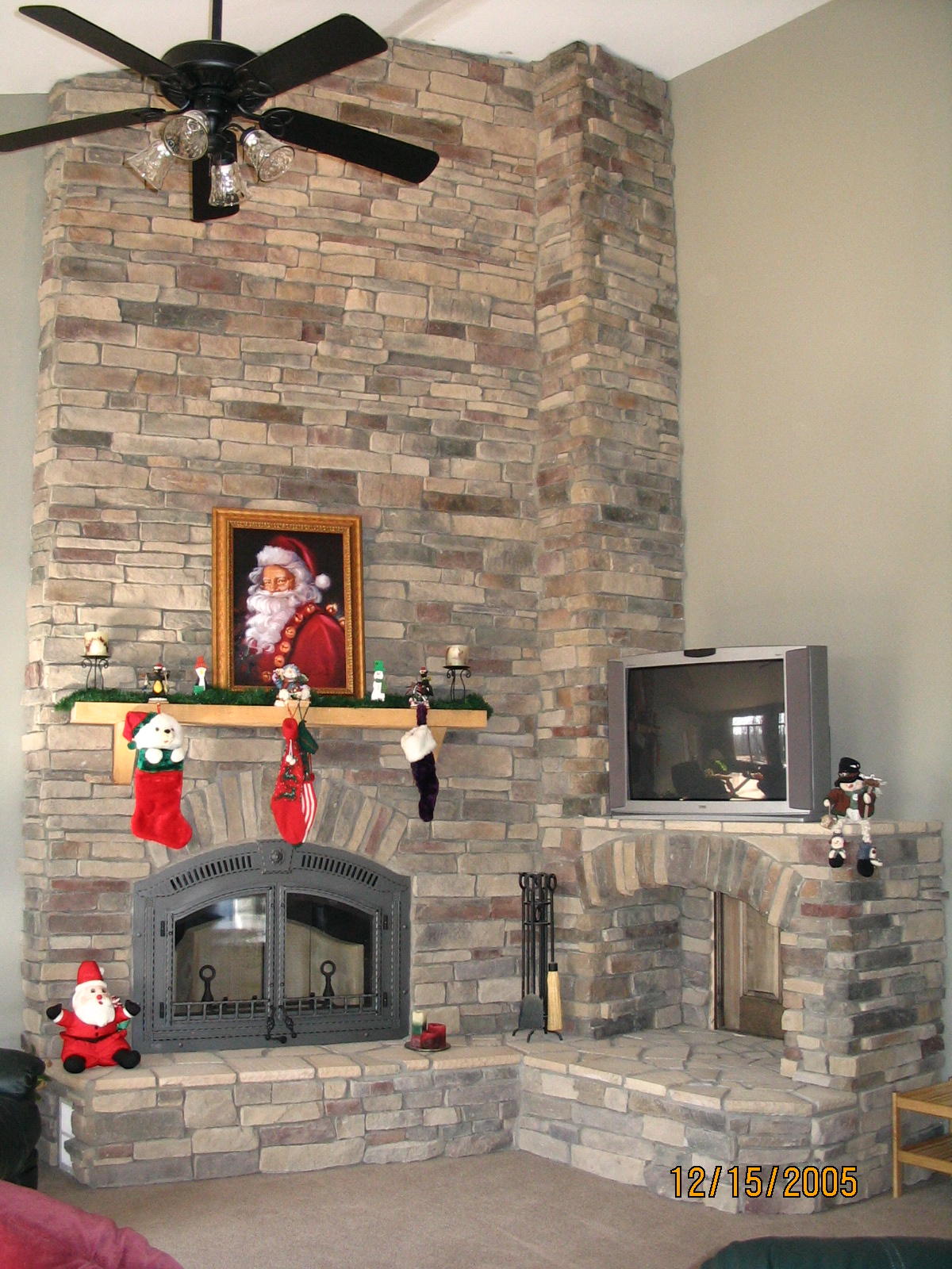

That looks just like the Majestic fireplace we have in our new house that I plan on replacing the first chance I get. It's pretty good as open hearth fireplaces go, but we were spoiled by the small closed system insert in our old house. Our Majestic has the outside air option and glass doors.
The open hearth uses 4 times the wood and puts out about 1/4 the heat the Lopi insert. One of the things I really miss is being able to load up the fireplace before going to bed and still have coals burning and the house warm in the morning. That's a key difference between the controlled burn of a closed system and an open hearth.

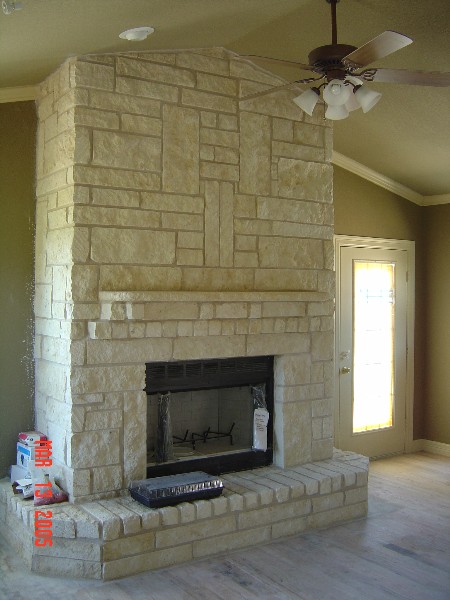

The primary reason for the fireplace is for looks. The mantel and place for the flat screen TV are more important than actual heating. I figured that while I'm planning this, I might as well make it functional, thus my reasoning for the insert. Currently we heat the house with two plug in, ceramic heaters. We save $100 a month on electricity using those instead of the central heating system. So maximum heat isn't an issue for us.
We thought about a freestanding stove, but just don't want one. We want the rock fireplace, lodge look for the room.

You might be right about to much rock. I'm not sure yet if that's the way to go or not. We have a 53 inch big screen and don't want to go any smaller. We'll probably buy a 52 inch LCD flat screen and I'm not sure how that will look with rock around it. I have all the space that I need to cut it into the wall and recess it in there without too much effort. Sometimes less is more.

I would do a bump out to install the insert in and run the stack. Still can get a nice surround and mantle without eating and floor space. Also you stack will be self contained in the bump isolating from the rest of the house. Triple wall pipe is really nice and makes me feel safe but get ready for sticker shock. I put my wood burner in over 10 years ago and on a single story house is cost me about $750.00 in pipe.

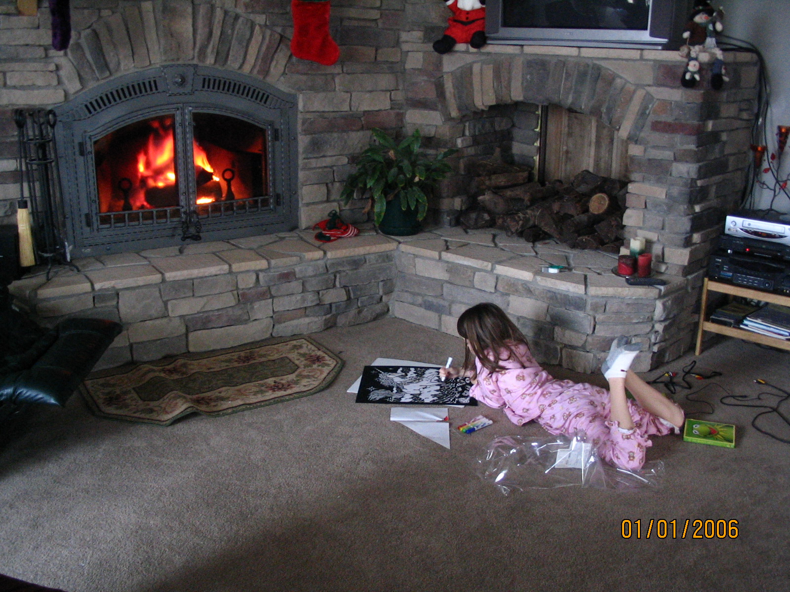

Thanks to everyones recomendations, I have a list of suppliers in Tyler that I want to go visit. I'm currently working on a house in the oposite direction of Tyler, out in the country, so it's gonna be awhile until I do any actual hands on research.
We really appreciate the pictures.

Jeje got it right. You are describing a zero clearance fireplace and not an insert.
An insert must be inserted into an actual masonry chimney with all the block and firebrick. You would need to build a real masonry fireplace/chimney at great cost and then buy an insert for it. The insert is a retrofit.
The zero clearance units can be a fireplace looking thing with metal pipe and flush mounted to a wall or built into an alcove or...
