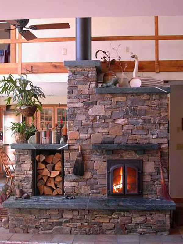

I don't think we'll do the TV in the fireplace thing, but it is kid of funny joking about it. We're both pretty conservative and traditional on thse things, and that might be the biggest hold back to making a fake fireplace then anything else.
My thought was to build a brick firebox, but only the bottom and sides. The top would be framed in wood to seal it off outside of the house. Then the brick would be painted black and a iron wood rack would be used to hold a few real logs. Then a iron screen of some kind would sit in front of the opening so that it would look absolutely real.
No flue or any way for anything to get in or out through it, just that brick fire box. In fact, while typeing this, I wonder why I would even need real brick? Maybe those fake vineer bricks that are about half an inch thich and go on like tile. Then paint them black for the same look.
The wall would have rock on it and we'd put in a heavy, oak mantel. Maybe three mantels at different heights. Then the flat screen TV would sit on top of the cener mantel.
I'm agreeing with Rox in her earlier post that bringing rock all the way up the wall to simulate a chimeney might be too much.

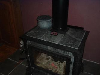

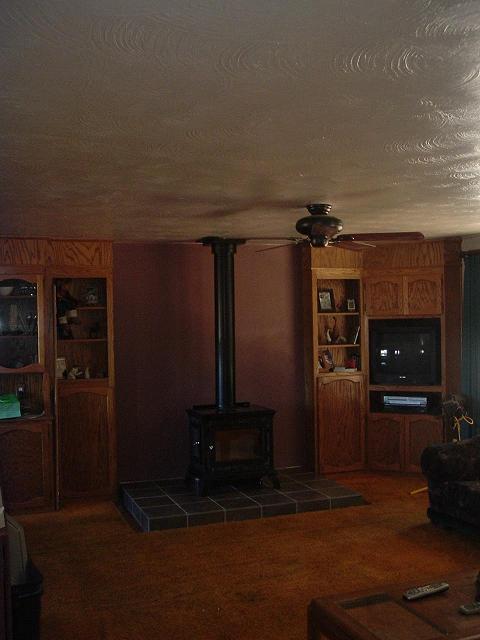

Another option that I've been considering is a freestanding stove designed to be operated either with closed doors as an airtight heater or with a metal screen to provide ambiance. Quadrafire makes two of these that both vent through a standard 6" flue. The heat output will be greatly reduced when burning with open doors.
To summarize: When I had a gas fireplace with a TV beside it I watched TV. I now have a wood burning stove with a TV beside it and I watch the fire. Gas is boring but better than nothing if it is ambiance you're after.

Eddie, highbeam makes some good points. I have had a regular wood burning fireplace, a gas logs fireplace and now the wood burning stove. Look how long it took Steph to go from the total fake FP to the one with an actual flame, and heat, next it will be the sound, then the aroma, then the full cycle of roaring fire to soft glowing coals...... The older you get the more options you want. But you are still young, my first car had few options.....;)
