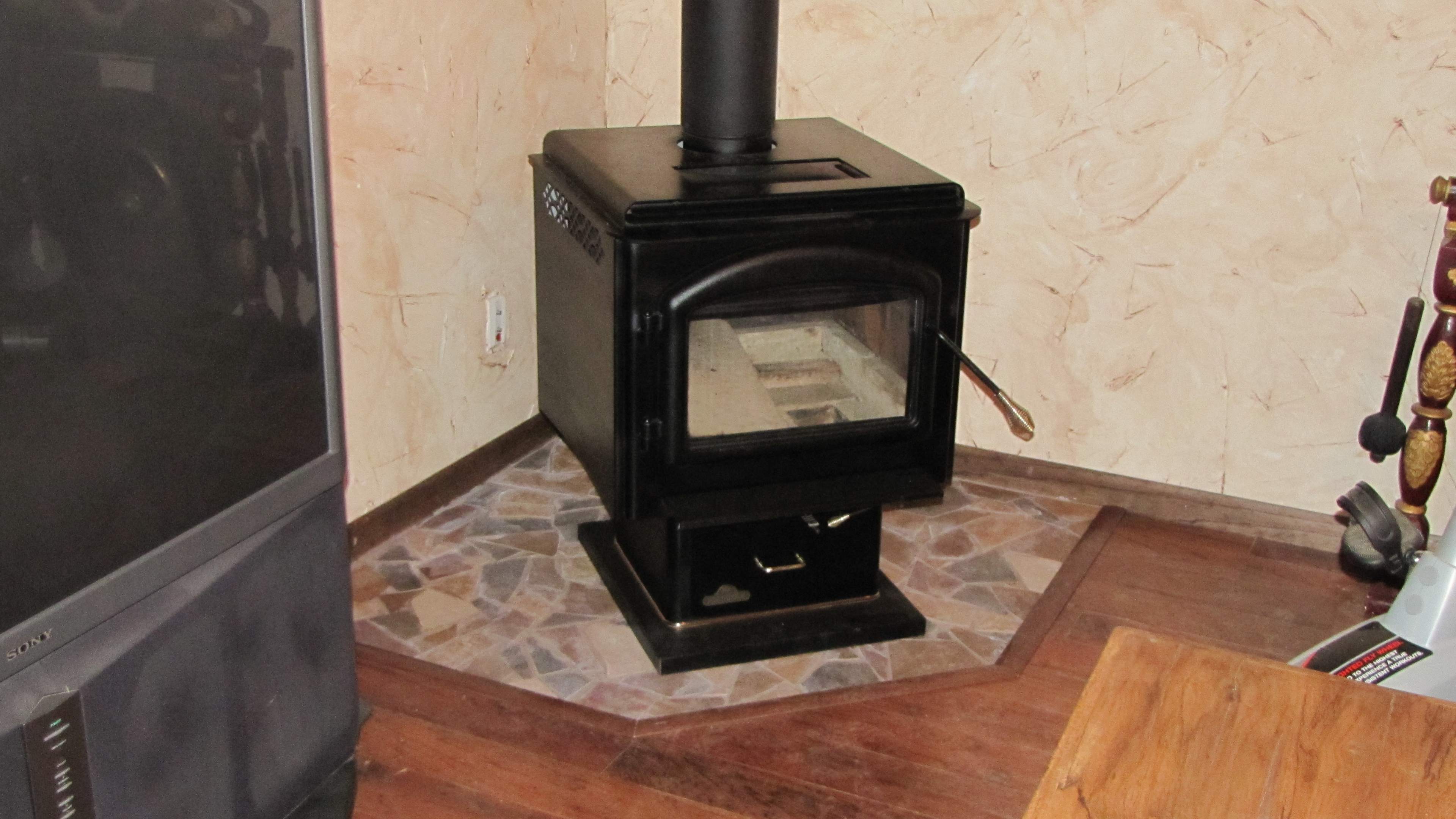

I trimed out the tile and set the stove where I wanted it. Then figured I'd run to the store and buy the rest of the pipe I needed and the parts to run it through the roof. While there are plenty of places who will order them for me, I couldn't find any that have what I need in stock. Lowes has the best prices, but said it will take three weeks to get here.
I'm searching online and found several suppliers, including Amazon, but with shipping and buying the individual pieces, it's twice as much money. The kit from Lowes is looking better and better. I'm impatient, but don't really have to have it done right away. I don't even have any wood ready to burn, so 3 weeks isn't such a big deal if I decide to go that route.

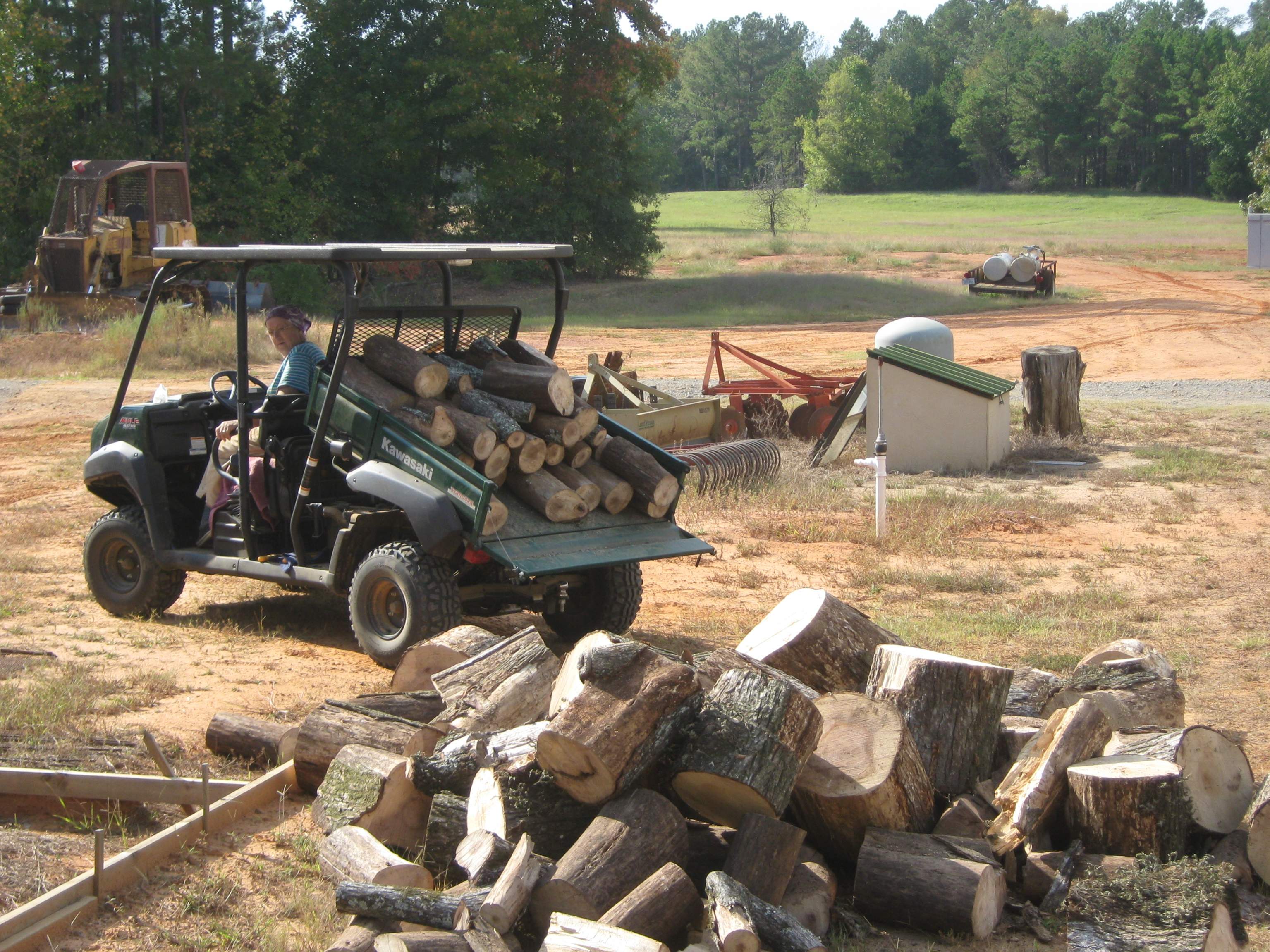

I'm really fighting you guys who tell me to store the wood away from the house. I'm seriously planning to rebuild the wall of my house with two layers of house wrap that I will apply over a wet layer of concrete block sealant to make sure no bugs can get through it. I will pour concrete for the wood to rest on with a slope to carry any moisture that might end up on it away from the house and I will put a small, metal, lean-to roof over the wood to help keep it dry and match the metal roof that's already on my house.
Part of my stuborness is that I don't have a place to build a wood storage shed that I like better. The other part is that I think I can make it bug proof. The combination is driving me to do what I understand to be a bad idea, but will do it anyway.
I'm still in the planning stage, but have a materials list and all the details pretty much figured out. It's realy just a matter of committing to it, and getting started.

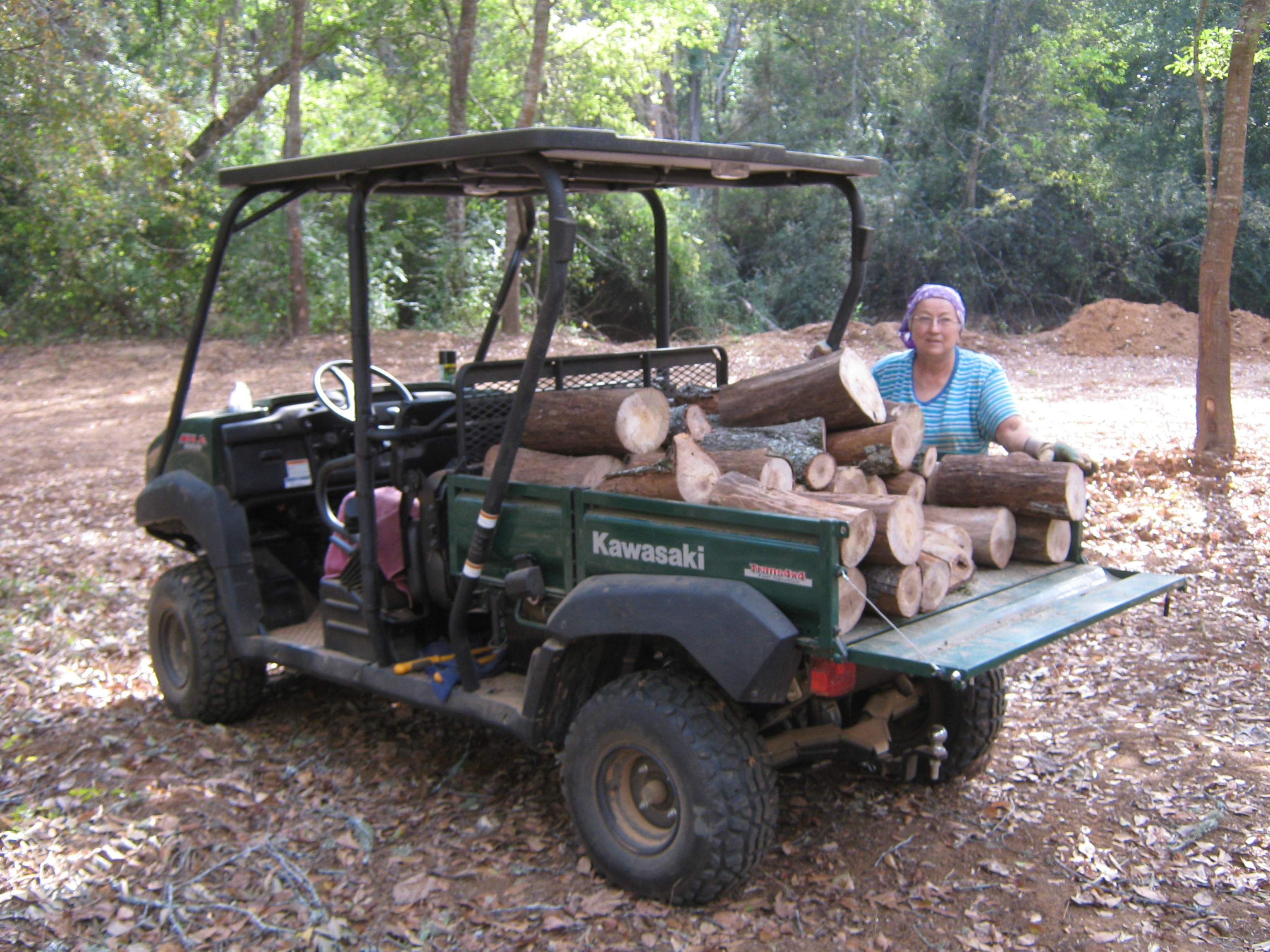

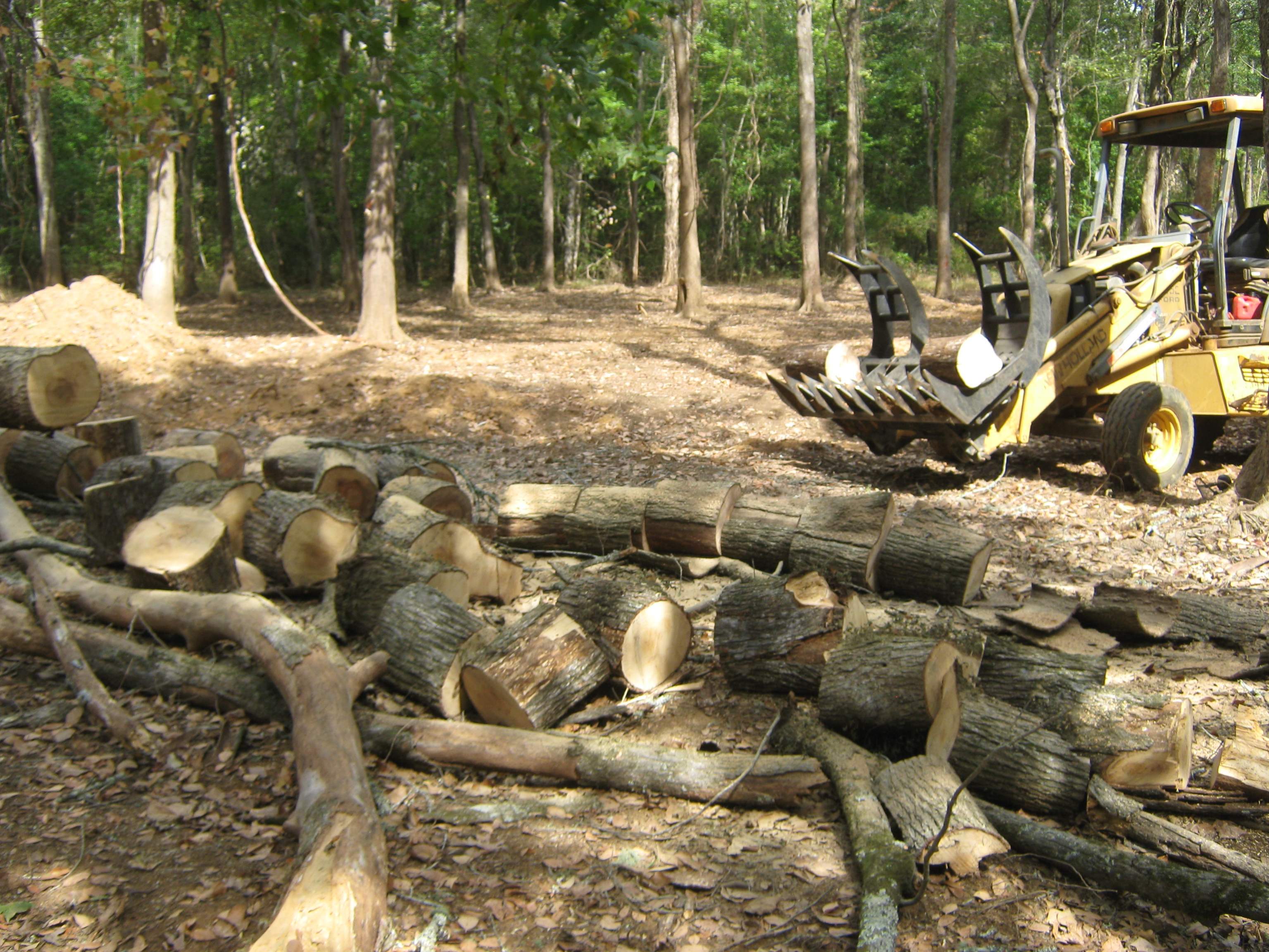

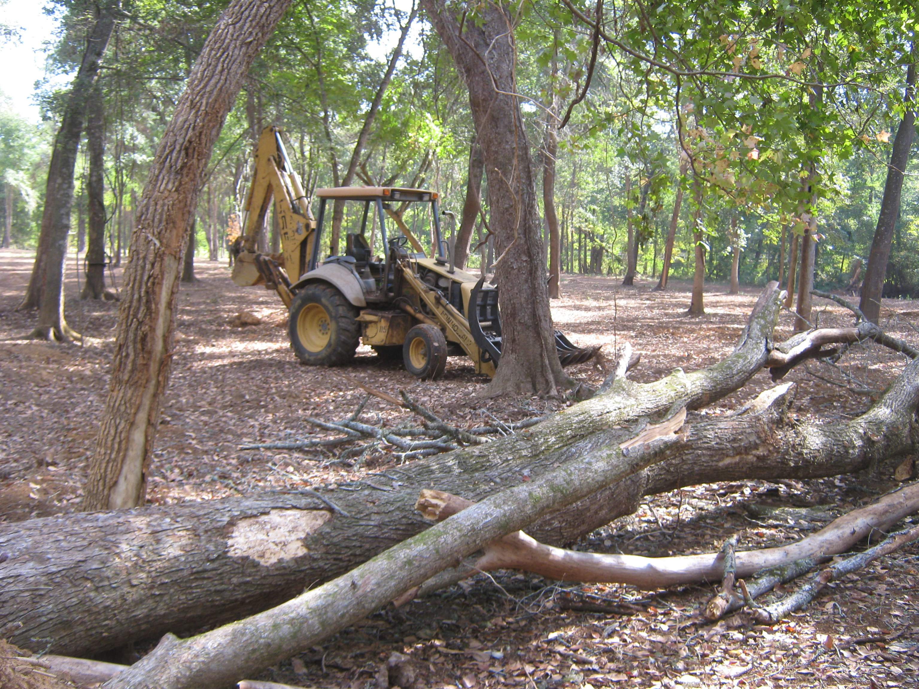

In the meantime, while waiting on my pipes to get here, and knowing that I will need wood on hand if I plan on actually having a fire, I started the process of getting that wood over the weekend. In an area that I've been clearing out the underbrush, but leaving my trees alone to create a park like setting, I found a standing oak tree that's in the 40 year old range. I had my dad take it down with the backhoe last week, and yesterday, I cut it up into 16 inch rounds, give or take an inch. My stove can handle larger, but at 16 inches, they are heavy enough, and a few were too heavy for me to lift, so I rolled them onto the grapple on the backhoe.
While enjoying the fall weather, the leaves fallling from the trees and the smell of fresh cut oak, my Mom showed up in the Mule. She had been out driving the trails and wanted to lend me a hand. We loaded up the bed of the mule that she brought to the pile by my house. It was a nice surprise to have her help out like that.
This tree has been dead for a few years now. It seems to be dry and ready to burn, but as a rookie, I could be wrong about this. The bark is falling off the tree, and some of the rounds are splitting on their own. Since this is what I have ready to go, I'm gonna just learn as I go and hopefully be better prepaired for next year.
Some time this week, I plan on borrowing my brothers log splitter and starting on that part of getting the wood ready.
My goal is to have two chords of wood split and stacked for winter.

Looks like good firewood to me! :thumbsup:
   / Fireplace advice, Part 2 #69
Yeah, that stuff in the mule is definitely ready to go. You may want to load some pieces in your stove to see what sizes fit nicely. That way, you may not have to split some of the branch pieces and you will know what size you need to get it down to for your stove. Too big and it won't go in the door of the stove. Too small and it burns up to quick. After 2 years of using mine I finally got a pretty good idea of what works and what doesn't. :laughing:
As for storing it near your house... just be sure you can spray under and behind it with insect spray. Storing it up on a skid or pallet may be a good idea, too. Not only will it provide more air circulation, but you can spray under it.
I store my pile out behind the garage. I also have an outside stair access to my basement room where the stove is. It has the two metal doors that open up and out. The stairs are 4' wide and 8 steps down. I load one side of the steps with a row of wood. That is enough for about 10 days. If it looks like the weather will be bad, I will pack both sides of the steps full and that is enough for well over two weeks.
My point is, even though I discourage people from storing wood right next to their house, I do it myself every time I load that staircase! :confused3: It is not sealed and insects can get in there. However, it is not heated and insects freeze to death if they go in there. In the summer, I keep it empty so no carpenter ants are tempted. :thumbsup:

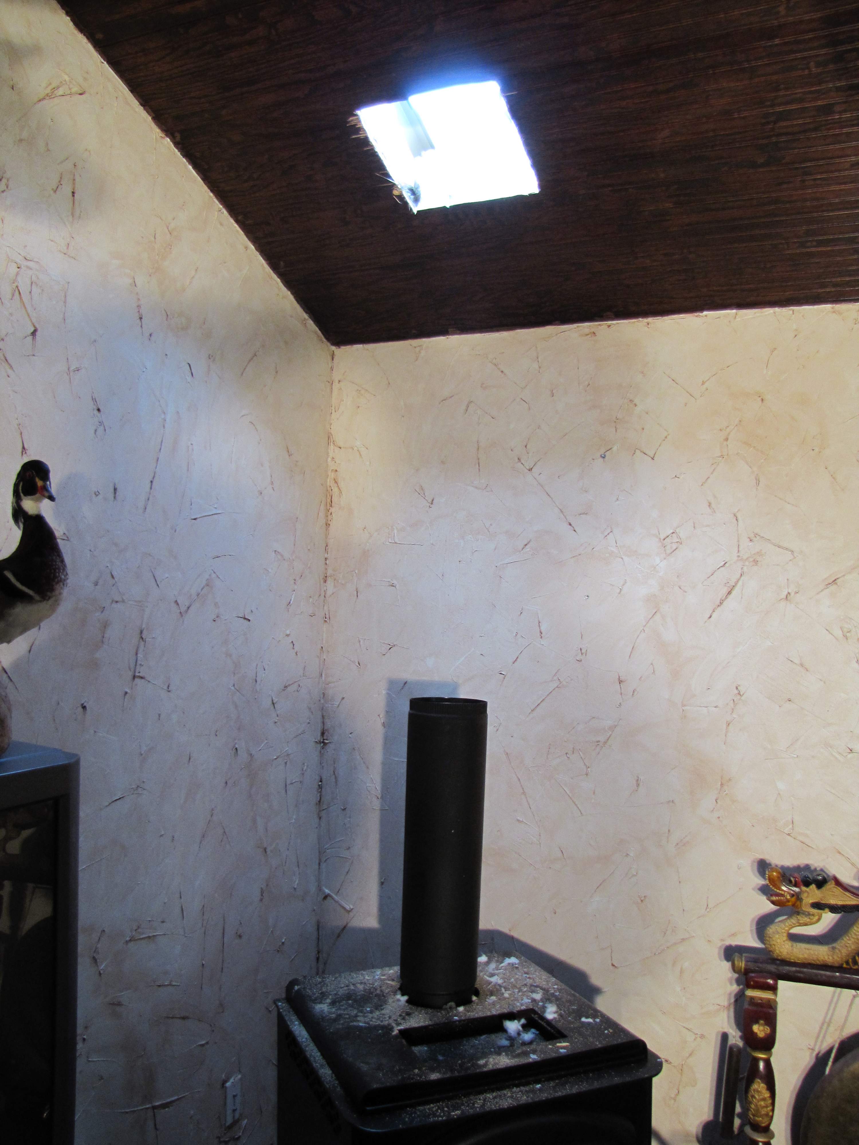

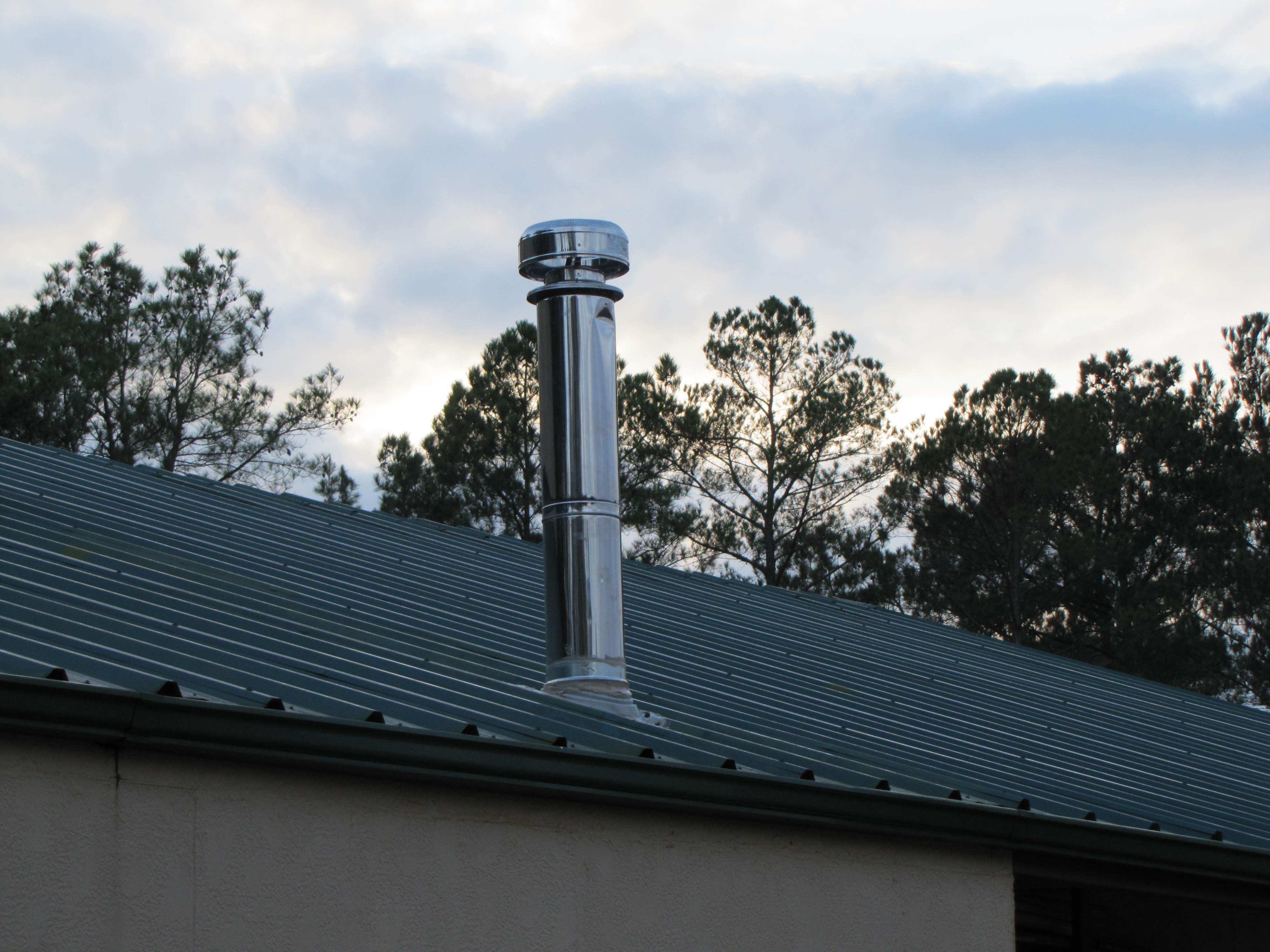

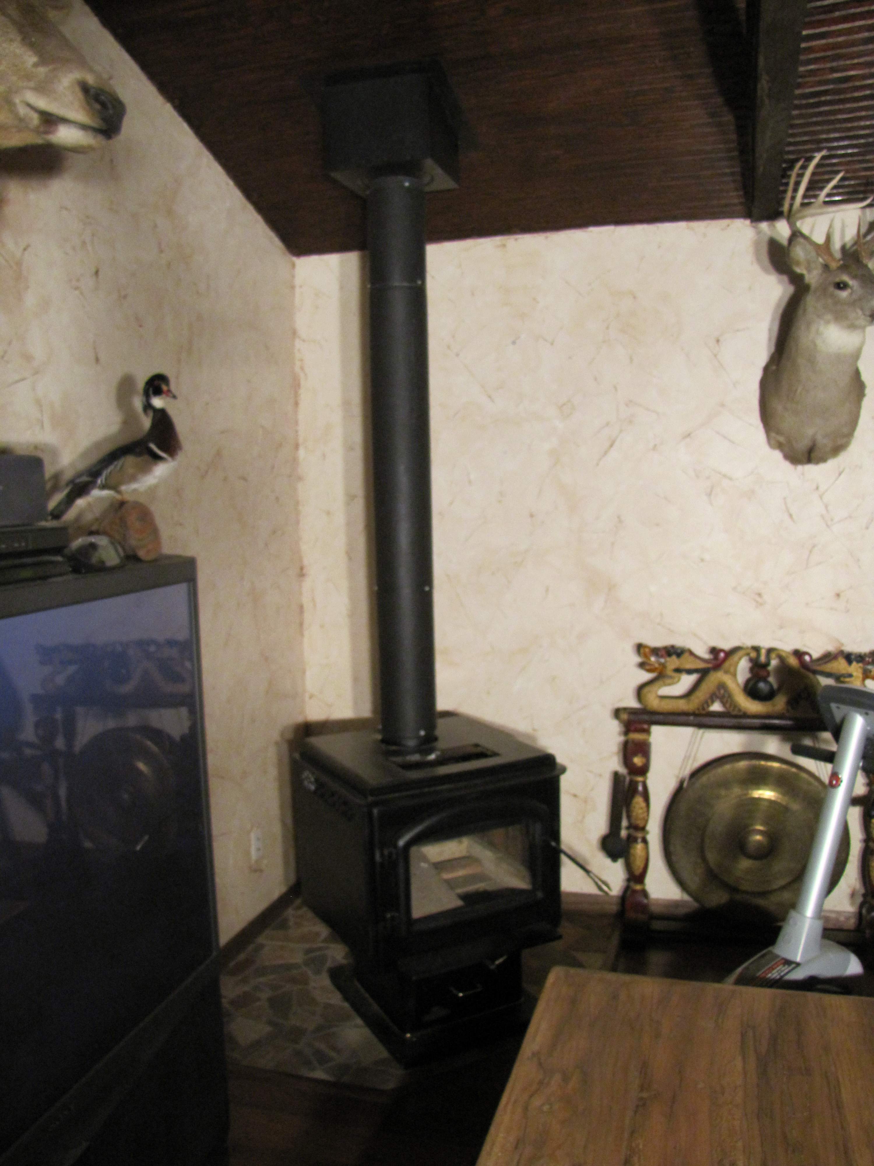

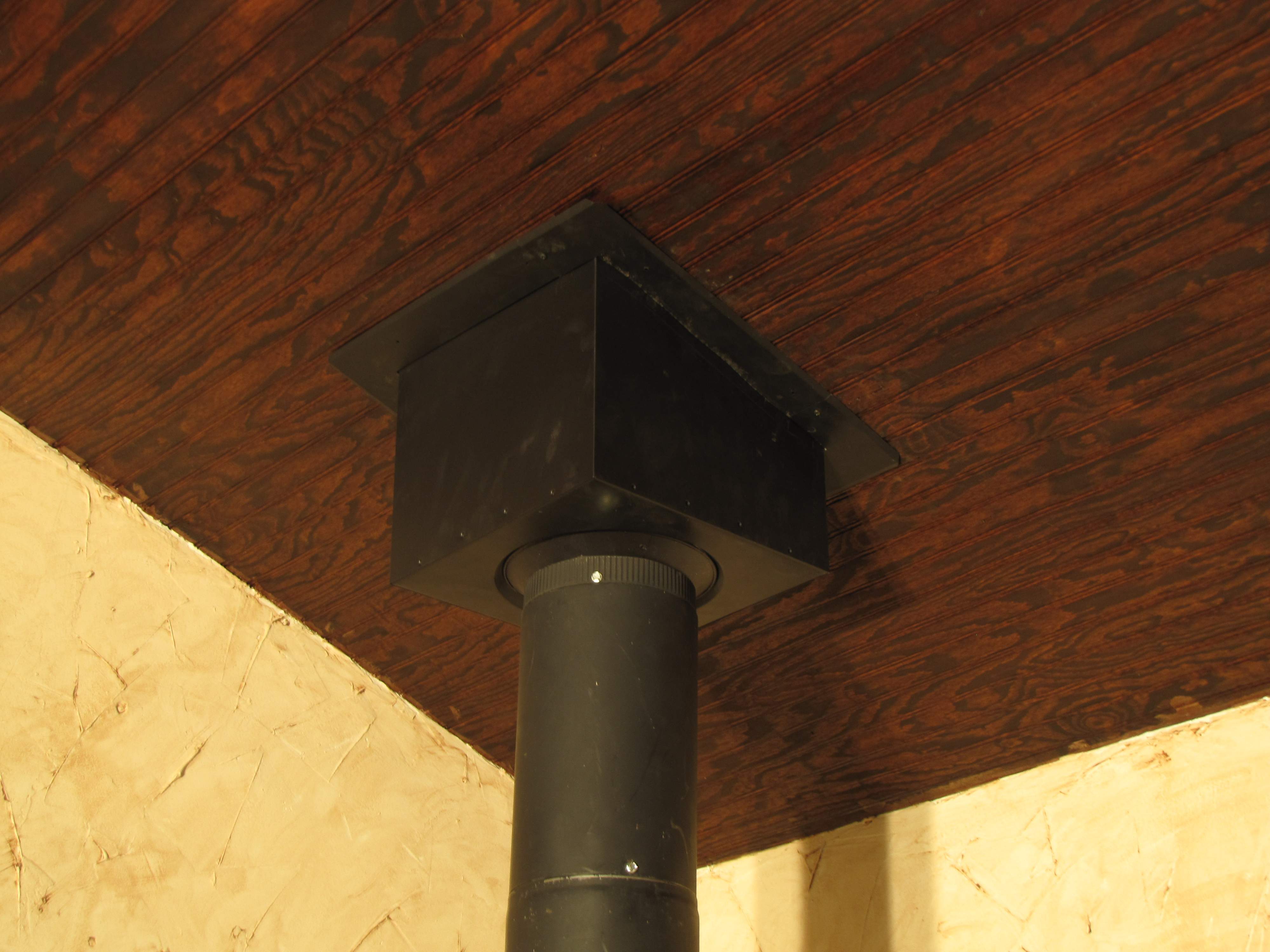

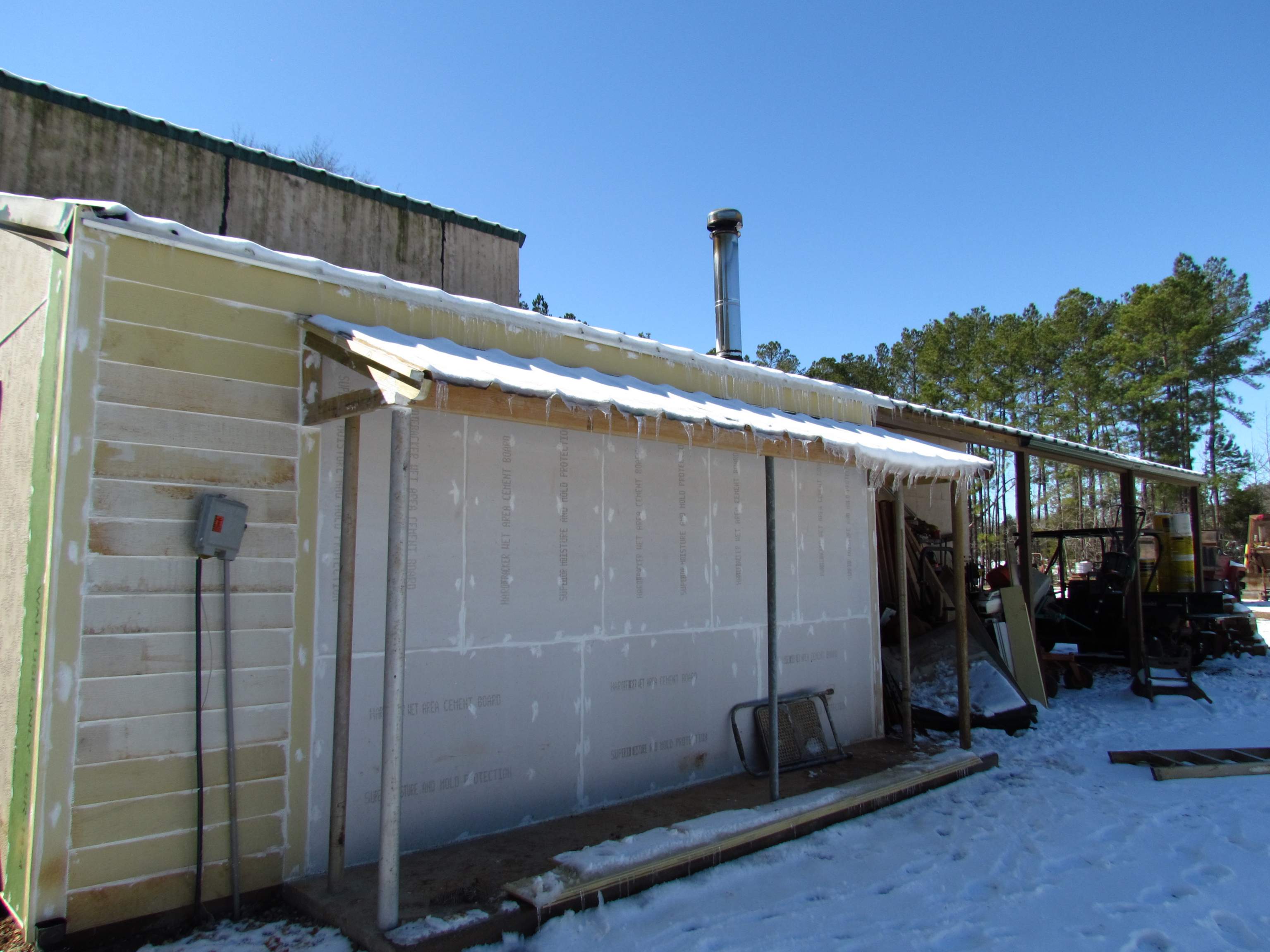

My parts for my pipe came in from Lowes two weeks ago. I was able to install it last weekend. All in all, it went in pretty easily. The real trick was getting it lined up so that the pipe would be straight. I had to slide the stove forward a little bit so the box would clear my ceiling joists.
Eddie
