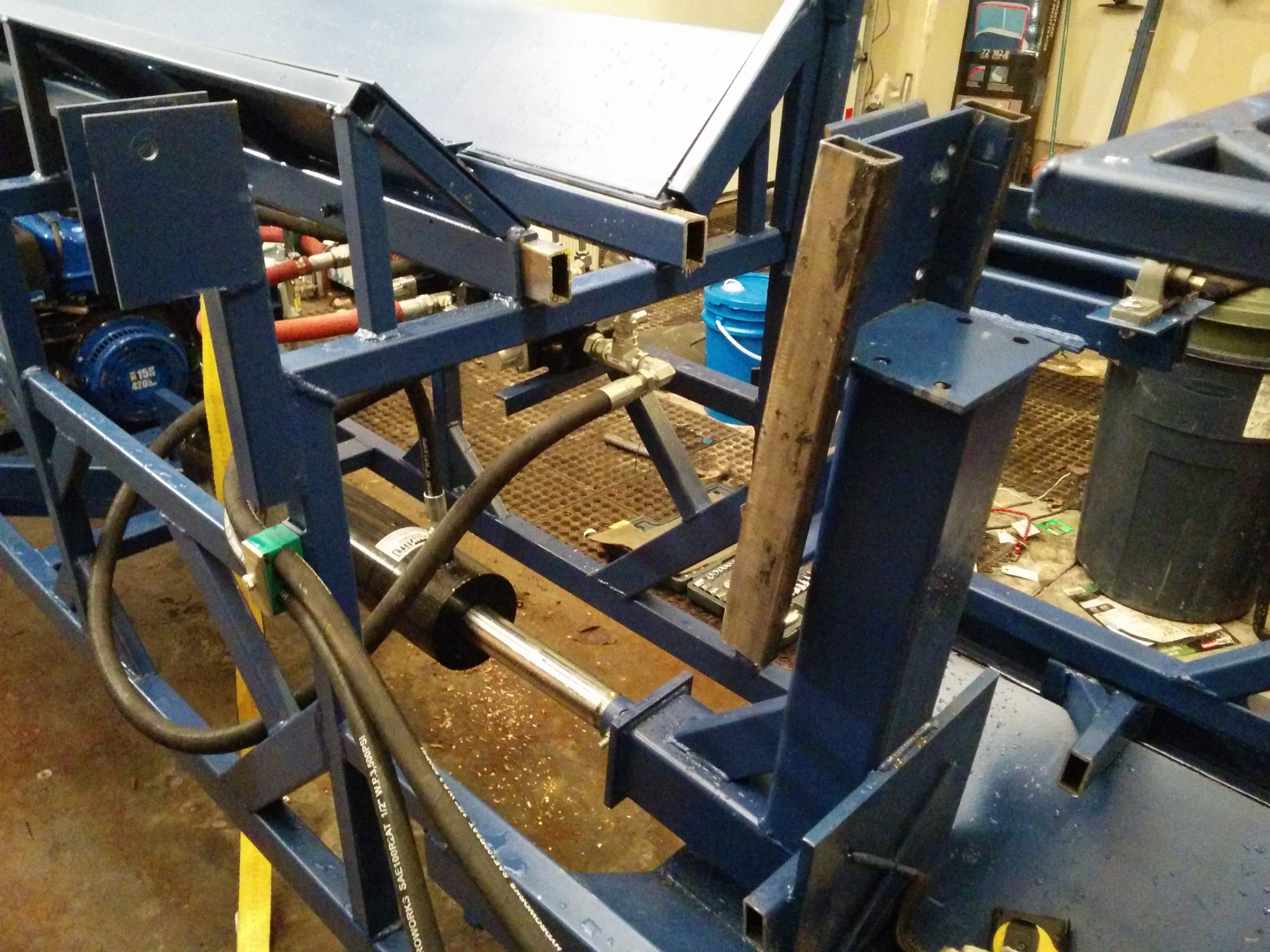

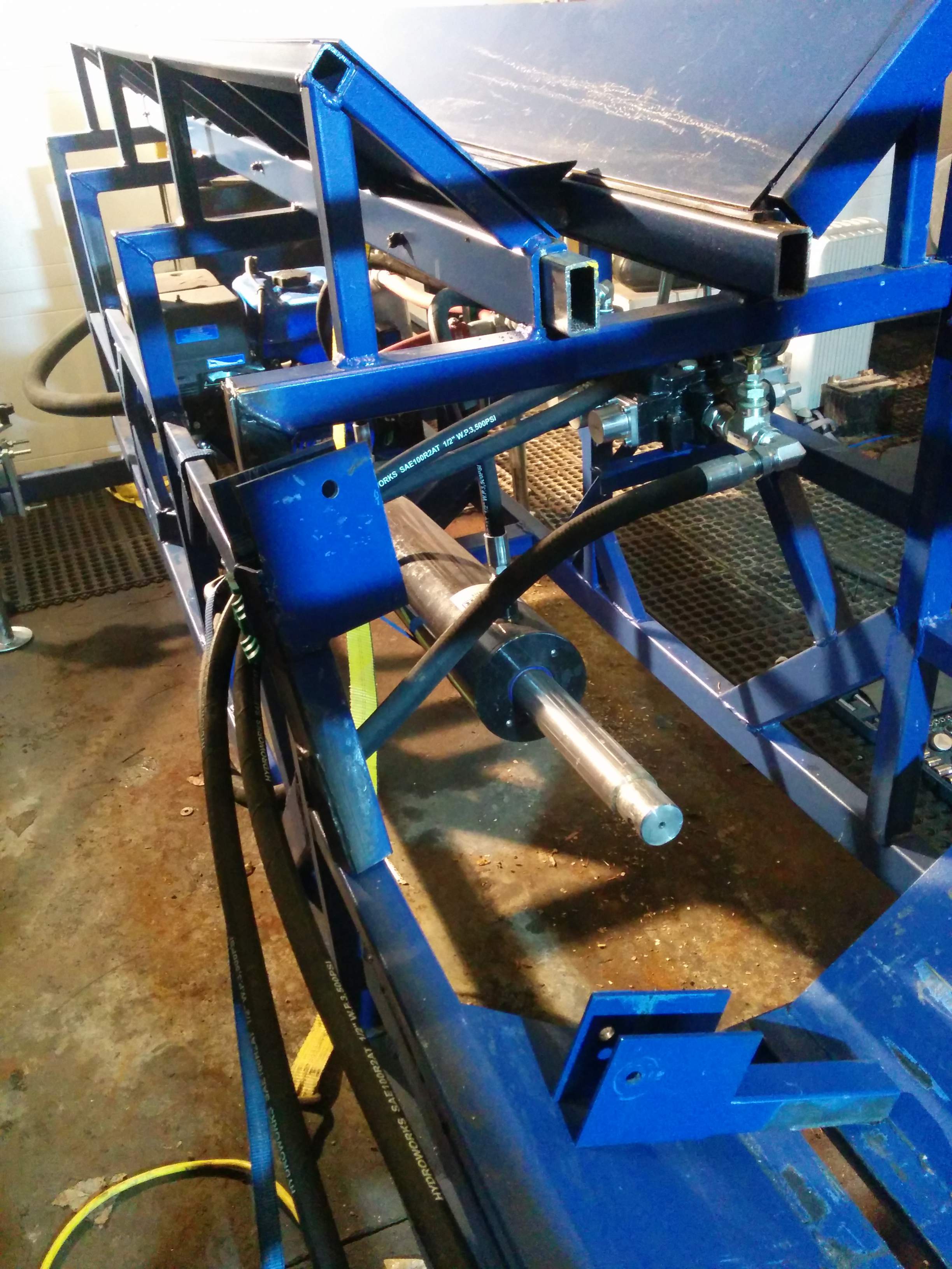

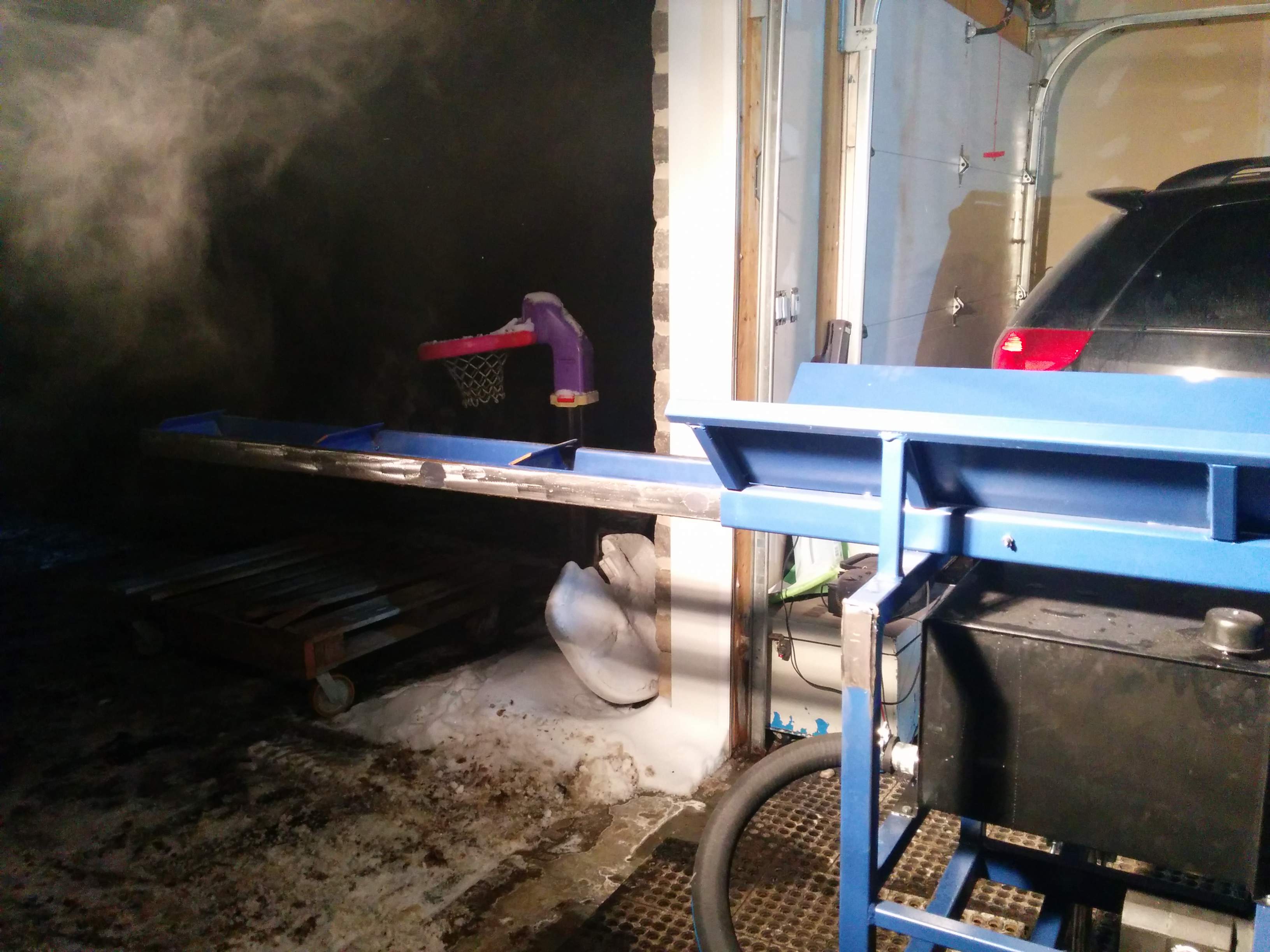

Well, the processor is comfortably back in the garage, unfortunately, that means my car was outside this morning when the temp was -22C. Moving it back to the garage, I didn't have the blower on the tractor because I've been using my scraper blade. That means I was missing my biggest source of ballast. I knew from the feel of the tractor (scraper blade is only about 200lbs, my tires are loaded), the back was very light so when I got onto my paved driveway with a slight incline, I took it out of 4 wheel drive and sure enough, I started spinning the back tires. That puts the processor at about 1800 lbs from my experience and I'll be adding another 300-400 with this redesign. Not that I should have been lifting it without the proper ballast, but it means I won't be able to lift it without the blower on the tractor when I'm done.
So it was a slow first day back at the office last night. Like I say, I got it back in the garage and got the splitter head out of the machine (that's actually not nearly as easy as it sounds). Then I started cutting...

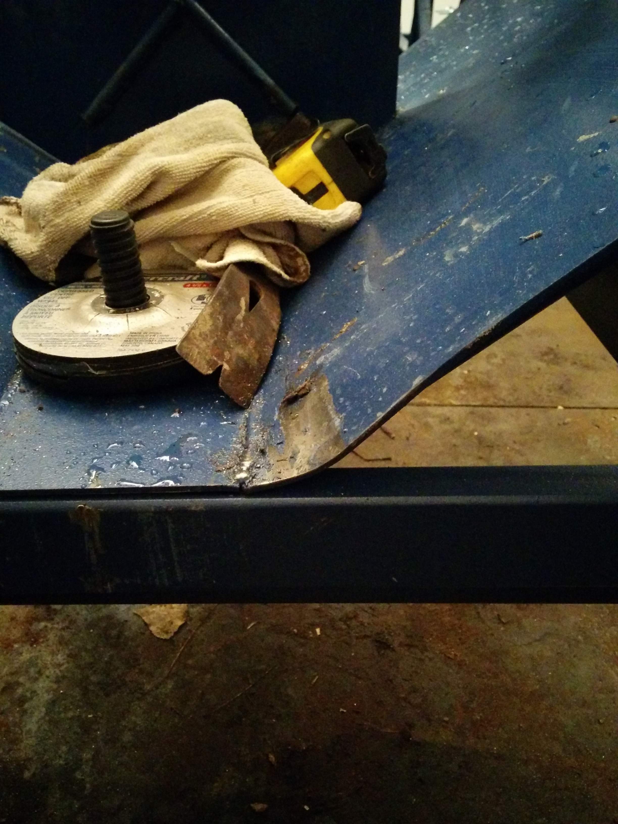

Back of the machine gone.
I didn't initially notice the damage to the trough from my first disaster of a test. I'm going to trim the trough back a few inches.

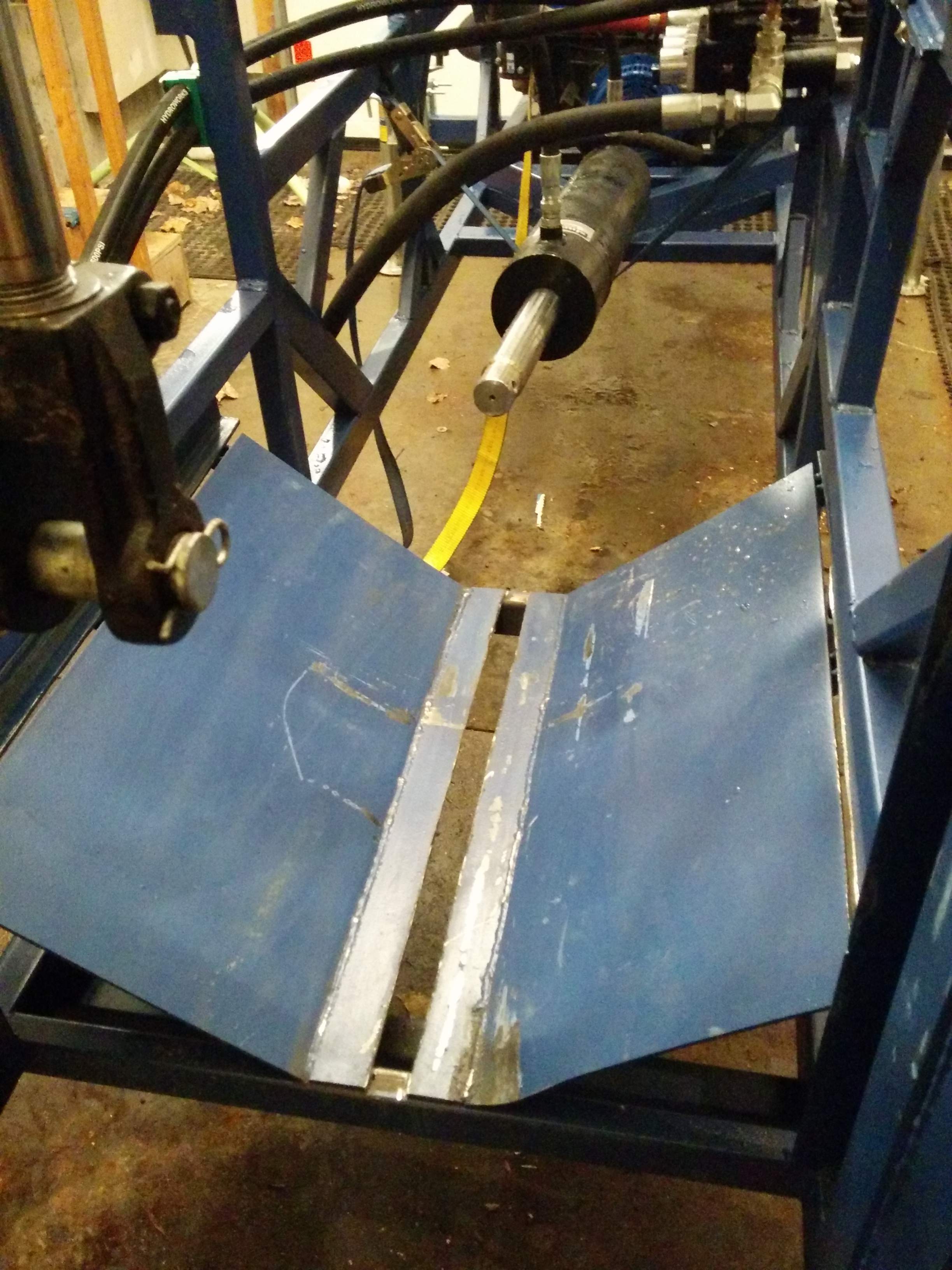

Next, I set about getting the pusher plate out of the machine. That wasn't going to happen without cutting it out since it was so twisted. The end of the sled was bent upwards so I cut it off since I'd never be able to pull it back out of the guide. I'm going to weld that end back in and add a roller or slide to support the wood right at the saw.
The attachment from the pusher plate to the cylinder shows how much it was pushed upward.
Last thing I got done was to cut a slot in the bottom of the trough. An 11" x 1/2 plate will be welded to the bottom of the pusher plate and go through the slot. A 1/2" by about 2 1/2" piece will be welded at the bottom of that piece just wide enough to slide between the rails, it will look like I've made my own I beam shape. Under that, a wider piece of 1/2 plate will be bolted to the one sliding between the rails and will slide along the bottom of the rails. This will keep the pusher from rising. I also have a large sheet of nylon or teflon or some similar material, that's 3/4" thick. I used part of it to make a cutting edge under my blower to protect my driveway. I'll cut and rip more of it to surround everything and allow it to glide smoothly.

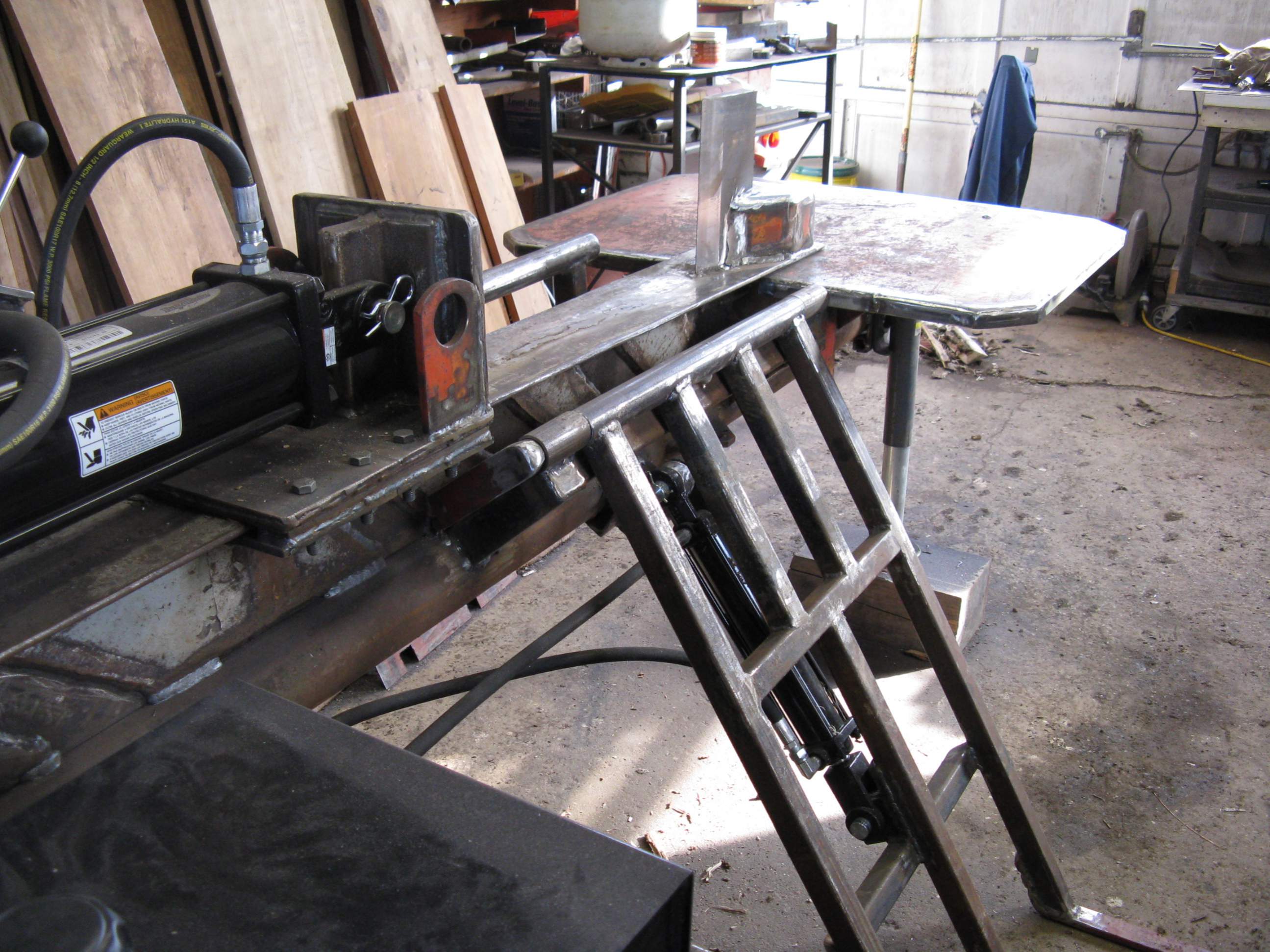

I'm not trying to tell you what to do but from my experience when dealing with this kind of stuff you will need to mount your cylinder to a beam. With the cylinder mounted to a beam properly (back push point) the front pusher will travel in a relatively straight motion. The way you have it mounted you have two different parts that can move and the front part is going to go in the direction that the anchor point is leaning. Look closely at the piece that you have the cylinder mounted to in the back. It may also be tweaked and need a little TLC.
If a cylinder is mounted to a good strong H beam properly it need very little support at the front to keep it traveling in a straight line. Some is needed of-course because all wood is not perfect like you see in all the advertising of splitters and wood processors. Also as someone else said before you need to get rid of that extension you have on the front pusher that is and avenue for trouble. The pusher pin needs to be as close to the pusher block as possible which will help also.
From where I'm sitting it doesn't look like it would be too hard to fab in a H beam to what you have.

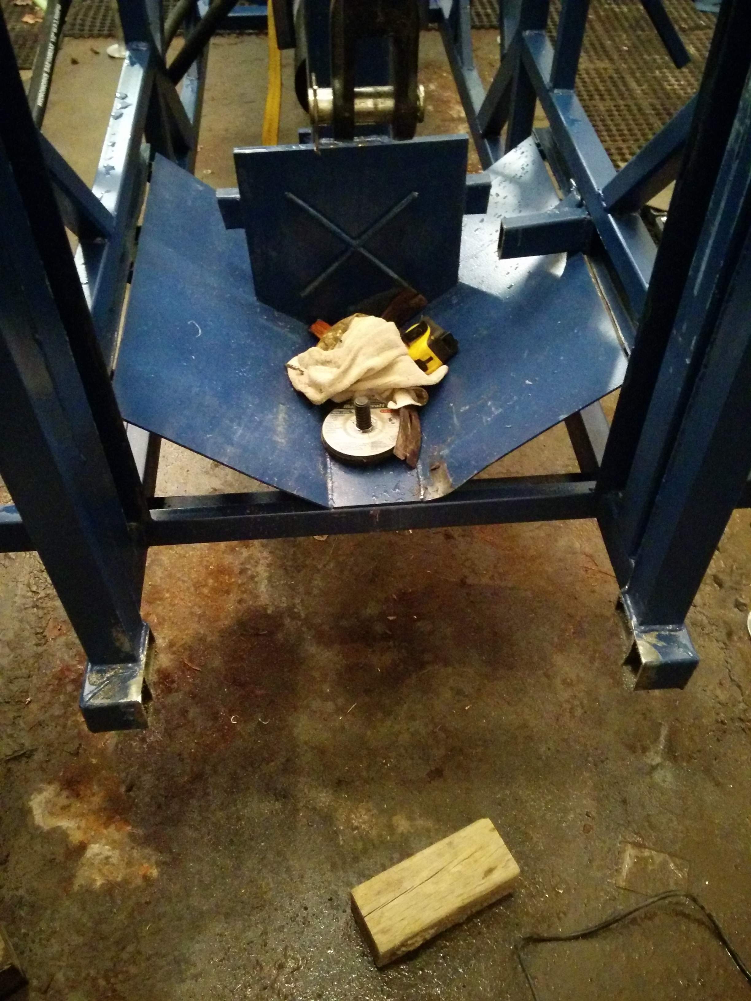

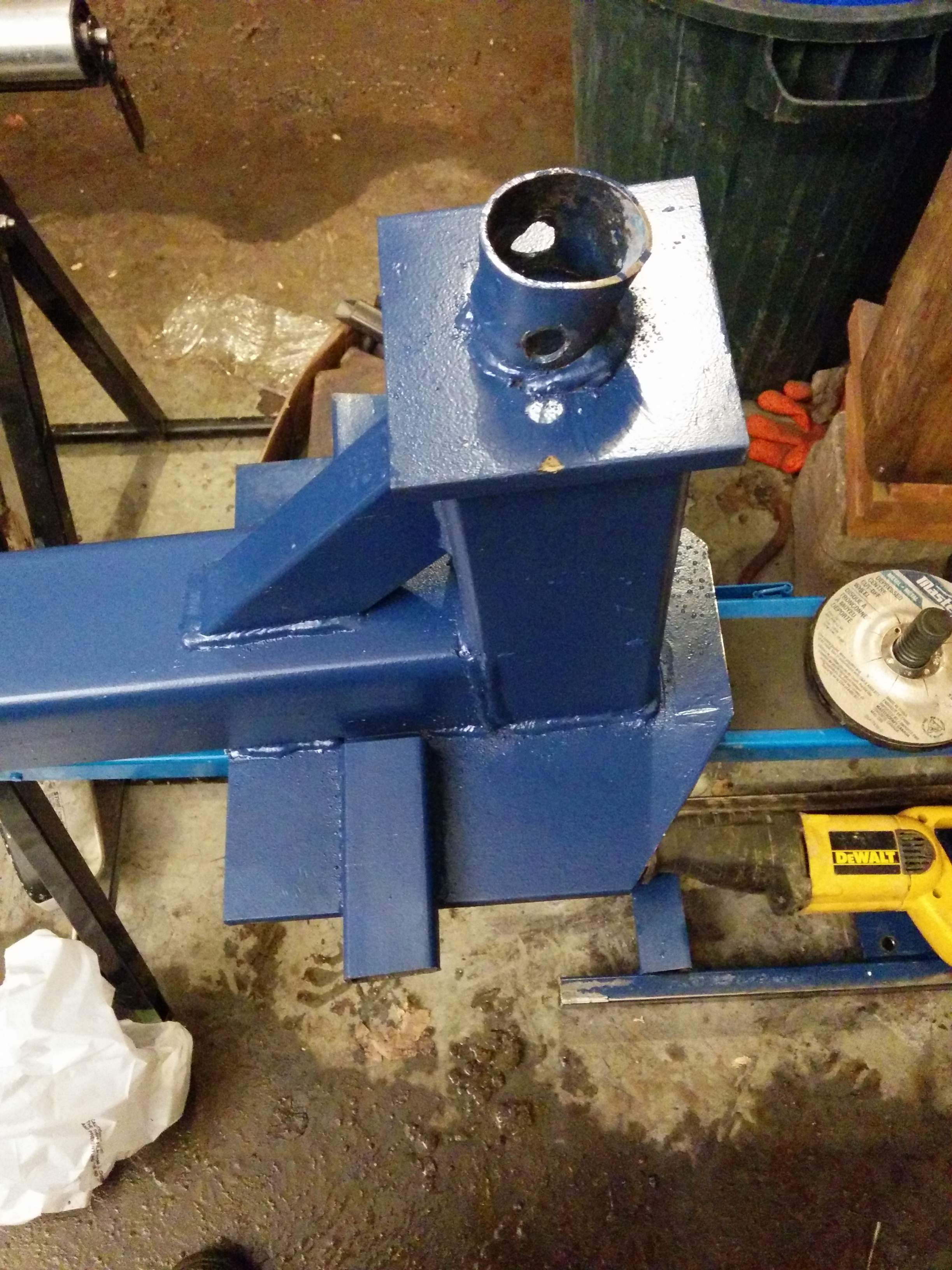

Cut the bottom of the splitter head out. This will allow the 4 way wedge to work properly without being jammed. I'm also going to re-purpose the two 6" X 10" - 1/2" pieces.
(it's upside down in the pic)

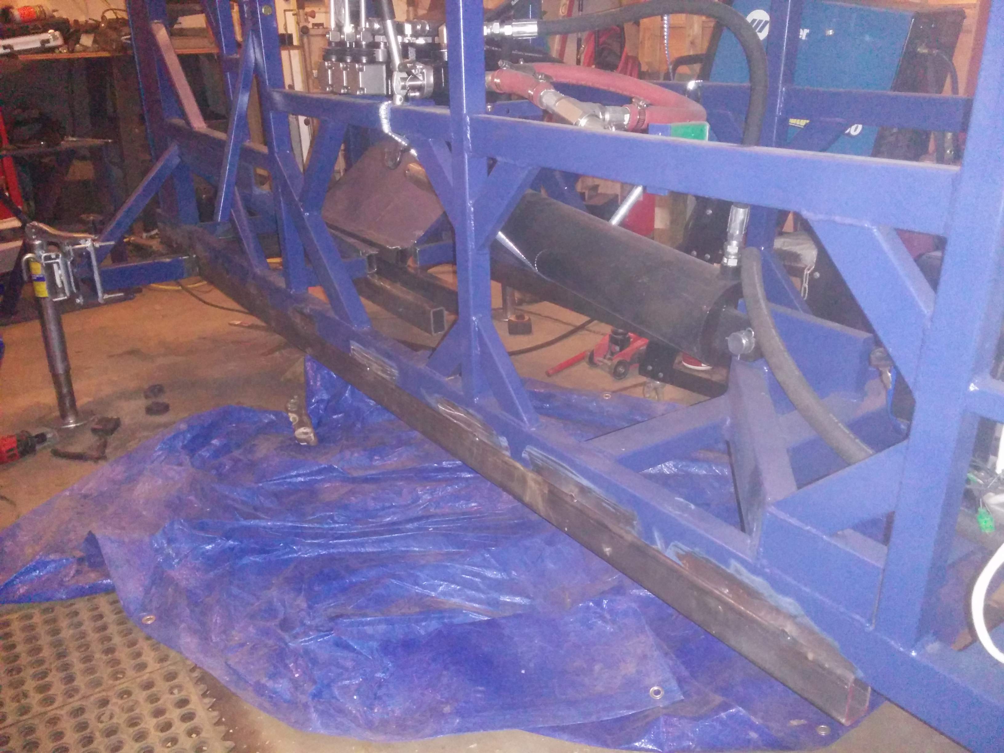

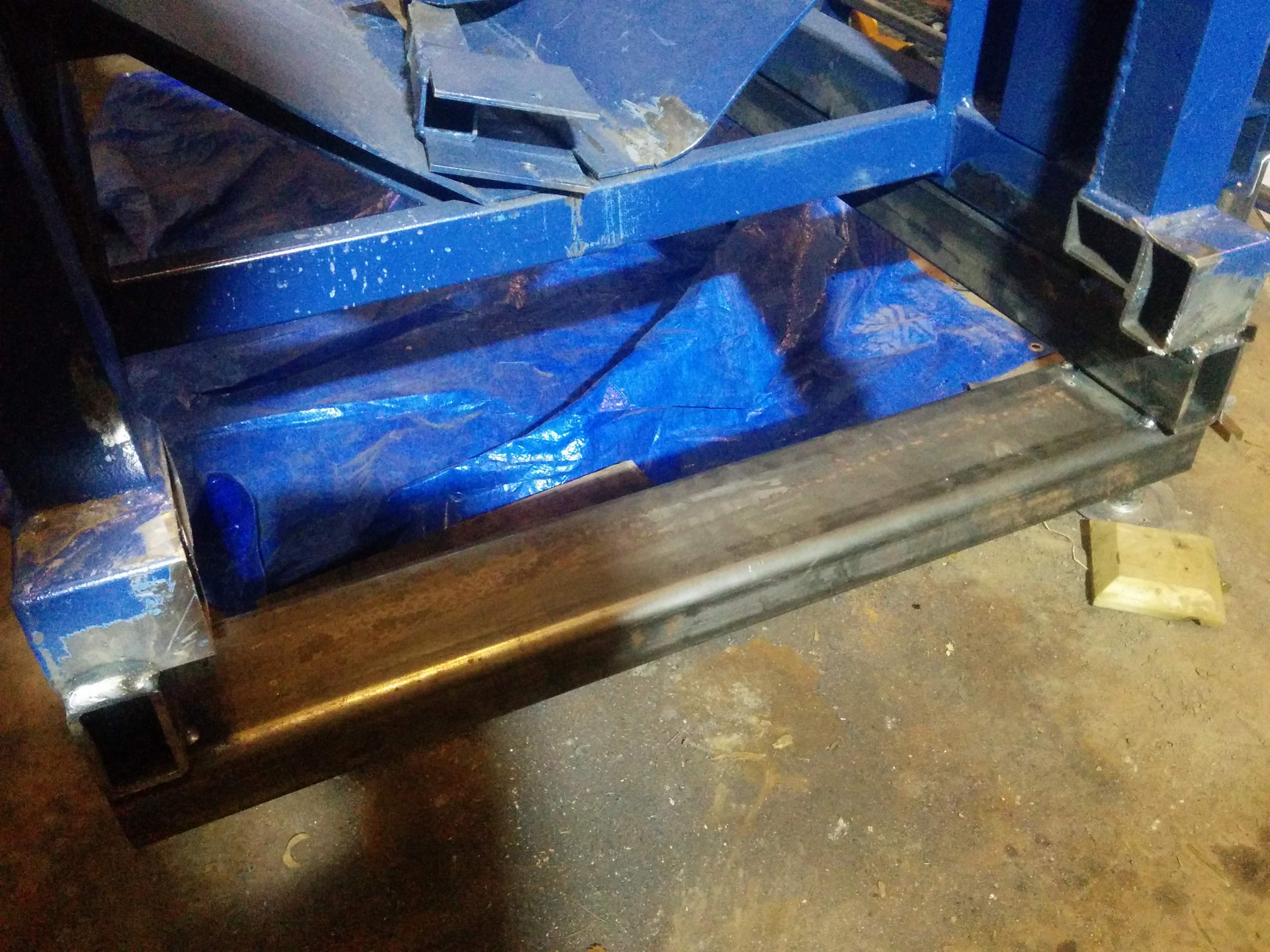

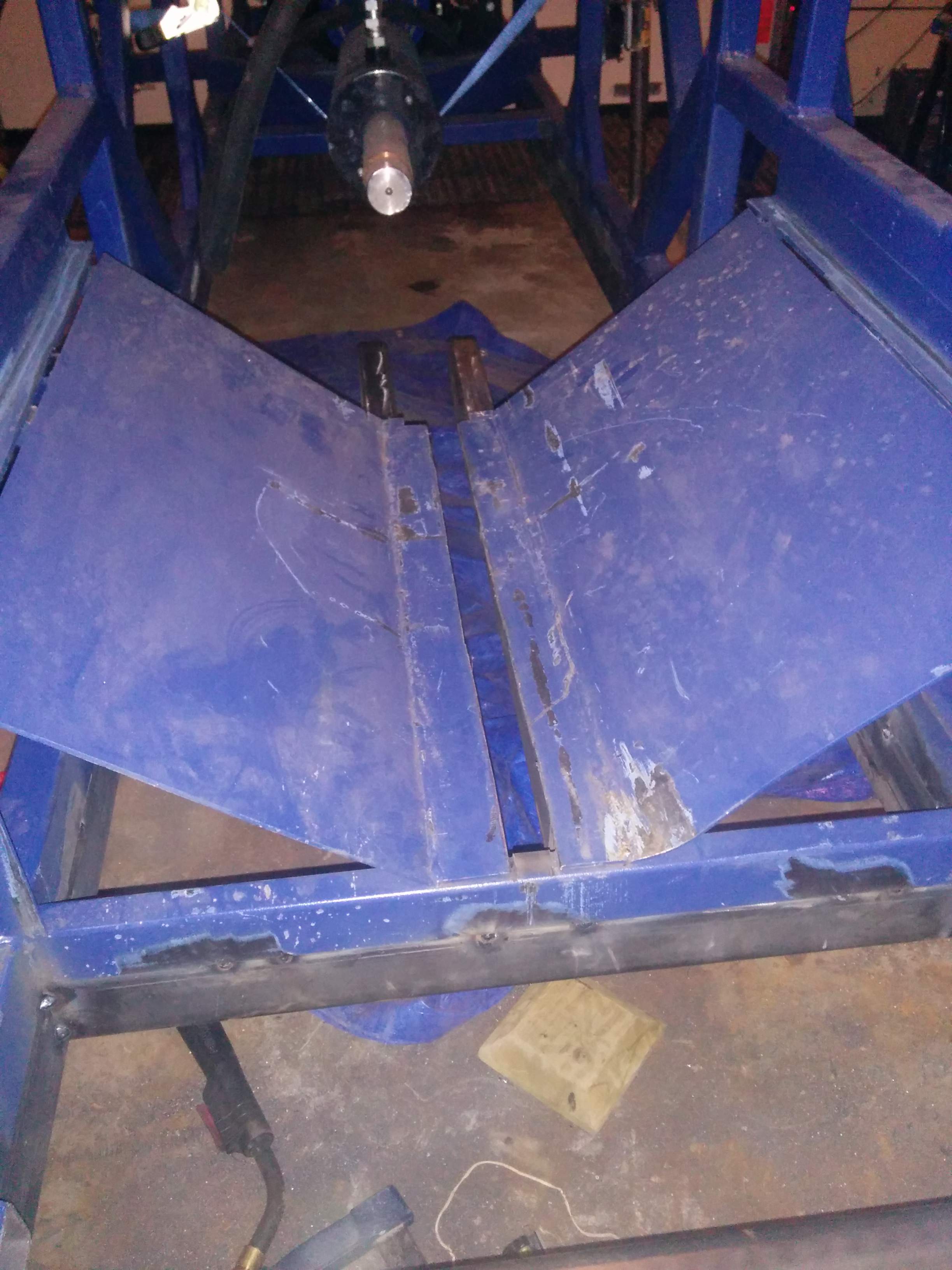

I started re-structuring the processors frame this weekend. It doesn't look like I got much done, but it was a lot of hard work. Working under the machine to cut small pieces out here and there isn't fun. Grinding, sanding and welding under there isn't much better. I'm actually sore this morning from the workout.
Sorry, pictures aren't very good

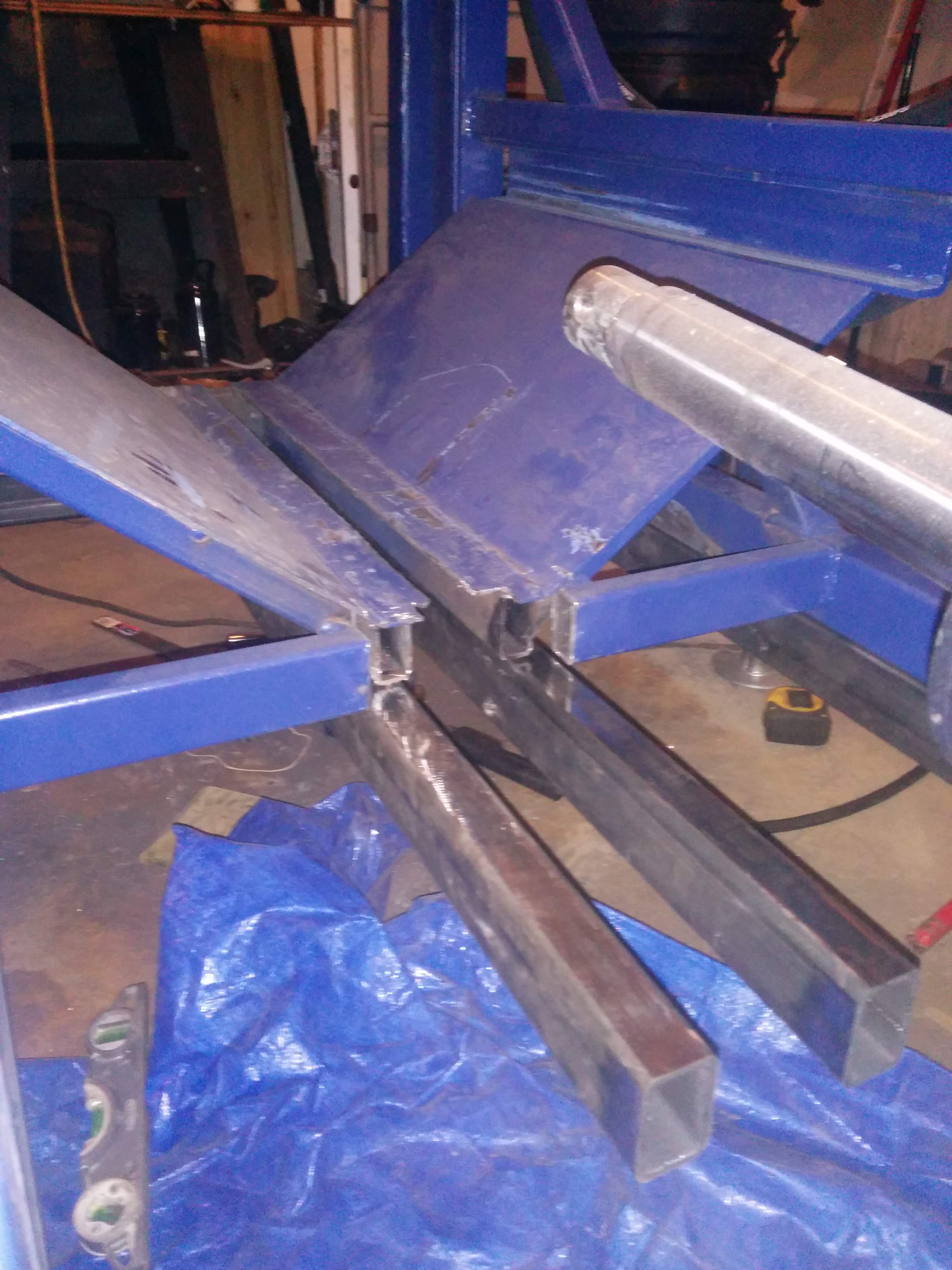

I started by doubling up the processors frame from the cutting head back behind the attachment point for the cylinder. This involved cutting out the cross member that made up the legs. They then got re-welded to the new frame. I used 1 1/2" X 2 1/2" - .188 (3/16), debated going all the way to 1/4 wall but with all the bracing now in place, decided .188 would be fine.
I welded a new cross piece at the back. It is 5" lower than the previous one and is 2" X 4" - 1/4. the only problem is that the splitting head isn't tall enough to rest against it when it's in the 4 way position so the sides will take all the pressure. I don't think that's the end of the world and I can always have the cutting head lengthened. The splitting head will rest against it in the 2 and 6 way positions.
I then started in on the rails for the pusher plate. They are also 1 1/2" X 2 1/2" - .188 and they mounted under the existing 1" X 2" - .125 rails that made up the bottom of the lower log trough. I didn't get finished last night but the new rails are tacked in place, I now need the cross member at the end of them and to extend the 1" X 2" rails on top of them to support the pusher plate when it's retracted. The rails have a 2 5/8" gap. Under the pusher plate, I'm welding a 1" think piece of plate in the vertical position and bolting a 3/4" thick piece of nylon to each side. That should give me 2 1/2" and leave a 1/16 on each side.
