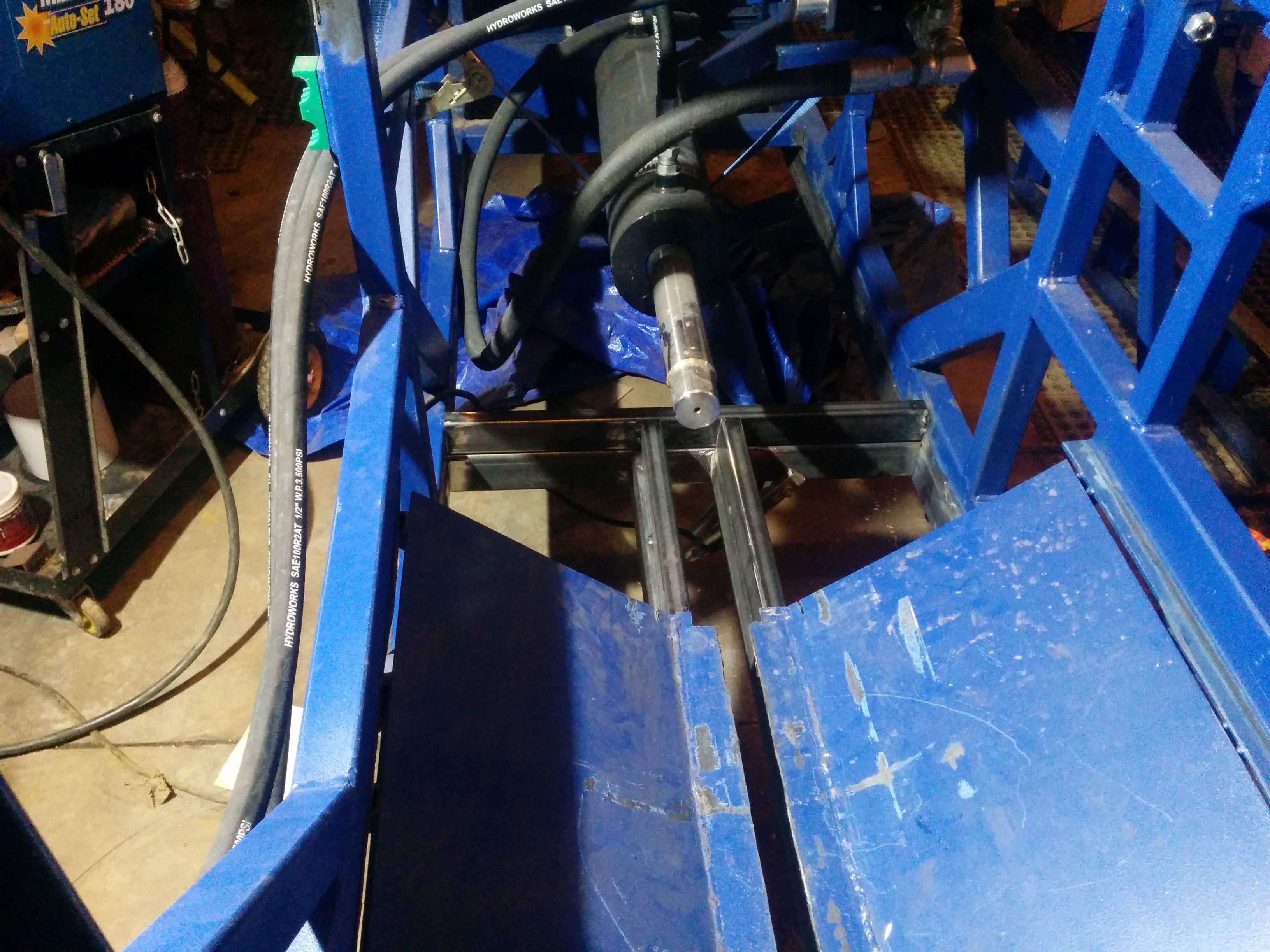

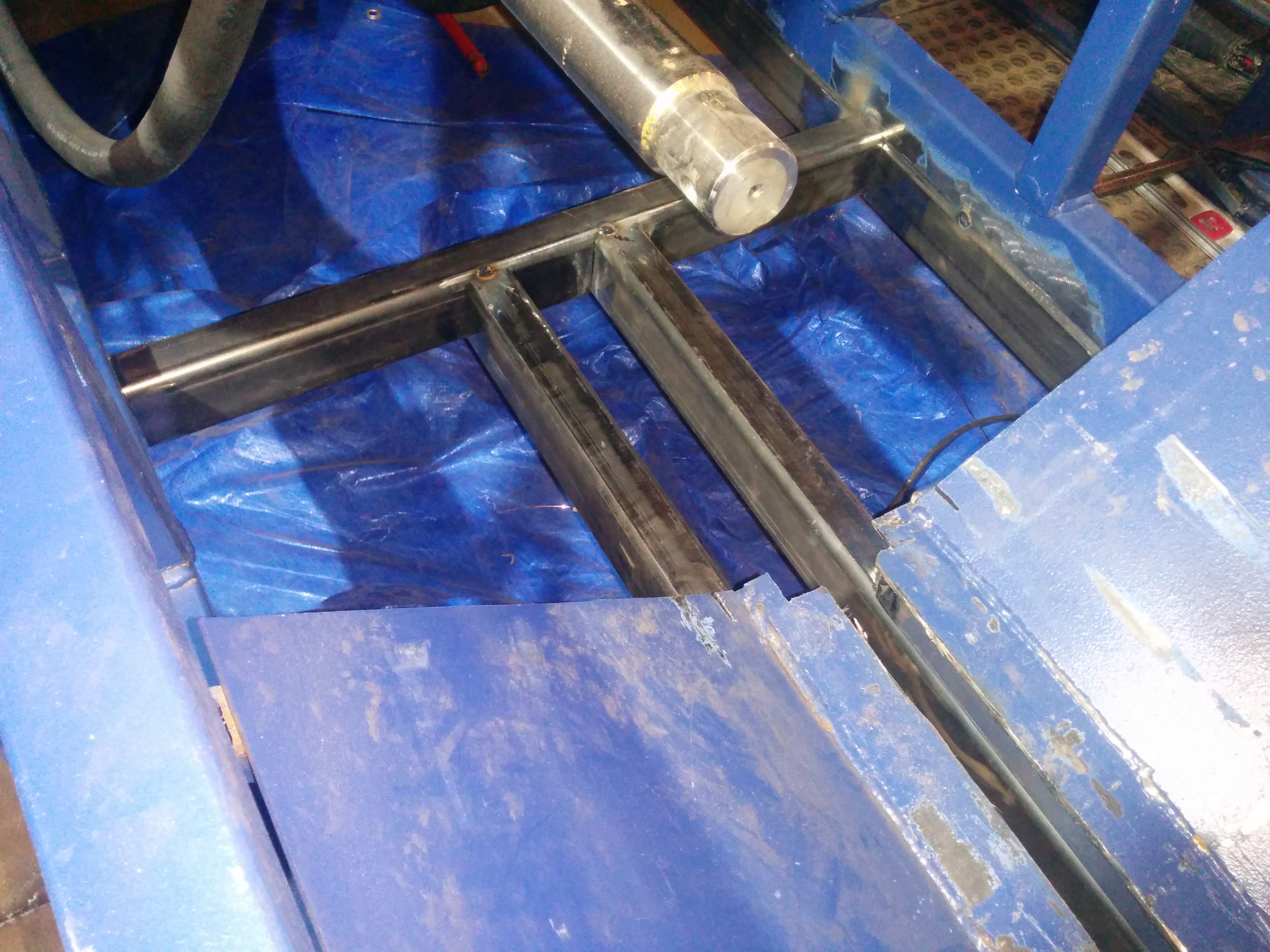

Got a little more done last night along with some good head scratching. Think I have it all figured out now.
Lower rails in place.
Upper rails extended. Just need to add a little sheet metal to make it level with the trough.

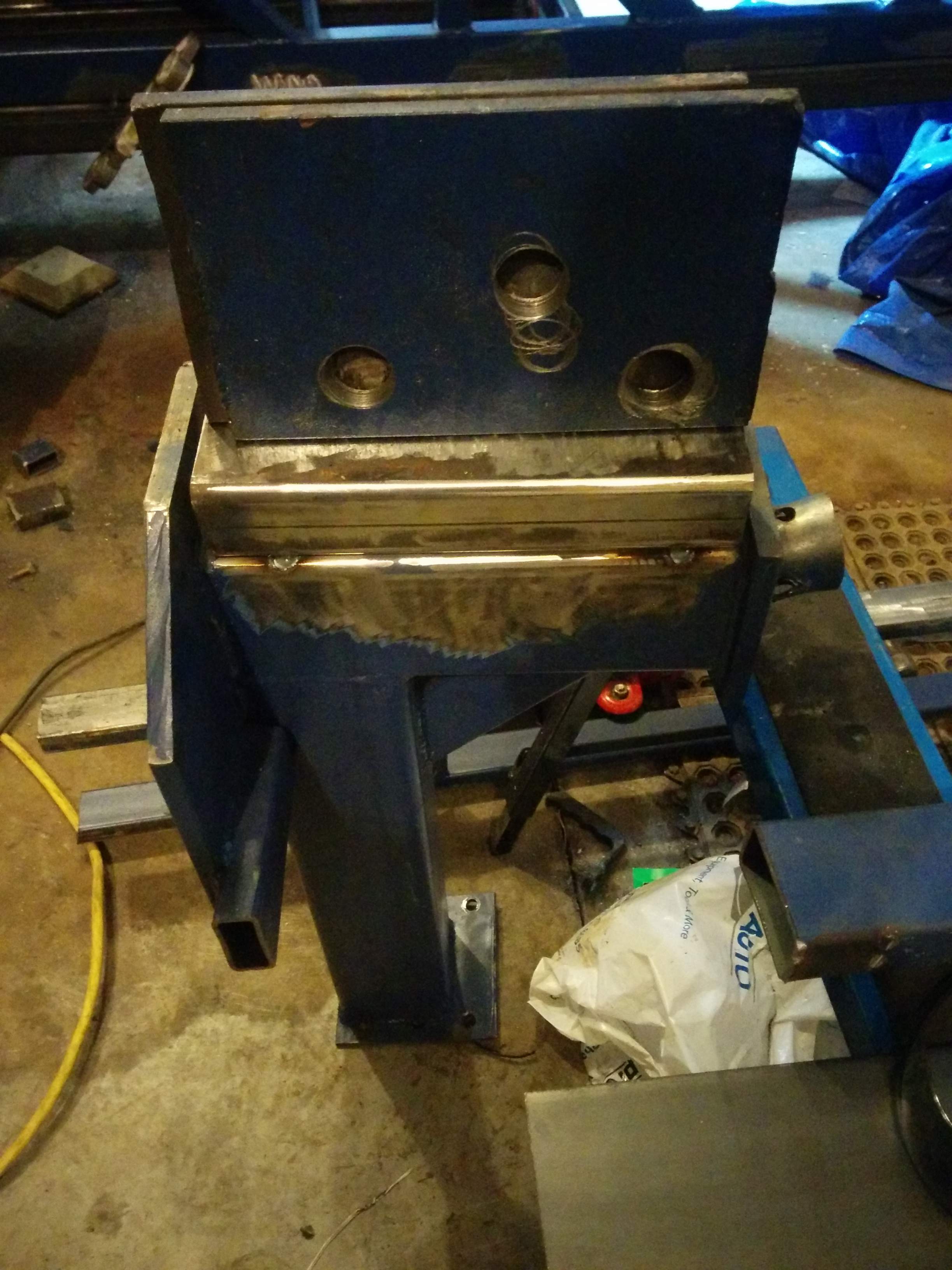

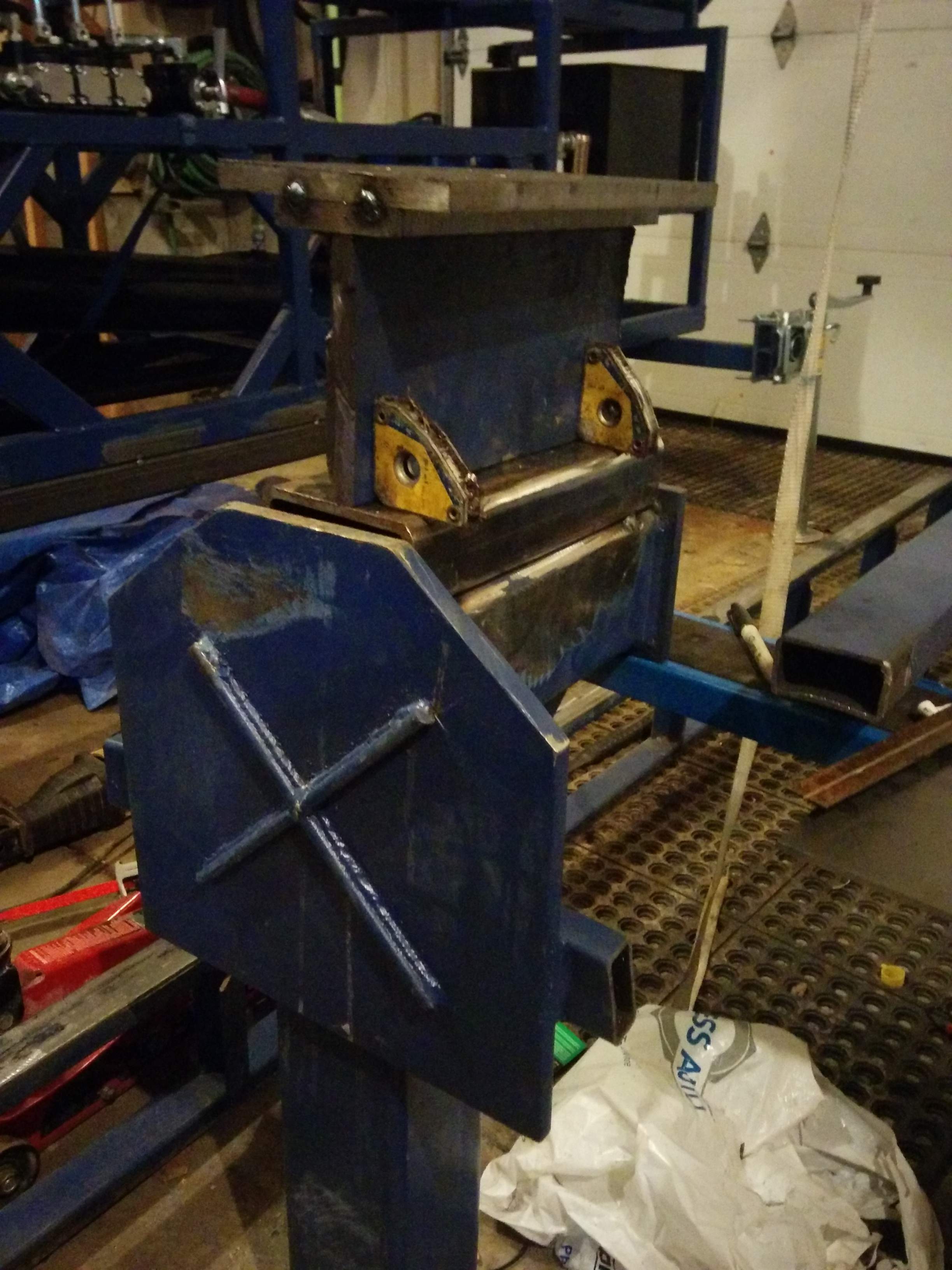

Welded a 2" X 4" - 1/4" piece to the bottom of the pusher plate. The two 6" X 10" - 1/2" scraps I cut out of the bottom of the splitter head will be trimmed to 5" tall and welded vertically to it. A T will be welded to the bottom to bolt onto a slide under the lower rails. I cut 3 holes randomly into one of the pieces to plug weld it to the other. 3/4" nylon one either side brings it to 2 1/2" thick to fit into the 2 5/8" space between the rails.

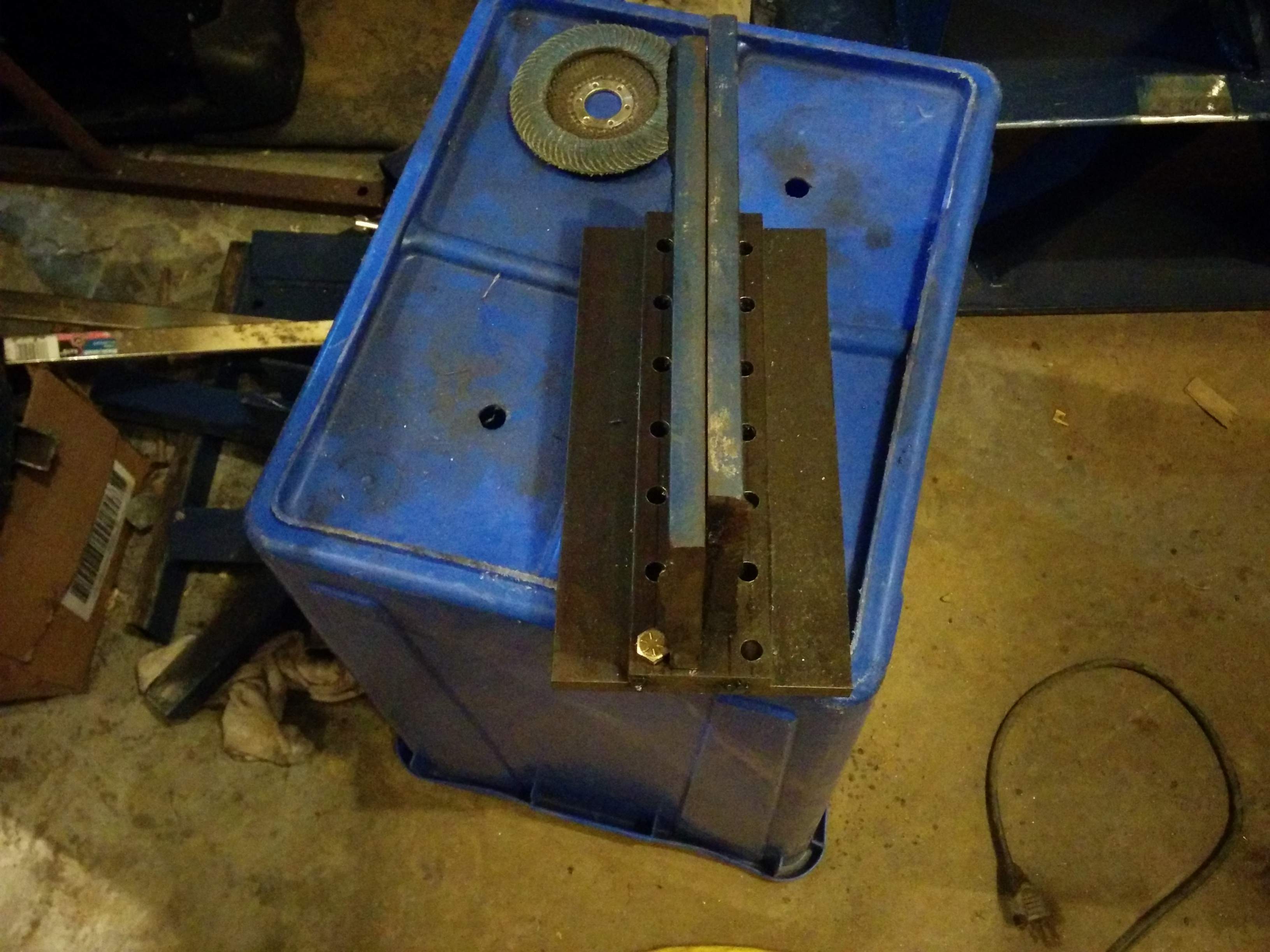

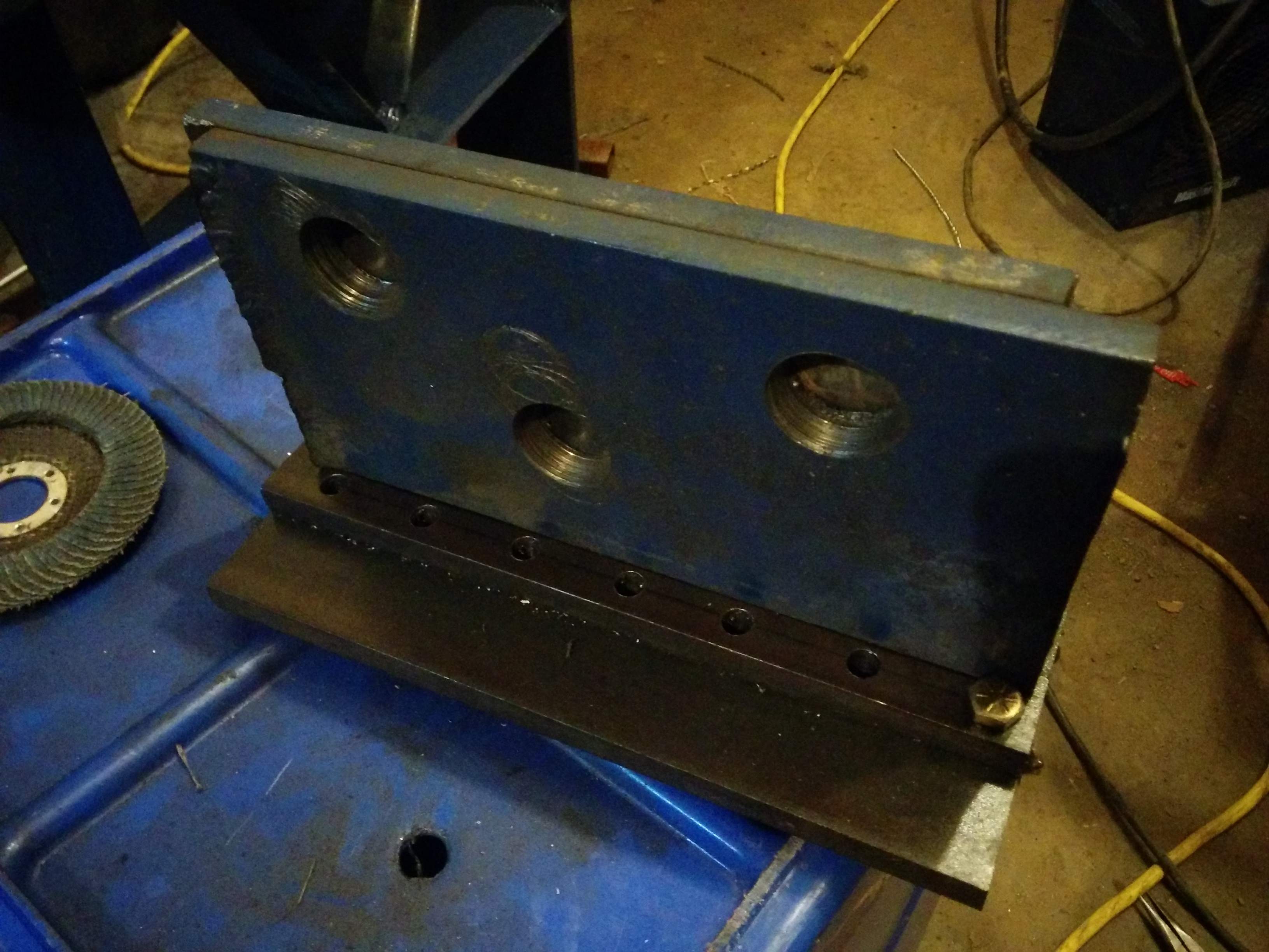

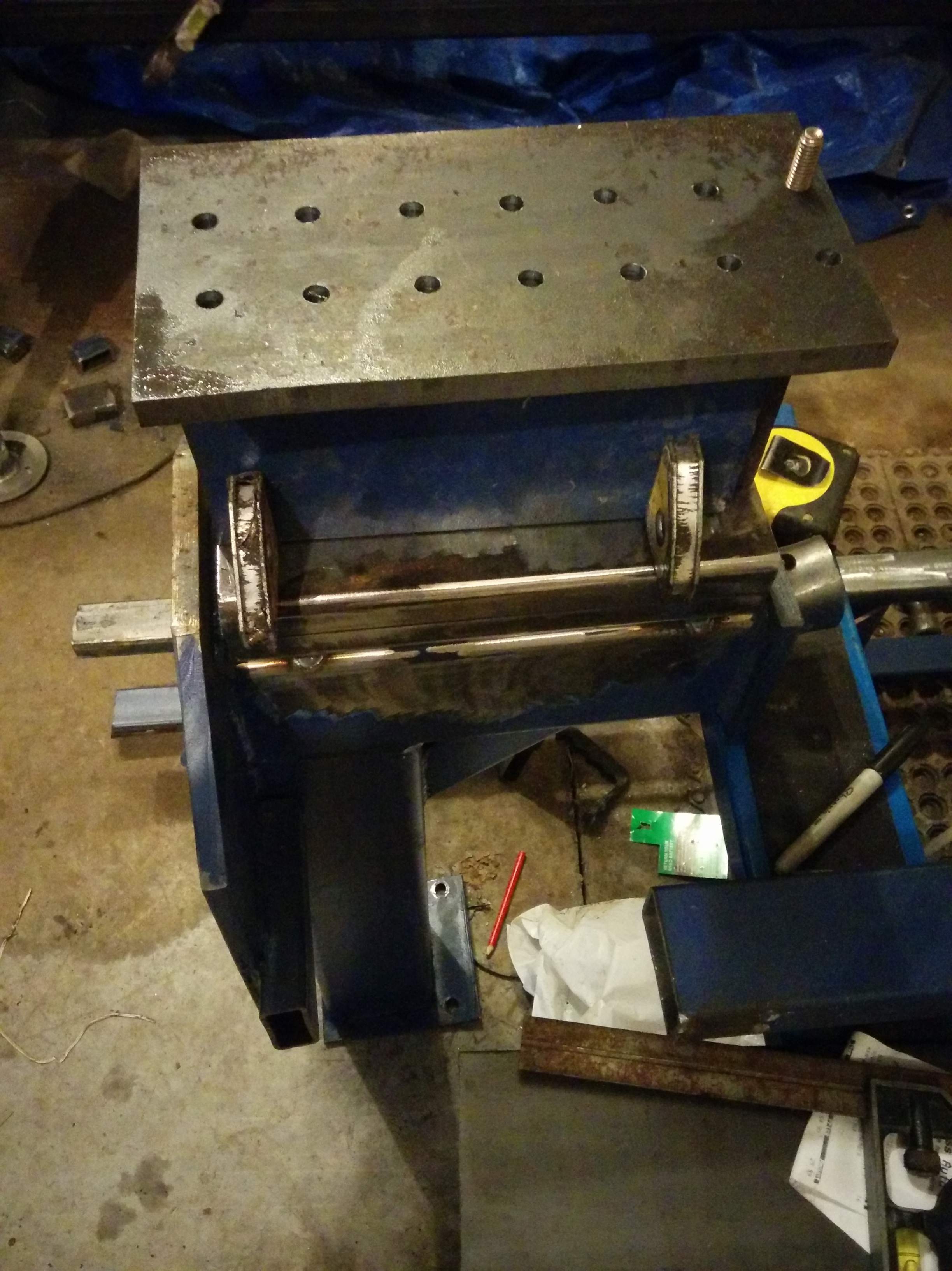

So, you'll all probably think I'm slacking off these days, but this pusher plate re-work is taking forever! By the time I looked up last night it was 12:30 am and it felt like I barely got anything done. The sad part is, I still see needing two nights to finish up the pusher plate before I can start having a little more fun building rollers and figuring out how to install the hydraulic motor.
Pictures all show the pusher plate upside down.
I trimmed the vertical pieces down to 4 15/16" (yes, I actually managed to hit that exactly on both 1/2" thick plates!).
I ripped a 8" X 12" - 1/2 plate down to a piece 2 1/2" X 10 1/2" and another at 5 3/8" X 10 1/2". I then tacked them together and drilled bolt holes through them. The 2 1/2" piece will be welded to the bottom of the pusher plate as a T, then there'll be a 3/4" thick piece of nylon (5 3/8" X 10 1/2") sandwiched between it and the larger piece.
There will be 14 - 3/8" grade 8 bolts holding the plates (and nylon) together. The bolt heads should jam on the vertical piece but if not, I'll have to tack them in place since I won't be able to get a wrench on them.

It's all those holes that take forever! How are you going to hold the poly to the sides of the guide?
By the look of it, you are using a hole saw for the larger holes -- what brand? I tried a couple 3/4" holes and just eat the teeth off after only a couple holes, seems they don't clean out enough (1 Mastercraft, 1 Dewalt) 1 1/4" worked much better thru 3/8' plate
And what drill press are you running? My Mastercraft one slips the belt way more than I think it should.

Yup, holes take a long time.
I drilled a 1" hole in 1" thick plate for the cylinder attachment. I could have spray painted the hole saw, stuck it back in the package and returned it when I was done! I used to burn hole saw after hole saw until I went to Ottawa Fasteners and bought cutting oil. I believe it's called Ice Cold but I can't remember who makes it. It's about $10 a bottle but goes a long way. Once you start using it, it won't matter what brand hole saw you use, they slice through it like butter. For thicker metal (like the 1/2" plate I just did), I continually stop, use a mini wire brush to clean out the cut, fill the groove with a couple drops of oil and keep going. It took a little while to get through the 1" plate, but it was easy cutting.
My drill press is from my dad. It's an older one, but a good one. Don't know any of the details though. The important thing is to slow it down, move the belt to the slowest speed and use cutting oil, heat is what's killing those bits.

Oh, the poly will be bolted using four bolts through the 1" thick plate. The head and nut will be sunk flush. I'll have to see what Ottawa Fasteners has to offer that's as thin as possible. I'll probably have to use loctite.
The poly for the slide under the bottom rails will have the 14 bolts through them.
For the poly under the pusher plate, I'll weld 1/2" sides and secure them with a few screws. There wont be any place for them to go since the pusher wont be able to rise or move side to side.
