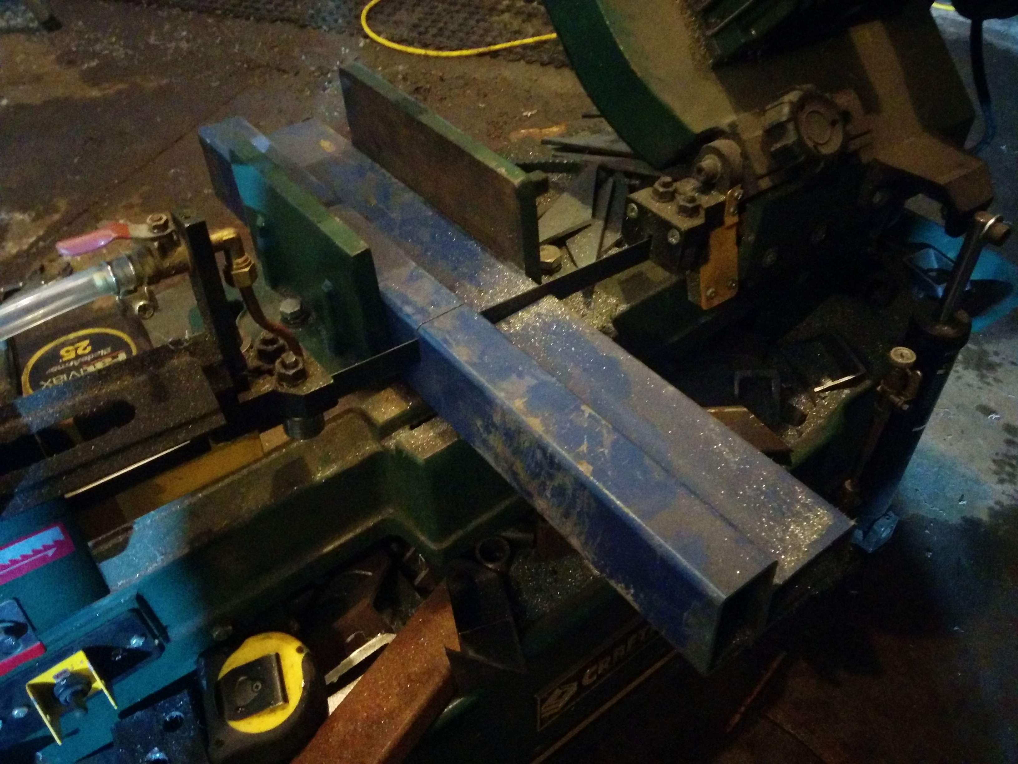

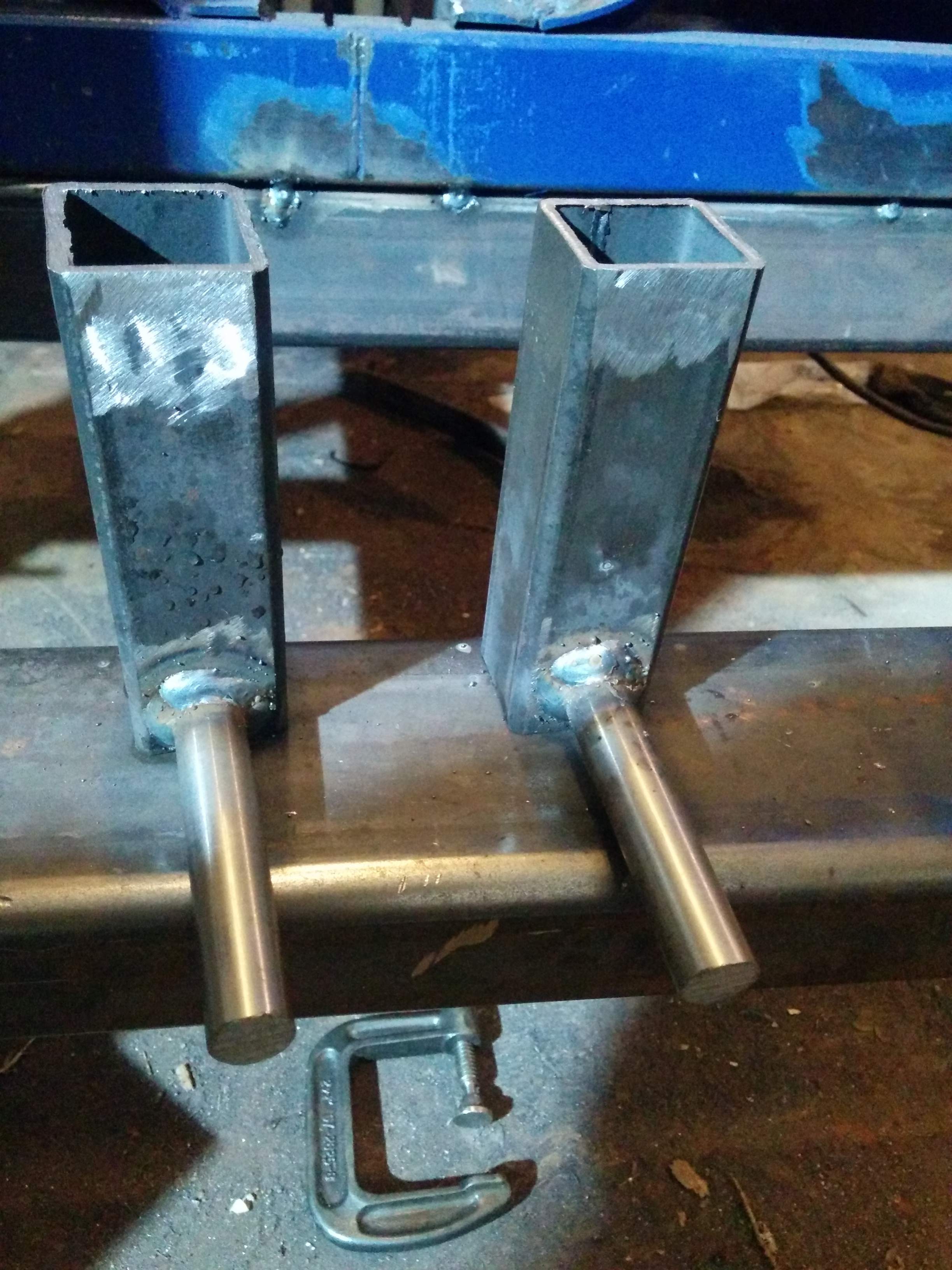

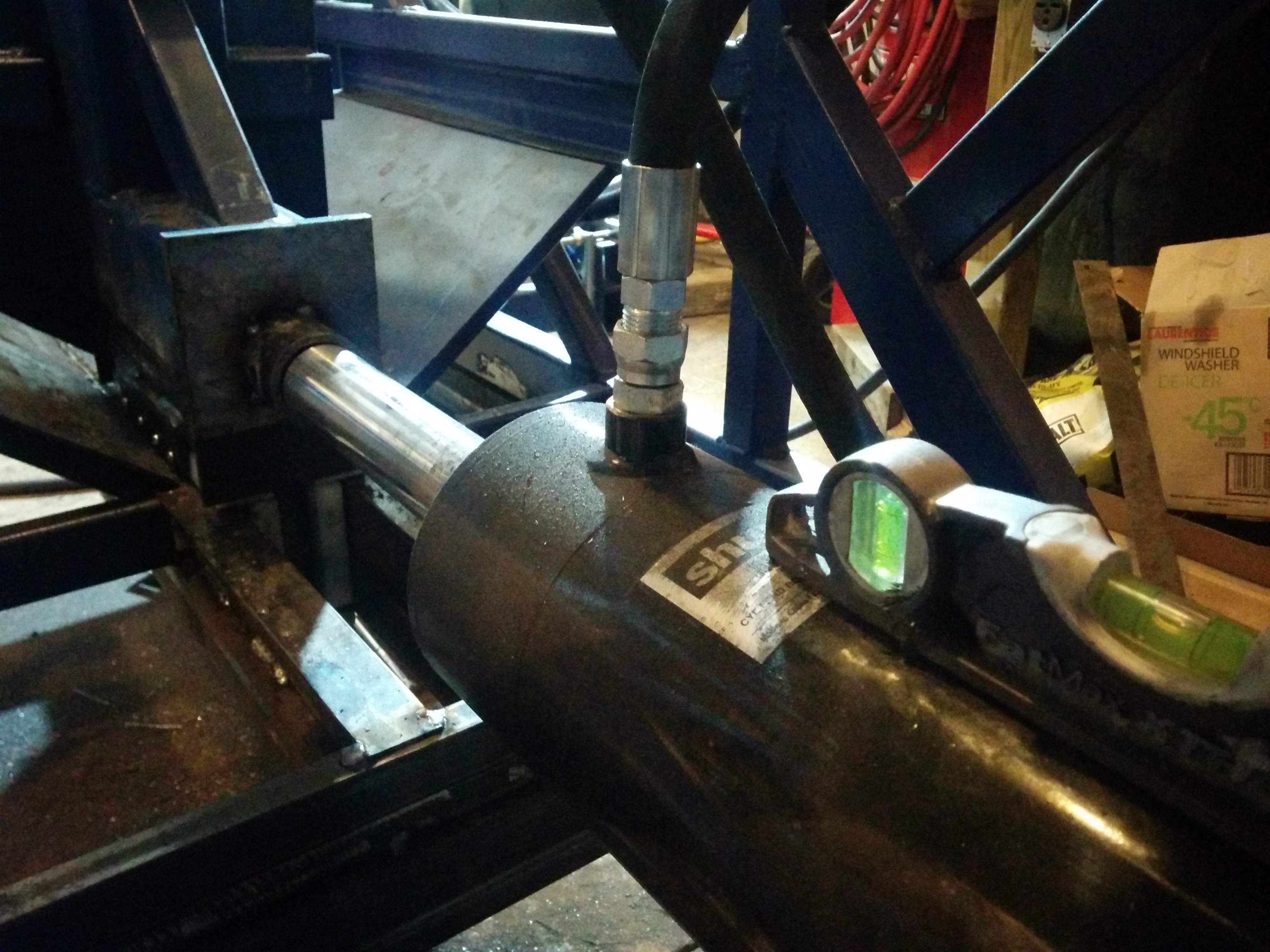

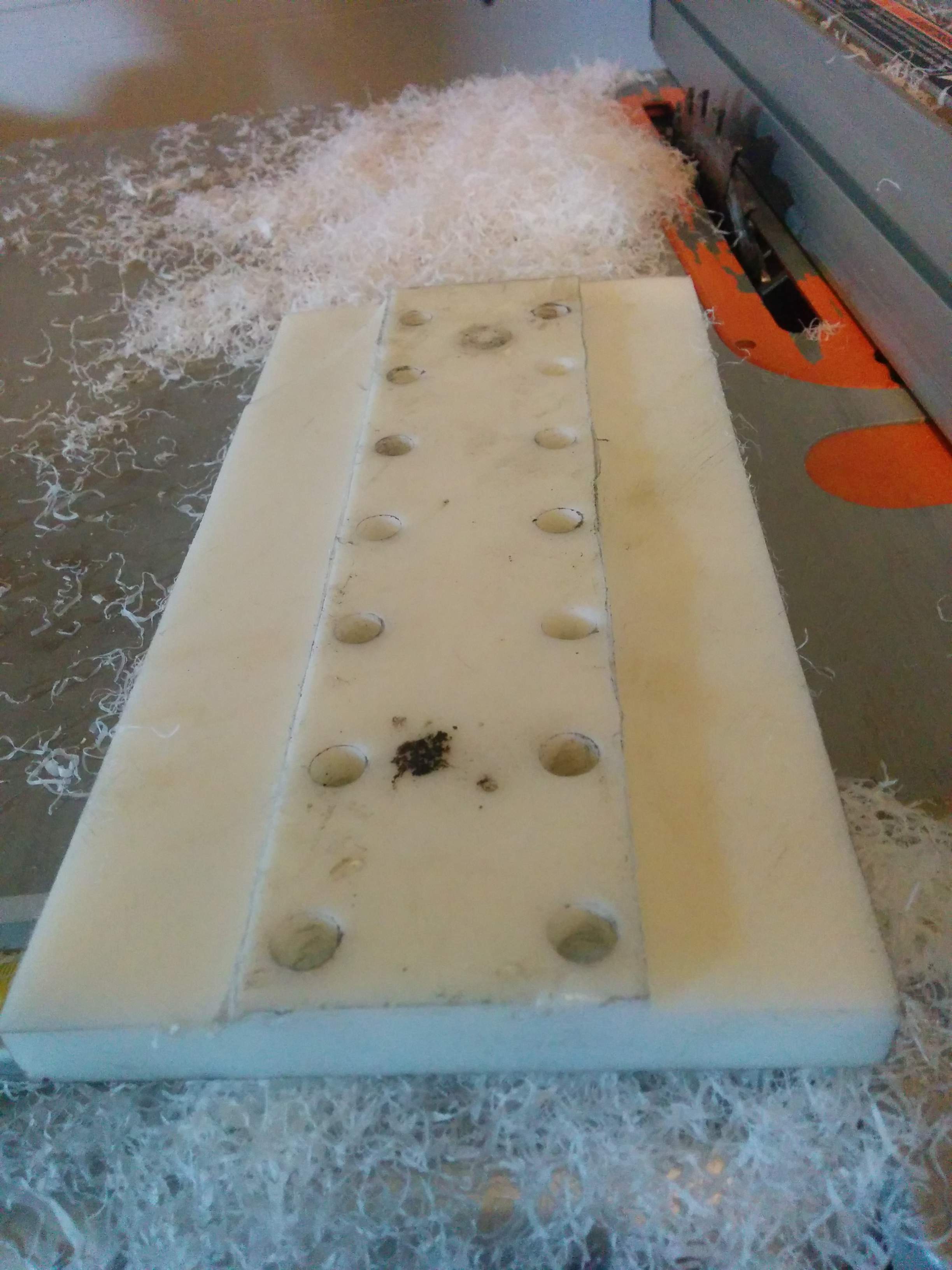

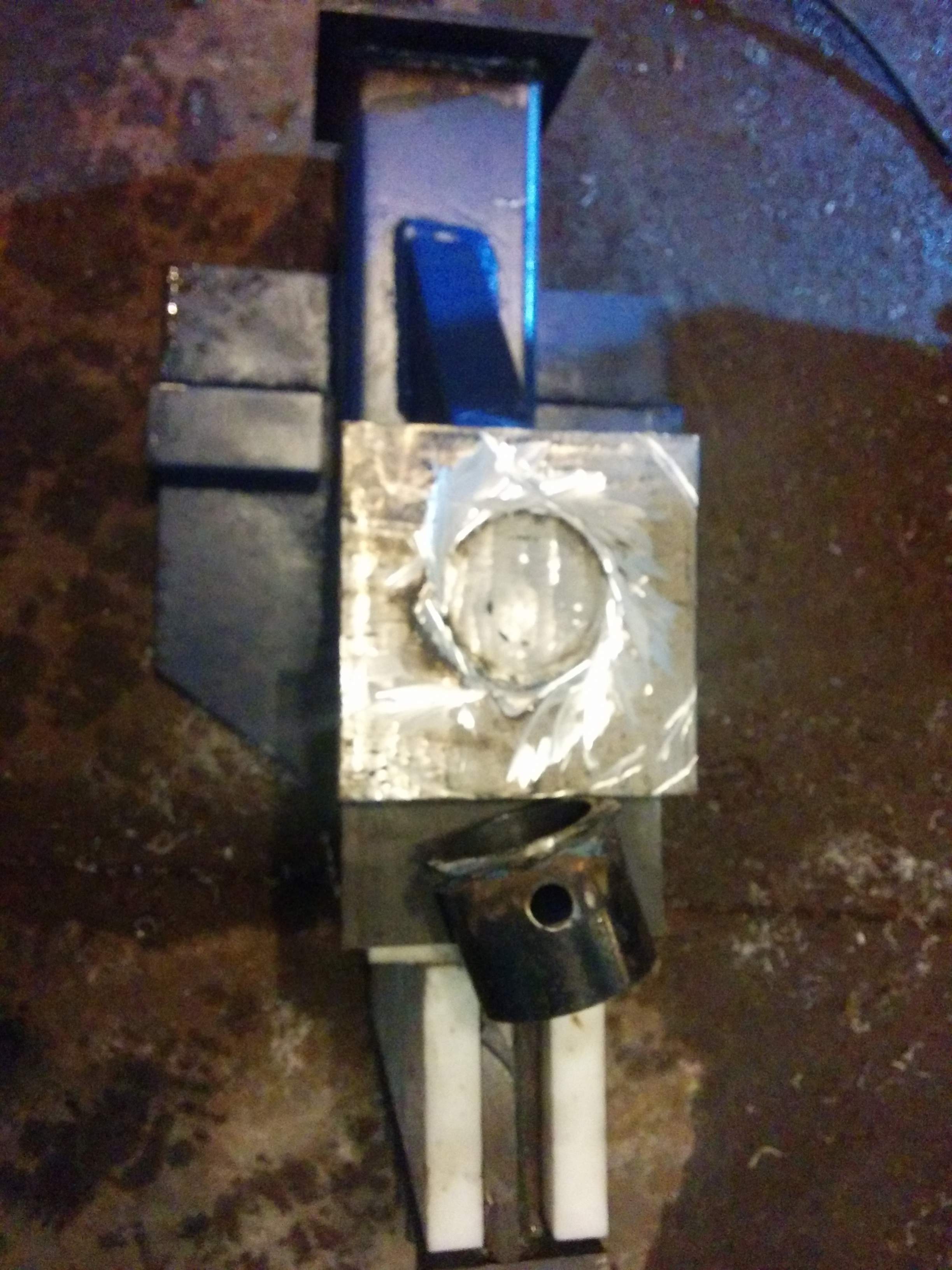

It doesn't look like much, but I'm actually satisfied with last nights progress, and that rarely happens. Like I mentioned before, the cylinder was no longer mounted level with the pusher plate, I goofed by 1" when I rebuilt it. What I failed to mention was that the plastic runner clamped the bottom rails a little too much and acted like a brake pad. So my first task last night was to tear it all apart and fix those two issues. As we've learned from this insanely long thread, I'm not happy until I've done something 3 times, so now I'm happy:laughing:
I cut the cylinder attachment off for the 3rd time!
I removed a little of the plastic to allow the pusher plate to move freely. I wanted about 1/16" to 1/8" of play, I ended up with about 1/8"
I used the processors jacks to level the processor then re-installed the pusher plate. MUCH better!
The only other thing I did last night was re-use the back of the processor frame that I cut away to give more clearance. I cut it to size and added it for bracing to the sides of the slide rails. I don't want the pusher plate to be able to push those rails out if a round gets stuck.

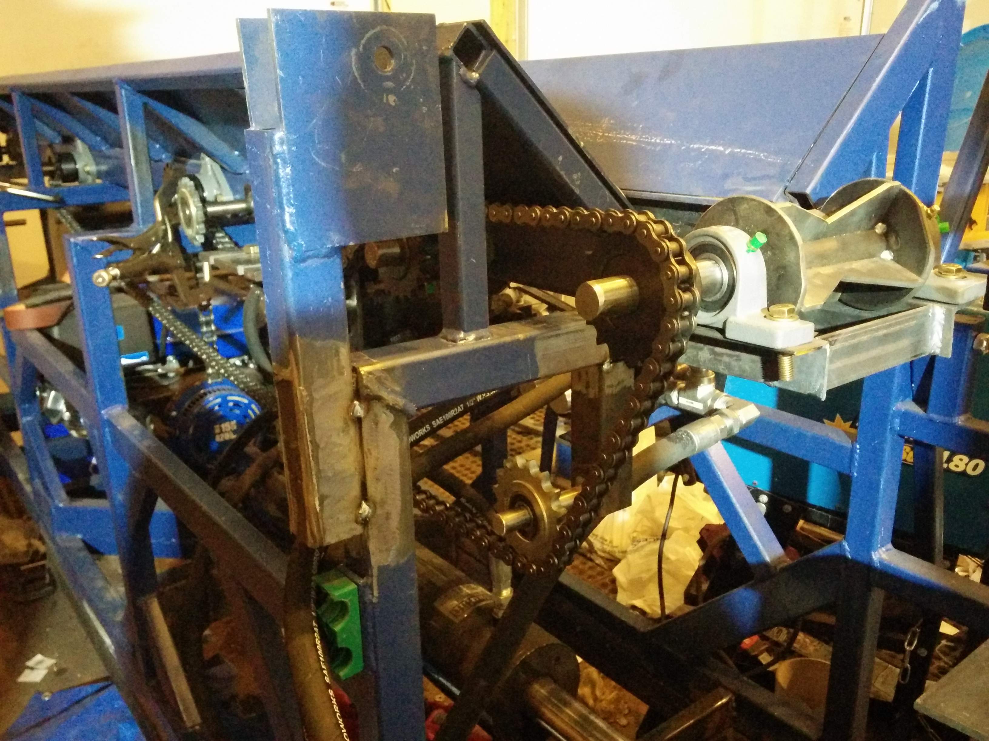

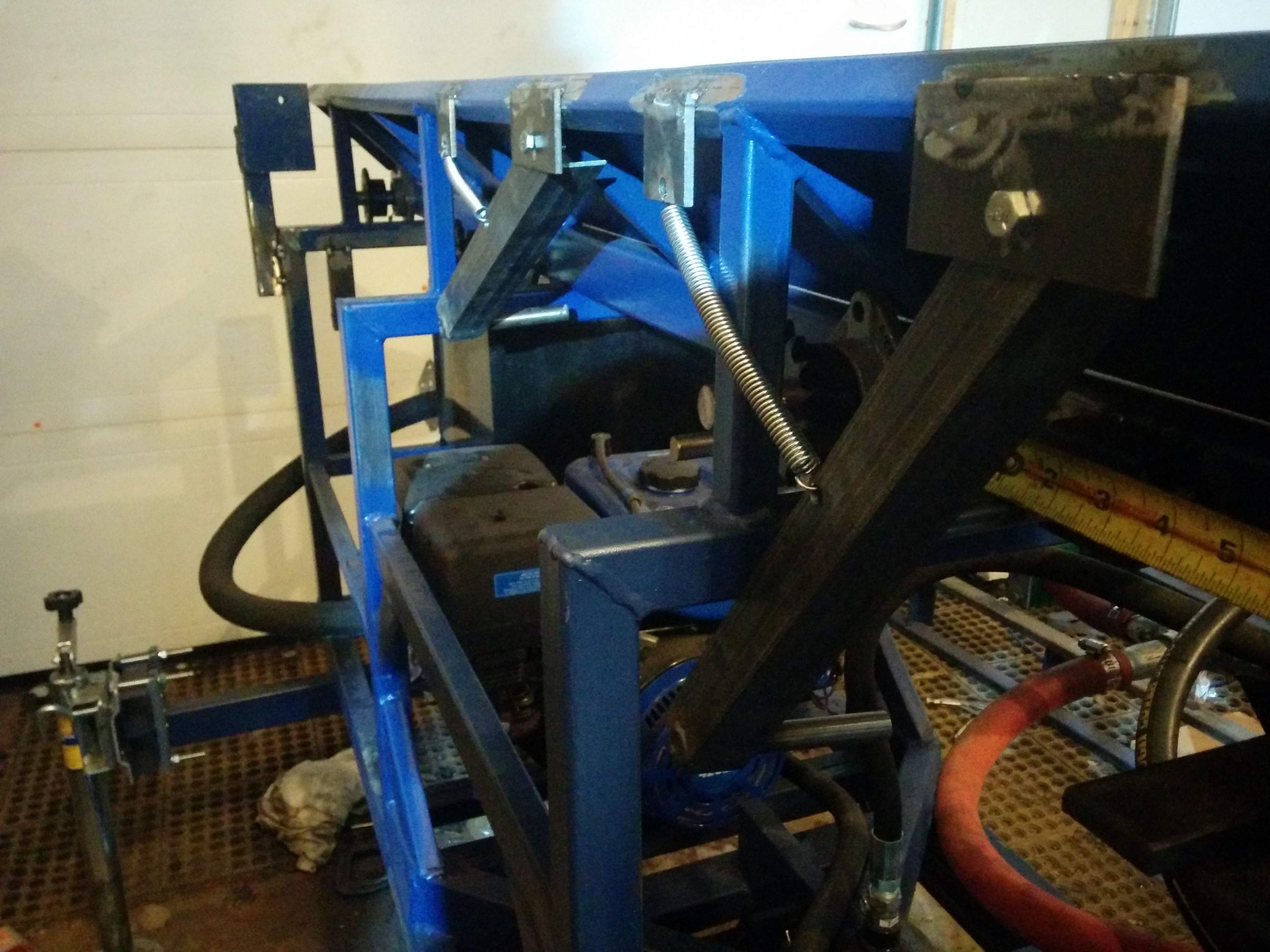

I got the chain drive system done last night... well mostly. That makes me happy, can't say I enjoyed fiddling with it. The problem I still have is getting the hub on the hydraulic motor. The shaft on the motor is 1.25" and the key is 5/16". The hub I have and any that I can find for a 1.25" shaft have a .25" keyway. The only choices I've been given is to bore the hub I have out or by a split key that starts at 5/16 and goes to 1/4. Obviously, boring out my keyway and maintaining the 5/16" key is a better choice, but it's expensive and I'm kind of sick of spending money on this. I can also get the other key quickly and boring out my hub will take a week. Once that's done, I can position the chain properly and install the chain.
First I needed to build a bracket for an idler sprocket to drop the chain down for the return
The idler sprockets installed and the completed chain path. You can also see the brackets I cleaned up and re-installed for the log deck.

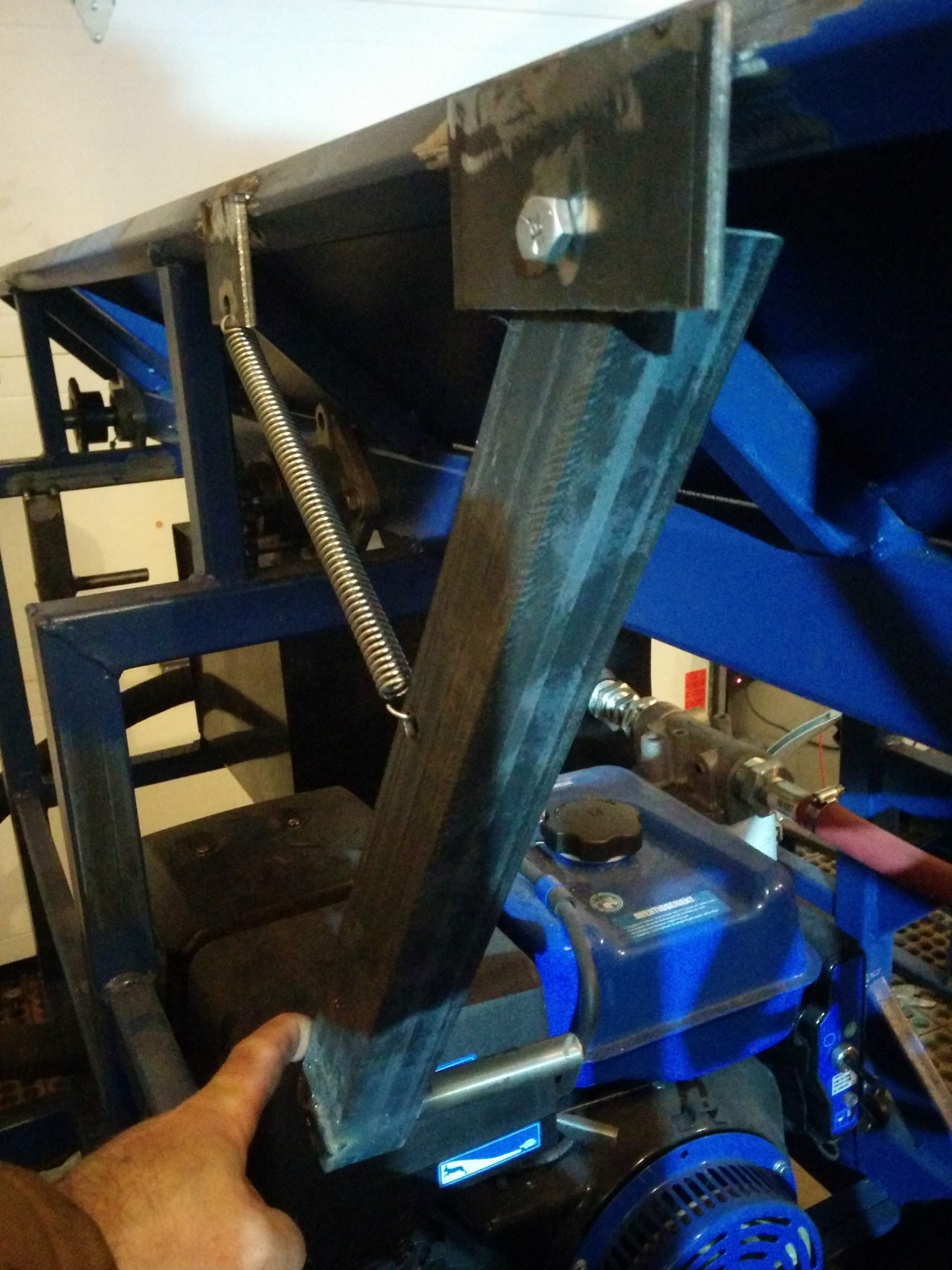

Finally, I built some tensioner arms to keep the chain tight and off the engine. I'll attach idler sprockets to each.

They say they won't have it ready till next week. They also say it's $100 to broach my $8 hub. Why complain about $100 at this point? It seems excessive to me.

That does seem outrageous to me. Honestly I've never done it nor had it done but I would really expect $20 (give or take) and 15 minutes... maybe a more on the time if yhey are busy. Have you shopped around at all?

I just spent the last 30 minutes calling every machine shop around me and they all say they can't do it. I can switch out the key with a combination key for $30 which also seems really pricey for a key. My only problem there is I haven't been able to remove the existing key from the motor. The hydraulic shop I bought if from assures me it's not pressed in, but for the life of me, I can't get it free.
