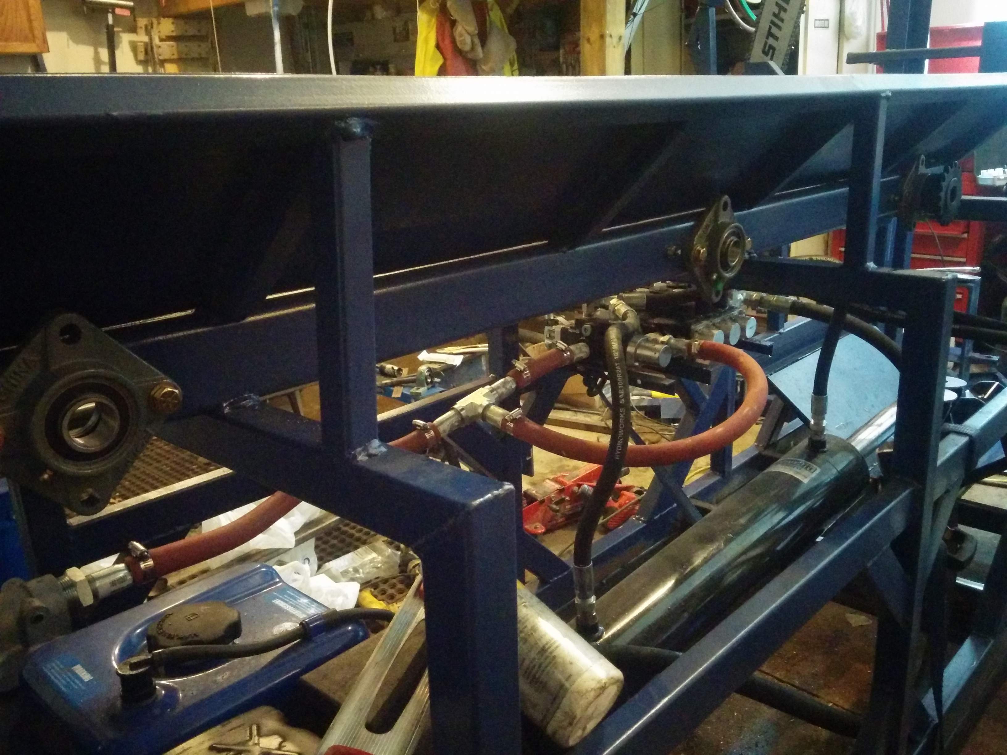

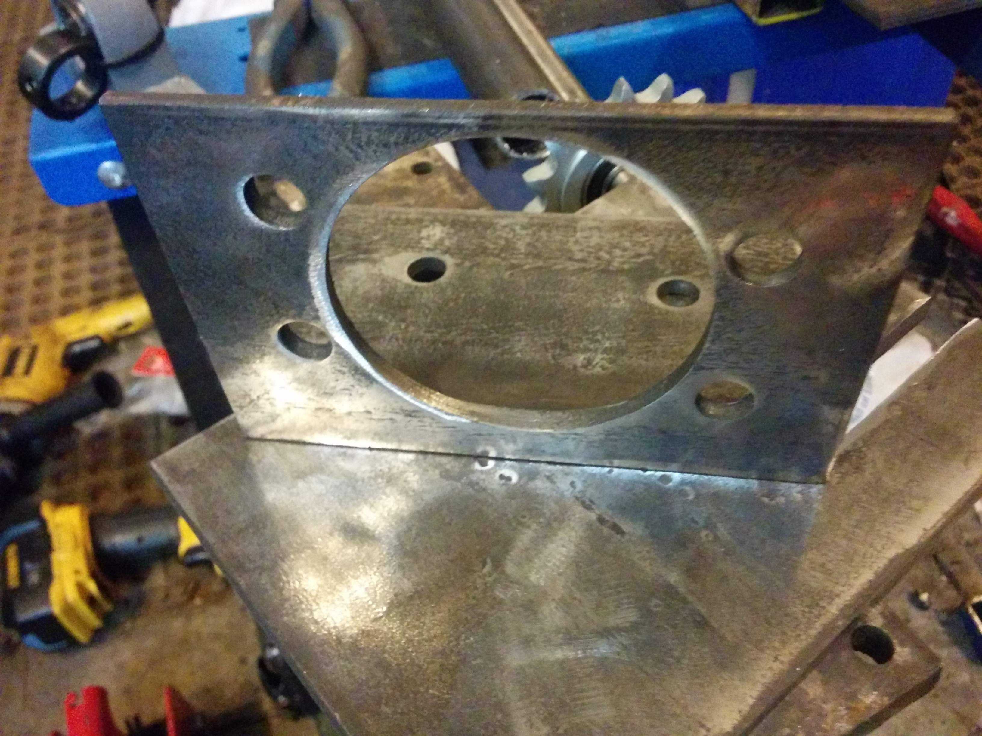

More cutting holes with a hole saw, this time for the flange bearings. I obviously couldn't use the drill press, so I went at it with a hand held drill with brand new hole saw. Unfortunately, I only have one corded drill and it is way too fast. I ended up fighting all Monday night and only got 3 holes drilled. Only 1 and 1/2 of those holes was using my corded drill, I finally decided to try a cordless drill and switched to the hole saw I'd drilled a bunch of holes with already. I finished the 1/2 cut of the second hole in a minute and did the 3rd hole is 3 or 4 minutes. Unfortunately, by then it was really late and I killed the battery on the drill and 3 holes was all I got done. The higher rpm drill destroyed the hole saw in seconds and it completely stopped cutting before it would cut 2 holes in 3/16" mild steel where the hole saw used at a lower RPM (exact same brand, I bought them together) cut the remaining 5 holes after having cut dozens of holes in material up to 1/2". I used generous amounts of cutting oil with both.
Last night I went out and finished up the holes. I had both batteries charged up and ready to go. I got through 2 more before having to switch batteries and then by the end of the next 2, the drill started smoking and was almost too hot to touch! I relented and gave the poor thing a break while the batteries charged again. By the end of the night, all 8 holes were cut, the flange bearings installed and the first roller roughed in so I can do some more figuring. Still need to decide how to mount the hydraulic motor and I'll have to use my idler sprockets to clear the trough supports. I was hoping the chain would pass over and under the supports, but no luck and I had no options with the placement of the flange bearings.
I'm only using 2 out of 4 bolts for the bearings. They're 3/8" grade 8 bolts. I think that's fine and I'm not going to bother mounting a piece of angle under the bearing for a 3rd bolt as I originally planned.
Here's where it stands now.

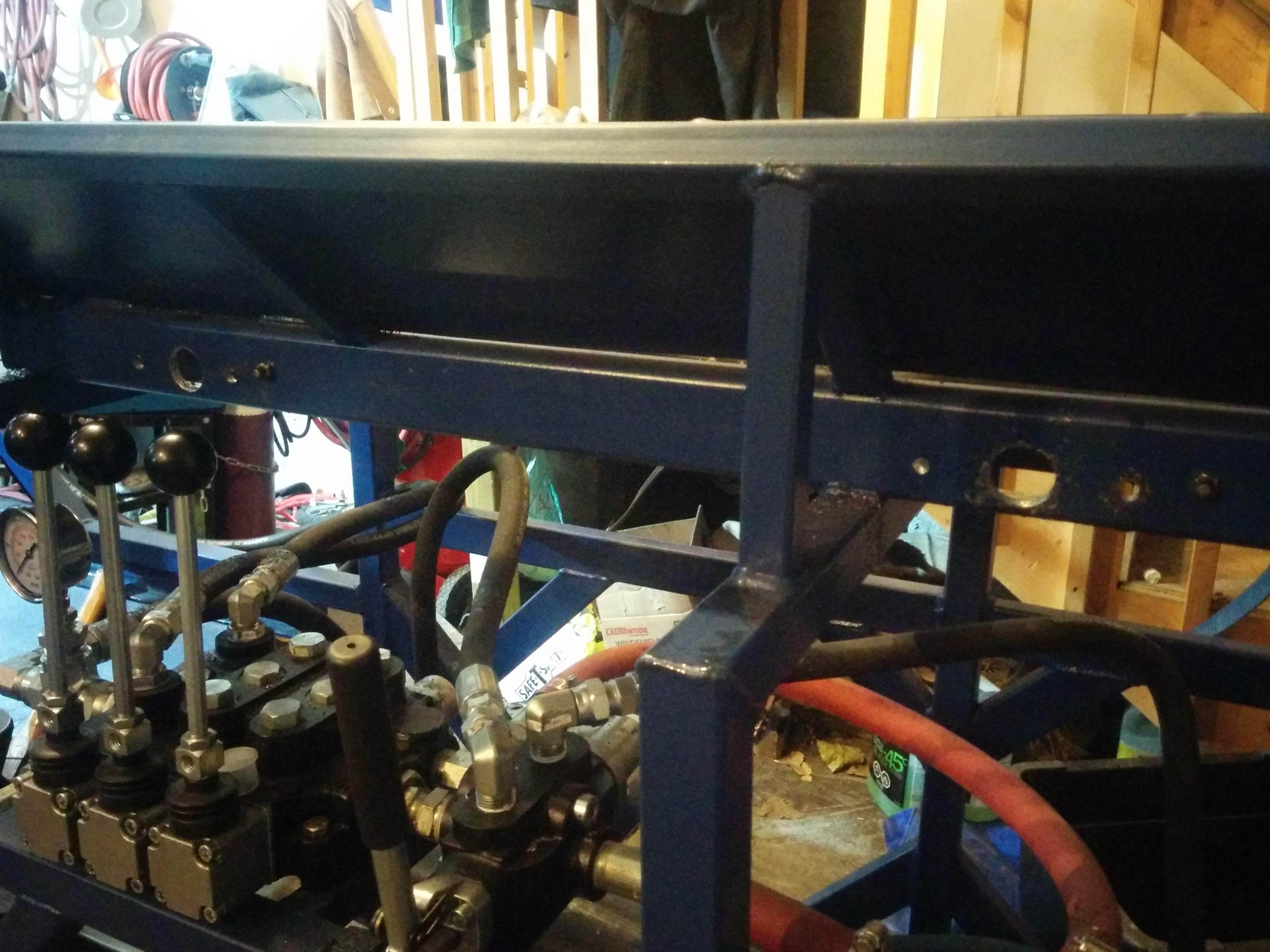

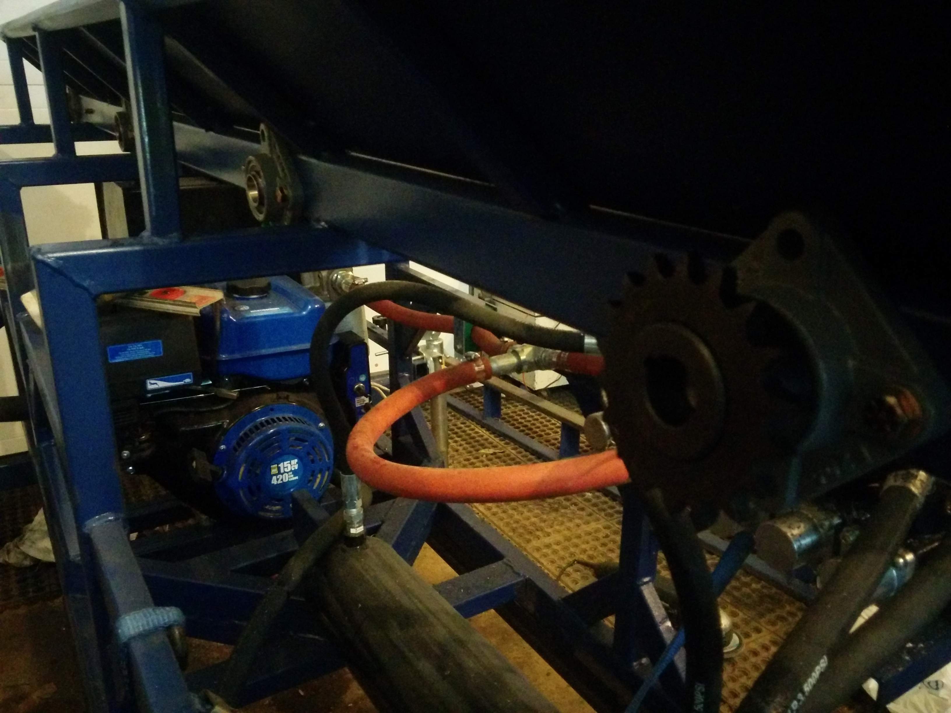

I'm disappointed and getting frustrated, no video to show this morning and my car was out all night in the beautiful -26C (-40C with wind), it was really happy to get going this morning! I made some progress this weekend, but my plans to have it finished by Sunday night fell short.

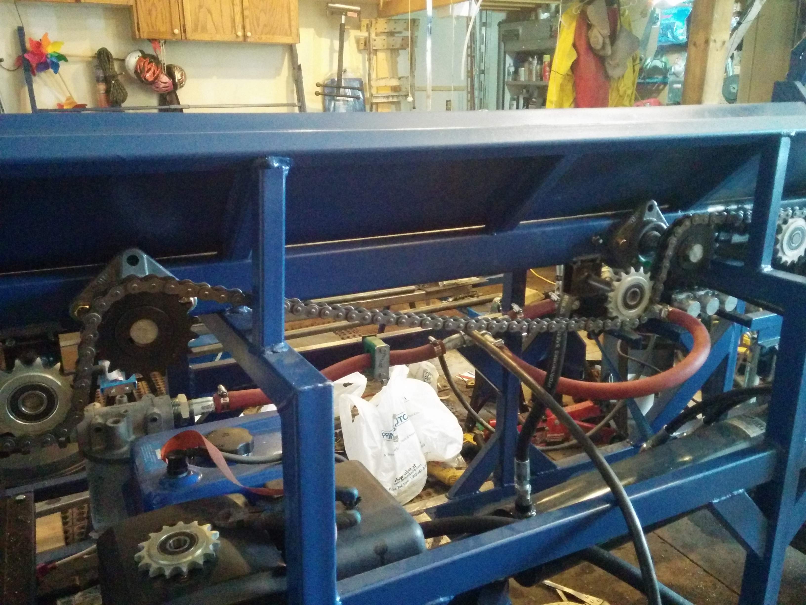

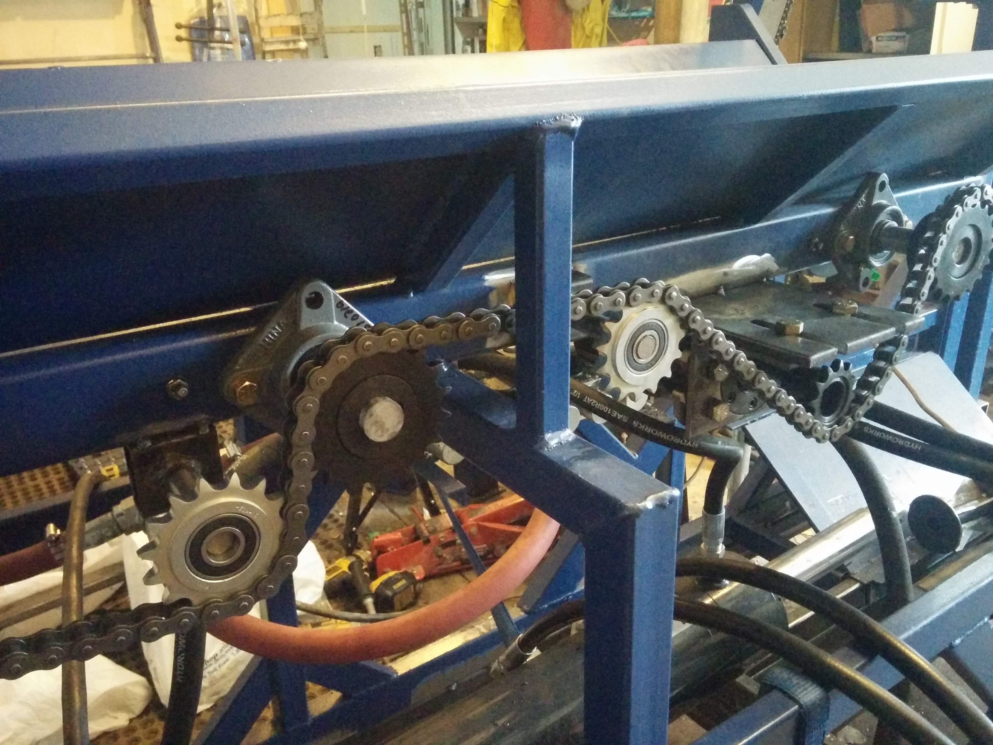

Started off installing the rollers and building the chain system for them. There are now 4 out of 5 rollers installed.

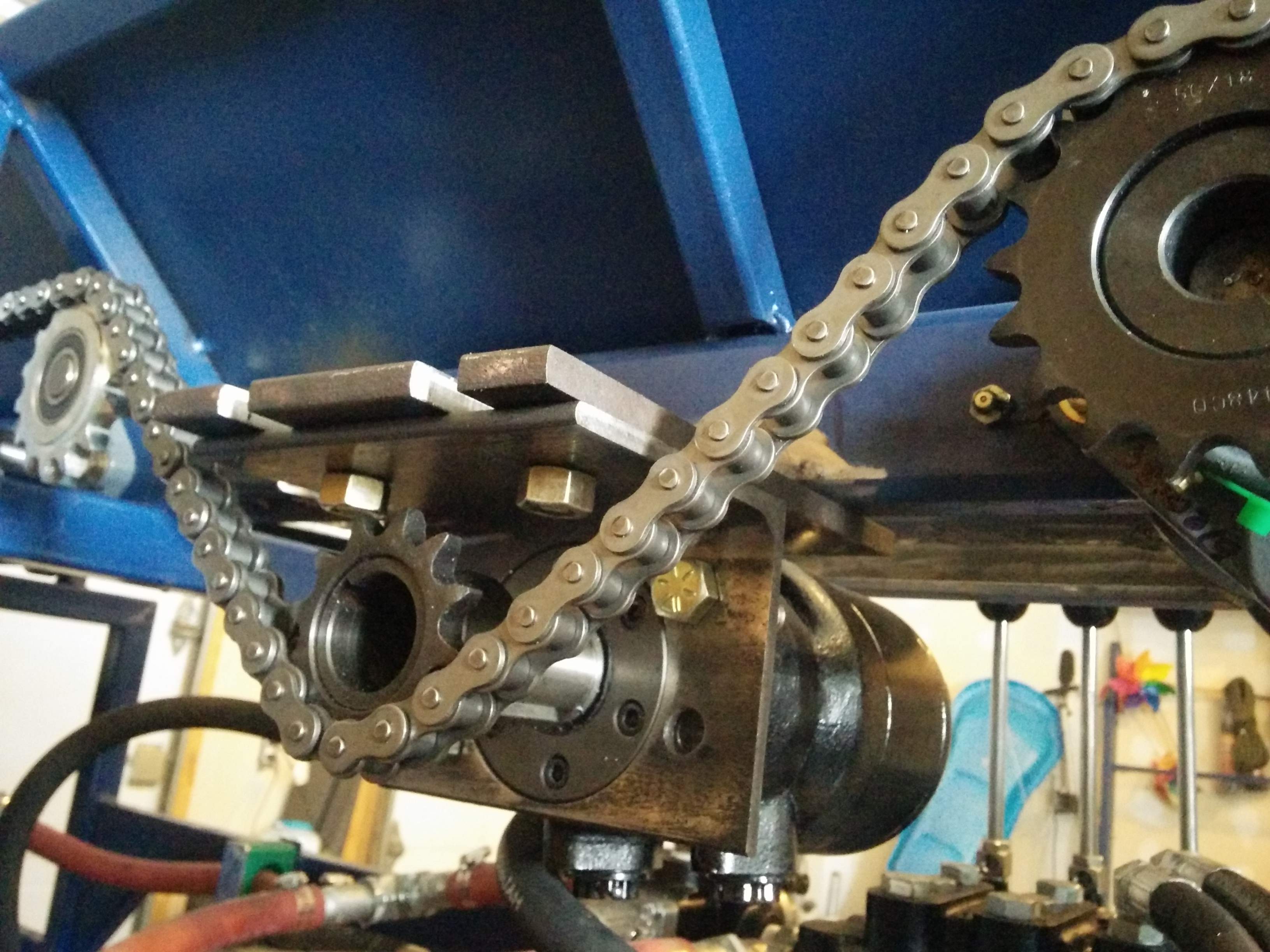

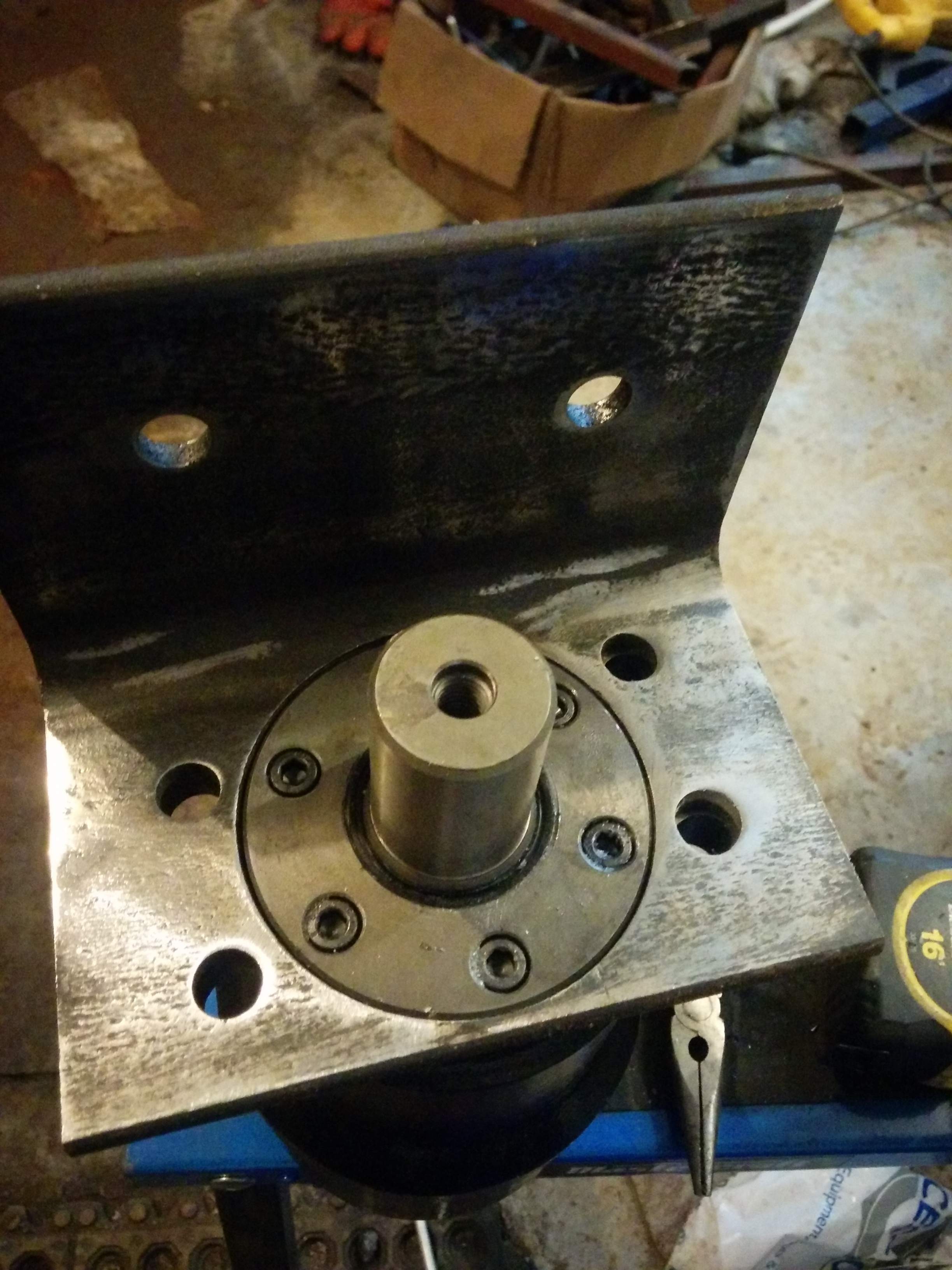

Next, I built a bracket to hold the hydraulic motor. I also made a little plate to allow for adjustment when installing the motor.
Finally, I figured out how to run the chain. Once I add a little extension in front of the trough, I'll be able to install the last roller. I'll then finish the chain system with two idler sprockets to get the chain low enough on the return and add two tensioning idler sprockets to keep the whole mess tight.

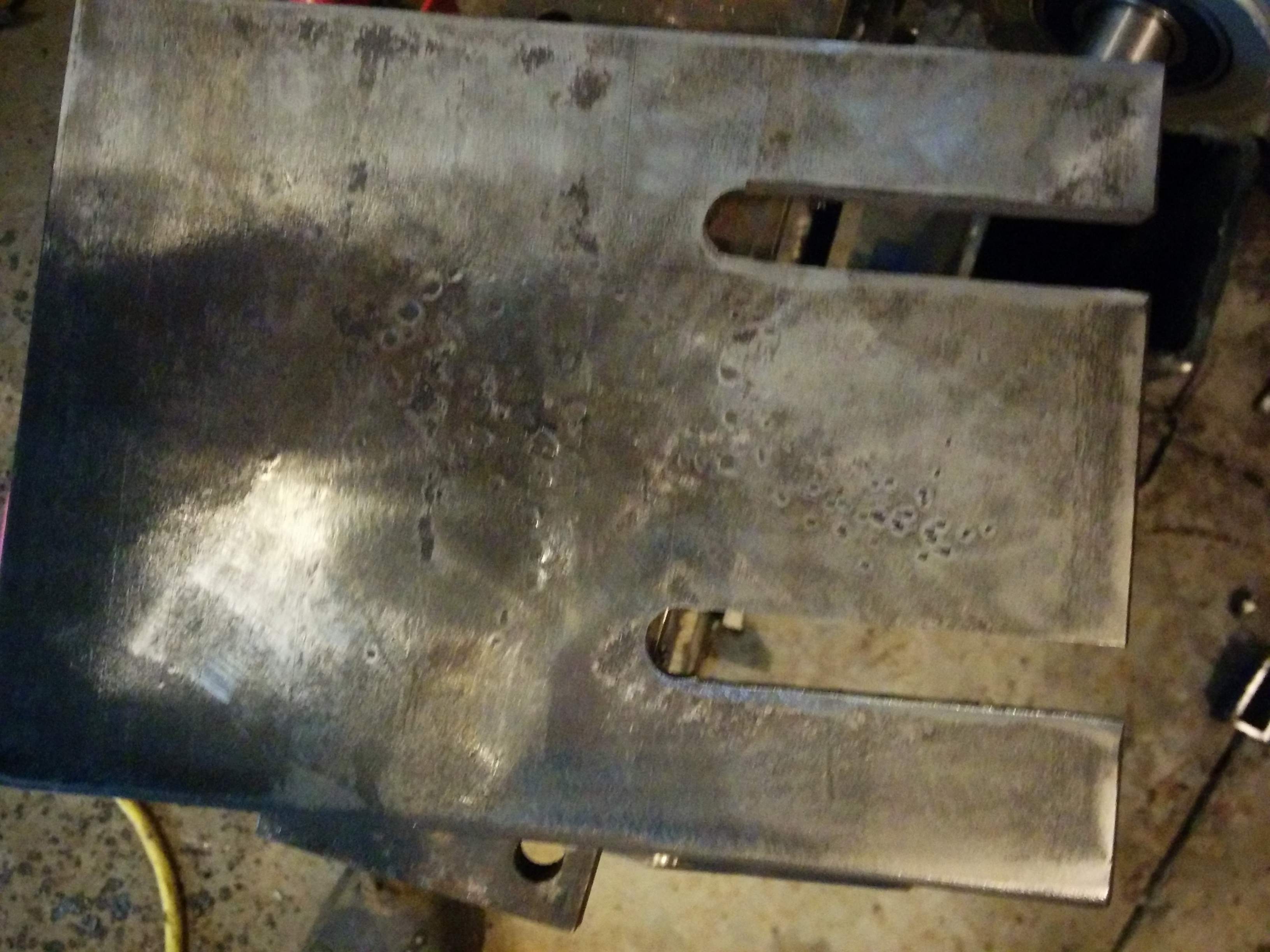

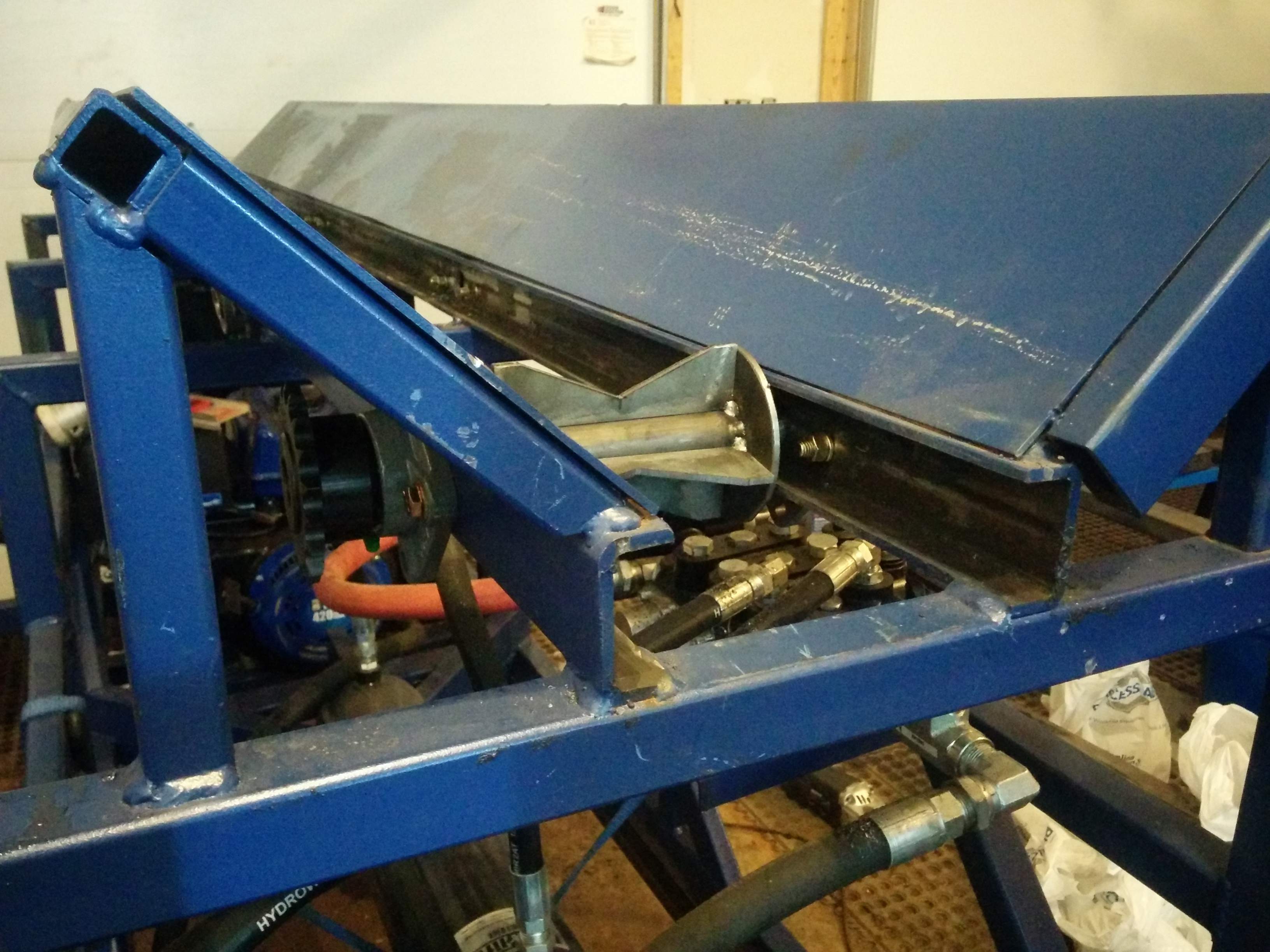

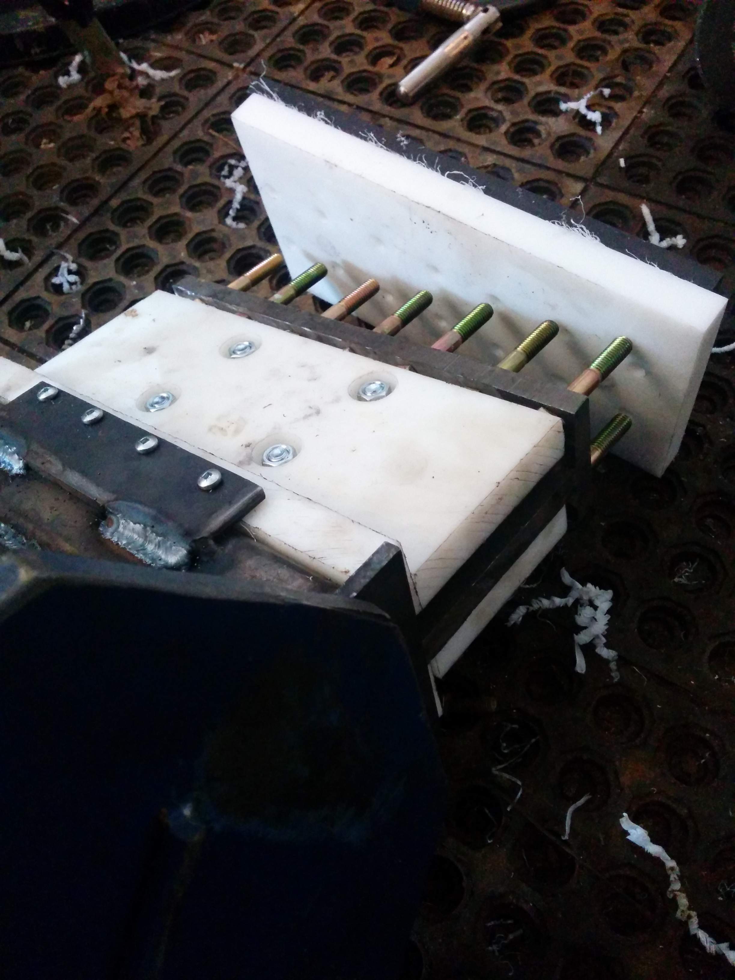

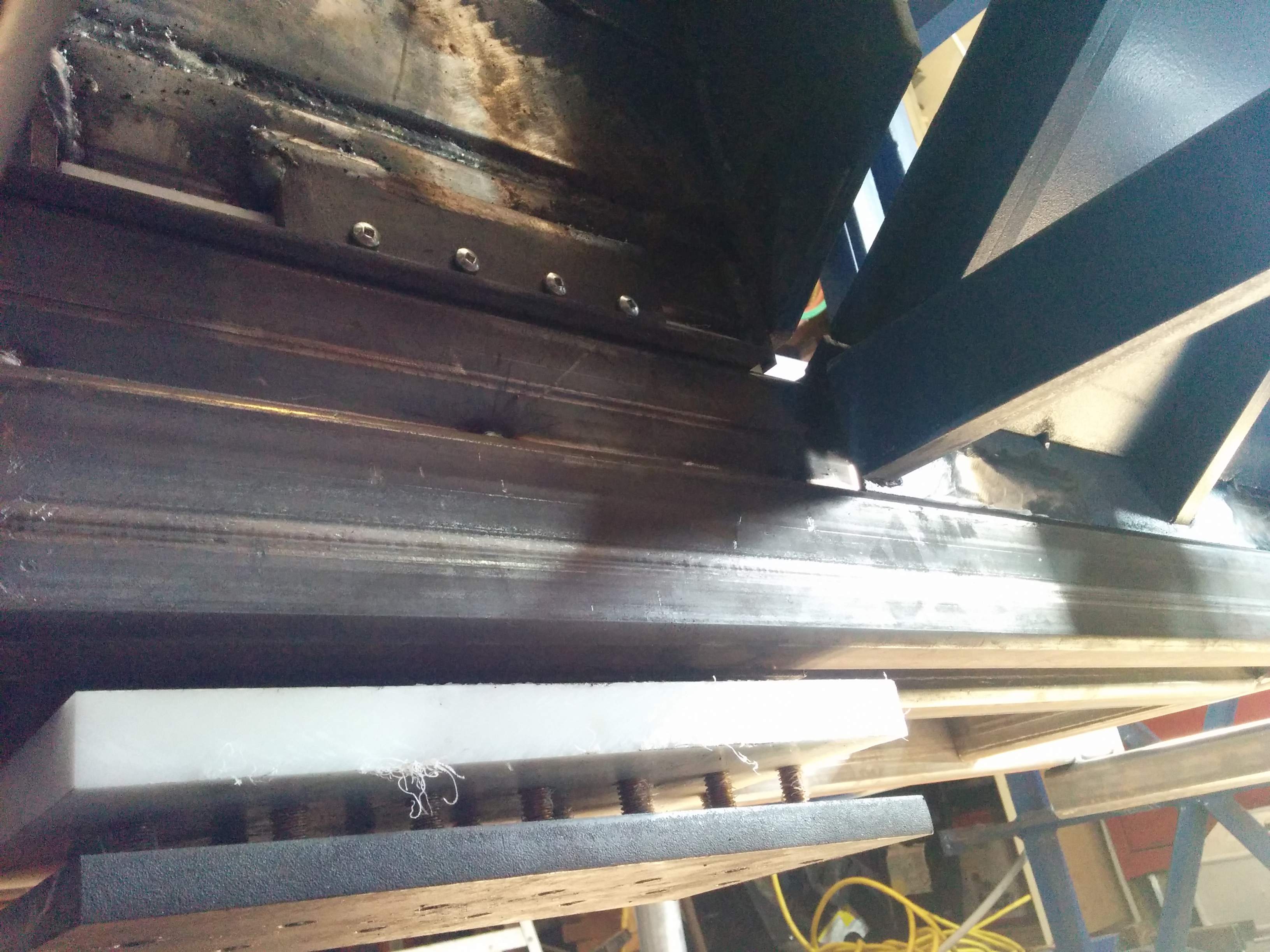

...I then got sick of farting around with the chain system since I was doing way too much thinking (who thinks on the weekend!). I decided it was time to get the pusher plate and cylinder back together. I also wanted to do more bracing.

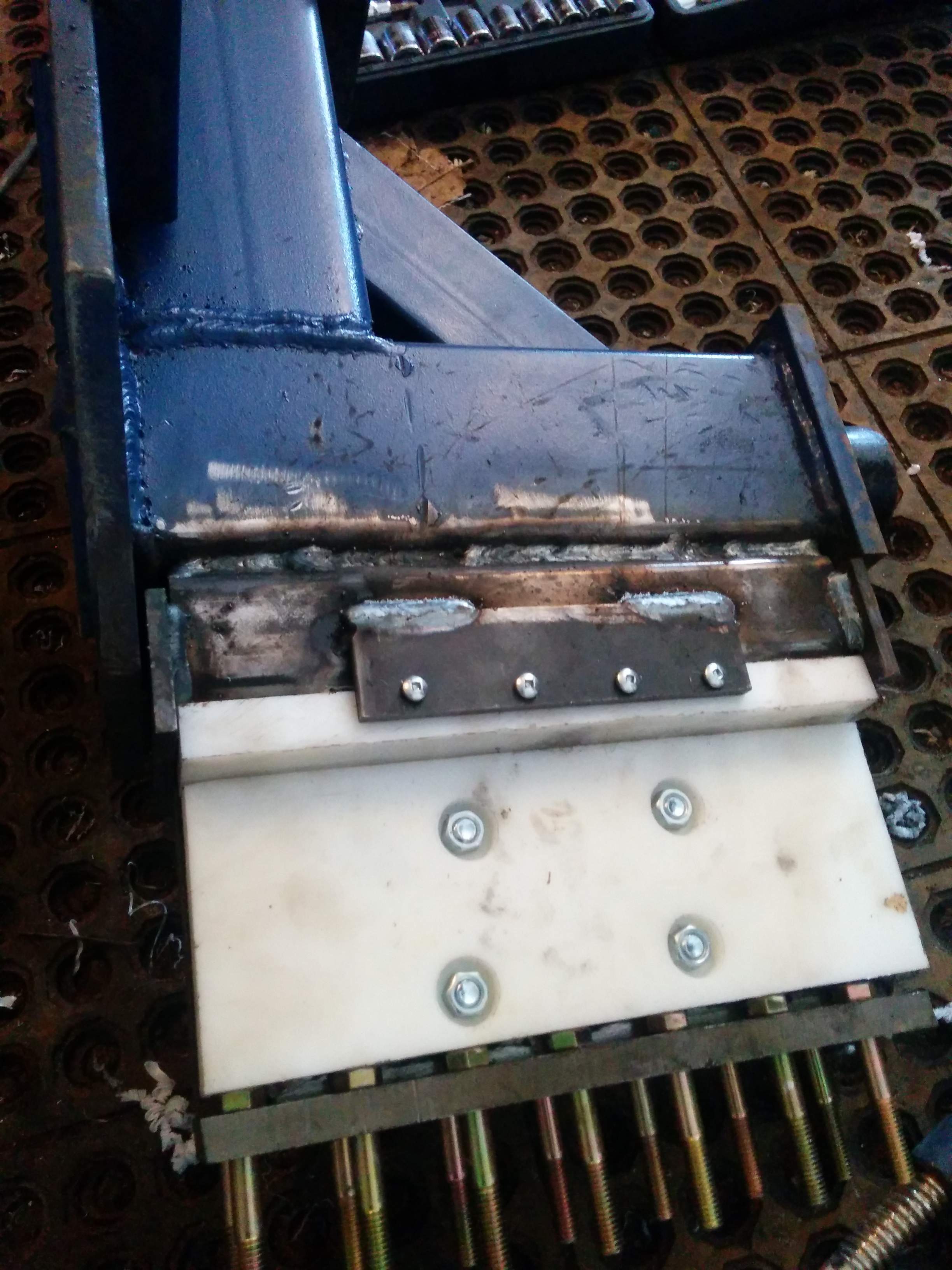

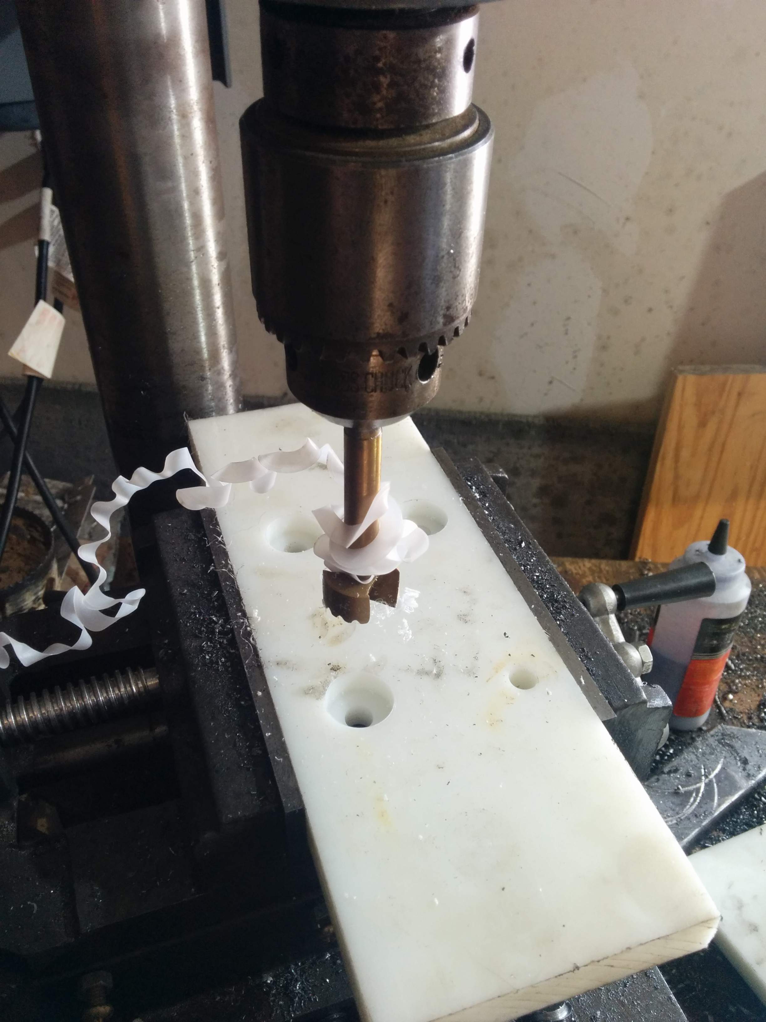

Pulled out the plastic (nylon, teflon... not really sure)
All contact surfaces got covered.

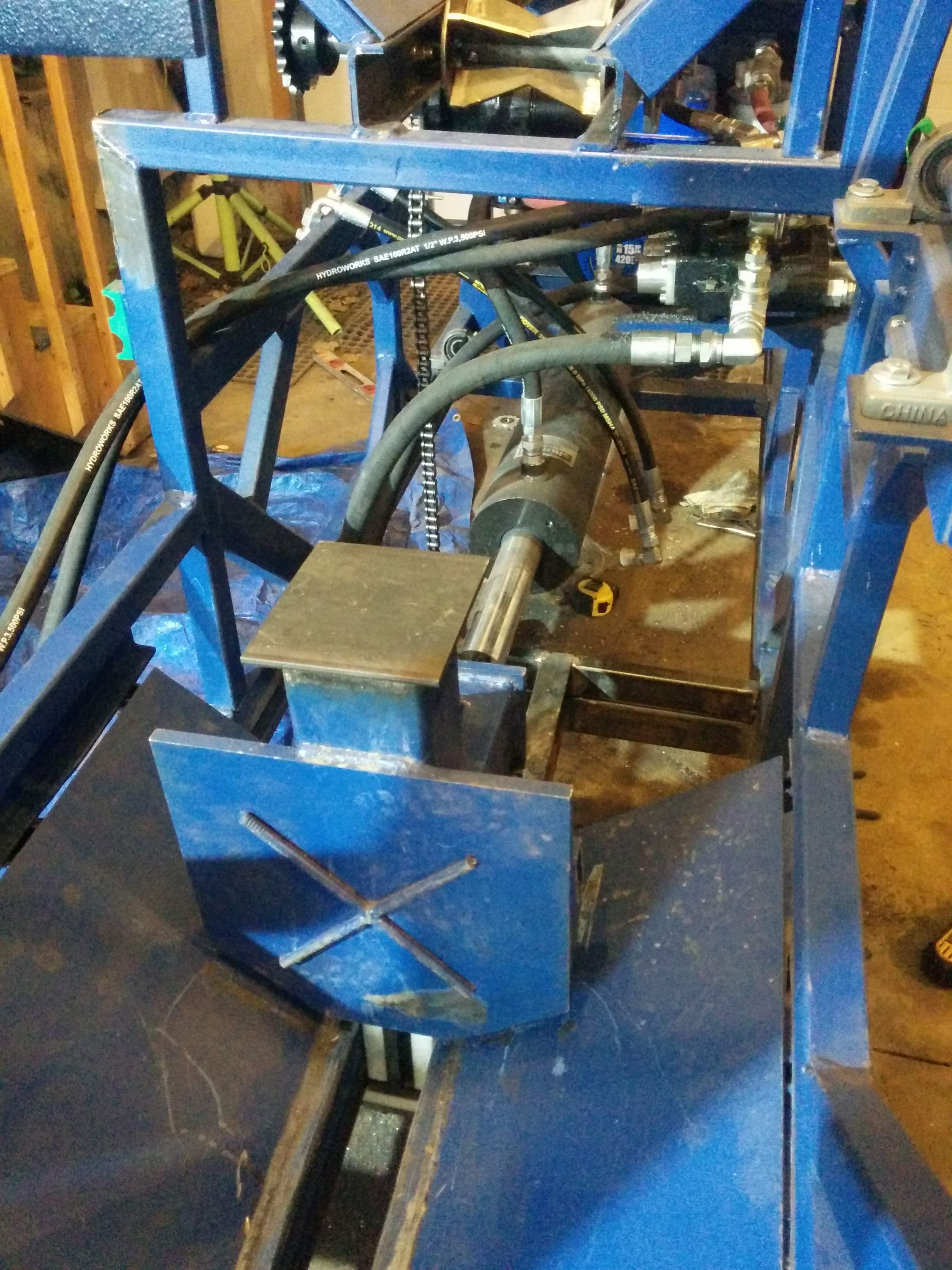

The whole thing together. Unfortunately, I let my guard down and didn't keep an eye on the angle of the cylinder. It's off by 1" so the cylinder is pushing on an angle. I'll have to take the pusher plate off again, cut off the attachment point and lower it by an inch. PITA, but it needs to be straight.

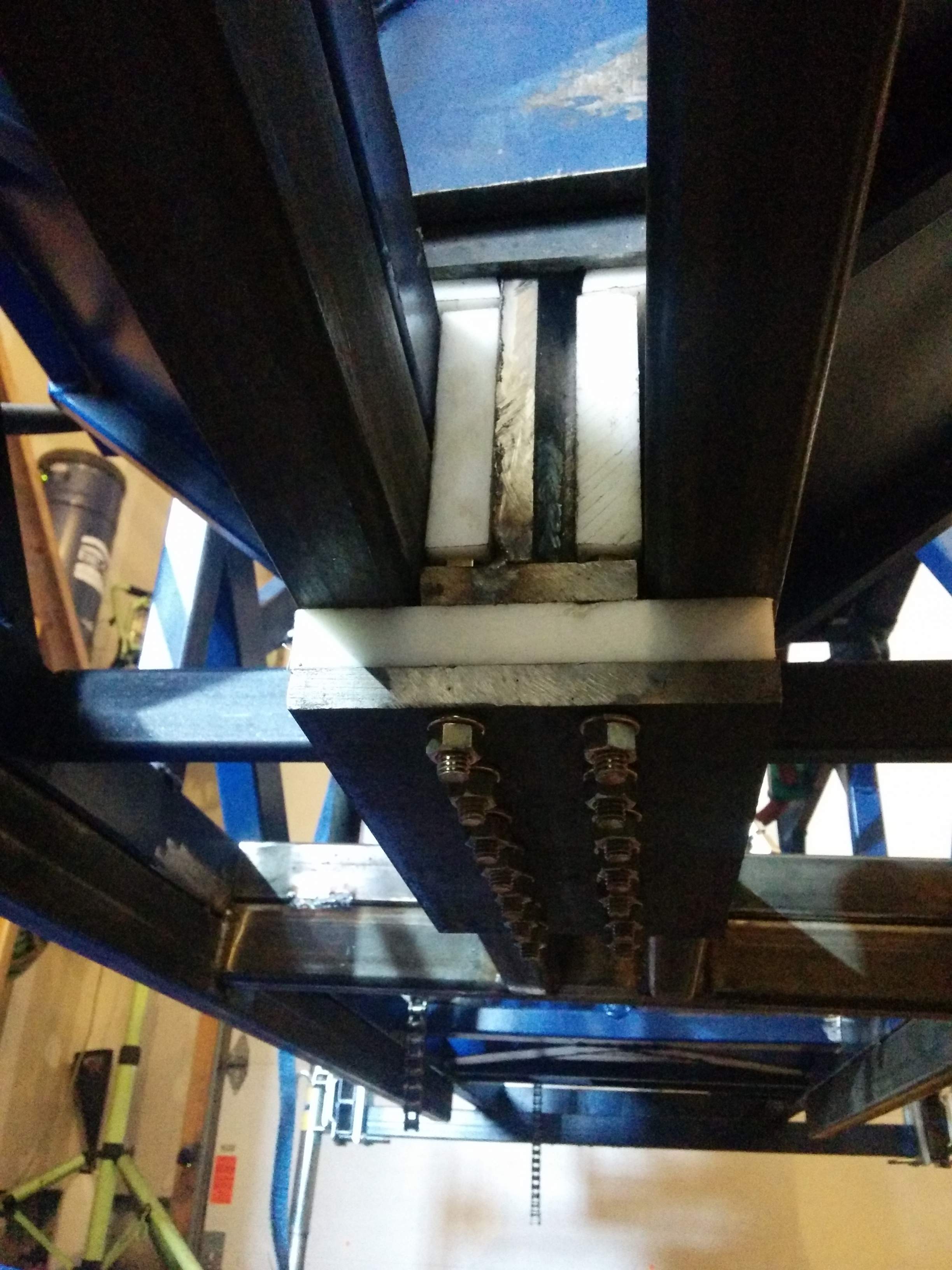

Finally, I added some more bracing to the attachment point of the cylinder. Yes, this is an absurd way of building this, I should have just started with an I beam, but I didn't, so I'm adding more bracing. The new cross member is 1.5" X 2.5" - 3/16 and it's braced using 2" X 4". I really hope all of this bracing adds up to being strong enough, it is now my biggest concern.
