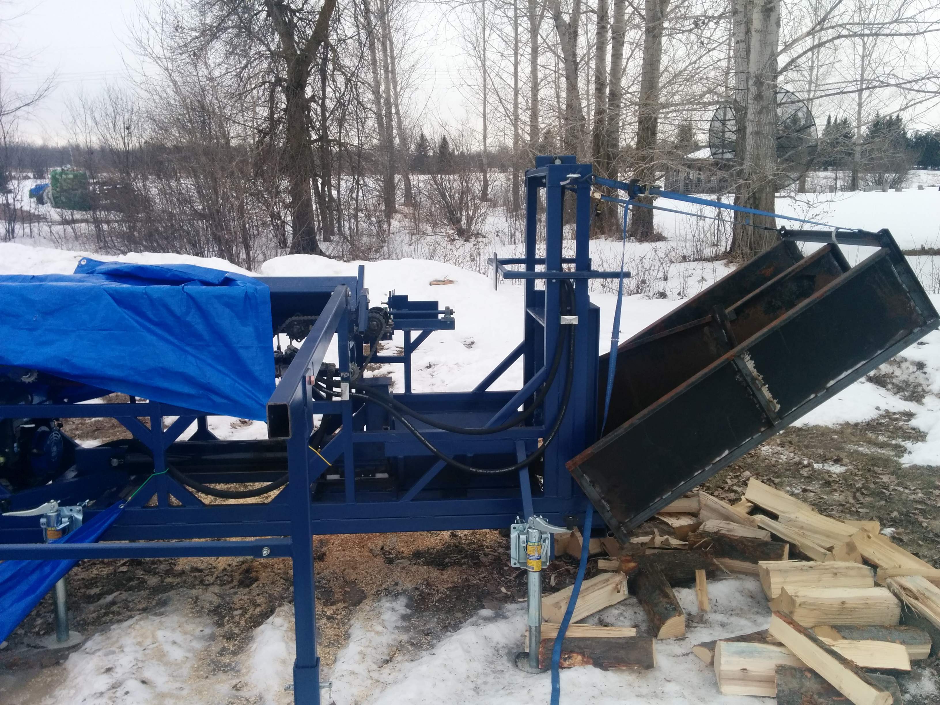

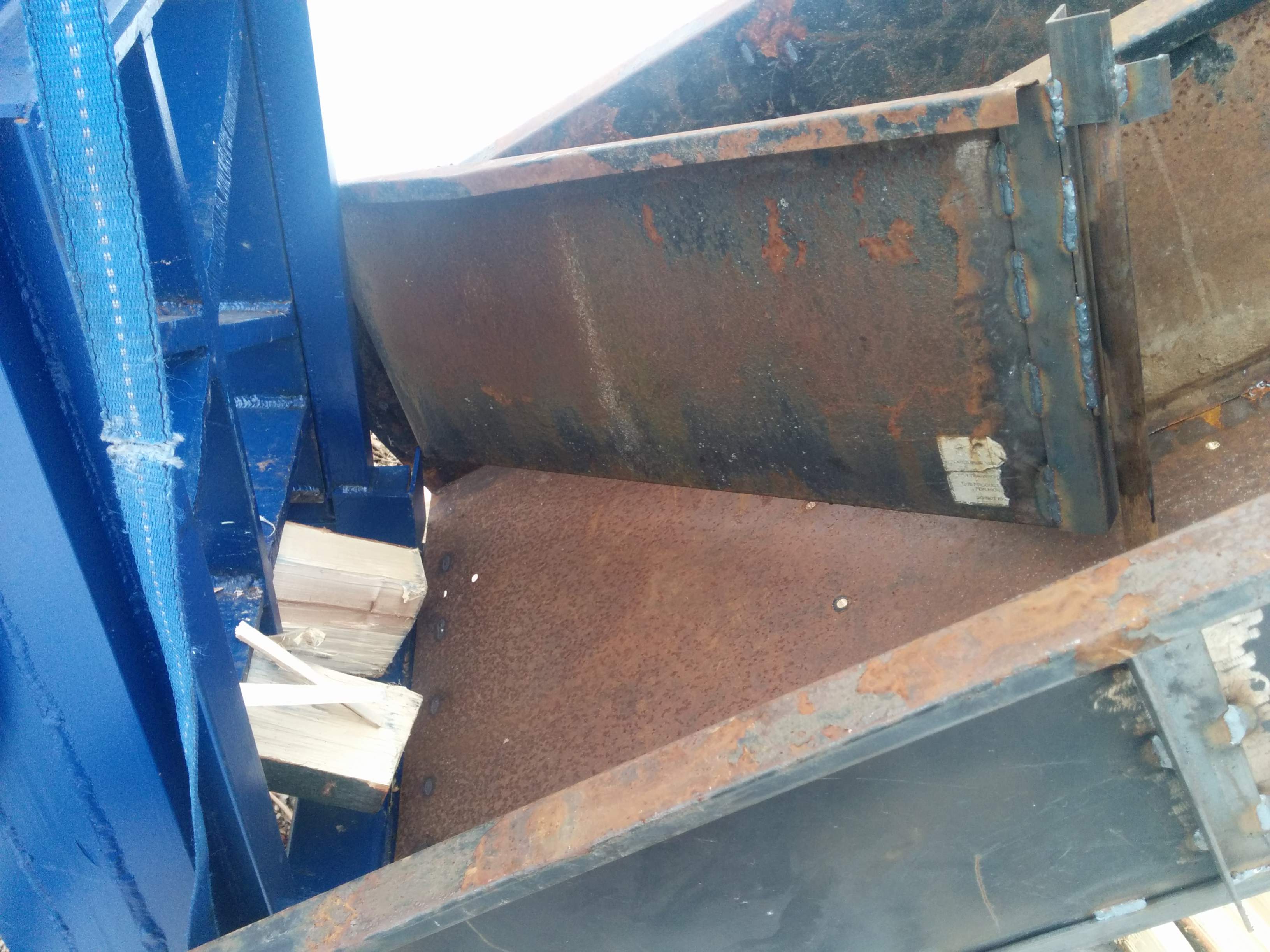

Well, the dump trailer/chute conversion is an epic fail! Way too steep to get to the height needed to empty into a bag even with the processor raise pretty much to it's full height. The flap doesn't fit with it on that angle and the wood would come out of the processor and be driven into the bottom of the chute far too hard. I need to give it a 4' extension. Not sure if I'll go buy yet again more steel or if I'll just make something out of plywood for now.
/ Firewood processor build thread #344
Looks like you could use a 30" piece of steel with a slight radius formed into it. Like a 30" section of a 6' diameter tank...OR SO. (I haven't taken the time to draw it out to scale). Place it between the processor and your ramp. That would provide a transition from your horizontal to the angle, plus the angle would decrease since you would be adding length. Not sure how that would impact your flap design.
/ Firewood processor build thread #345
I would tend to agree, I think you'd want at least 24" that is pretty much flat before you try to force it up the chute.
Also wondering if taking the rust down and putting a nice gloss coat of paint on there would help to reduce friction and binding.

Im not sure on your diverter idea. Its in a place where it can see considerable force. Trying to push splits up an incline is a hard thing to do. I did this with mine and its never worked all that right. I got the idea from the Wallenstein processors. Splits go all over the place and jam. And my incline isnt that steep, maybe 20* if that. Im going to rework it. mine needs to be deeper and tighter to keep the splits on the right path. Im not sure on the flat section either (I got a flat on mine). The best solution is an outfeed conveyor, it pulls the splits away from the machine and piles them right after the wedge. I just missed out on one for $500 last spring. Im still watching.
If you went with a conveyor, your diverter idea could work fine, just remove the center and use it after the conveyor when the splits are falling, similar to this:
