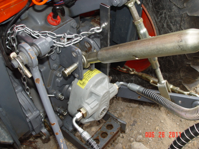

If you put that pump on a gear box and if it is geared right you can run your tractor at a lower RPM and still get 540 RPM. What GPM pump do you plan on using

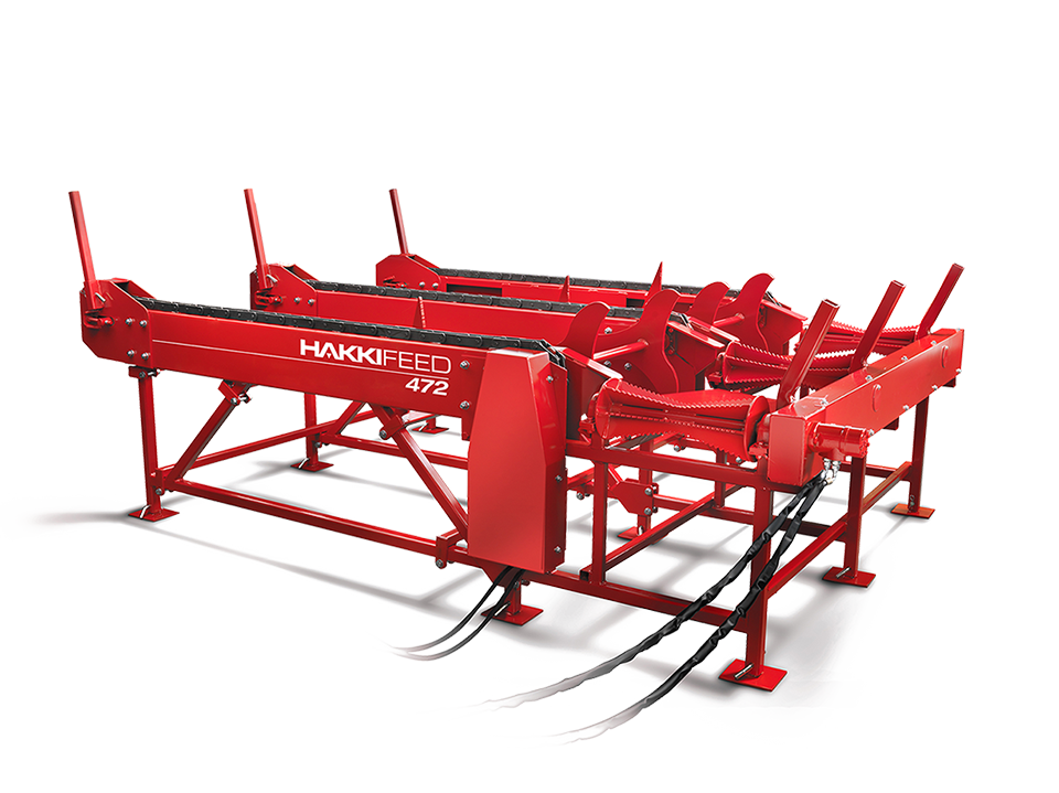

I have mainly maple, ash and beech. I would like to process 200 face cord per year.
My budget is 7000 Canadian dollar. I need to purchase almost everything.
I want to have a log table infeed, something like this:
Theses models are driving by the PTO of the tractor.

Because they do not run the tractor wide open to get the output from the pump. A tractor does not turn at 540 RPM's until it is between half and 3/4 throttle and I know for a fact the one I saw run the tractor was not running at 1/2 throttle
/ Firewood processor project. #35
Just use a higher gpm pump and turn it slower to accomplish the flow you need.
/ Firewood processor project. #36
Exactly. And especially with his 80Hp tractor, he can have more power that he can utilize without buying the super expensive motors like the F11, even in low rpms.

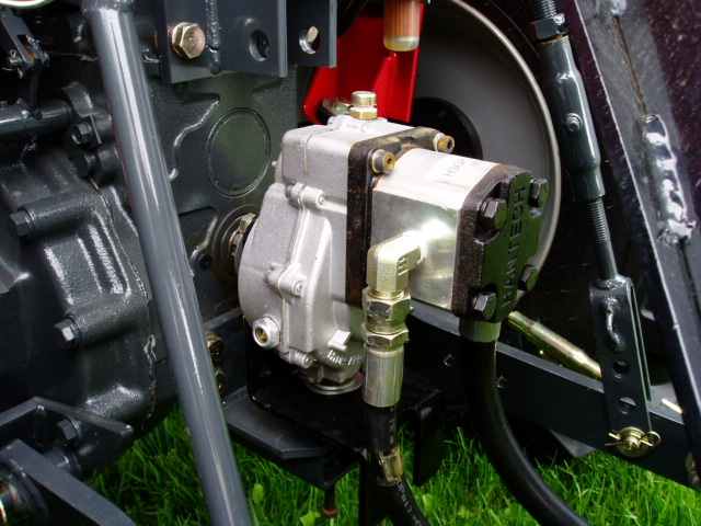

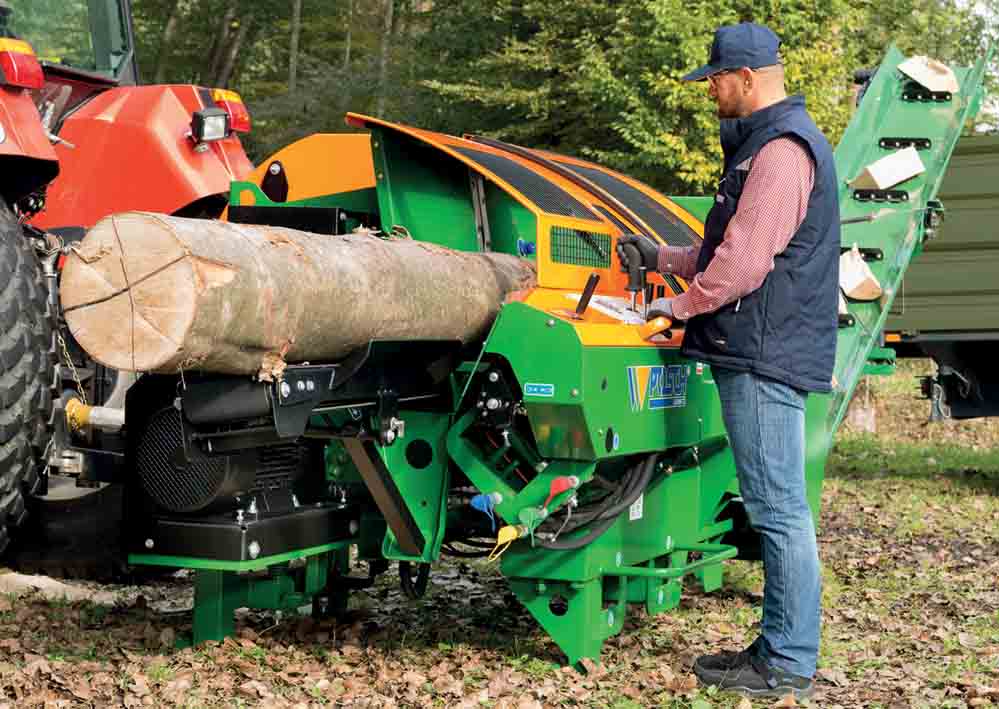

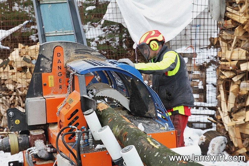

The models that I "study" have indeed a gearboxes and regular gear pumps, most of the time between two and three.
Example:
If you look closely you will see it
This one above have an angle gear box.
But they always say on their manual to run the tractor pto at 520-540 rpm.
My tractor motor need to be at 1900 rpm to drive the pto at 540rpm. max rpm is 2200
But i can have a direct pto link to the tractor motor or 1000 rpm.
My idea was to use some pto pump.
maybe two on the same shaft.
4570man I like your idea, because I think that my tractor reach max torque at 1400 rpm I think. so no need to go higher.
