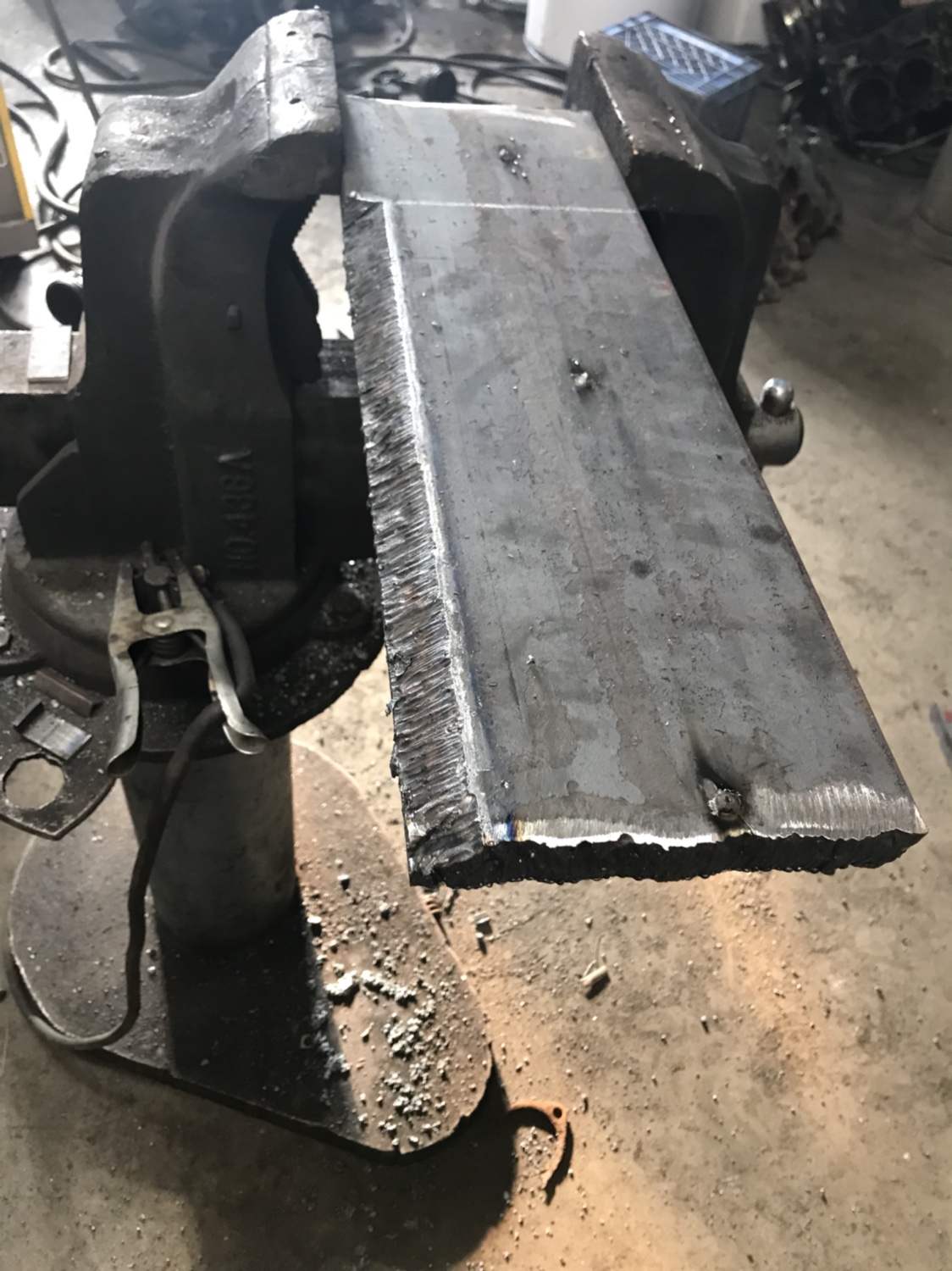

That’s how I made mine. A track torch would be leaps and bounds better than my free hand guide assist job but that’s still better than a grinder alone. IMG_1363.JPG
/ Firewood processor project.
#82
Did you use mild steel or something else?

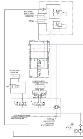

Ok, so I have almost finish the hydraulic circuit. My first idea was to use 2 hydraulic cylinder , one working and another one "lazy" but activate when
necessary with an sequence valve. The cylinders are mechanically connected at the push plate side. the port on the lazy cylinder are connected
to the tank . but the extend port are also connected to the pump with a sequence valve. Something like this:
But this was before I found the website flowfit.com and more pump option that surpluscenter.com.
now I will use just one cylinder 5x2.5x24" at 3000 psi for 26 tons max. I will have two pump (hi-lo) with an unloading valve.
to have speed and force when needing.

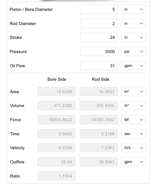

I also think that increasing flow is better than pressure. Now I have a question about regenerative circuit for the splitter.
If my cylinder is 5x2x24" Do you think that the ratio between the bore and the rode side "permit" a regenerative circuit?Screen Shot 2019-04-15 at 3.59.36 PM.png
My concern is that the differential area of the bore and rode are to "close" to have the cylinder extend. I know that many say that this concept is for cylinder that have a ratio of 1:2.
And do you know what the speed of this cylinder will be on the bore side with regenerative flow?
/ Firewood processor project. #88
In simple terms, Regen mode would give you the speed and force of a 1.75" cylinder (or whatever size the rod is).
