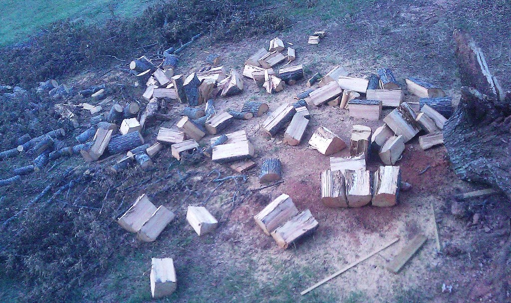

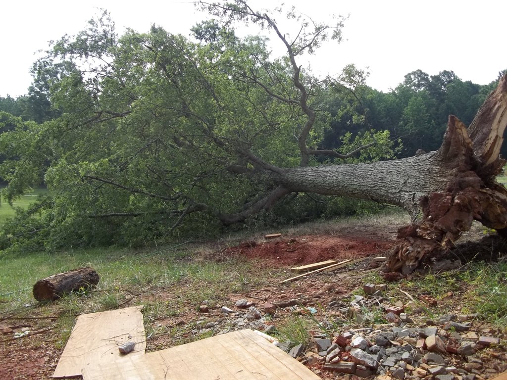

So this tree that fell on 14 Jun and is on 6 July mostly split and stacked needs to really wait till fall of 2012 to burn.
My 12 year old boy is learning how to swing a sledge hammer. :thumbsup:
I know this green wet oak is much harder to split than oak that has dried a while.

As a general rule I would recommend that all wood be seasoned 18 to 24 months before burning and 36 months would be ideal if possible (I never seem to get far enough ahead to burn 36 month wood). The first year I installed our outdoor wood furnace (a hot air model) we had about three to four cords of wood that had been cut and stacked in various places in our woods. It was amazing how that well seasoned wood heated the house. As the winter turned to early spring we found ourselves burning newer wood (some seasoned 9 to 12 months) and the reduction in heat available from the wood burned was very noticeable.
Perhaps some wood is softer and spongier when green but in my experience cutting and splitting cherry, oak (white, red, and pin oak), maple, and even tulip and poplar, they all seem to split with a maul easier immediately after they have been cut. It just seems that the moisture in the wood makes it split better - or maybe I just prefer to get it done sooner than later.
Where you hit the logs is much more important than how hard you hit it. I used to hit everything across the middle in an effort to split it in halves, and then into quarters. That method works with smaller rounds of wood but for large diameter logs you are far better off 'slabbing' them by splitting off slabs near the outside diameter and working your way around. Different woods definitely have particular characteristics that affect how and where to hit them.

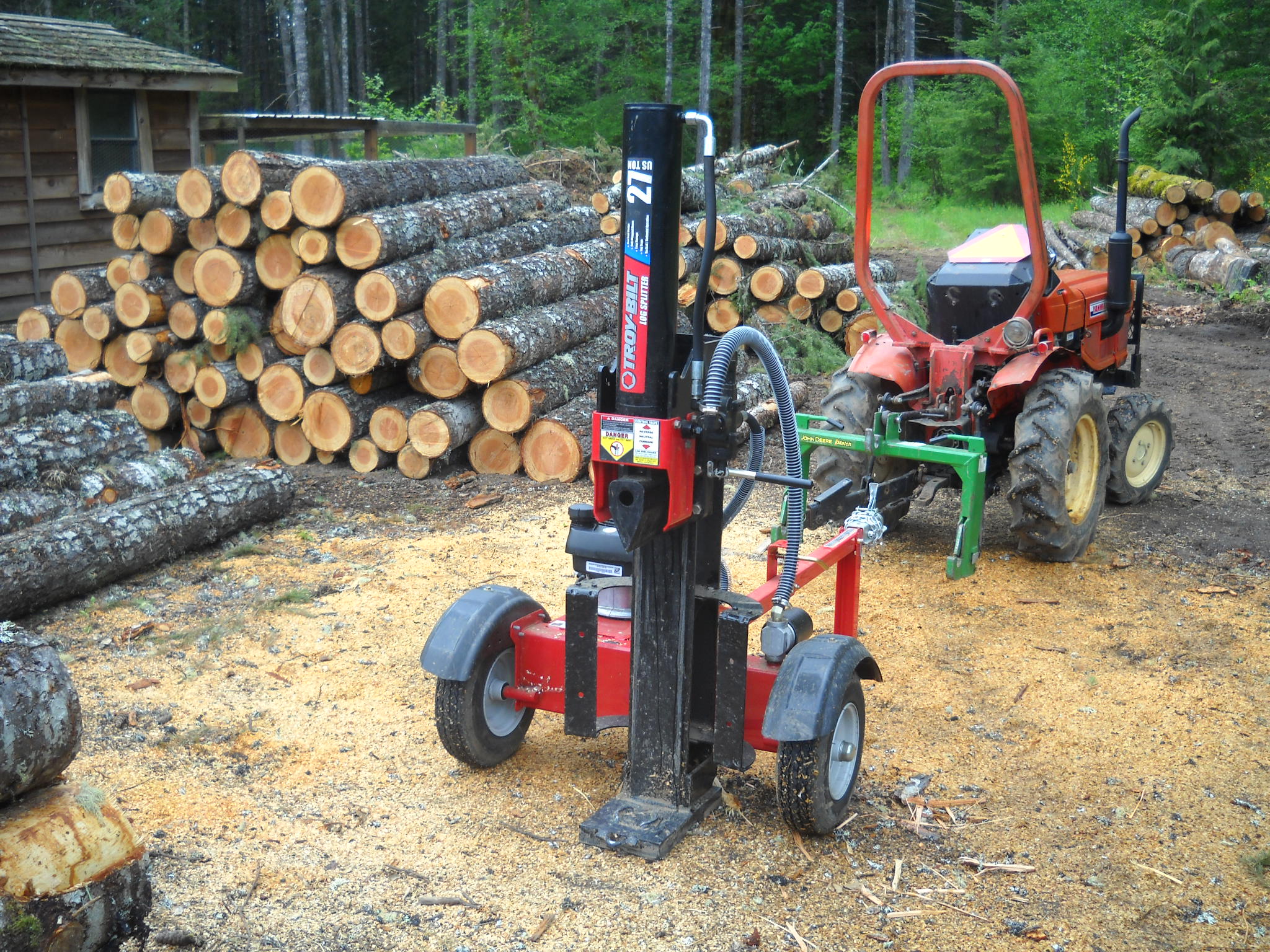

When I started my big firewood project, i went out and got myself a 27 log splitter and a chain saw. Now I have another chain saw, bigger than the first, and having the chain saw, tractor, and splitter makes wood processing much more time efficient. The splitter has already split over 15 cord of wood and has already payed for itself since i got it back last fall. When i stack it, it depends. At home I stack it on pallets and tie it all together so it could be one unit which is half a cord even. This way I can measure the amount of wood i have with ease. This last weekend i split and stacked probably 6 cord for my neighbor and just stacked it (Douglas fir and Oak) along his fence line for 50' and made 3 rows. He can now just take some barn metal and a few sheet metal screws and stick that over top the rows to keep the weather off them. I usually tarp my wood at home.

Nice outfit. Nice job of stacking too! Looks like you have plenty of logs to work with.
I bought a splitter about three years ago. At the time I felt like it was a 'must have'. Then in the fall when I started cutting and splitting I just viewed the splitter as one more thing I would have to pull to the woods and never got around to using it. Frankly, I like the convenience of carrying a splitting maul up to the cut logs where they lay and splitting them on the spot. Using a splitter would involve either moving the logs to the splitter or the splitter to the logs.
I feel that in most cases I can split with the maul faster than using a splitter based on the cycle times I see of 10 seconds or more. That seems like forever if you watch ten seconds tick away on a clock. Anyway, after the splitter sat in the way in my pole barn for over a year without ever being used I posted it on Craigslist and sold it. I split between four and six cords of wood per year and I haven't missed having it yet.

How old are you? I too can split faster by hand but not for as long as the splitter can. Sometimes if i have a small amount like a pickup load its not bad but sometimes if i cut and loaded it a splitter is nice.
