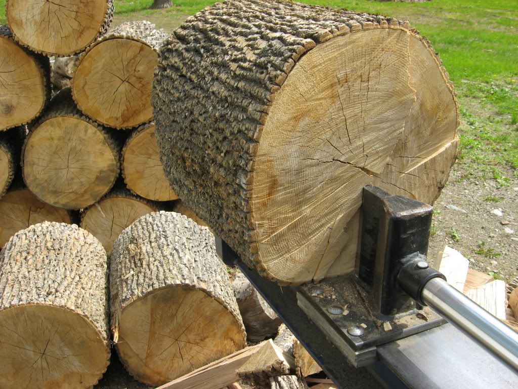

#1 Do y'all cover your firewood after it is split? Tarp, shed, what?
#2 How far do y'all stack the wood from your house?
#3 How long do you let it sit before using it in the fireplace?
no worst thing you could do is completly cover it! it will start to sweat and mold
I think that it true too. Also, I have been told to keep it out of the dirt so fungus can't get cranked up on it.
Definitely agree. Air circulating around the wood is extremely important for carrying away moist from the wood. Sheltered would be a better description for covering wood. A shelter with open sides can keep rain and snow from the wood while open sides allow the air flow required.

MIne is split where i cut it and then stored under a lean to on the side of the house. Its seasoned about 18 months or more. One load of fir i had was so wet i let it stay for 3 years before i was able to use it.
