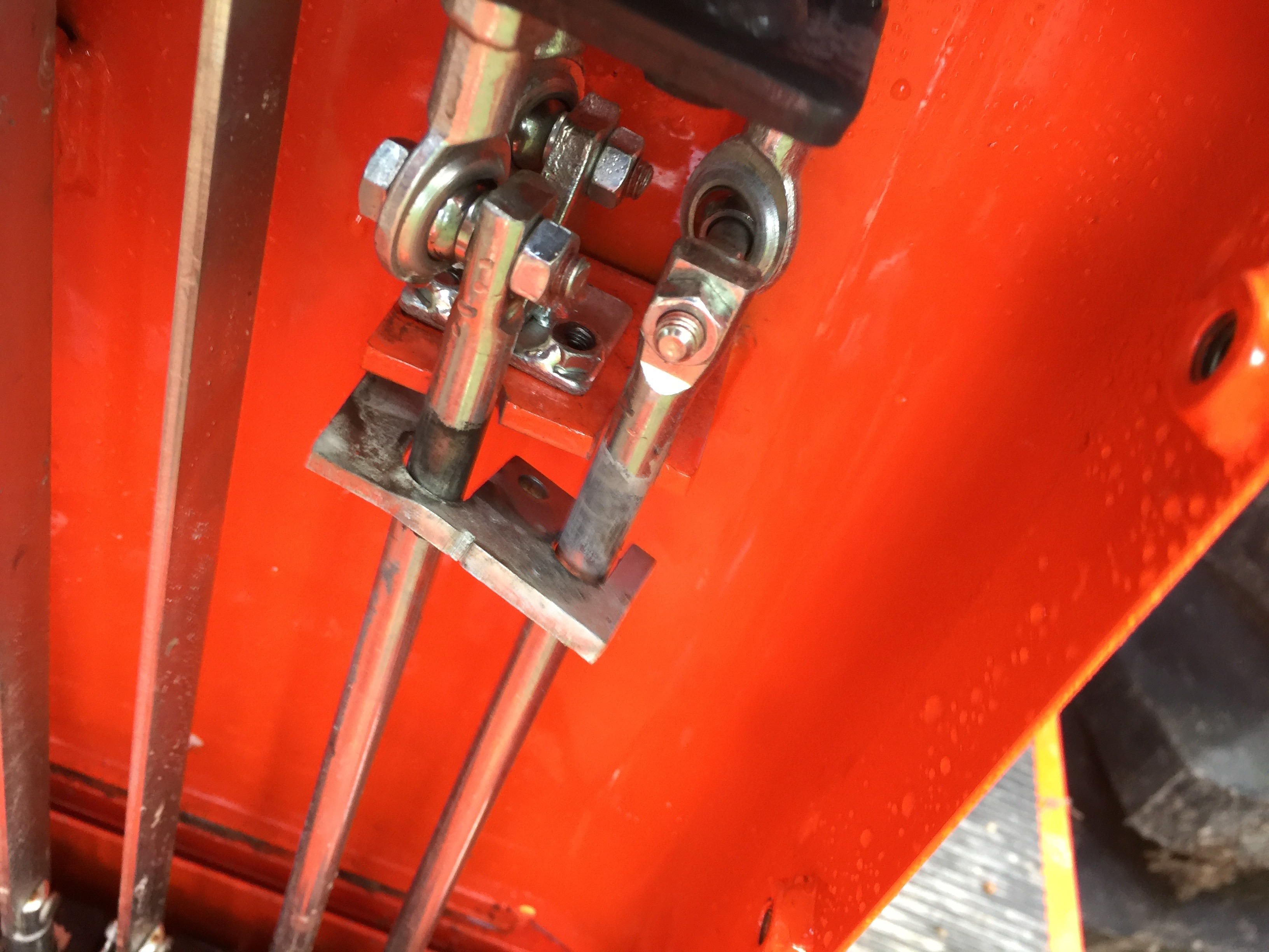

The left control for the BH has been becoming more and more unresponsive and I opened the console this morning to see what was going on and found the guide plate (?) had lost one bolt and the other was loose. I took it off and straightened it back up in my vice and bought some new bolts at the hardware store. Reassembled with blue thread lock. While I was in there I checked the other side and its bolts were loose too. Tightened up and applied thread lock there as well. Didn't expect to have to get into there at 30 hours. It's back to normal operations now though.

It happens. I have to reapply locktite to the theads on the rodends to my FEL loader joystick about every 200-300 hours.
hugs, Brandi
   / First fix on the BH #3
Good find,part of owning tractor you just never know.
