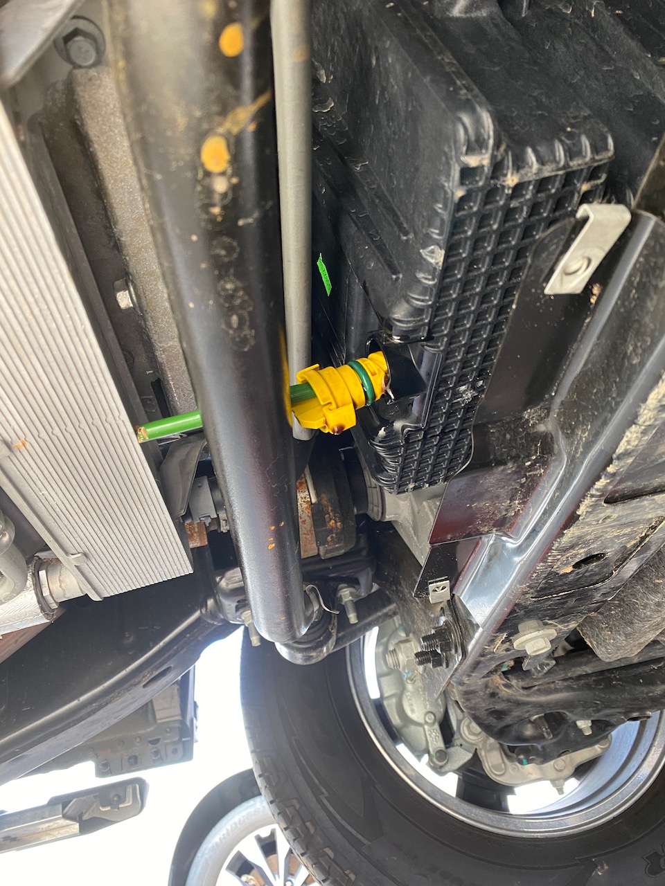

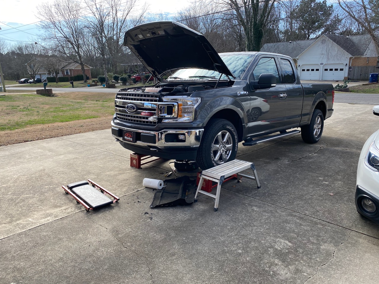

I found it a little annoying that I need to stand on a box to easily check the oil on my 4WD 3.5 EB. However, I only check the oil every few months since it uses none at all, so it's not that big of a deal. I was originally taken aback by the plastic plug on the oil pan, but after 3 years I have decided it's a good design. The pan covering the bottom of the engine takes a few minutes to remove, but once it's off it's great to have a very clean bottom of the engine, even after years of use.
Yeah, its really bad when one has to put the truck up on ramps to get under and remove the panel for access to the drain plug, then requires a box to stand on to put the new oil in!
I use a short pencil to keep the yellow plug partially in the hole so as to keep everything from gushing out, hitting the sway bar, and making a mess.
