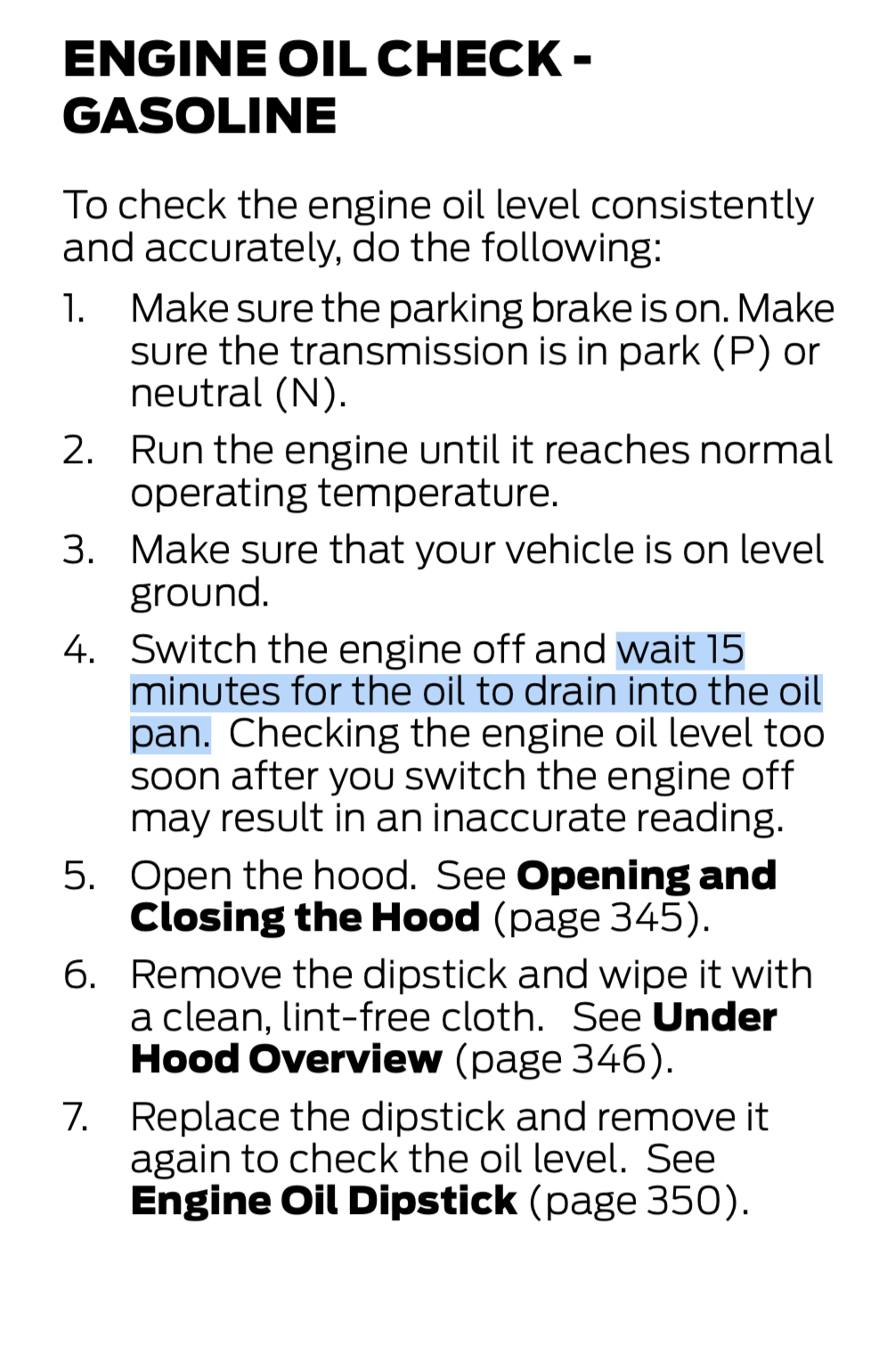

The "experts" say to drain hot. Suspends the heavy particles so they come out with the oil.
"Experts" do not want to tell car dealerships they have to let cars sit 4 hours to cool before draining the oil.
If particles are so heavy then how is redistributing them throughout the engine before draining the oil an improvement? If so heavy then they are in the bottom of the crankcase pan nearest the drain to be the first things that come out.
Ford says the 2.7EB needs a long drain to get all the oil out. So why not drain cold? Oil has had hours to trickle down to the crankcase pan.
I learned to drain cold nearly 20 years ago with a Toyota Avalon. Hot, the oil filter was full of oil, mounted at a 45 degree (website won't properly display ー degree symbol) angle immediately above what was said to be a $700 "active motor mount". Made a huge mess to remove the oil filter.
When cold the oil filter had almost no oil inside. Less oil than the 45 degree angle would suspect. Came off clean, no spill. But I also found the engine held 5.0 quarts to 1/8" below the FULL line on dipstick when drained cold. Hot drain filled 5.0 quarts was 1/4" or more over the FULL line.
So it was a matter of cold drain didn't burn my hands on exhaust manifold and spill oil out of the used filter, and I got more oil out of the engine, and the convenience of using exactly one 5 quart jug of Mobil-1. Versus "everybody says to do it hot."
This is from the 2018 F-150 owner's manual:
Please run a test for me.
Remove drain plug and wait 1 minute. Then place a separate catch basin under the hole and wait 14 minutes. Then measure the oil captured in the last catch basin. Report that here on this thread please?
Thank you!
