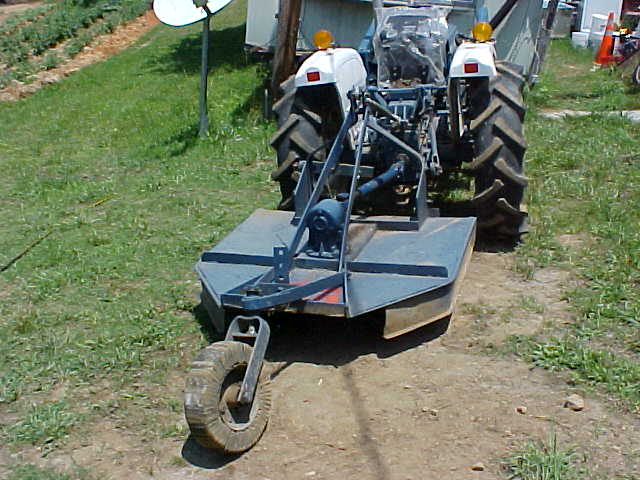

This is suppose to be a 4 ft King Kutter Bush Hog... I'm not sure. It works well except the four bolts that hold the gear box on has worked loose. I can't seem to get them tightened.

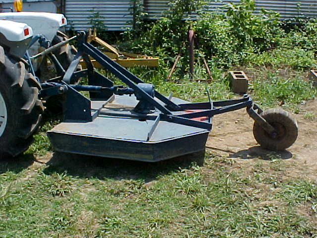

Another view of Bush Hog

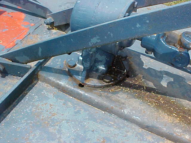

Hear is a close up of bolts I am speaking of. Anyone have the tools to fit these. I understand the blades and stump jumper has to be taken off to do this. The large nuts and bolts that hold blades and stump jumper on are huge. I don't have the tools large enough to do this job /forums/images/graemlins/confused.gif /forums/images/graemlins/frown.gif /forums/images/graemlins/crazy.gif

</font><font color="blue" class="small">( This is suppose to be a 4 ft King Kutter Bush Hog... I'm not sure. It works well except the four bolts that hold the gear box on has worked loose. I can't seem to get them tightened. )</font>
Hi Jim,
If you cant get those bolts tightened up with some help, and cant get them off /forums/images/graemlins/confused.gif, your going to have to cut them off ! Then install new bolts and locknuts. If that condition remains like that the gearbox will be damaged, elongated holes or cracked casting /forums/images/graemlins/frown.gif
