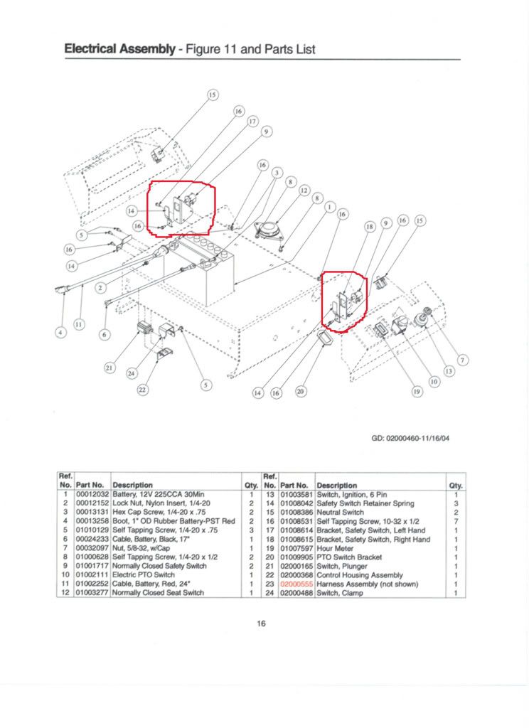

I have a 2006 Cub Cadet Z-Force 50 is there any way to keep the mower blades from disengaging while in reverse?
   / First take on my Cub Cadet Z-Force 50 #26
Under the covers on each side there is a switch for each steering lever with a little plate that pushes the switch you only have to make it so one of the switches isn't working and the PTO won't cutout.
