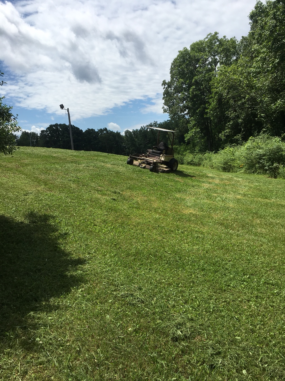

I must’ve missed the 30-35 degree claim. I agree that’s it’s almost certainly not that steep. I’d be surprised if the average vehicle would even climb that. This hill is only 17 degrees measured by holding my phone angle app on the roll bar. The phone has since been verified for accuracy and was spot on. The second picture is 48 degrees measured the same way. IMG_4349.JPGIMG_4414.JPG

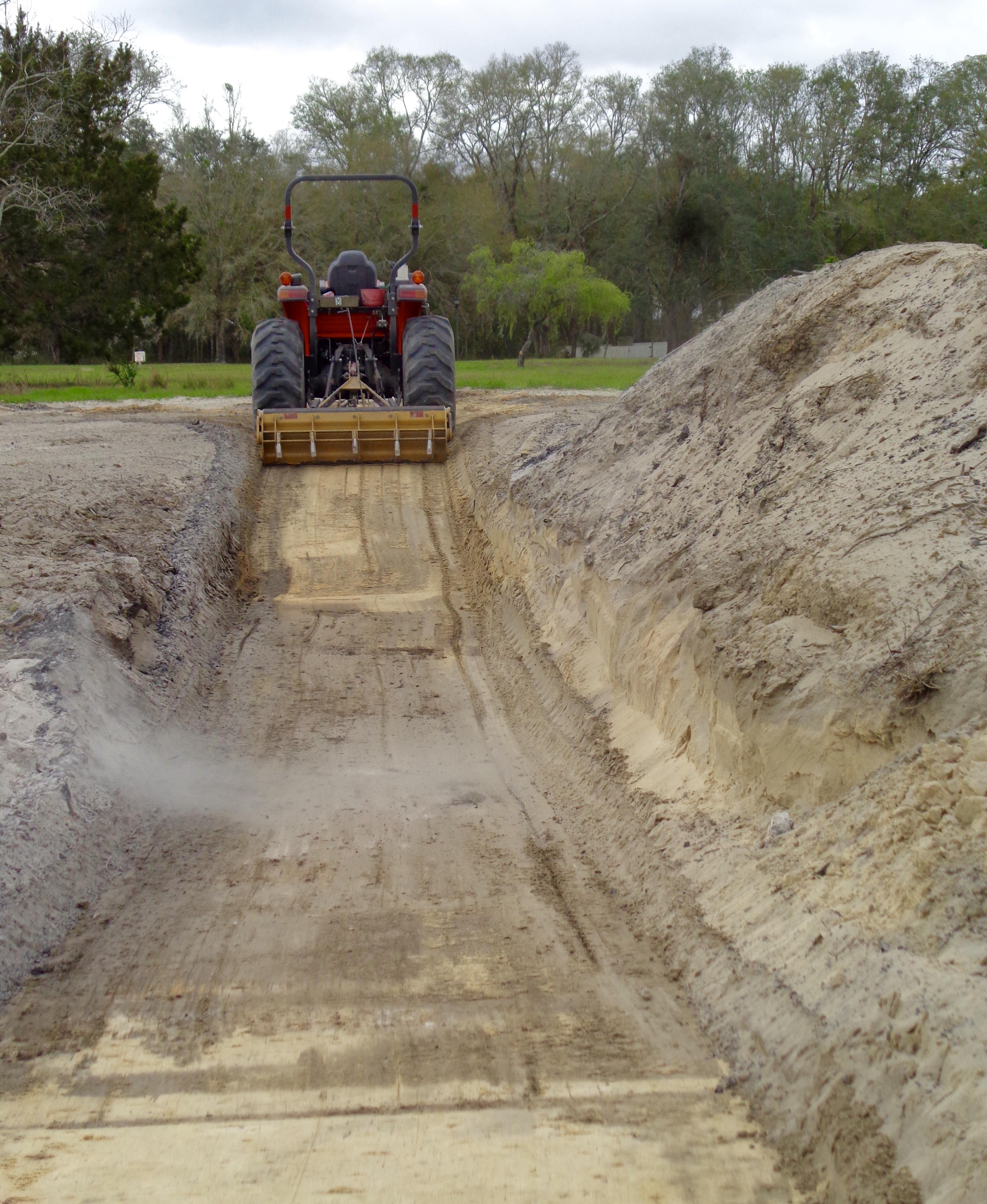

The fundamental importance of TRACTOR WEIGHT eludes many tractor shoppers. Heavier tractor chassis weight is more important for most tractor operations than increased tractor horsepower. Within subcompact and compact tractor categories, bare tractor weight must increase 50% before you notice a significant tractor capability increase. It takes a 100% increase in bare tractor weight to elicit MY-OH-MY!
Heavier tractors are built on larger frames with larger wheels/tires. Heavier tractors with large diameter tires have more tractive power pulling ground contact implements, pushing a loader bucket into dirt and pushing snow. Larger wheels and tires increase ground clearance, enabling a heavier tractor to bridge holes, ruts and downed tree limbs with less bucking and disturbance when passing over rough pasture and woodland.
My L3560/HST weighs 3,500 pounds bare tractor. It will pull a full 60" Box Blade of moist, sandy soil up fairly steep slopes VERY SLOWLY.
Bare tractor weight is a tractor specification easily found in sales brochures and web sites, readily comparable across tractor brands and tractor models.
Then in 2009, after just poking at summer driveway maintenance, I traded the Ford in for a Kubota M6040. My Kubota has a heavy duty Land Pride grapple on the FEL, has 1550 pound of Rimguard in the rear tires and a Rhino HD 950 rear blade on the 3-point. My useable "implement" jumped in weight from the 3100 pound Ford to the Kubota that weighs 10,100 pounds.
I don't think you need a tractor as big as what I have. However, be certain that you DO HAVE a tractor large enough to handle a rear blade or box blade that WILL move material on your driveway - year-round.
OOSIK'S M6040 is ~~5,000 pounds~~ bare tractor weight.

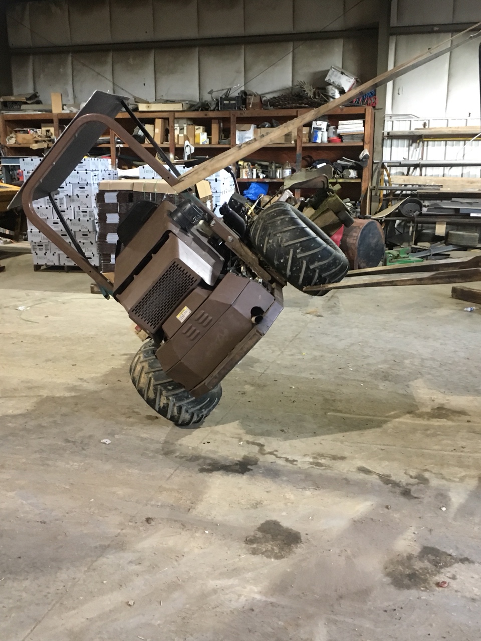

Unless you modify your driveway description you need a 4-WD tractor with a bare weight of around 4,000 pounds. All 4,000 pound tractors will be over 25-horsepower. No 4,000 pound tractor will enter a garage with an 84" sill, even with ROPS folded.
