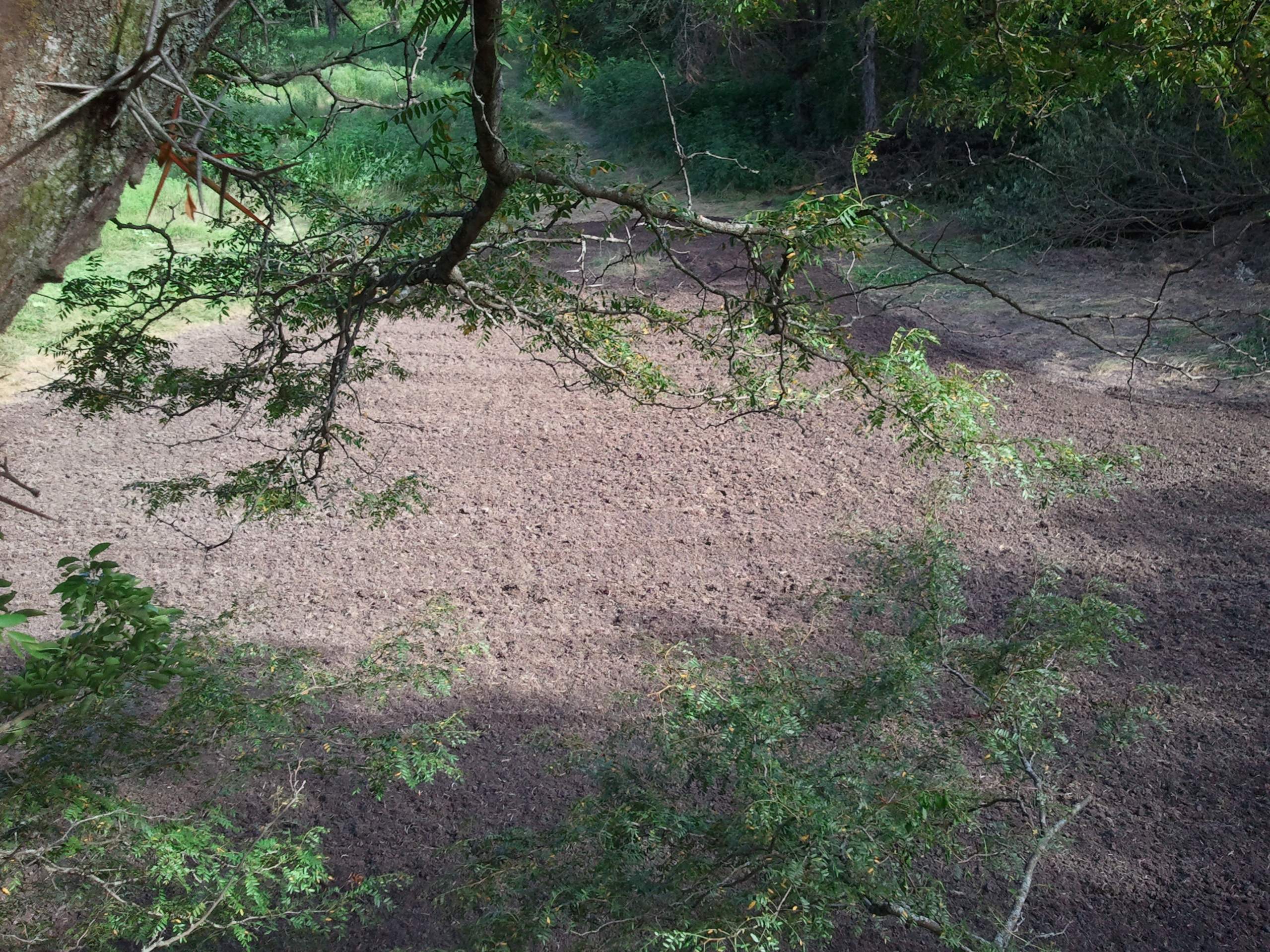

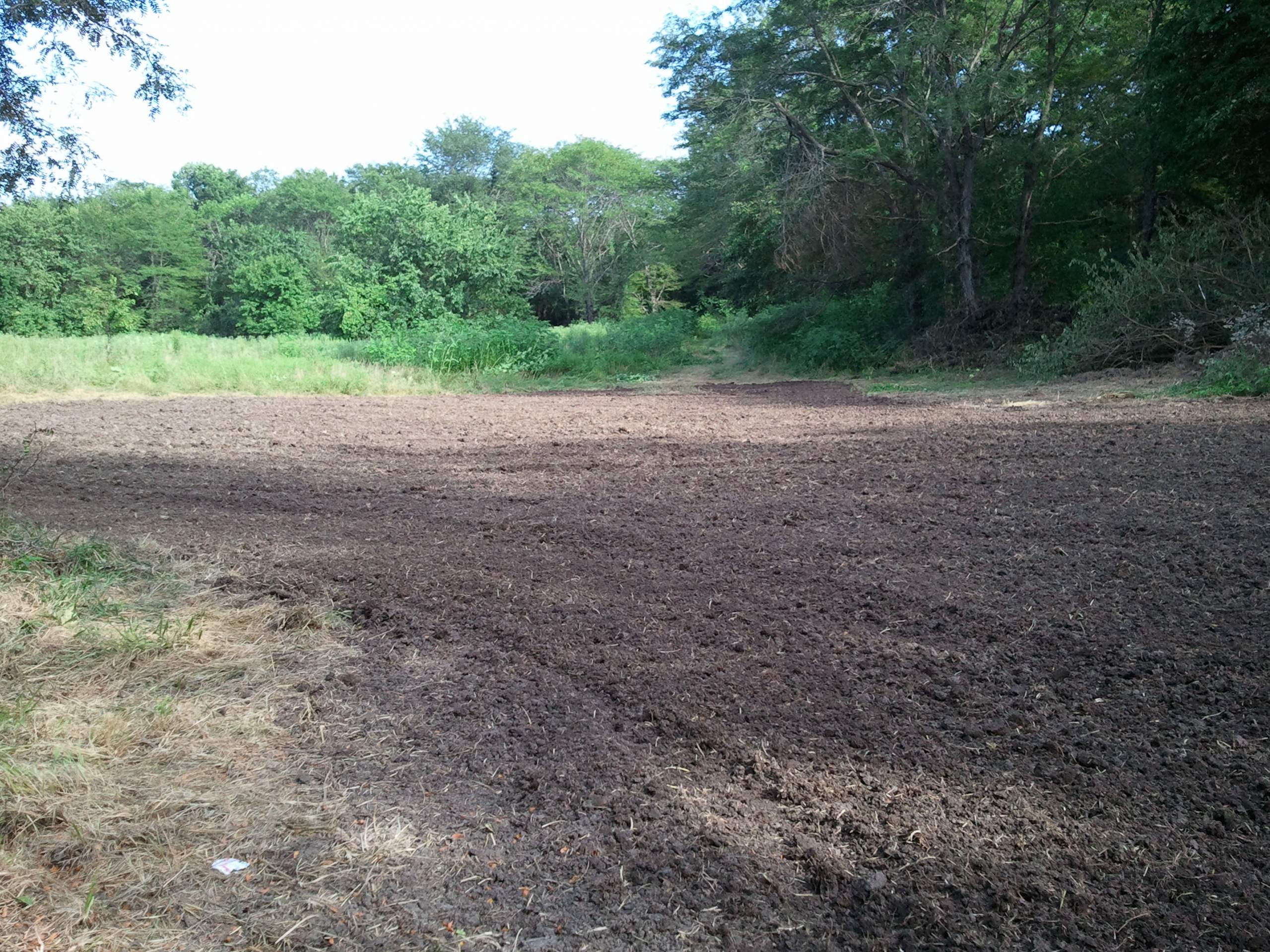

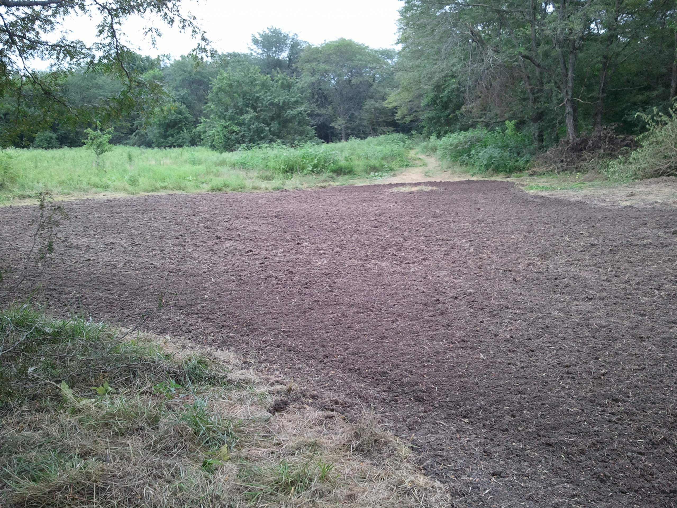

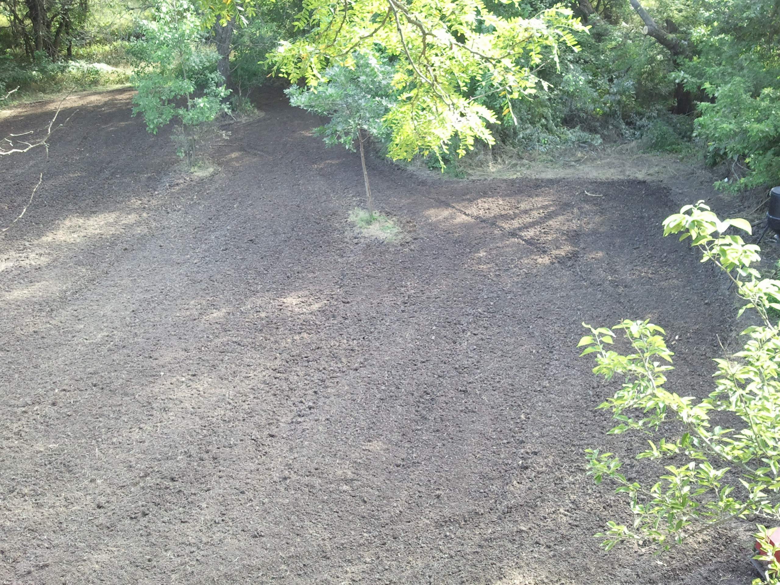

I decided to go ahead and put my seed down since we are supposed to get rain today. I retilled the ground and took a few pics before I broadcasted the seeds. I took a couple picture out of a new deer stand we put up.

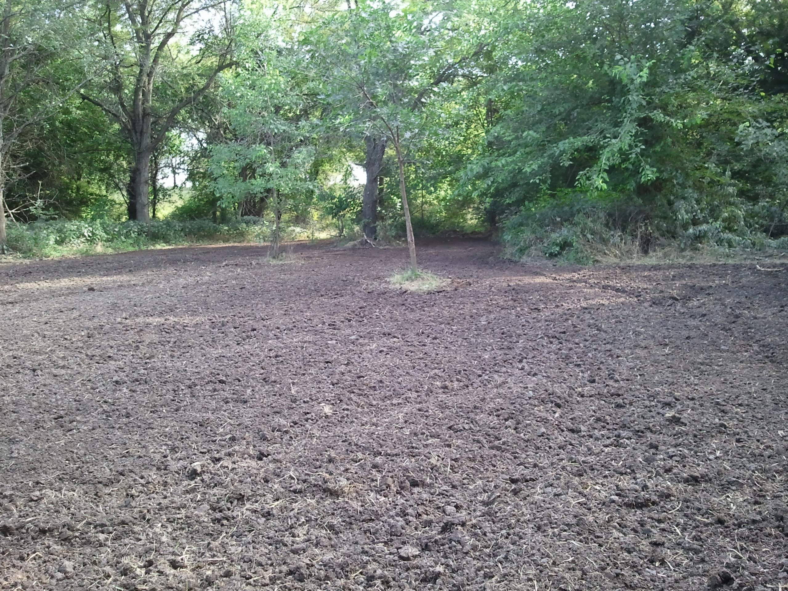

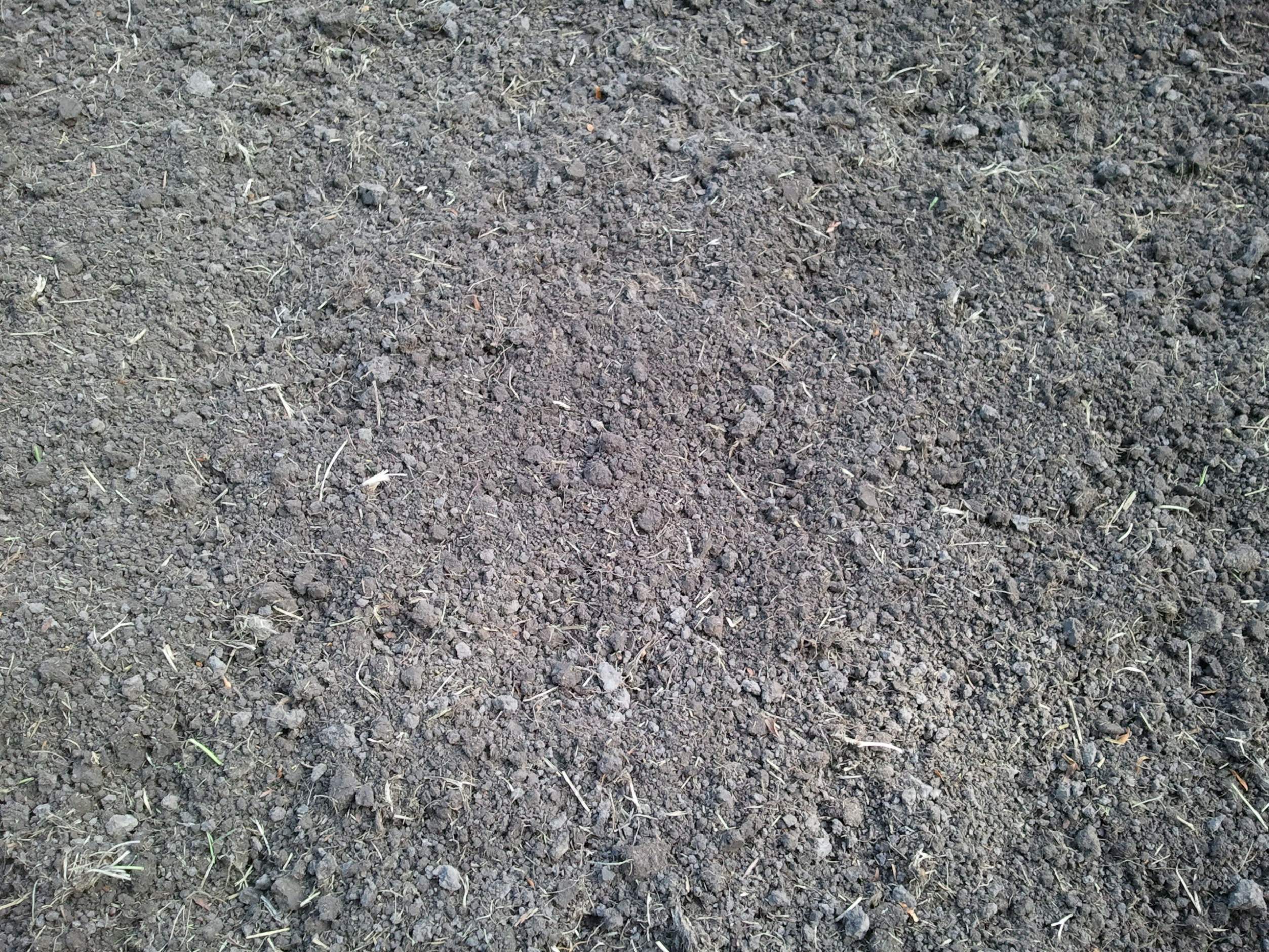

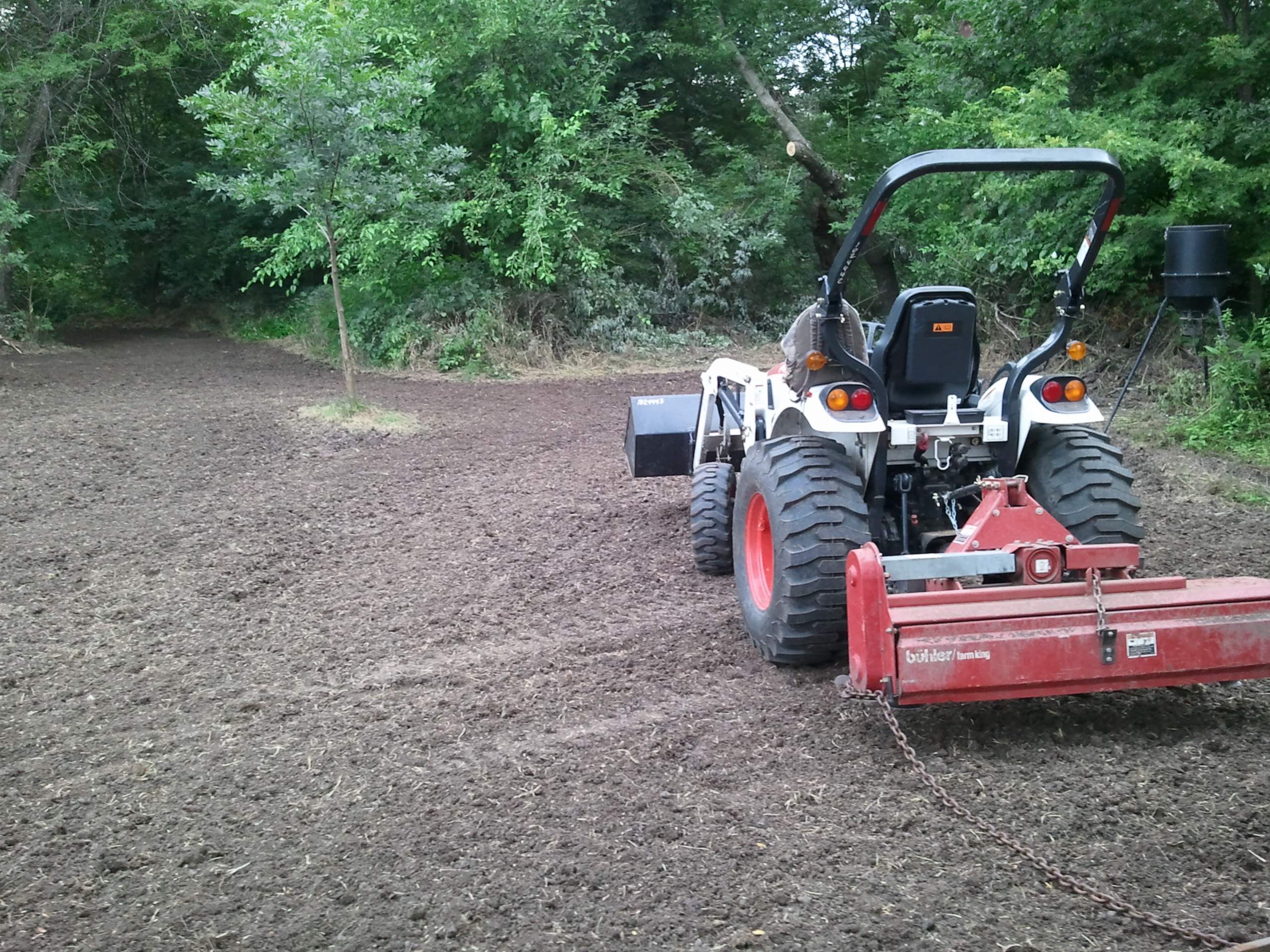

I don't have any type of cultipacker, so I just used my tractor tires to firm up the seed bed. I drove over and the entire food plot. Then, i used the tiller to just loosen up the top inch or so of soil. I then used a bag seeder to broadcast my seed.

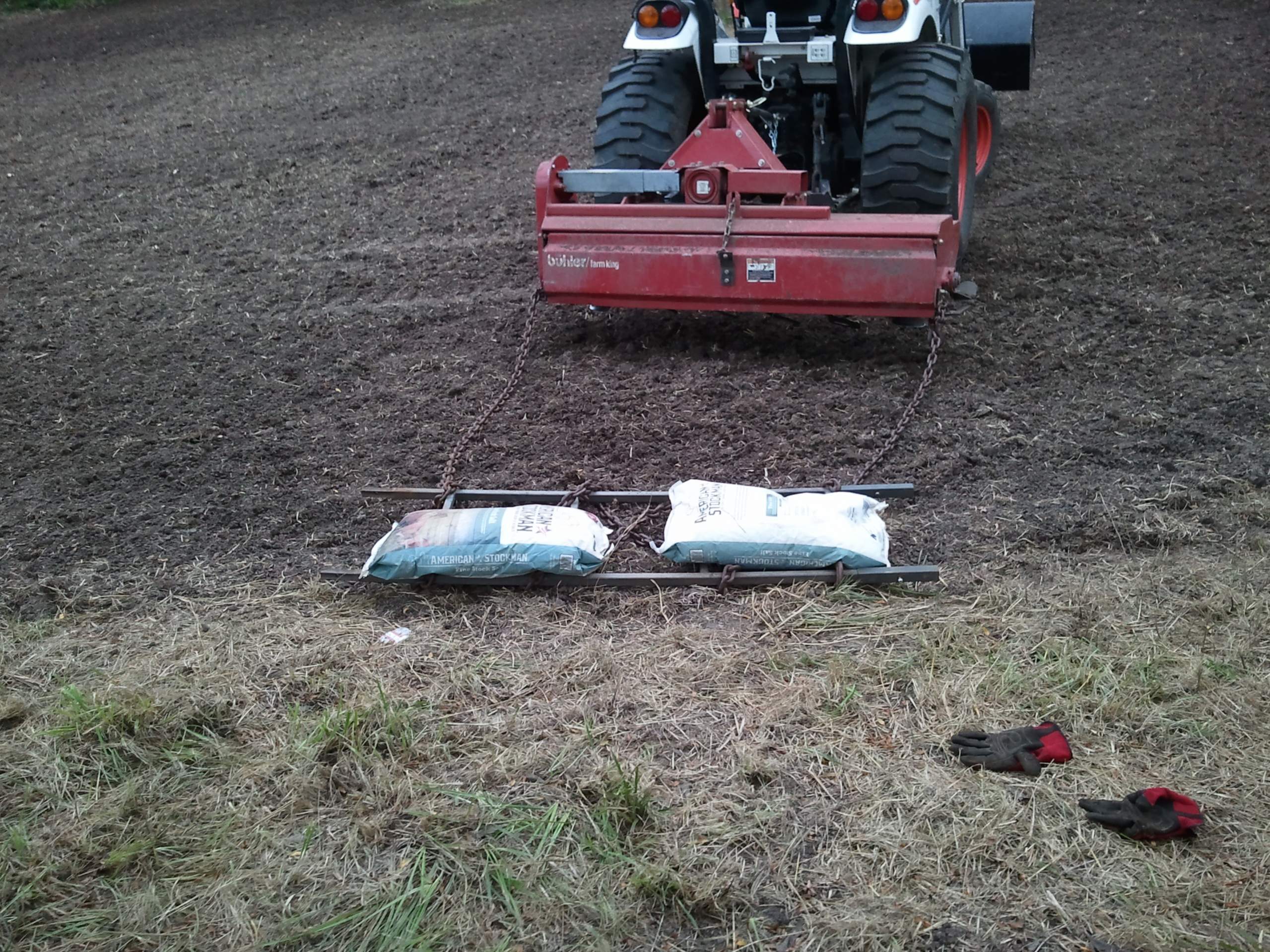

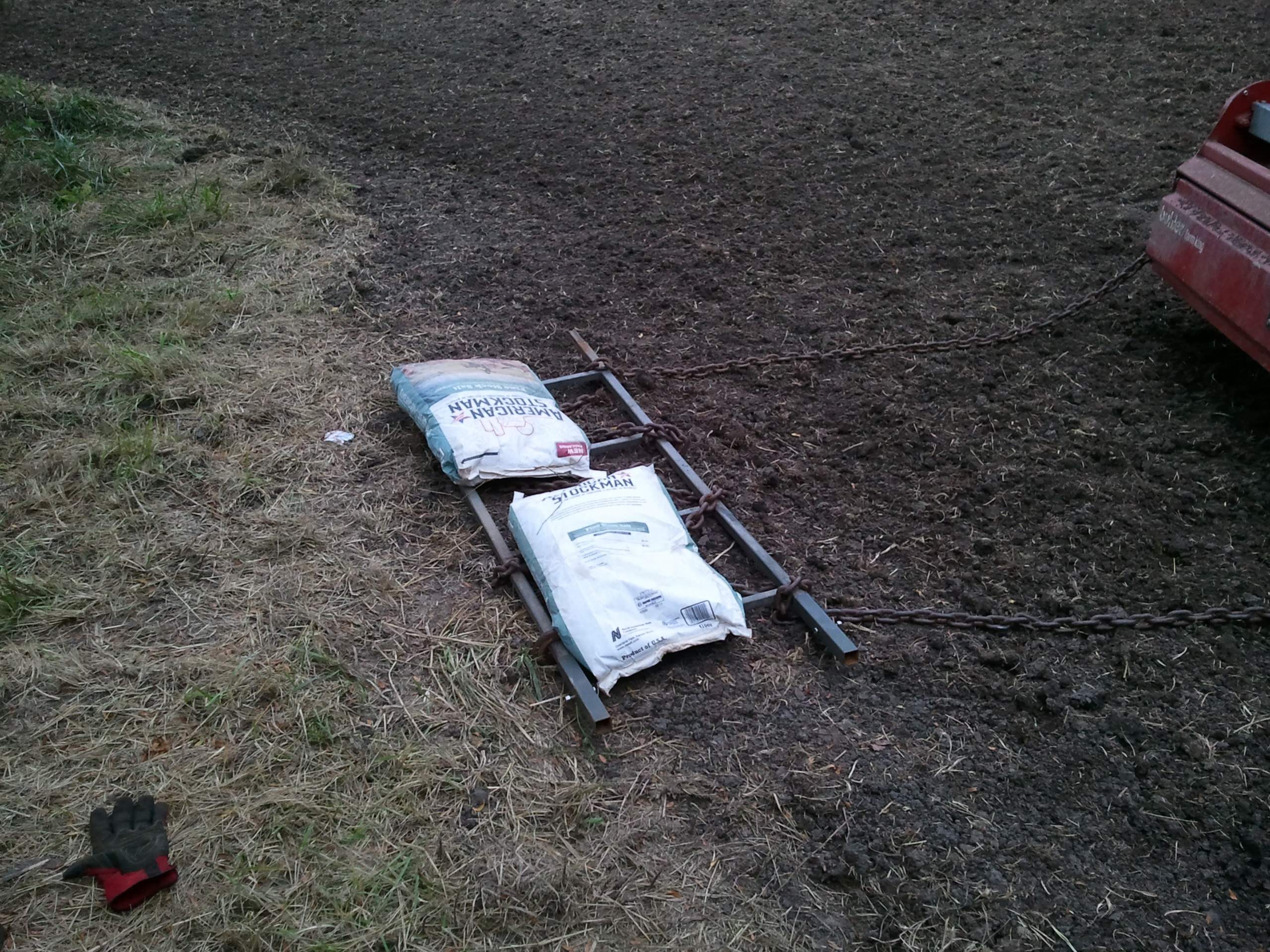

Since I don't have a cultipacker to get good seed to soil contact, I made a simple weighted drag to pull behind the tractor. It is a 5' ladder stand section with heavy log chains wrapped around and weaved through the steps, then I have 2 50lb bags of cattle salt on top of it to weigh it all down. Along with the tire tracks, I think this did a pretty good job of getting the seed down into the soil and firming up the seed bed around it. I have no way to know for sure, but time will tell how this worked out.

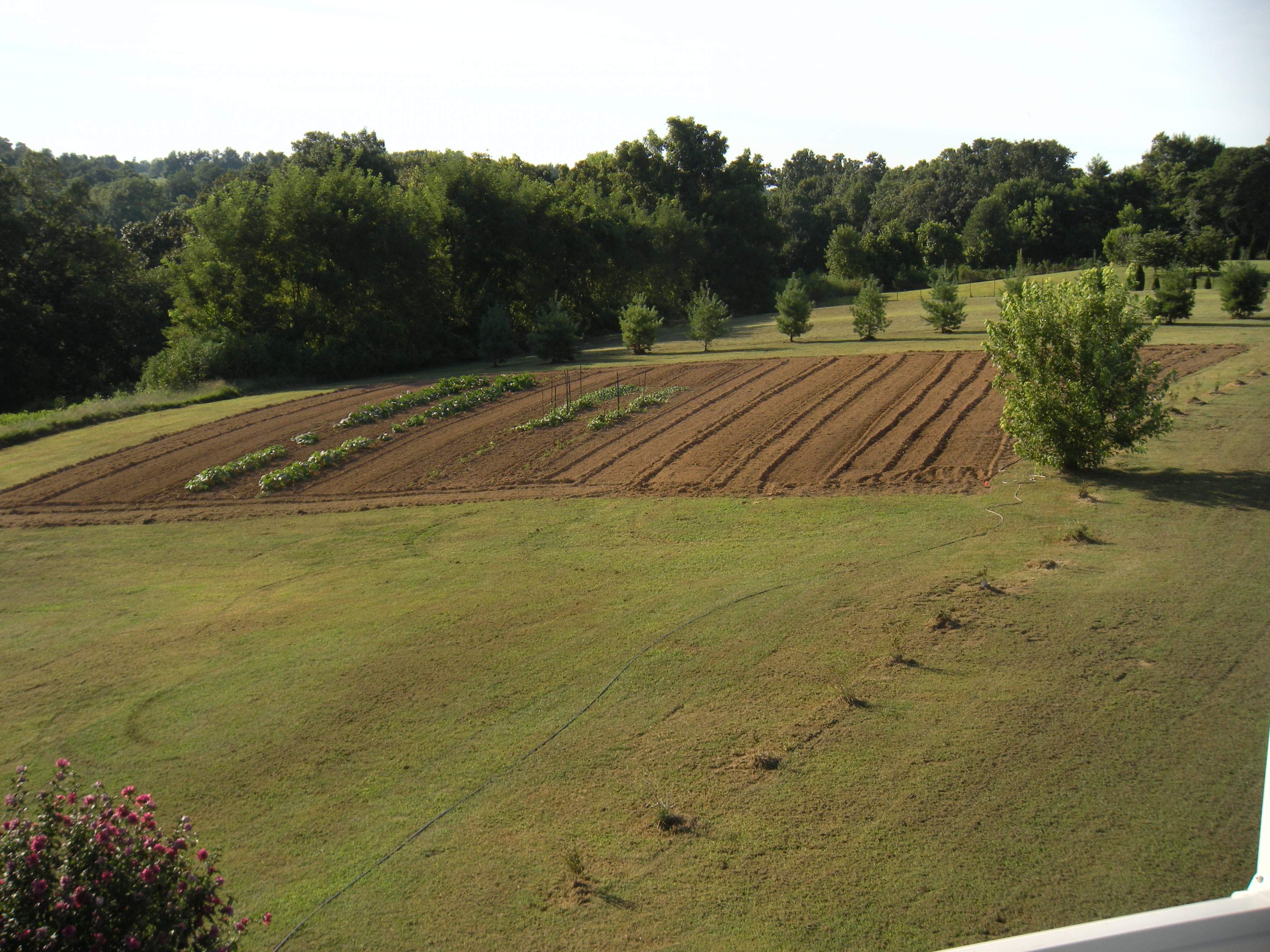

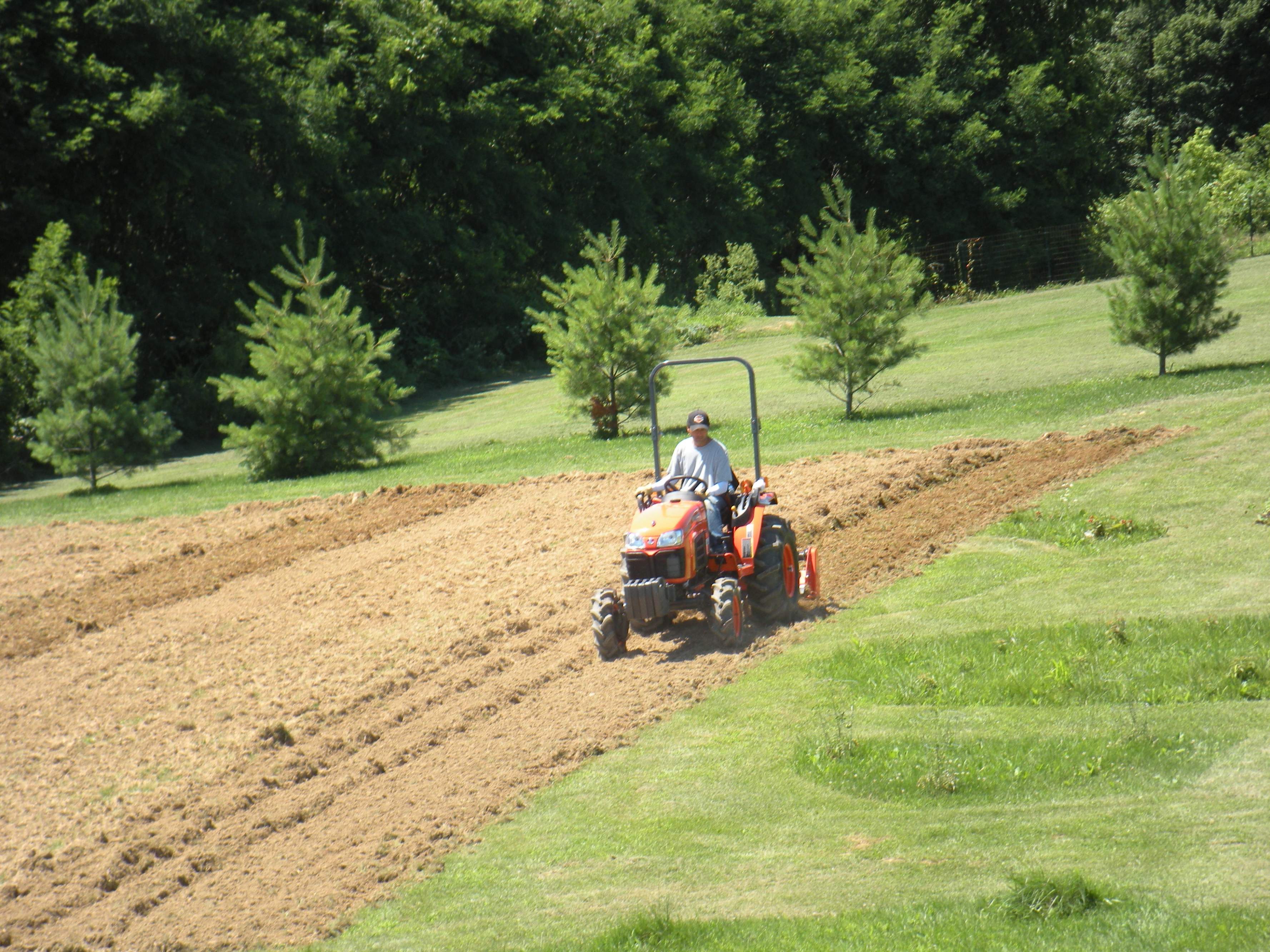

I didn't use any chemicals to convert my sodded area to a food plot - although it wasn't for deer. I mowed it, then tilled it - 4 passes. I let it rest for a few weeks, then planted.
