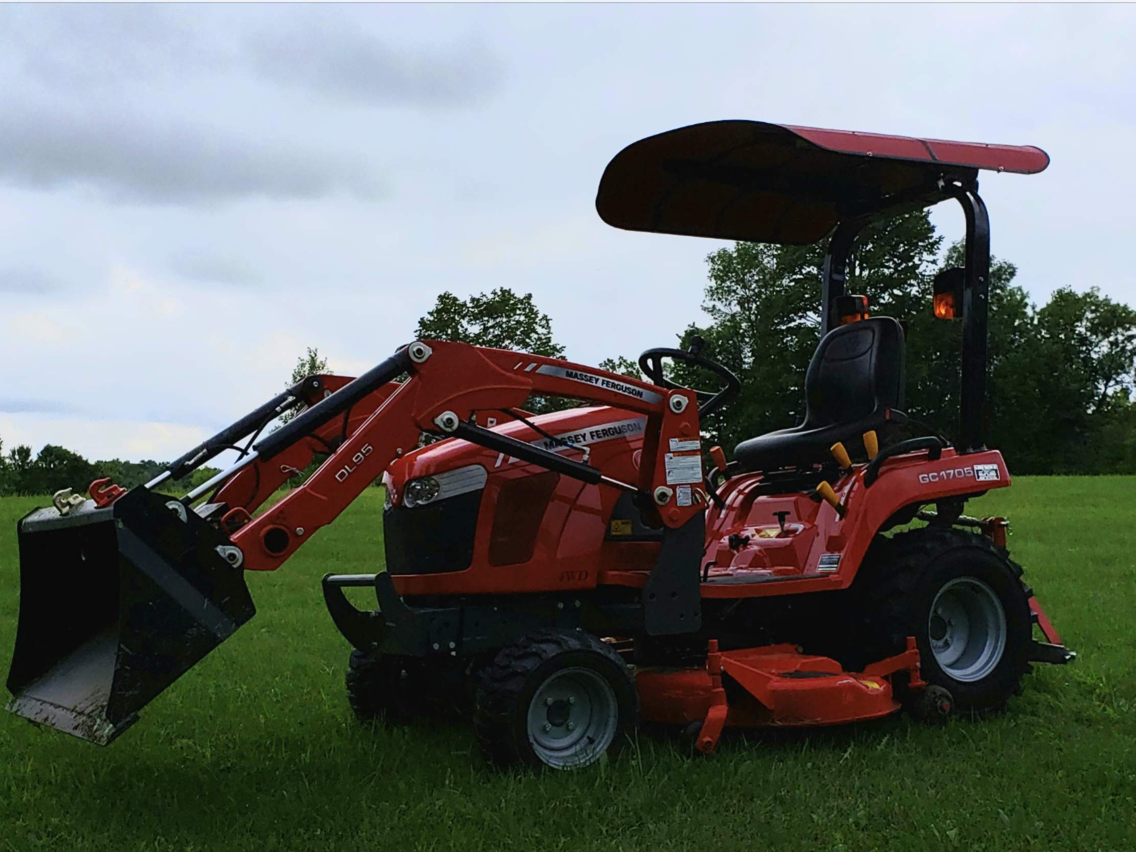

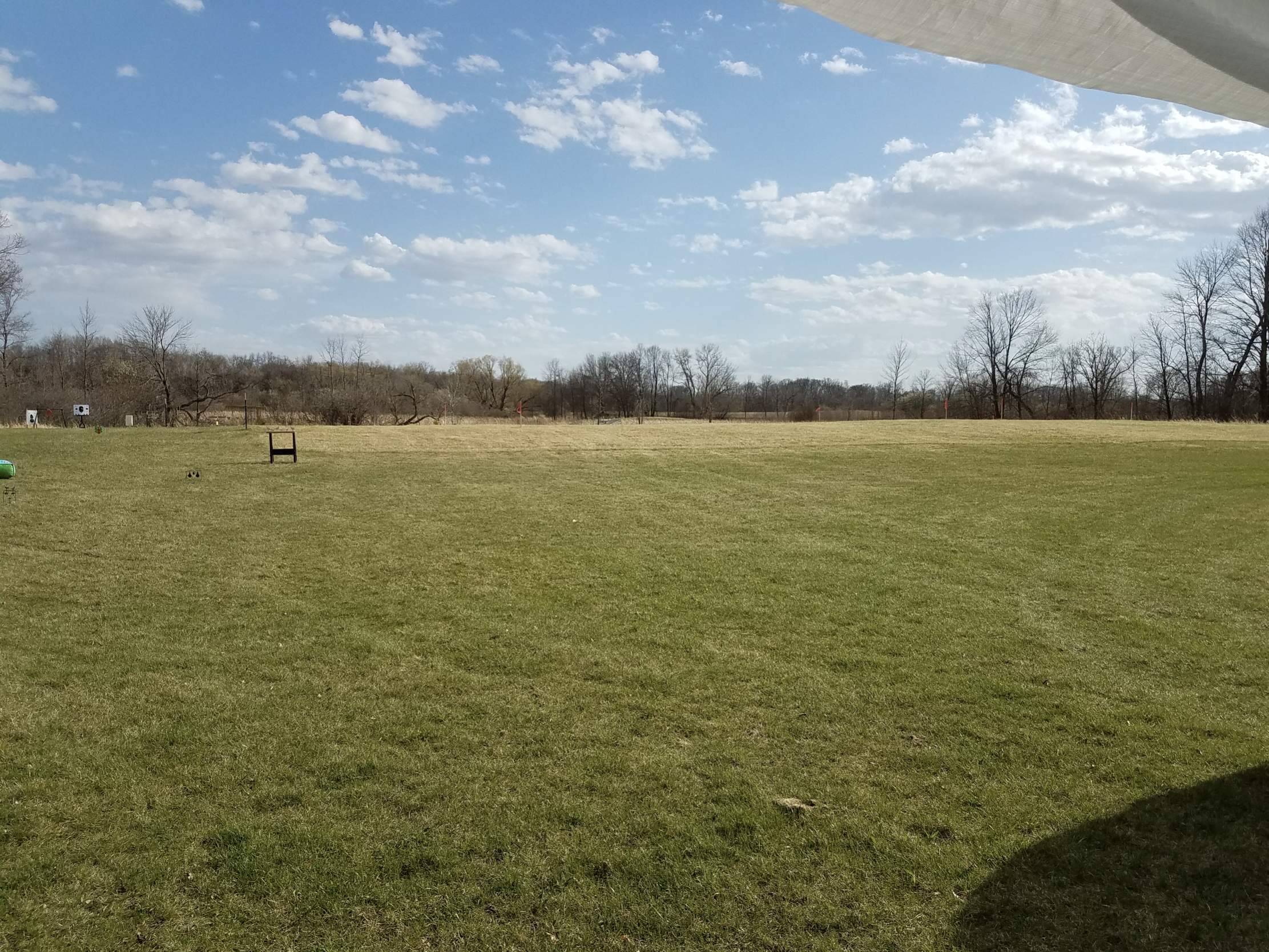

I have 12.7 acres and mow about six acres of that which is fairly level except for the ditch along the highway, I mow the ditch and around the camper with a 54 inch Cub Cadet zero turn, used to mow the whole thing with my zero turn until about 4 weeks ago, I decided to go with a scut with a 60 inch mmm and FEL to use on my property and I also bought a box blade and back blade to use with it, my driveway is about 300 feet long maybe a bit more and made my own drag to help keep it clean and I am thinking of getting a land rake.
For winter I am looking at buying a soft cab called The Original, that way I can remove it after winter when not needed.
This is part of my six acres.
My new Sub Compact.

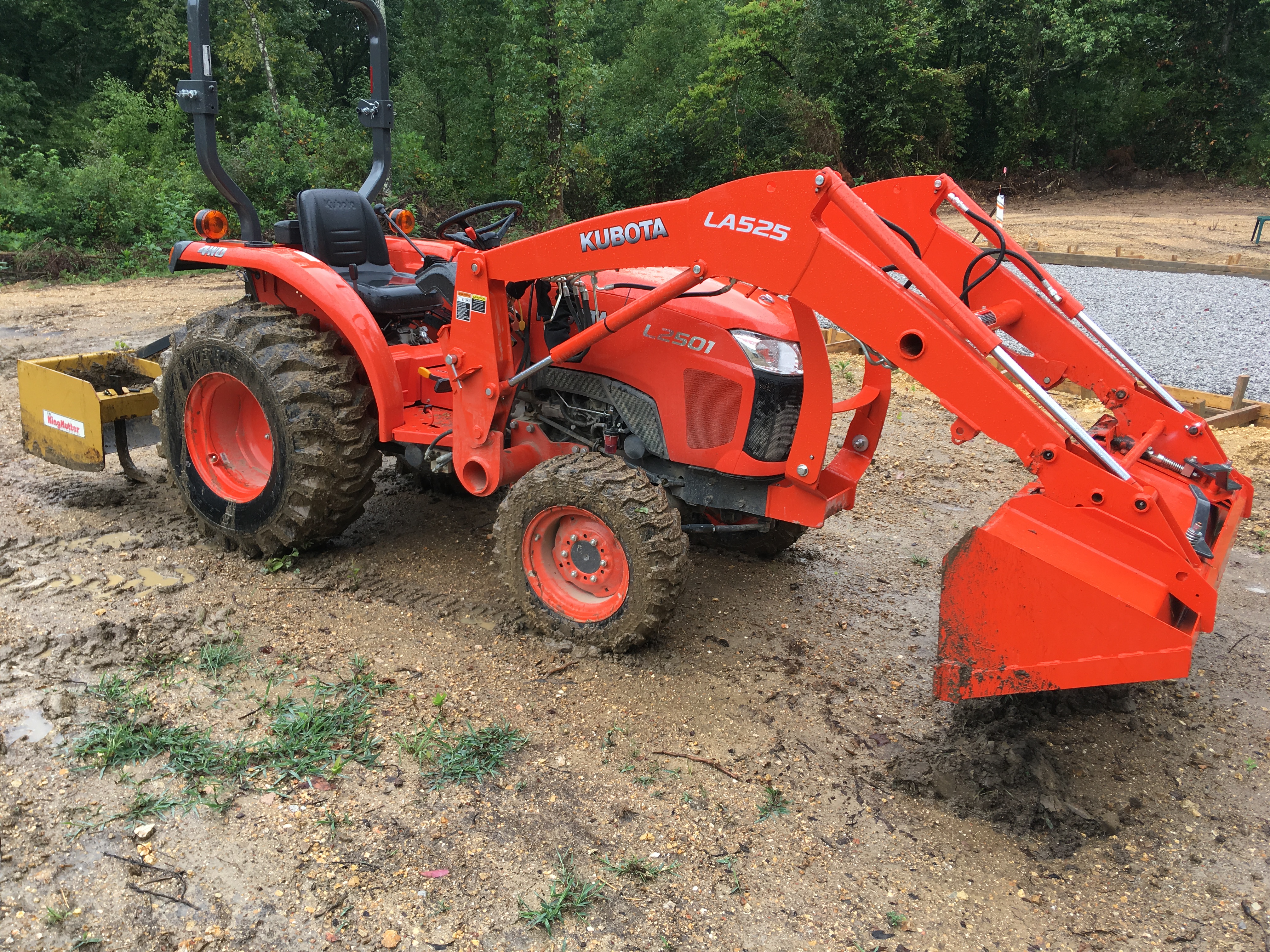

im biased! very satisfied with this tractor. 20hrs on the clock and running it like i stole it!
definitely worth a test ride.
