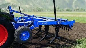

Got dry Hard Clay??
Lots of horse power and a spiked tooth type cultivator attachment. More than a few passes as deep as can be done. Follow by discing, plowing, or a tiller.
On hard dry clay a rototiller will take a bad beating. If the soil is wet you end up pulling a rotating tube of clay over the surface.
Weight in the bucket will add to your traction.
Sod turning plows have a gentler longer angled mole board that inverts the sod in a continuous strip. The harder steeper mole boards are for cultivated ground an break the soil Down into smaller clods when it’s turned.
The depth the soil is worked to should be limited to viable Soil.
learning how to plow is mostly about attaching and adjusting the implement properly.
