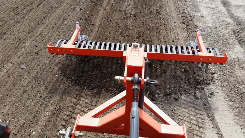

As others have said...gauge wheels make a huge difference. They will keep the implement from wanting to "dig in". I built a rake and the wheels make it easy to grade most materials. A few passes and you're good to go.
You've done a good job...it'll just be easier/quicker with the wheel!
If you can't find a gauge wheel to adapt to the blade, look for a local fabricator and I'm sure he could help you out. It would be money well spent.

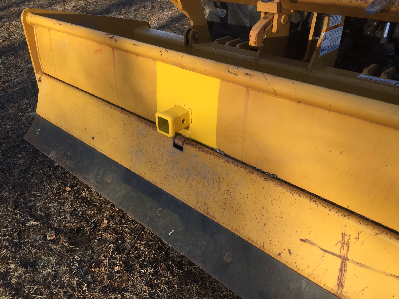

I have a regular back blade and a box blade. I have a receiver hitch tube on the rear of both for moving trailers around . The next project it to mount a gauge wheel to some receiver stock so I can put it on easily when needed. Also thinking of mounting the gauge wheel to a trailer tongue jack on this tube to allow easy up and down adjustment of the blade .
Al

Al,
That's a good idea to add a gauge wheel in the receiver hitch location. I had welded a hitch on my box blade to tow around my log splitter, but never thought of the gauge wheel.
I can actually see the value of having a gauge wheel on the box blade as well, albeit not as much as the rear blade.
Here are a couple pics of the receiver hitch I have. Please don't mind my welds, as you can tell, im an amateur at best.
