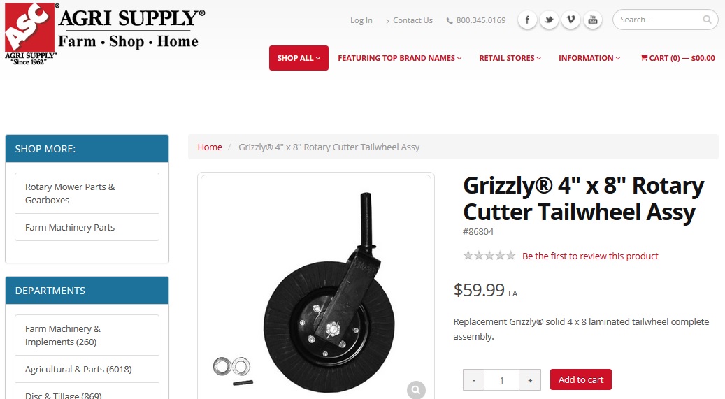

soldier415, with a topntilt you shouldn't need a hydraulic gauge wheel.
al2, make sure when you fit a gauge wheel there is enough room for the wheel AND the gravel or what ever you are pushing.
Also set the down speed on the 3ph to medium decent or slower as if someone drops the blade you may have a bent gauge wheel arm at the receiver hitch.

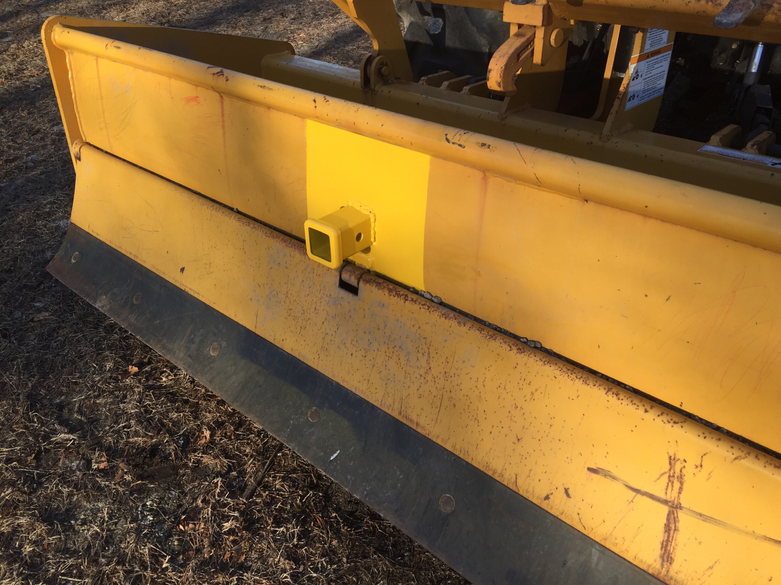

Soldier, your road is looking pretty good in my opinion. In a short amount of time it looks like you've made a lot of progress learning the blade.
In the link to the gauge wheel I posted before, it did list a manual kit for about $550 if you were interested.
Al,
That's a good idea to add a gauge wheel in the receiver hitch location. I had welded a hitch on my box blade to tow around my log splitter, but never thought of the gauge wheel.
I can actually see the value of having a gauge wheel on the box blade as well, albeit not as much as the rear blade.
Here are a couple pics of the receiver hitch I have. Please don't mind my welds, as you can tell, im an amateur at best.
If you get this, all you have to do is fab up everything around it!
