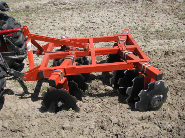

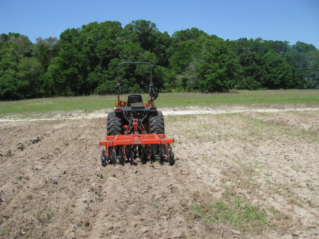

Yes, you need a Bush Hog type Rotary Cutter, or a Flail Mower, not a Finish Mower.
Almost no one plows for food plots. A pass or two with heavy, 3-Pt. hitch mounted Disc Harrow is usually sufficient to cut up the surface in preparation for seeding and then, ideally, a Cultipacker is used to roll in the seed and prevent erosion. Plows are not that easy to find and not that easy to adjust. A Disc Harrow is suitable, relatively easy to use, faster and half the price of a GOOD plow. It can take two seasons to develop a lush food plot.

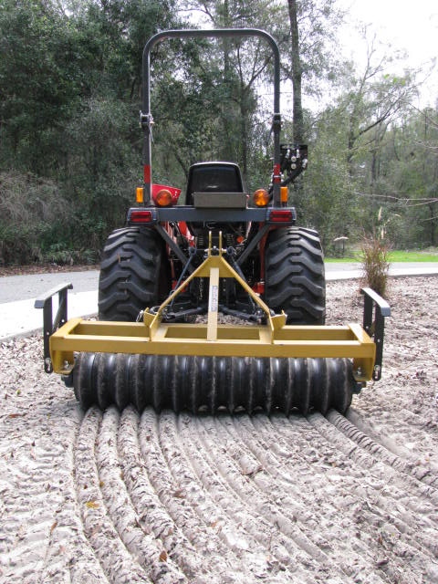

Road implements to consider are: Box Blade, Rear Blade, Landscape Rake and/or Land Plane. You can really get OPINIONS on which are best for road maintenance on T-B-N. If your road is 3"-6" gravel, consider an easy-to-use Land Plane first. With a one mile road a Land Plane would be worth its cost in time saved and ease of use.
~I do not understand "mowing" the road.~
I am a great fan of the Ratchet Rake. Consider this $300 attachment for your FEL bucket both for food plot preparaton and road maintenance.
If you have not operated a tractor before you are likely to find tractor-ing intimidating the first 200 hours. Go slow; think SAFETY. The Operator is the most important safety feature on any tractor.
