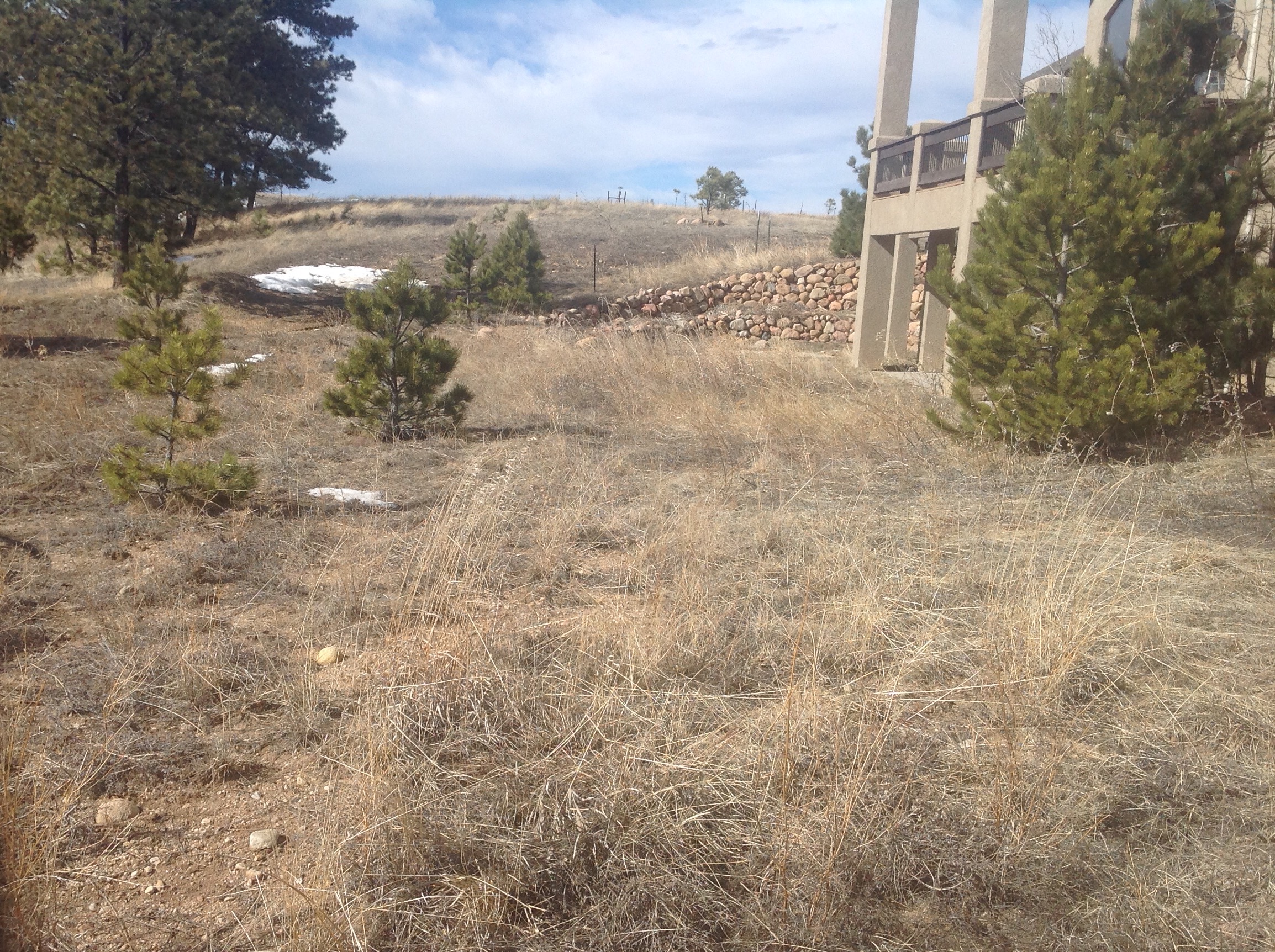

We just moved to a 35 acre property in Colorado. The land is rolling pasture with some widely spaced evergreens and a pond.
So I appreciate any suggestions for dedicated mower models to look at ......
So here's a thought. If you aren't quite ready to put down big $$ for a CUT and implements, but you want to tame the land a bit around your house sooner rather than later - then Axelhub may be on to something. Buy a cheap ($500?) used lawn tractor you can use and abuse in the tall grass. Something 15+hp and the higher it can lift the mower the better. Also, a deck with 2 longer blades is better for rough cutting than a wider one with 3 shorter blade. I cut trails over 3/4" brush and (hidden) stumps with a 15hp MTD with a 44" deck. These mowers are tougher than you think if you have the courage to plunge forward into the tall stuff. I do walk it first to look for the obvious obstacles.
That's not your long term solution, but it gets you a "yard" around your house. When it's done, you can sell it (if it's still working) and buy a nicer mower.

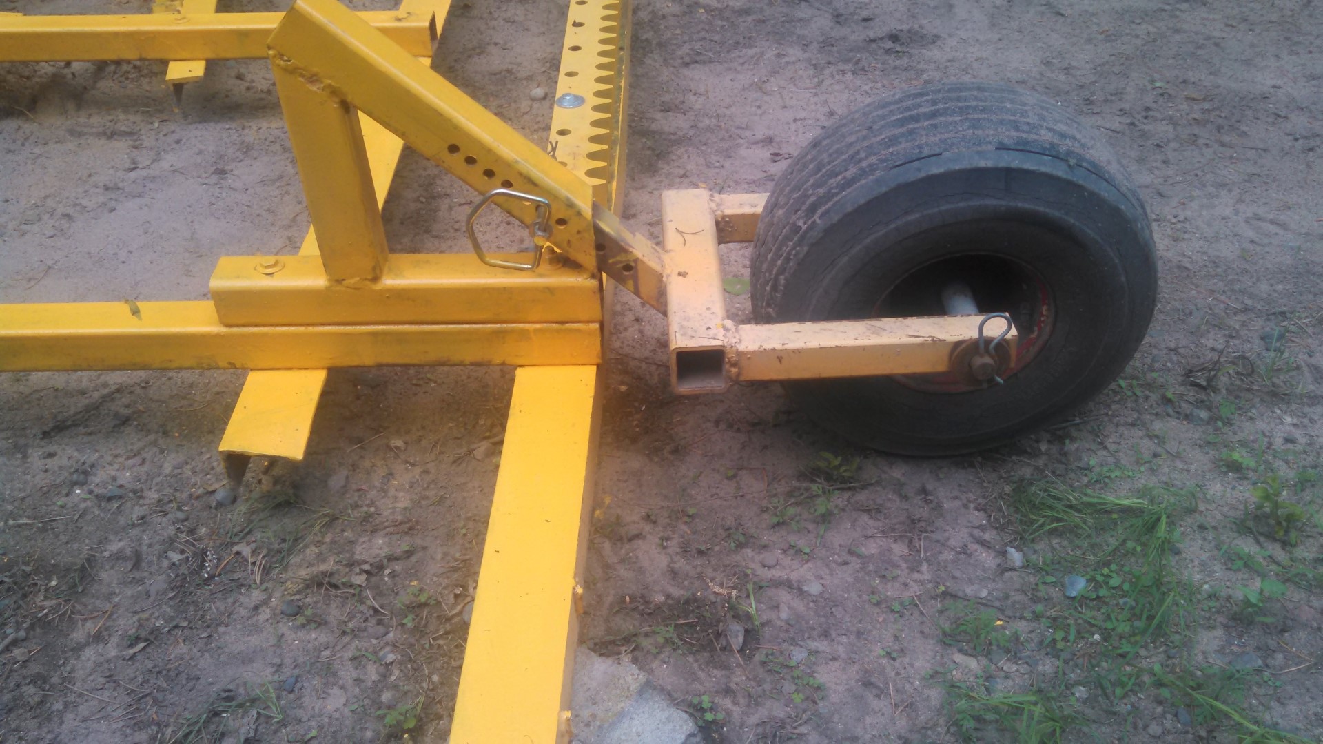

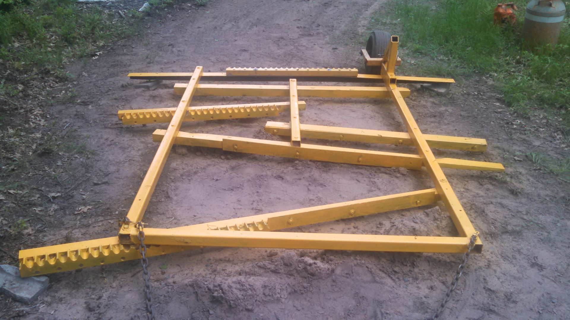

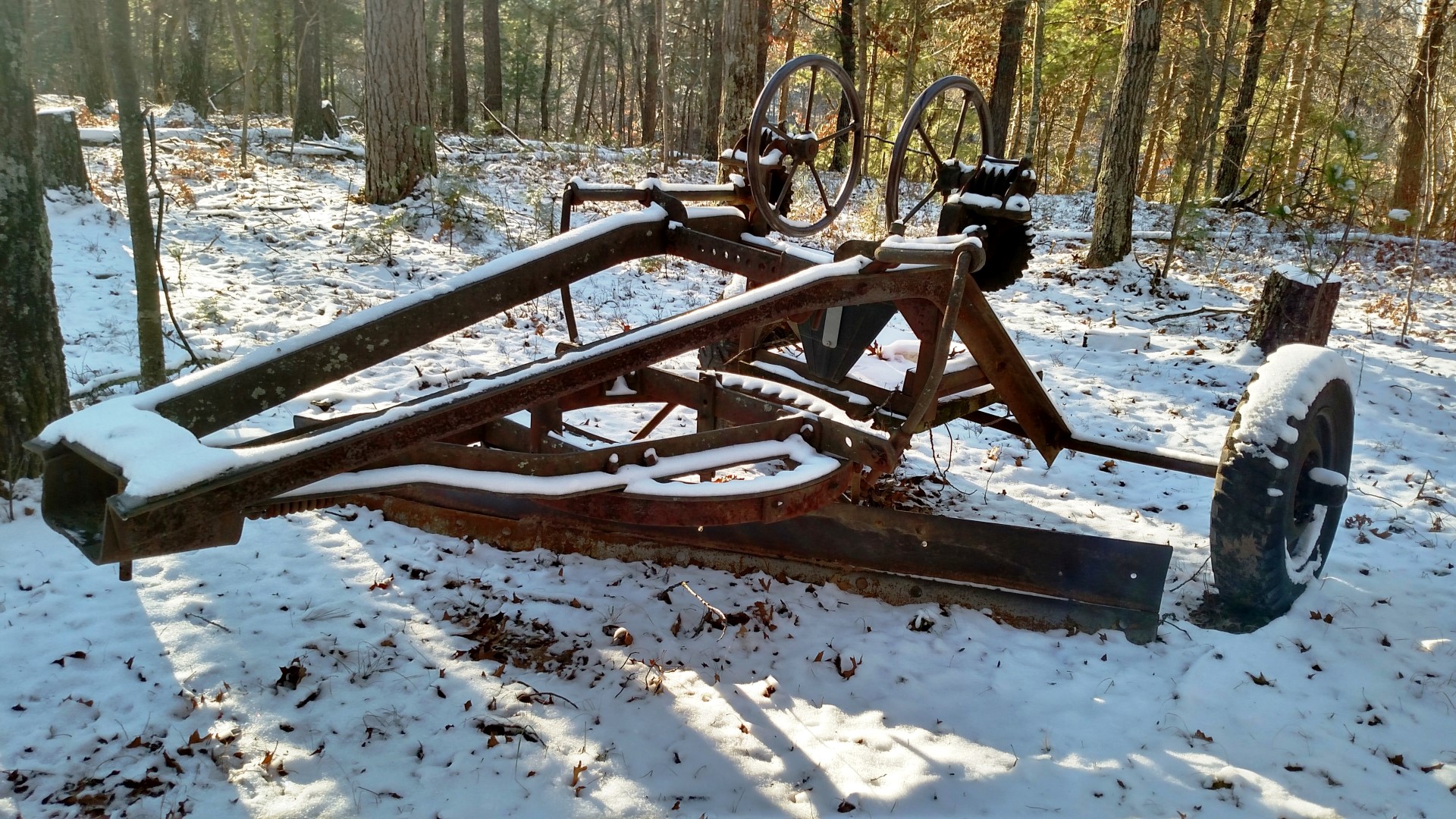

The drag actually maintains the crown pretty well. If you look at the pictures or video, you can see that there is a guide wheel that slightly elevates the left side of the drag, and that keeps a crown in the center of the road. It leaves a very smooth surface. That said, I have also attached a picture of my (old) secret weapon for establishing crowns and road contours. Those old pony graders are awesome!
I have been adding gravel to the road over the years, and that really helps. I have also been eliminating any place where water could pool (puddles), and making diversion ditches on hills to slow the velocity of water running along the side of the road during down pours. Good drainage makes for good roads. Easier to keep it up (the drag), than let things go and do bigger repairs. I hope that more fully explains.

Seems as though you have your driveway situation under MUCH better control than I thought.
Your "old secret weapon" is a great thing to have. I looked, but never could find one.

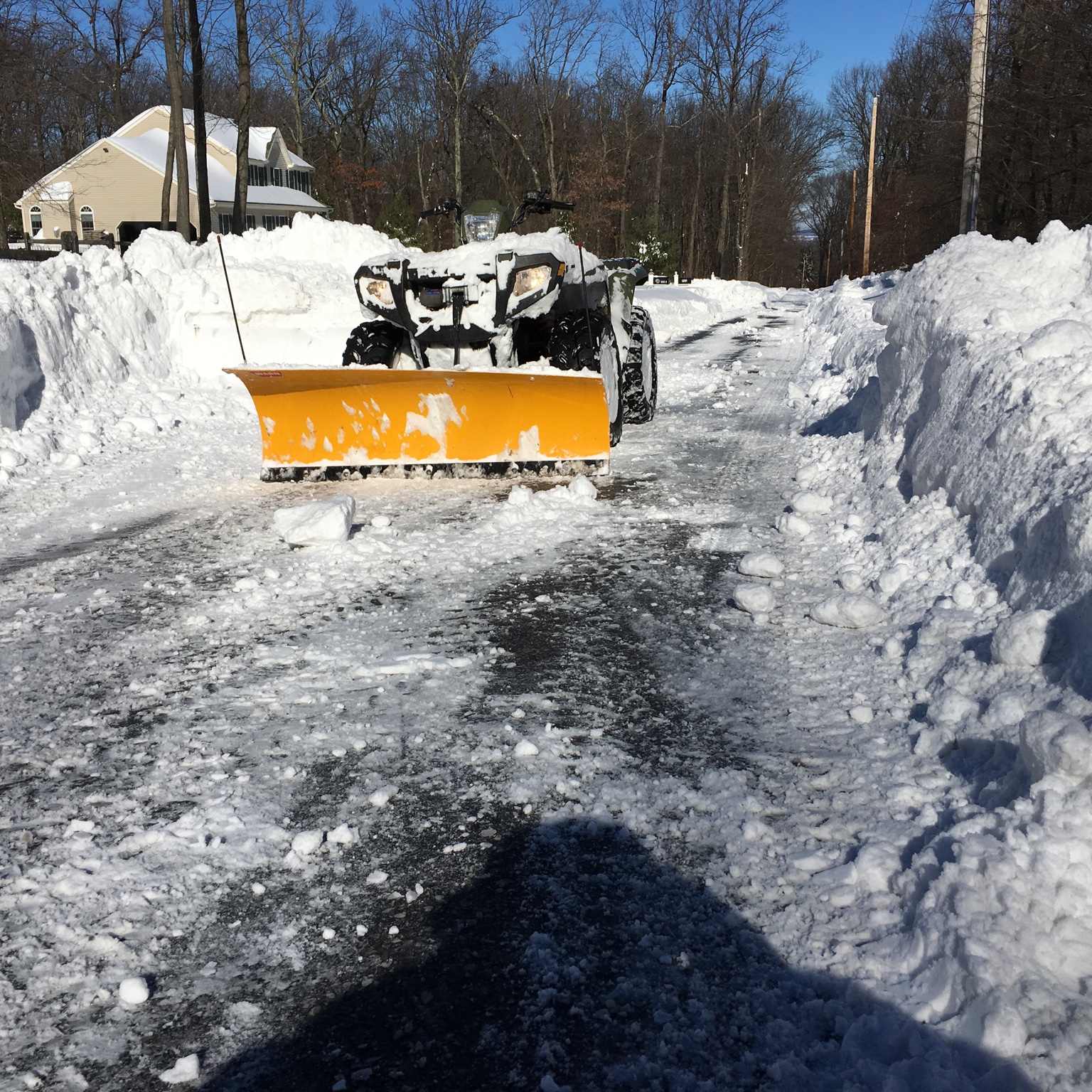

32 inches of snow, one ATV.View attachment 460269
Nice! I grew up in NE PA and don't recall too many blue sky days like that in winter. You were very lucky to have such a nice day to clear all that snow. I bet it was a lot wetter and heavier than we get here too.

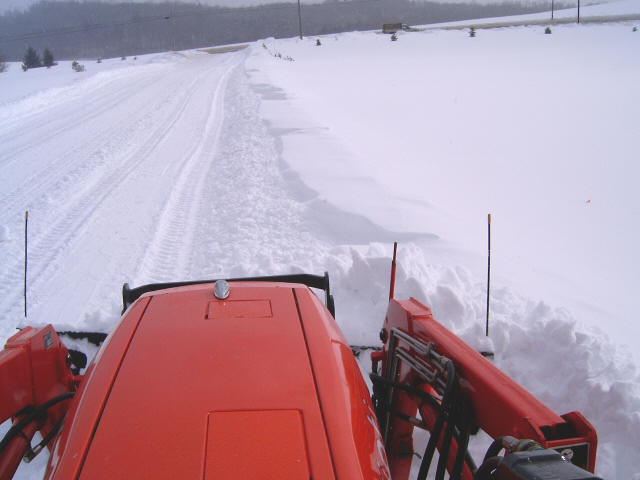

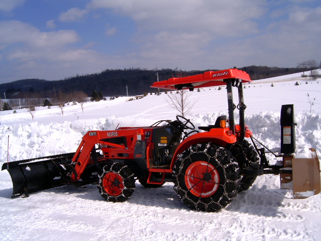

Someone asked what you need 35+ HP for. The answer is snow. 800ft of drive and half a mile of road is impossible with a SCUT. Period. There is no way a SCUT is going to clear a 18+ inches of drifted snow off that length of road before the spring thaw does. 35HP is nearly impossible, it will take you all day. I really struggled the say my road drifted over with about 2 ft. of snow. In fact it took the neighboring farmer's 300HP JD Row Crop tractor with a front blade to really clear it. (that was the day I realized that I would never have enough tractor). The only time I max out the tractor is in the snow. 4WD, LO, Diff lock, going in reverse there are times I'm still sliding. Loading the tires would help, but not a solution. With 35HP you could at least conceivably get out and clear the road. A bigger tractor makes it go quicker. Here weight is way more important that HP, so look at that.
Loading the rear tires on my 35 HP tractor helped very little for snow plowing.
Chains make a HUGE difference.
Before chains my 35 HP tractor with loaded R-4's struggled to get out of its own way trying to push snow..
I now run chains on all 4 and with a 9' power angle snow plow can push some snow. (we have a 650' driveway that drifts)
Between the 9' blade on the front and a snow blower on the rear. I think my 35 HP tractor could handle that driveway and roadway with little problem.
