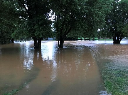

Bigger is not always better an L2501 will lift less and weighs less than Mx 4800 obviously with wet ground putting more weight out especially on FEL means more ground compaction ruts and sinking etc.Your situation is a little complex with wet ground most of the time.I feel no matter what size tractor you go with you need to know it痴 limitations take your time and work can get done.You may want to hire or if you got experience rent a machine to get started and maybe get yourself some paths set up to run a tractor on I know loggers will lay small trees down to run on in wet ground.There are mats used with excavators in wet ares to keep them from sinking may be an option to get you started to eventually get your tractor in there ?? Good luck on tractor and ground
/ First tractor - wet ground... ? #45
The wheels and tires on a 3,700 pound MX are much larger than the wheels and tires on a 2,700 pound L2501. I doubt if ground loading with an MX exceeds the ground loading with an L2501. If optional bulbous radial tires tires are ordered for the MX ground loading may be less with an MX.
Based on FEL lift capacity the L2501 will require twice as many trips into the wet area; each trip mushing the damp ground further.
If logs are towed out, each tractor should be able to pull about 75% of operating weight.

Since not everyone realizes this, I'll just point out: Ground pressure is basically exactly equal to the air pressure you put in your tires. So if you have a little tractor with 15 psi in the tires, or a big ***** tractor with 15 psi in the tires.... they both put 15 psi onto the ground. Contact patch area of the tires expands to carry the weight of the machine proportional to inflation pressure. Since most manufacturers supply tires sized adequately to carry their machines, the mud-bogging potential of a tractor doesn't really depend on it's size.
Caveats include: Do bigger tractors require more tire pressure for safe performance (fronts, especially)? And obviously the tire type and flexibility play a big role - R1s with rigid bars concentrate the load.

Yes, the contact patch of the tire will roughly shrink in half, and thus the specific pressure will just about double, to carry the same total weight of the tractor. This logic is sound for smooth tires but I think R1's with inflexible lugs/bars may not respond as linearly.
So Lou, this is probably what happens in your case. If the tire can't flex much to expand the contact patch, it will certainly exert more ground pressure if you load up the tractor weight. It's pretty hard to visually determine tire contact patch area though. A tiny bit more sidewall squat can make a big difference in the true effective patch underneath.
