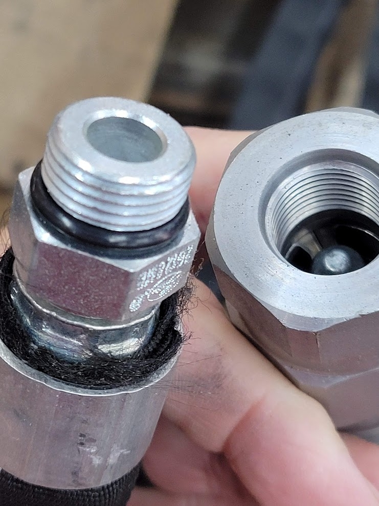

Jan 23, 2024 / fitting type #1 JCoastie Platinum Member Joined Aug 29, 2020 Messages 846 Location Coastal AL Tractor LS MT240HE New auger arrived today with flat face couplings. I need to change them to AG 1/2 NPT poppet type. What type are these so I know what adapter I need? My 1/2 NTP quick connects screw on loosely, so it is 1/2" but what type is it? Attachments Auger_Hydraulics.jpg 365.2 KB · Views: 96
Jan 23, 2024 / fitting type #2 O oldnslo Super Member Joined Jan 20, 2010 Messages 8,790 Location Northern, IL Tractor Branson 2400H, JD X540 That is an SAE O-ring boss straight thread fitting not NPT. #8 SAE is 3/4-16 thread #10 SAE is 7/8 - 14 thread #12 SAE is 1 1/16 - 12 thread
Jan 23, 2024 / fitting type Thread Starter #3 OP JCoastie Platinum Member Joined Aug 29, 2020 Messages 846 Location Coastal AL Tractor LS MT240HE Thanks, headed to a local hydraulic shop this afternoon, hopefully they can fix me up.
Jan 23, 2024 / fitting type Thread Starter #4 OP JCoastie Platinum Member Joined Aug 29, 2020 Messages 846 Location Coastal AL Tractor LS MT240HE Got the adapters, they were #6, just traded the flat face connectors that were not useful to me. Win for all. Last edited: Jan 23, 2024
