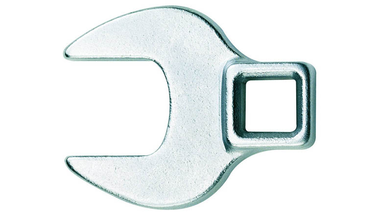

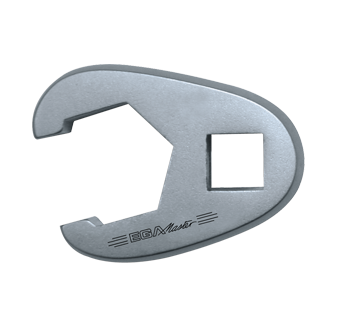

crows foot wrench.jpgLlaves-_LLAVE_HEXAGONAL_CROW_FOOT_-LLAVE_HEXAGONAL_CROW_FOOT.png
Crowfoot, straight and flare nut

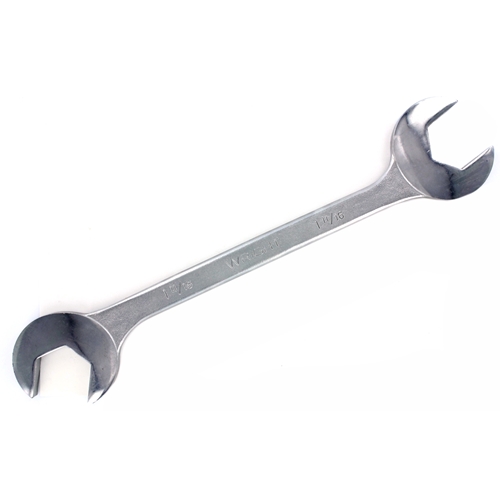

I was thinking more like this.
