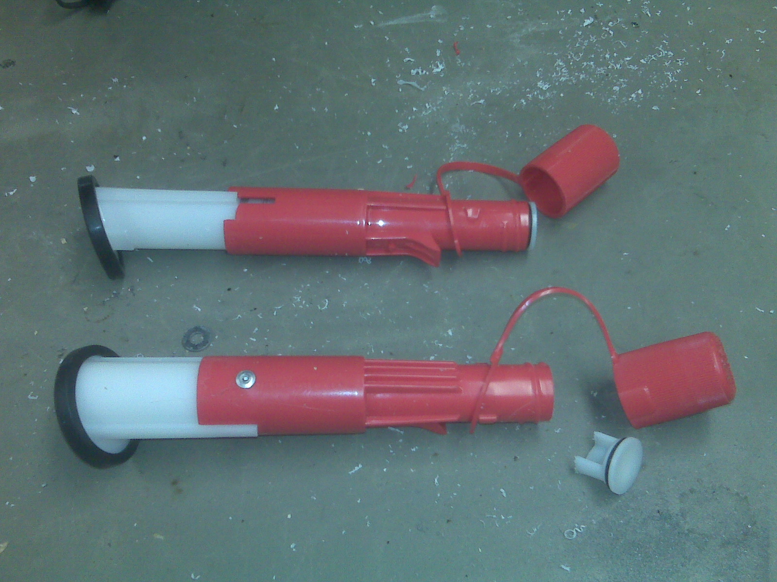

Yeah, and they are after me for posting my "fix" here to keep the safety spouts open...:laughing:

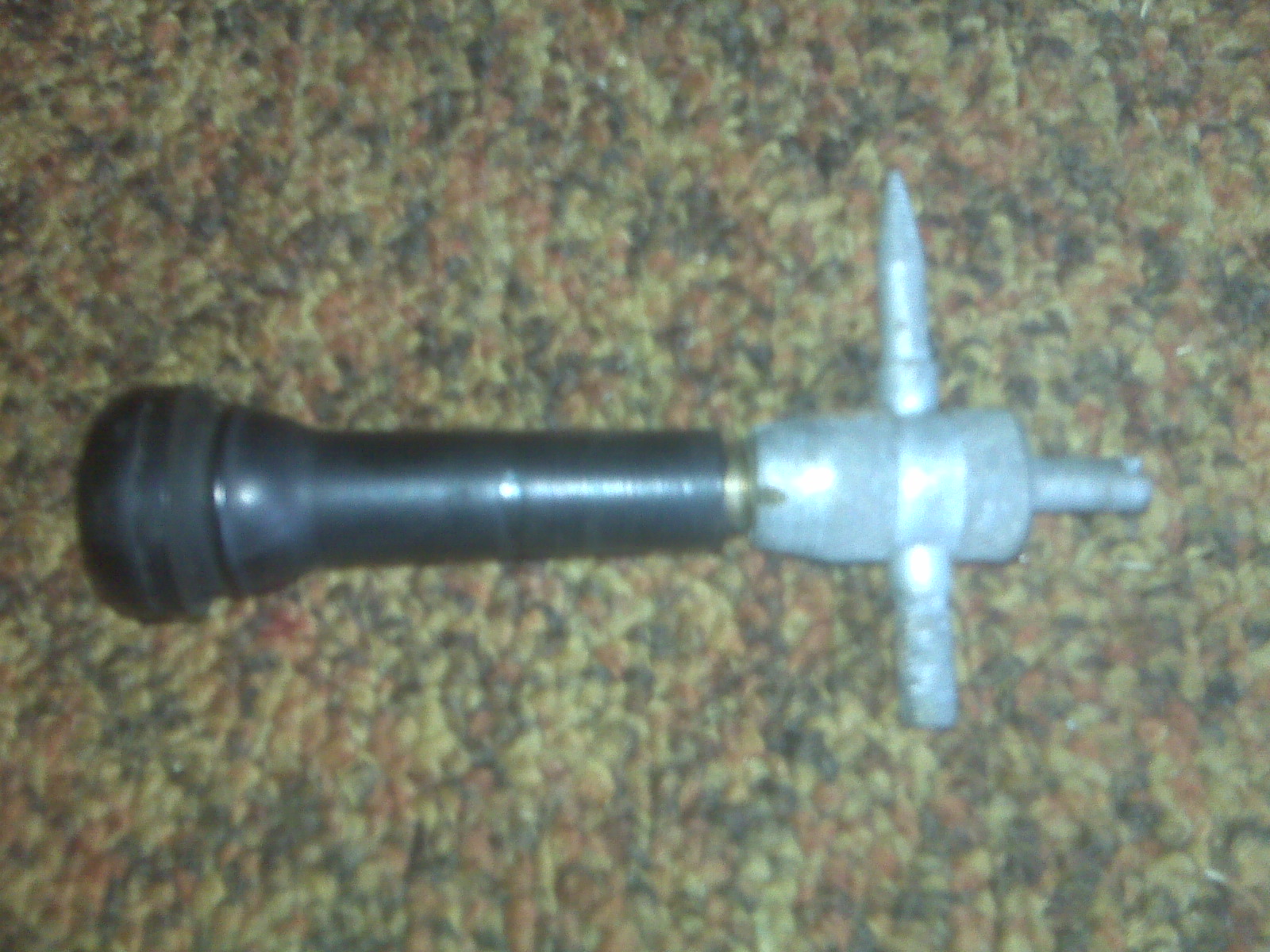

I noticed you have one of those EPA compliant gas cans that takes forever to empty and you spill more than the old cans that had a vent. I bought a bunch of these at NAPA and drilled a hole on the opposite end from the spout, then used a string to work a tubeless tire valve up into the hole from the inside and hooked on a puller and pulled it in. Then you take out guts and you have a cheap ($1.00) vent that works fantastic, doesn't leak, and you can find a new cap real easy when you lose or misplace it. Try it, you'll like it...............
This is a great idea! My plastic can implodes so much when it gets cold outside it will crack one of these days. I'll use your idea and leave the cap on the tire valve just a little loose to cure the problem I am seeing.
Does the fuel eat at the rubber tire valve any?

About using a tubeless tire valve to vent a safety spout gas can, an excellent idea but because my two new cans are for diesel fuel and always indoors I am going to pass on venting them. As for installing the valve stem, I have installed a number of those valves on car rims, and you don't really need a special tool for that, unless you count those little tire valve tools that are for rethreading valve stems or removing the tiny valve inside. I can install a valve core in a car rim using just an open end wrench to lever up the "T" on these.
Nice fix! does it help speed up the flow any? I've been looking for some 'black market' spouts that work better and am toying with the idea of just drilling a small hole and then covering it with grey tape when its in storage.
