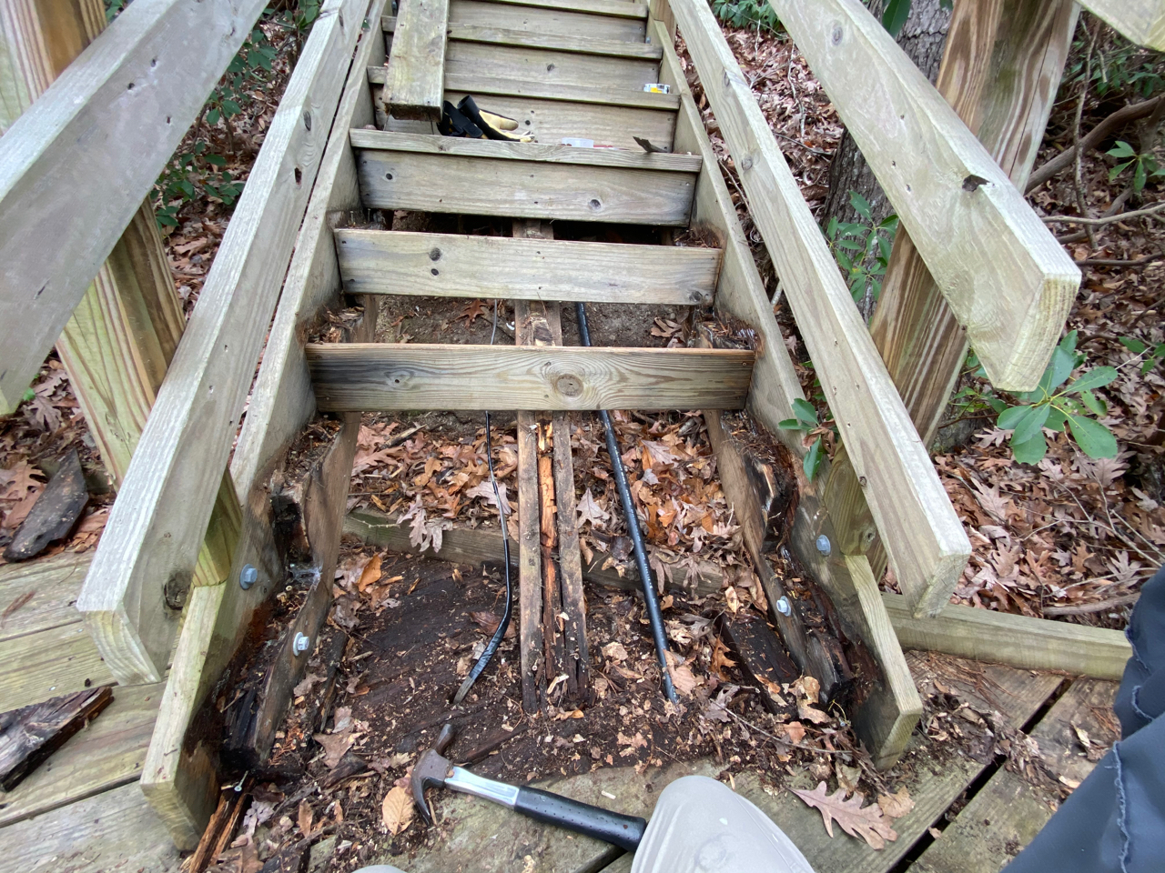

Wanted to bump this thread with some pictures. I had started pulling apart some steps to repair rotted areas, then we had a bad storm last weekend and a tree came down on the middle section of steps. So I am basically rebuilding one flight of the steps now.
PRIOR TO TREE FALLING:
AFTER (not many pics, I was busy with chainsaw and tractor on the side of a hill):
I think what exacerbated the rot problem was the stair design I used, which sistered a 2x10 stringer against a 2x12 for stiffness. It let water collect and soak into all the cut ends of the stringers, and trapped water between the boards. But in looking at the labels on the old lumber, it was a lower treatement level than I can buy today, so the treatment wasn't great. On top of that, some critter (possibly a fox) had made a den under the bottom 3-4 steps and that most certainly accelerated the rot in that area, and on the deck where the steps rested. To add insult to injury, looks like a mouse chewed on my electrical wire, so that needs replacing too.
For the new steps, I am using only 2x12 sides and using galvanized angle brackets to hold the treads, which will be a single 2x12 36" wide. No stringers. There will also be no risers. I prefer risers for the finished look, but that's just more wood and joints to trap water and rot.
The middle deck is being rebuilt today. I am using marine lumber for the beams and ground-contact 2x8 for the joists and deck boards. I have a bottle of copper treatment to paint on all cut ends.
I have mixed emotions about this rebuild. On the one hand, I want to do it right and avoid rotting so that the steps last longer. On the other hand, a tree could fall in a future storm or hurricane and take them out again. Just have to accept the risk I guess.
I'll post more pics as I make progress. Working on a hill sucks. I lost the 3/4" socket off my wrench yesterday when I accidentally hit the button on the wrench. The socket made a bunch of bounces on the way down the hill before it launched into the water.

From your pictures, it sounds like you figured out the problem. I'm not a fan of bracket to support steps because then tend to loosen up over time. For me, I want a stringer every foot to 16 inches. I think 18 inches between steps is pushing it. Once I figure out the math to cut the first stringer, the others are easy.
I also try real hard to have my stringers sitting on concrete.

Any closed stringer is going to promote rot no where for moisture to escape . Can't tell from pictures but it looks like stringers are sitting on ground . The higher you can get them off the ground to facilate air circulation and the ability to remove leaves keeps critters from building homes in the nooks and crannies. My grand mother made me make a set of stairs like that closed stringer [riser boards] because she was afraid to look through open risers:confused2: I told her there was no place for leaves and snow to go but she wanted it. After a few years it was a yearly project replaceing boards that rotted out. After 10 years so much was replaced had to rip it out and start over again. Pt lumber sucks.:drink:

It's a 30-35 degree slope, so about the same as a 8/12 roof. Not as scary as a roof but slippery in some spots. I still have the old center stringer attached at the top to help me move up and down. Once that comes out I will put in a rope for sure. I remember when building the stairs the first time, going down that rope with sacks of concrete, posts, etc on my shoulder, and it was crazy. I am not young enough to do that anymore.
I agree on the spacing -- I plan to install a couple test treads and see how they feel. A 2x12 is pretty stiff over 36" but we'll see. If there is any flex (which would be bad for the brackets) I will either add a stiffener under the tread or add a center stringer of some sort.
The closest these come to the ground is about 4". But pack leaves and a critter nest in there and it may as well be on the ground. The bizarre thing is that the boards did not rot on the bottom where they were close to the ground. They mainly up above rotted where the stringer and outer 2x12 came together, and where the treads and risers touched the stringers. There were other scrap boards used to prop up the stringers 6 years ago in full ground contact, and those looked fine! So I think the main issue here was trapping water and having no air circulation. Hopefully the new design will improve that.
I know my wife won't like walking up the stairs when she can see through below, but it's obvious to me that a closed design isn't a good idea in this spot. There is another long flight below that is 6-8' off the ground (and over water) and those are still in good shape so I will leave them alone. They get sunlight and that probably avoided problems. But eventually they will need replacing and I would go with open treads there too, so everything looks the same.
If I had the money and access, I would get steel/glavanized steps made up with grating for treads. Those would probably last forever, pending trees coming down.

Working from home gives me a couple extra hours every day, so I have been able to get a move on the new stairs and knock them out quickly. Thankfully I had bought materials and hardware weeks ago.
(Note top step isn't installed yet, since I need to access the area for electrical).
I am surprised how solid the stairs feel -- this design uses about half the lumber as before, and there is no center stringer. Despite that, they are very solid and there is no bounce when walking.
Since there are no risers to brace the stringers cross-wise, I think the stringers might want to twist or "rack" if anyone leans on the hand rails (when they get added later). So I might put cross braces between stringers next to each pair of hand rails to tie everything together cross-wise.
For railings, I can salvage the previous 4x4 posts. I'll do a 2x6 and 2x4 along the top for a handrail. Instead of side rails, I might try something using thin cable. Sort of like those expensive cable rails you see on modern decks, but maybe done on a budget.
