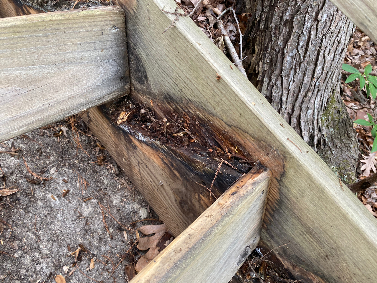

I'll have to see if I can find a tag to know what the treatment level was, but it was basic off-the-shelf 2-by lumber from Lowes. It ain't doing great!
For those asking, there are regular stringers hidden out of sight, sistered to the inside of the outer 2x12 board. In retrospect, I don't think this is a good design for dealing with moisture, although I have used the same design on three other sets of stairs on my property that have zero issues. And the rot is just on about 10 steps out of the 45 going down to the pier. So I either think those steps get wetter and get less light/air, or it's just crappy treated lumber.
Thanks for all the responses so far guys, it helps! I plan to pull off a couple treads/risers this weekend and see how bad it looks underneath.
OK... If it was from Lowes you got .25, the .40 is rated for ground contact. The .40 will be more in price but worth it.
   / Fixing and caulking rotting joints on exterior wood stairs #22
I'm going to skip my usual procedure and not read all the responses. I'm going to posit that the original builder of this deck - you or otherwise - just cut the boards and installed them. That is likely the root failure. The treatment does not typically soak the entire thickness of a board as the manufacturers do not/cannot allow enough time in the treatment process for this to occur. Thus any cut ends expose what is essentially untreated wood in the center. And it rots. Go figger. You can go to any paint type store and get a gallon of the treatment chemical. It is nasty stuff. Only use it outside with gloves, and a face shield to avoid any splashes in your eyes is a wise move too. Slop it on any and all cut faces/ends/etc, and anyplace else it looks like the treatment did not get to.
Yes, you will also want to do things to avoid any puddling of water so they deck/stairs can drain, but if you do not treat the cut ends, you have started the clock ticking much faster than it should.

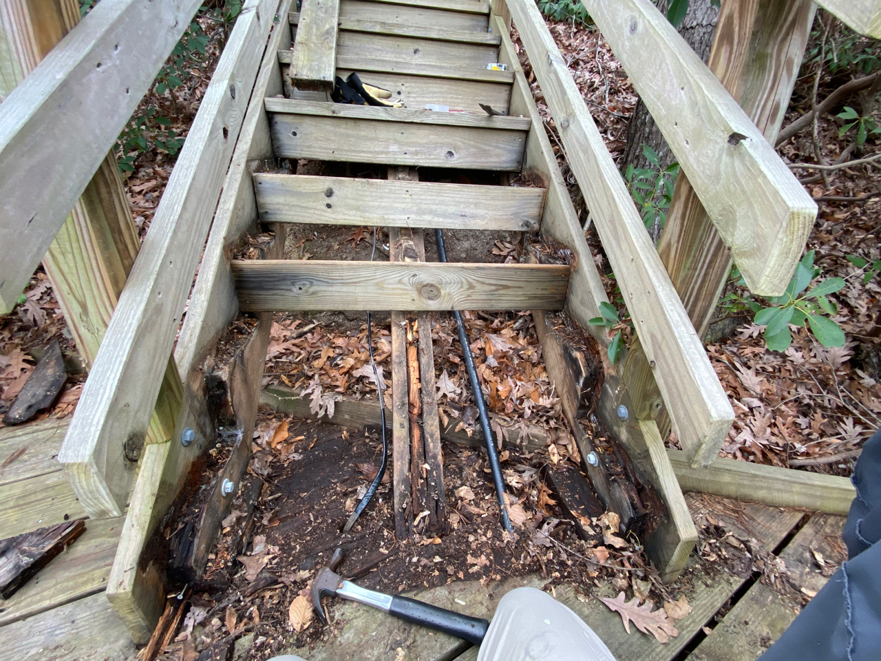

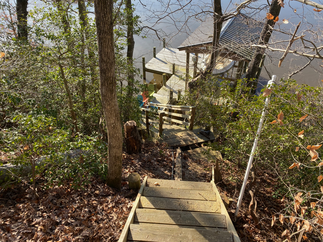

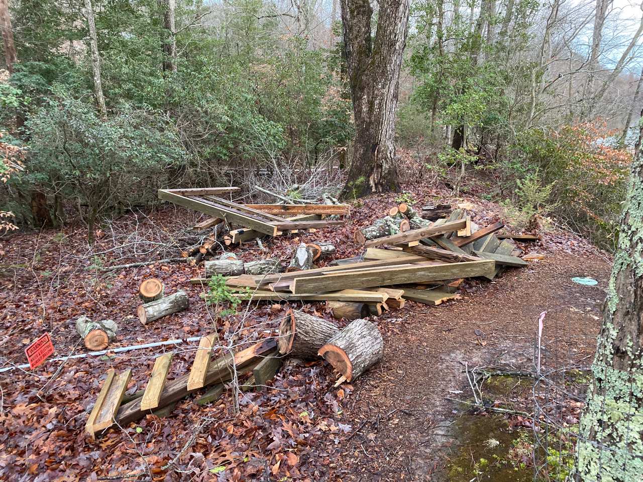

Wanted to bump this thread with some pictures. I had started pulling apart some steps to repair rotted areas, then we had a bad storm last weekend and a tree came down on the middle section of steps. So I am basically rebuilding one flight of the steps now.
PRIOR TO TREE FALLING:

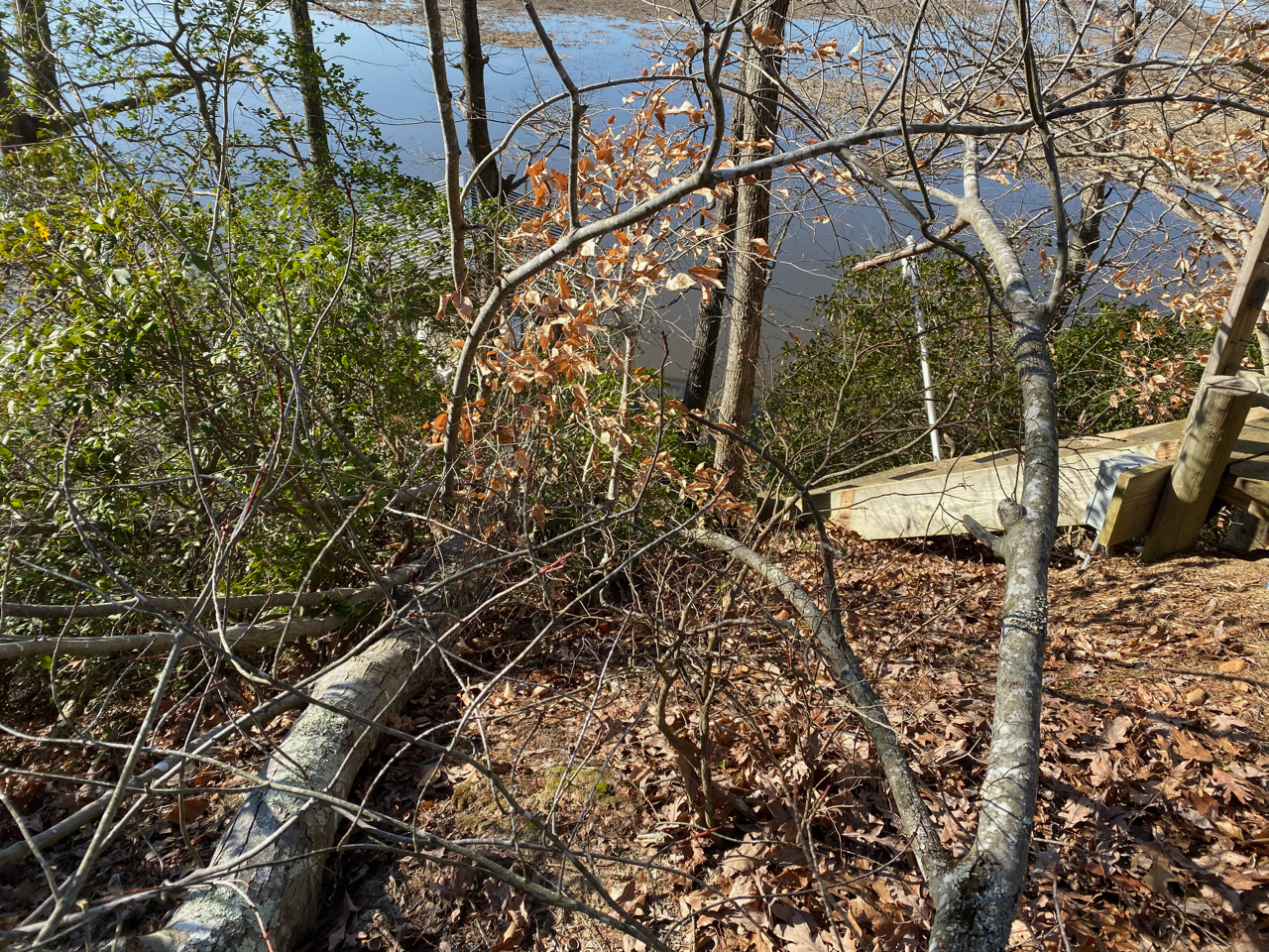

AFTER (not many pics, I was busy with chainsaw and tractor on the side of a hill):

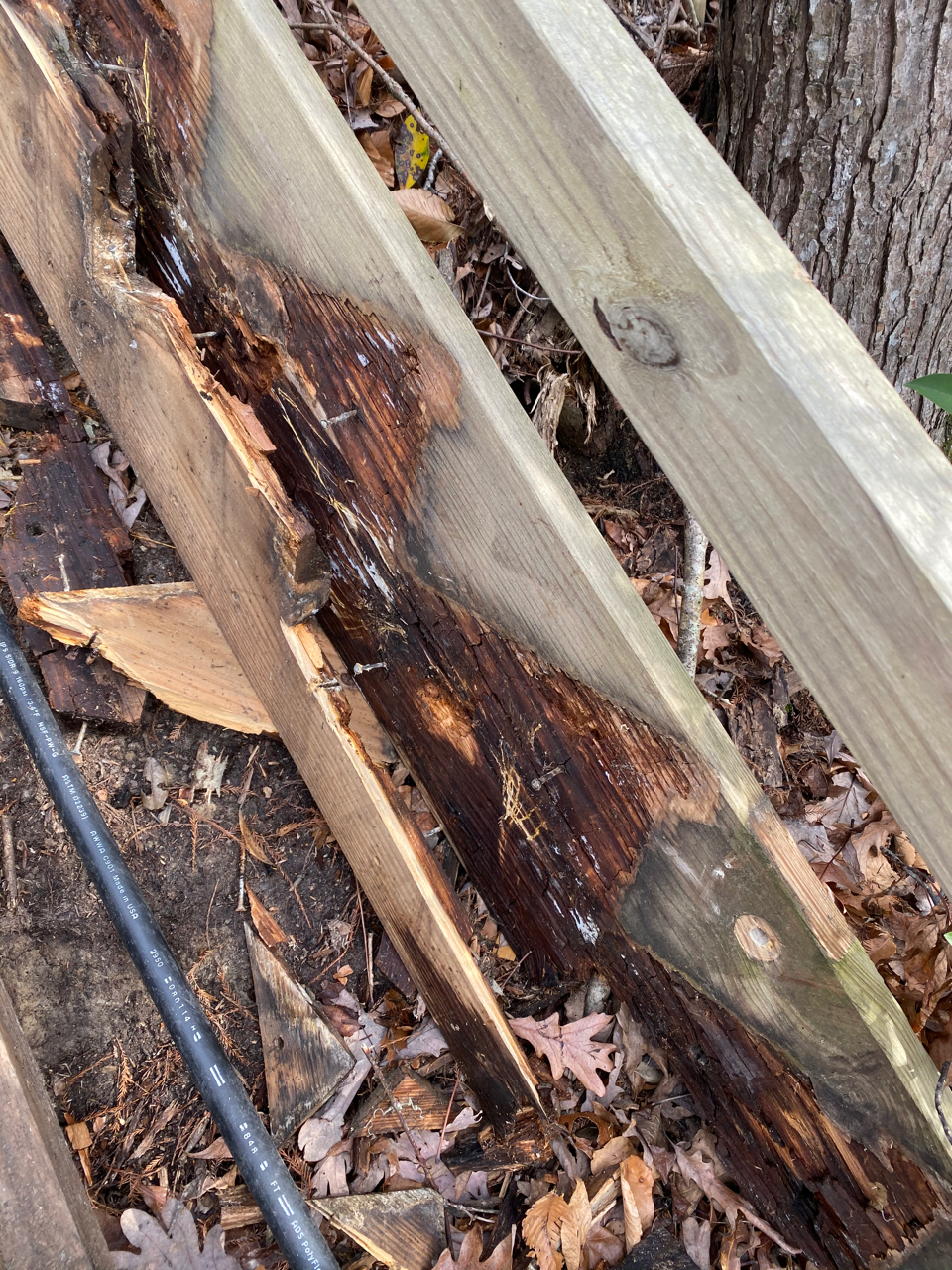

I think what exacerbated the rot problem was the stair design I used, which sistered a 2x10 stringer against a 2x12 for stiffness. It let water collect and soak into all the cut ends of the stringers, and trapped water between the boards. But in looking at the labels on the old lumber, it was a lower treatement level than I can buy today, so the treatment wasn't great. On top of that, some critter (possibly a fox) had made a den under the bottom 3-4 steps and that most certainly accelerated the rot in that area, and on the deck where the steps rested. To add insult to injury, looks like a mouse chewed on my electrical wire, so that needs replacing too.
For the new steps, I am using only 2x12 sides and using galvanized angle brackets to hold the treads, which will be a single 2x12 36" wide. No stringers. There will also be no risers. I prefer risers for the finished look, but that's just more wood and joints to trap water and rot.
The middle deck is being rebuilt today. I am using marine lumber for the beams and ground-contact 2x8 for the joists and deck boards. I have a bottle of copper treatment to paint on all cut ends.
I have mixed emotions about this rebuild. On the one hand, I want to do it right and avoid rotting so that the steps last longer. On the other hand, a tree could fall in a future storm or hurricane and take them out again. Just have to accept the risk I guess.
I'll post more pics as I make progress. Working on a hill sucks. I lost the 3/4" socket off my wrench yesterday when I accidentally hit the button on the wrench. The socket made a bunch of bounces on the way down the hill before it launched into the water.
