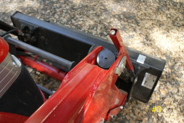

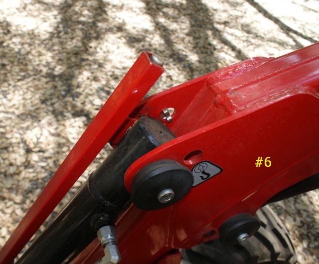

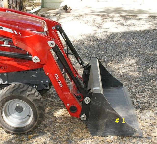

I made one from scrap pile parts.... Don't know why any would pay to buy one.... It is used with almost all my FEL work ...

Dale, that's the kind I prefer. I cut an additional 2" off the top half of the tube. I can see the rod end coming. I don't over run now.
Nice work!!!

IF the rod is even with end of tube, FEL is "level"... IF rod is out of tube bucket lip is in a "up curl" position, if rod disappears in tube bucket lip is in a "down curl"....

Yep. And if you are raising the bucket back to level from the dump position you stop with the end of the rod even with the end of the tube. If you notch off a couple inches of the tube you can see the rod coming and not over run. :)

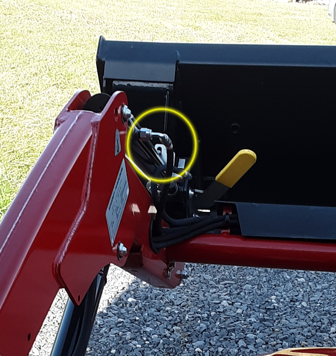

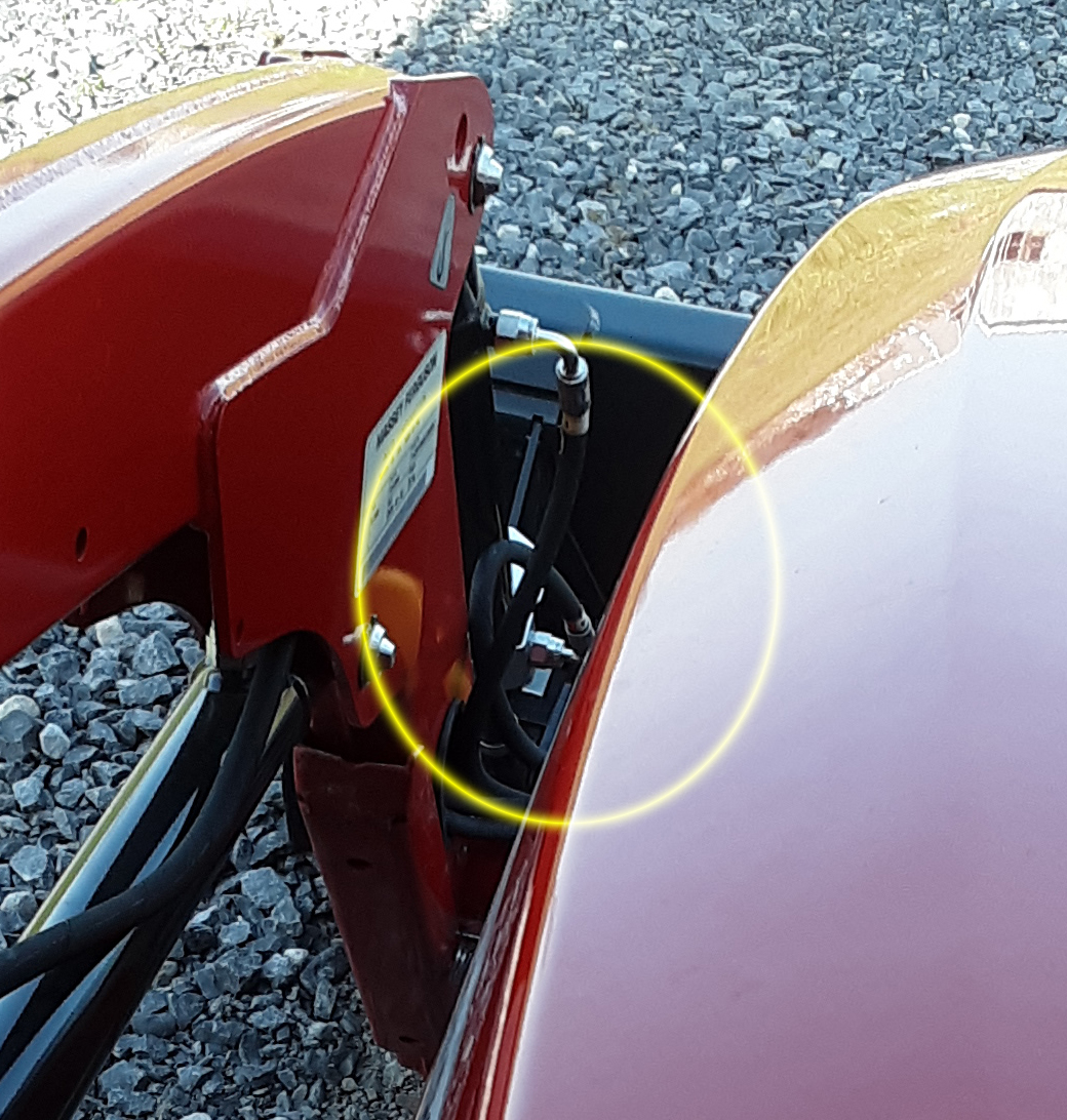

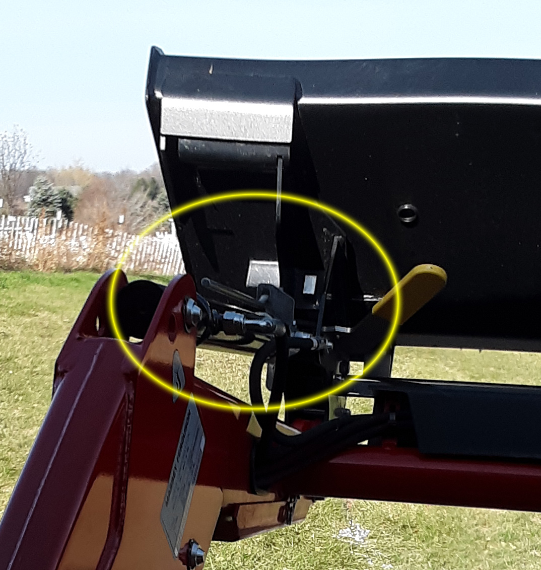

So, after the snow I got this past monday, after trying to use the bucket to move snow because it was not enough to get the blower out and too much to leave it. What I discovered is that a bucket is quite a bit more difficult to level by eye than other types of equipment I've experienced. Dug up a little. I'll probably get used to it after a while, but I decided that I needed some assistance or I'm going to have a mess to deal with in the spring.
Not having the time to fabricate something myself right now I decided to order this thing.... knowing full well that I could be throwing my money away. I figured if nothing else I could give others what I didn't have, that is a better idea of what it would be like using this thing.
So here is my review.
This thing is completely unusable with the bucket lowered. Here's a picture of it from the seat. It is impossible to see. There is simply no position to put yourself in, not even standing up, that will let you see it.
Here is another picture of the bucket raised about half way. This makes the indicator visible from the seat, but it needs to be in just the right position to see it through the crook in the hose. This is possible, but would require getting used to and may be hard to see at night, I'll have to try it the next time I'm out in the dark. It's possible that the headlight will illuminate it in this position.
Finally, this is a picture with the bucket raised higher. This gives the best view of the indicator (sorry, this shadows from the sun make this one a bit harder to see in the picture).
On a scale of 1 to 5 stars I would give this a rating of 2. It's usable, but only just usable. It will get me through this winter.
I would not recommend this to anyone.
Needless to say, next spring/summer when I have more time I will be looking at fabricating something more useful.

Good review. Undisputable with the picture evidence. I think you were generous. I'd have went with a 1.

I like the principle of this indicator and the fact that it is adjustable and I can set it so that my bucket is at an upward angle for winter.
But the rod needed to be longer so that the bend is above the lower FEL arm and the bracket should connect to the upper fitting instead of the lower fitting and the bracket bracket should be longer bringing the hole up above the lower arm to match the higher location of the bend in the rod.
