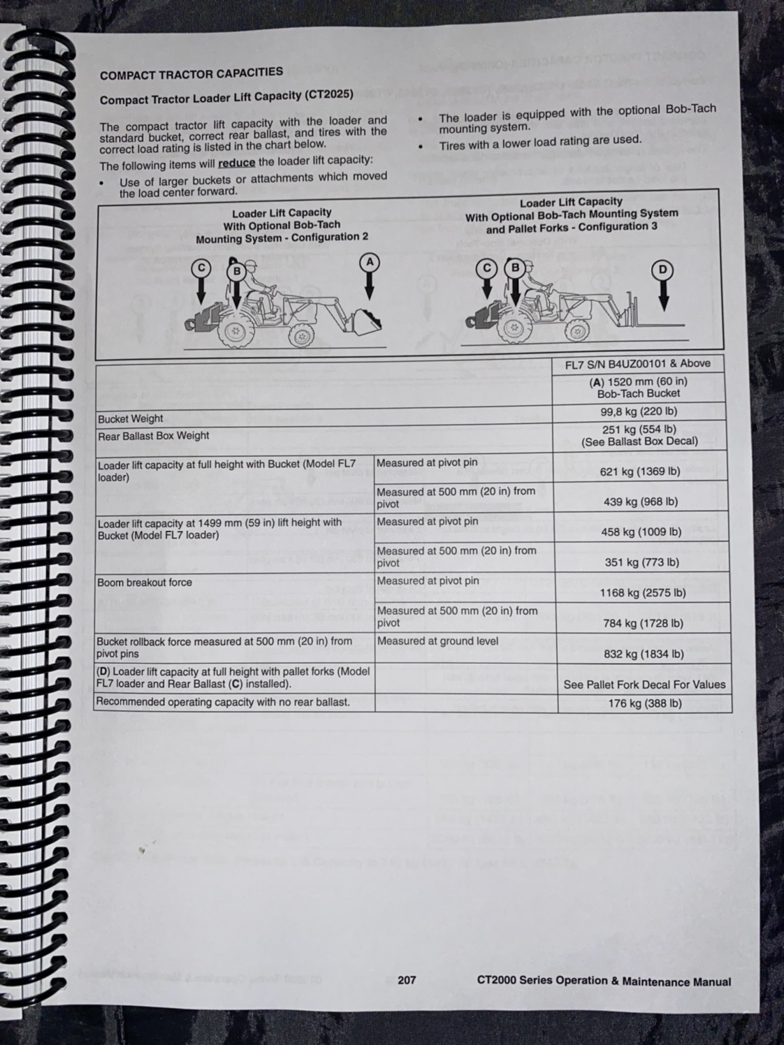

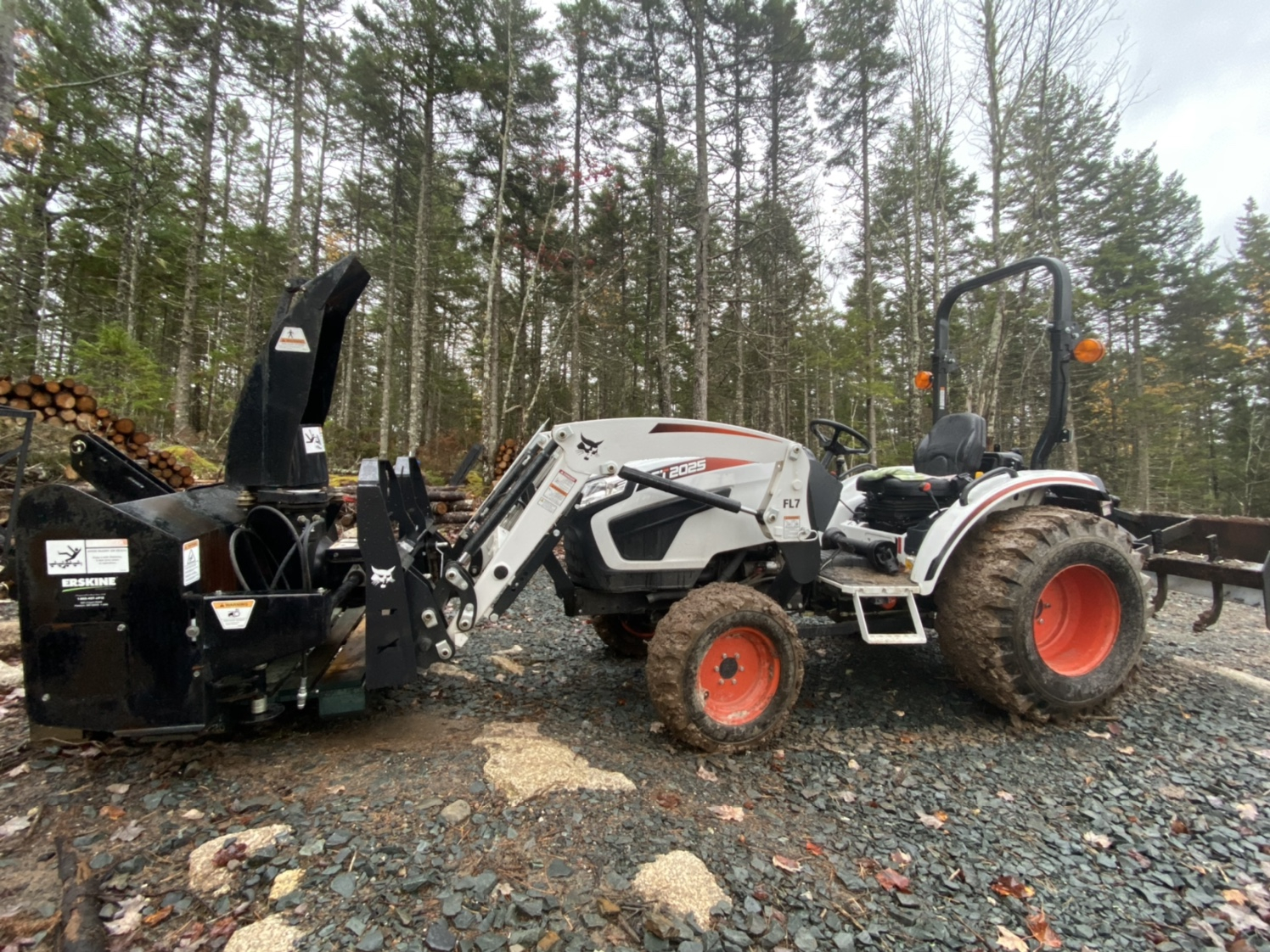

I just unloaded a snow blower from the delivery truck today, using the Bobcat pallet forks. The blower is in the 800+lb range, so with pallet call it 900lb. The center of gravity was within 600mm of the loader pins.
At truck deck height I was able to roll back enough and lifting was no problem. Once backed away from the truck and lowering the load to safe height I could not get the roll back beyond the amount shown in the picture. This resulted in the load not being level unless raising the load higher than desired for transport.
Considering rollback force is stated to be 1834lb 20” out from the pins at ground level, far exceeding the lift force, something seems wrong. Anyone else experienced anything similar with known weight or agree the dealer should be consulted? I don’t really want a warranty call to turn into a billable service call because they slap a gage on the hydraulics and say it’s in spec.

Looking at the manual again, I believe they made a mistake for the capacity at 59” off the ground. It makes absolutely no sense to have less capacity at 59” than at full height, the higher the loader goes, the worse the geometry for the boom cylinder.
Looking at the boom breakout force which is more relevant than lifting capacity since the issue was tested low to ground, the boom is quite close to the rollback in capacity, however the boom continued to lift effortlessly at higher heights demonstrating the reserve capacity with the given load.
Considering that the rollback force at 20” from pin is 1834lb, the entire 900lb I was lifting could have been near the tip of my 42” forks and there still should have been power enough to rollback. Am I missing something?

I does look like the bulk of the weight was more forward than 20" in the above picture. The weight being shifted more will drastically decrease capacity. With that said I have the FL8 loader and I feel like it struggles with curl sometimes. I move some larger oak rounds with pallet forks and also grabbing logs with the grapple. When grabbing something in the 700-800 pound range I typically have limited curl. The grapple does weight about 400lbs though and larger pieces are about 24" from the pins.

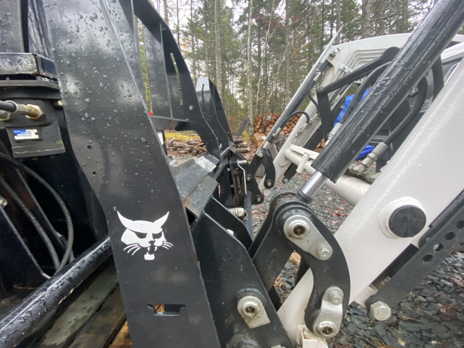

I tried from the other side of the pallet today (it’s about 40” wide so if center of gravity was too far forward then it should be favorable from the other side). Unfortunately the 3PH on the blower projected beyond the pallet so it kept me about 4” away from the pallet. I still couldn’t roll it back, might have been worse. In fact, I pushed the forks into the ground so I could roll it back which worked. When I lifted the load the dump cylinders could not hold the load and the cylinders extended until about the same position in the previous picture which is where the dump geometry begins to improve.

That is good to know, do you have loaded tires or any ballast on back when you lift the rear off the ground? I can't make the rear end budge, but the tires are loaded and I had a box blade mounted when trying to make this lift. I've never once lifted the rear tires off the ground in any implement configuration and I often get the bucket stuck in the dirt pile and have to reverse because I can't lift out of the pile.
One other thing surprised me, with the 42" forks level and about waste high off the ground, just my body weight (210lb) on the end of the light weight forks actually extends the curl cylinders and compresses the boom cylinders. Remove the weight and they spring back. I expected flex in the loader frame/arms, not springiness in the hydraulic system. In hind sight I do recall stepping on the bucket to avoid mud while walking around the front of the tractor and the bucket dipped while my body weight was on it.
   / FL7 Loader on CT2025 Doesn’t Seem to Meet Spec #9
I wonder if maybe there’s some air stuck in your hydraulic system. Try pushing your loader control all the way to max and holding it there for15 or 20 seconds in multiple directions and see if that changes things.
   / FL7 Loader on CT2025 Doesn’t Seem to Meet Spec #10
I am with Tman on this. It either sounds like air or you have a bleed, possibly in the joystick where some pressure is getting to up/down and curl up/down. A simple seal leak can make your hydraulics seem weak. To answer your question, I usually have something on the 3 point, heavy old forklift forks or something. I do not have the tires loaded though.
