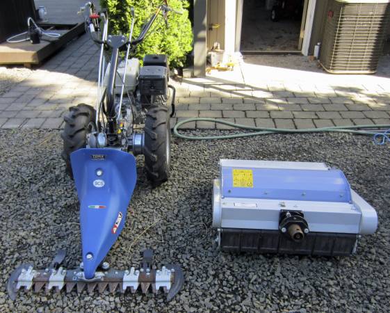

   / Flail mower for BCS 730? #15
Nice looking machine. You have the adapter you need to run the tiller and chipper from your 730. It's the 2 inch long extension between the sickle mower and the quick coupler.
Also, I don't like the setup your flail mower came with. You can buy an integral quick coupler from Earth Tools that will have an elongated hole to allow for side to side tilt. This will make the flail mower follow the lay of the ground better. It's an easy change out.
Thanks for the info.
Do you know which coupler that is, or do I need to ask Earth Tools?

Just ask for the components that make a Berta flail mower attachment from a bolt-on into an integral quick coupler. There will be a round hole on one side and an oval hole on the other side. Put the oval hole up so you get the side to side tilt. The round hole is for use with a rotary plow I don't think Joel even offers the flail mower without this attachment anymore.
