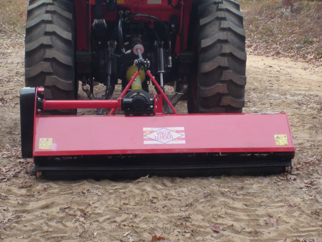

My new Chinese EFG175 medium duty fail mower will be delivered tomorrow. I really wanted the Caroni, but Agri Supply is out of stock until mid-January and I need it by the middle of this month. I would have preferred the EFGC175 heavy duty model, but they are out of those until January. It seems these two retailers order a fixed amount once per year and when they are out, they are out until the following calendar year. I always try and avoid sending my money to China, but our manufacturers and government have made this very difficult.
The mower comes standard with the 56 mower grass blades and I also ordered the 28 mulching hammers. Initially it will be used to mulch a huge amount of oak leaves that are beginning to fall on my current 4 acres and there will be some sticks mixed in also. Then it will be used to clean up overgrown shrubbery, which will probably require the hammer blades.
Would it be best to leave the grass blades attached for mulching leaves or change over to the hammers for this task before I start either of the two planned tasks?
Thanks.
