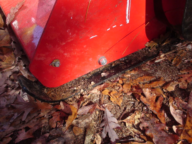

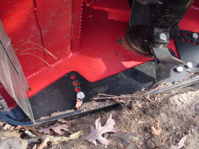

I tried it at the delivered height of about 1.5" and then I lowered the skids to their lowest position and moved the roller up, which probably gave me about 1/2" cut, to no avail. Also raised the 3PH a bit and the increased height did not help any.
I see no reason to try the heavier mulching blades just for leaves. I think as a regular grass and brush mower this will be fine, but this is not the main purpose I ordered it for. With as many trees as I have, grass is not a large issue.
Due to the length of my hydraulic top link, I am not able to angle the front of the mower up any at all and it sits at a slight down slant. Later this week I plan on replacing the top link with the stock, manual link as it looks like I may be able to adjust it longer and hope to be able to tilt the front of the mower up a bit. Will try another cut like this. And if this does not help mulch, I am out of things to try and will just have to spend the many hours on the garden tractor mulching leaves again this year.

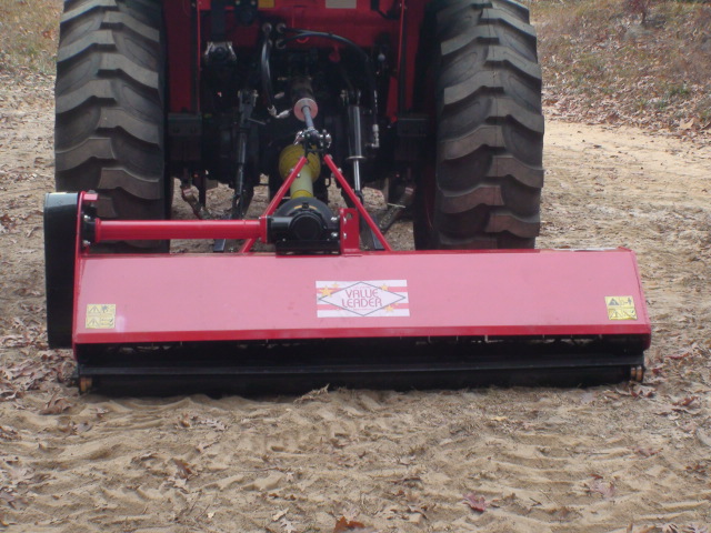

Could you possibly upload a few images of your flail mower???

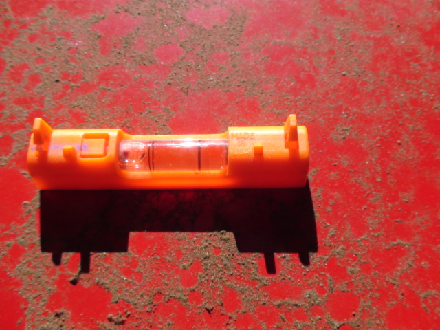

About your top link, you need to be sure your flail mower is LEVEL
from front to back.
If you have a small bubble level place it across
the top of the flail mower from front to back and
adjust it the top link in that manner.
The other issue is wet leaves a flail mower will not
work well trying to shred wet leaves when they
are soaked or still have a lot of moisture in them.

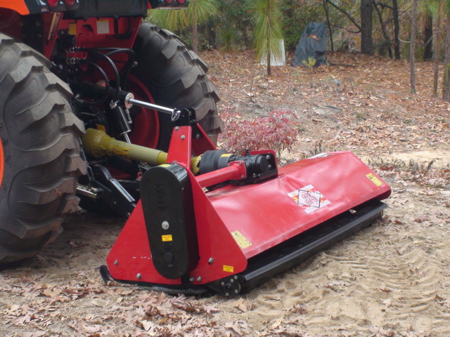

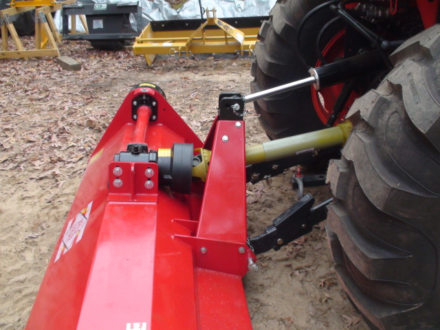

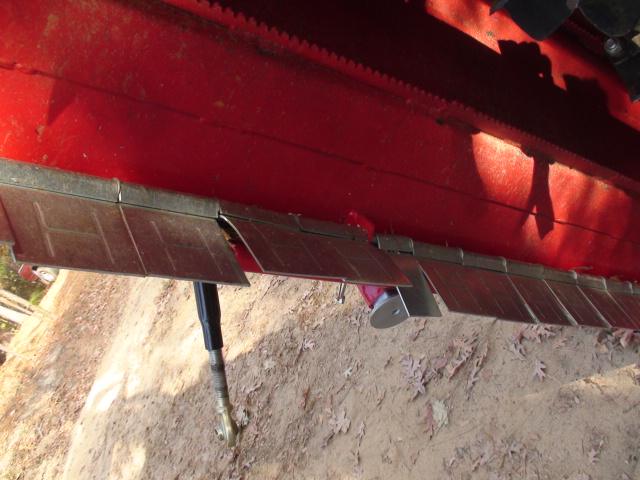

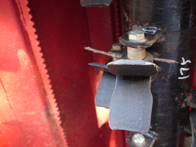

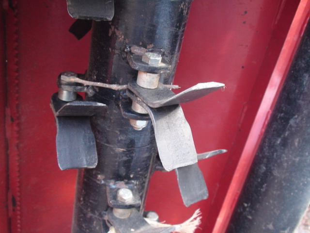

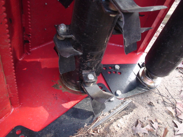

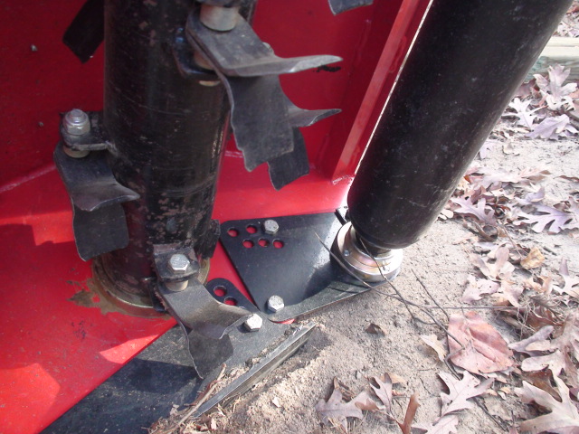

Uploading a few pics. Note the skids are pretty much flat on the ground (pic 294). You can't tell by the photo but the rear of the skid is elevated about 1/8". But the top surface of the unit is at a larger angle down indicated by the level.
I am going to either replace the top link with a longer manual one I have for a test or trying raising the front of the skids.
The leaves were very dry during the testing yesterday but are a little damp today from a bit of overnight rain. I will wait until tomorrow to test again.

I changed the top link to a longer one to make the top of the mower shroud level, although I am not sure that portion is designed to be level as the side skids were pretty level anyway. In the original configuration I posted, I was able to get the cutting height down to ~ 3/4" with the roller and the side skids at their lowest positions and the skids ~ flat on the ground.
When I lengthened the top link so the top surface of the mower was level, it raised the front of the skids 1 1/2" off the ground and the rear ~ 1/2" off the ground and was just sitting on the roller. This made the lowest cutting height ~ 1 3/4". So I think the level skids are probably a truer indication of the level point and the original setup was probably cutting fairly level. And when the top link is shortened and the skids are more flat on the ground and the blades lower to the ground, I can hear more noise within the mower housing of stuff being flung around, than I can when the top link is lengthened.
The leaves are not too thick yet, maybe 1/2" - 2" in height. I tried various skid height positions and changed the angle by moving the top link in each direction without any significant change in the leaf mulching pattern. At BEST, I can see maybe 25% at MOST are cut in some manner by the mower, but certainly not what I would call mulched. And not even close to the mulching my 46" Craftsman garden tractor has been providing for the last 15 years.
In my mind, the absolutely only thing left to try would be to swap out the grass blades for the brush blades. And I see no purpose in this. But maybe the full width of the brush blades can help create a vacuum. I really do not know. But do know I do not want to leave any stone unturned that could improve this matter, so will probably swap the blades this weekend. But first I need to properly do the first of 3 or 4 mulchings using the garden tractor before the leaves gets too thick.
Will post how the mulching blades turn out within a week or so. But I really think this mower is not designed to mulch leaves unless they are mixed in with grass or laying on top of grass.
