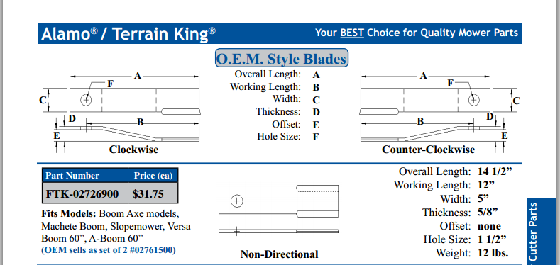

Looked on Flailmaster for a drawing that showed how to measure but didn't find one.
David Sent from my iPad using TractorByNet
I just found this on Flail-Master for what seems to be rotary mower blades.
Measuring with this as a guide, my blade is 4" long with a working length of 3.5" and width of 1 3/4". It is also 0.212 inches thick. So the overall measurements, including the metal thickness make it a nice blade dimensionally- if it were only heat treated. Mine are dinged up after very little usage- just leaf mulching testing.

For anyone needing to replace their blades and want to use the Flail-Master brand, I called Flail-master to get the proper way to measure the height/length of the blades. The height/length is measured as the hanging length. Meaning one measures from the top of the mounting hole to the bottom of the blade.

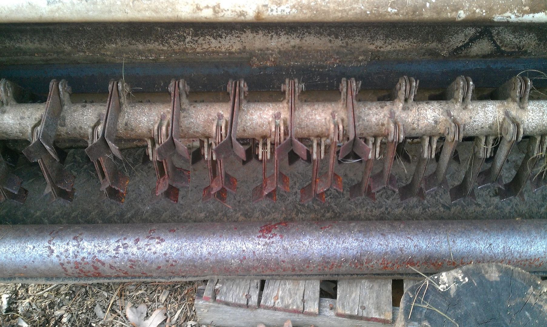

I've got four rows of slicers at 22 pair per row for a total of 88 pair that are spaced about as tightly as you can get them. I have a hard time understanding that it would be to a lack of coverage or too few knives.
I seen a lot of posts saying a flail should be able to mulch leaves but I don't recall any posts from anyone who uses it for that successfully.
Has anyone had success with usimg a flail to completely mulch leaves to the point you don't have to collect them? If so, pics or a description of your setup would be most appreciated. TIA.

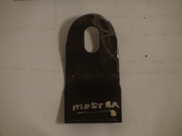

The blades I selected as replacements for the non heat treated factory blades came in this evening and I noticed the top portion of the blade had more height between the top of the mounting hole and the top of the blade assembly. I thought I had all of the measurements accounted for, but did not think about this one.
These blades from Flail-master seem like high quality blades, but they just will not work in my application. Using a 14" cutoff saw, I cut 1/4" off the top of one of the blades but still need to taper both sides at the newly cut top edge to allow the blades to swing properly. I do not think I want to put in this much work on 60 blades to make them work.
They would have worked well had the new blade not have the extra material at the top.
And if these blades are any indication of Flail-Master's other products, I think they would be a good place to purchase parts from.

I have had some time to think about this mower situation and it will not live up to its potential with the OEM blades that came with mine. I spent a bit of time on a 2nd blade today using two cuts with a 14" cut off and a bench grinder. The end result is a perfectly shaped, hopefully high quality, grass blade that should hold its edge and be resharpenable.
This is what I was expecting when I ordered the new blades. It should take me about 30 minutes per blade to reshape, including a few dunks in a bucket of cool water so the edge temper is not lost- hopefully. This will be a winter project.
