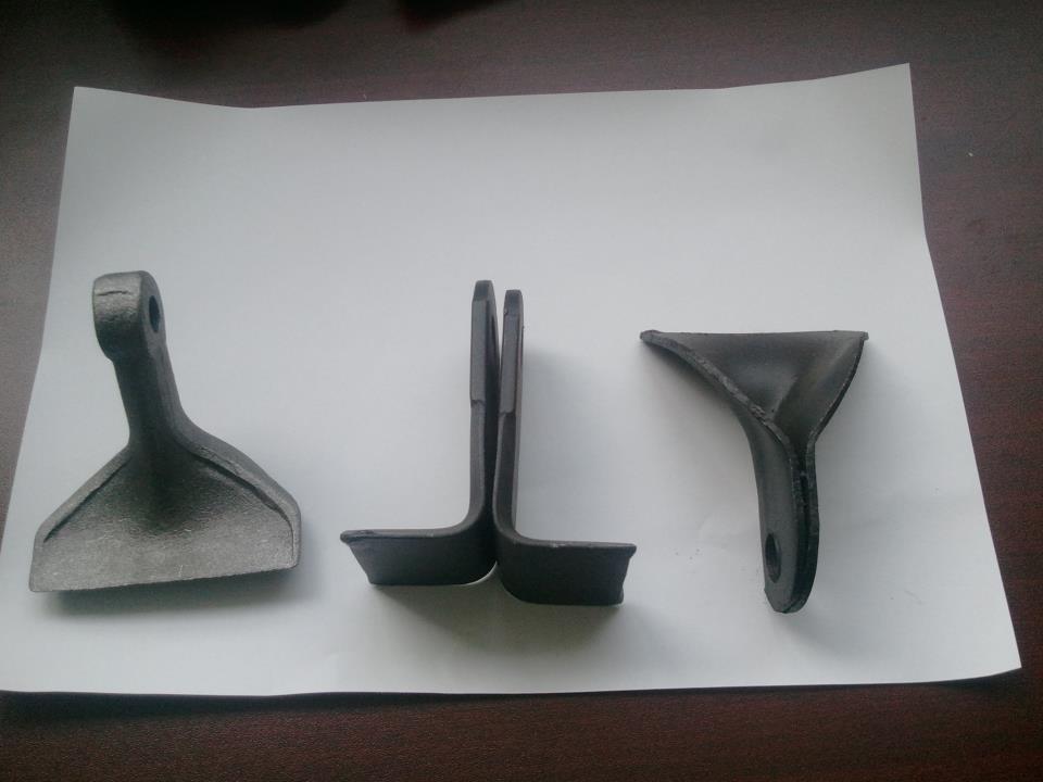

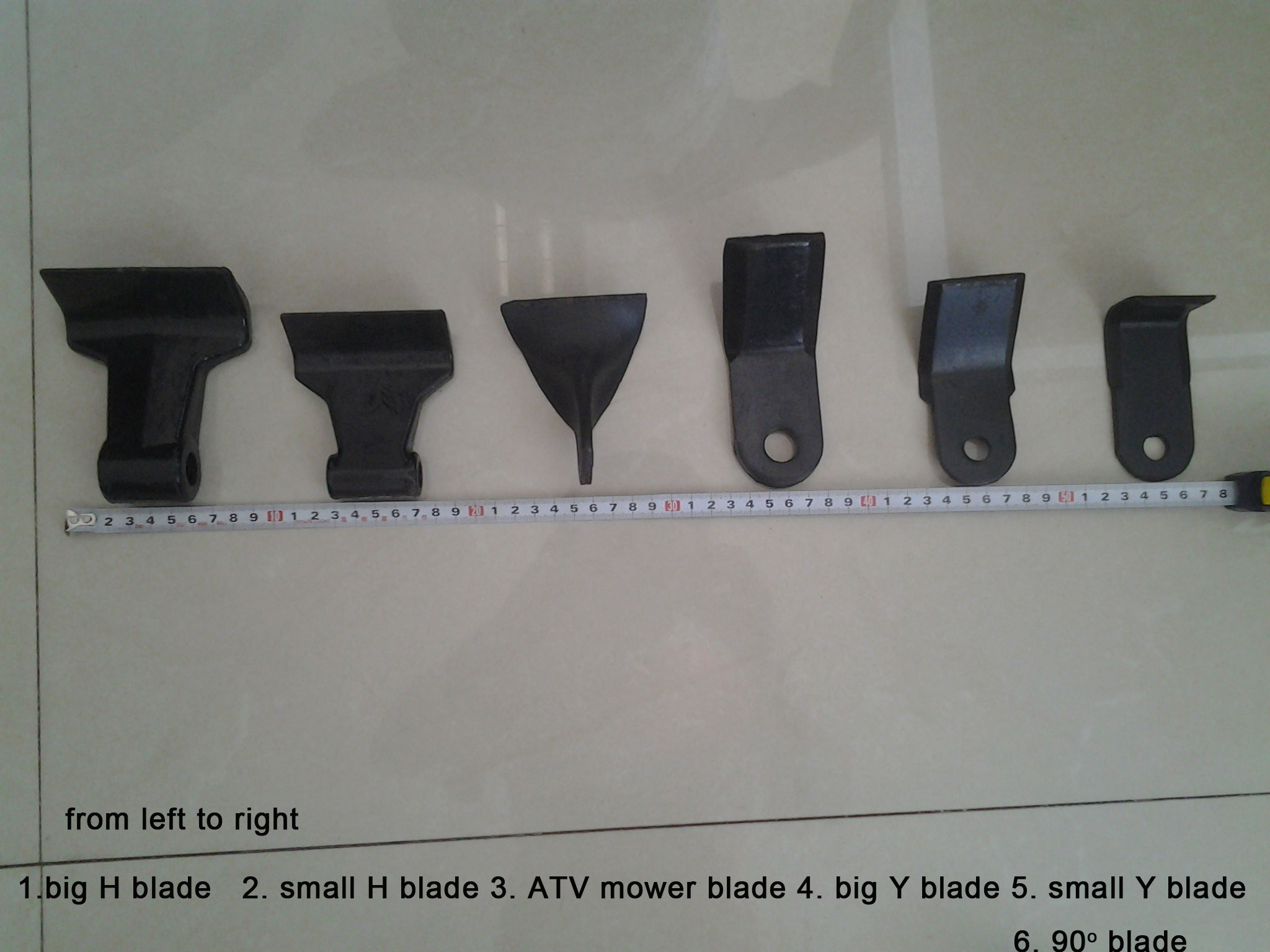

generally, different blade can make very big different effect.
View attachment 347141View attachment 347142
for example, the second blade in the first photo, it is small H blade, and the first blade in the second photo, it is also small blade. BUT, because of different material, the second one's price is double as the first. After testing and compare with both of them, the second blade is much better than the first one.
BUT, till now, now customer would like to buy the second blade, because of its price.
By the way, you can find your blade in the first photo.
Thanks for the pics. I believe the 2nd blade in the first photo is the hammer blades I purchased optionally as they were what Betsco was selling and I had no experience... I have not tried them yet as I see no reason it will mulch leaves any better. But I guess I should go ahead and replace them as the current Y blades do nothing to leaves. May change them out tomorrow morning.

I think till now, the only way for you to get these blade is directly buying from my factory in Chinese. Because of its expensive price, none of my customer buy this model blade till now.
Here are photo which I took when we test this blade, you can see, it have a much sharper blade than the H blade which you are using now.
Thanks Jack
That H in second pic looks interesting. Wonder where I can get to fit my EFGC 175. Never seen the 90 before.
David Sent from my iPad using TractorByNet

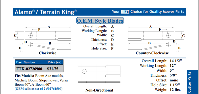

I just found this on Flail-Master for what seems to be rotary mower blades.
Measuring with this as a guide, my blade is 4" long with a working length of 3.5" and width of 1 3/4". It is also 0.212 inches thick. So the overall measurements, including the metal thickness make it a nice blade dimensionally- if it were only heat treated. Mine are dinged up after very little usage- just leaf mulching testing.

For anyone needing to replace their blades and want to use the Flail-Master brand, I called Flail-master to get the proper way to measure the height/length of the blades. The height/length is measured as the hanging length. Meaning one measures from the top of the mounting hole to the bottom of the blade.

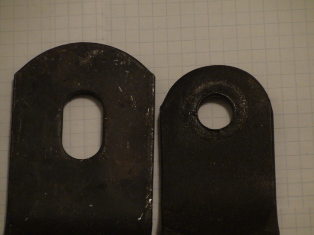

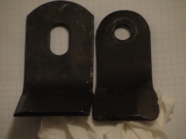

The blades I selected as replacements for the non heat treated factory blades came in this evening and I noticed the top portion of the blade had more height between the top of the mounting hole and the top of the blade assembly. I thought I had all of the measurements accounted for, but did not think about this one.
These blades from Flail-master seem like high quality blades, but they just will not work in my application. Using a 14" cutoff saw, I cut 1/4" off the top of one of the blades but still need to taper both sides at the newly cut top edge to allow the blades to swing properly. I do not think I want to put in this much work on 60 blades to make them work.
I should have just ordered a pair of blades of the two types I thought would work to make sure all was well before ordering a complete set with no trials. But I am in a bind for time and needed to get the OEM blades replaced with a quality blade set, as I am moving all of my tractor equipment 40 miles away to my retirement property for clearing it.
I do not want to put anymore money or time into this mower as I have other projects to complete before I can move the equipment. So I guess I will just leave the OEM blades on for now and think about this situation for awhile.
/ Flail Mower usage questions
#58
They would have worked well had the new blade not have the extra material at the top.
And if these blades are any indication of Flail-Master's other products, I think they would be a good place to purchase parts from.

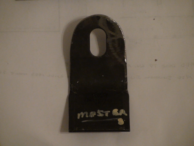

#59
I have had some time to think about this mower situation and it will not live up to its potential with the OEM blades that came with mine. I spent a bit of time on a 2nd blade today using two cuts with a 14" cut off and a bench grinder. The end result is a perfectly shaped, hopefully high quality, grass blade that should hold its edge and be resharpenable.
This is what I was expecting when I ordered the new blades. It should take me about 30 minutes per blade to reshape, including a few dunks in a bucket of cool water so the edge temper is not lost- hopefully. This will be a winter project.
