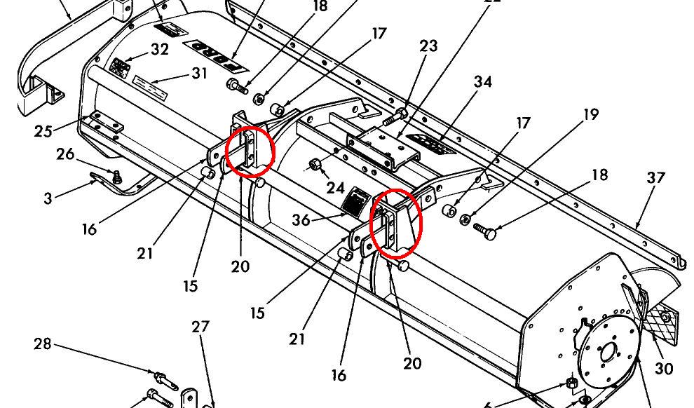

Here is my question...If I buy this 6o inch cut Ford 917 H Flail mower will my NH TC - 29 be powerful enough to pull it and cut 3 ft. tall grass and brush...My bush hog will..I just have no experience with a flail...Anyone with a flail have an opinion ? Thanks
