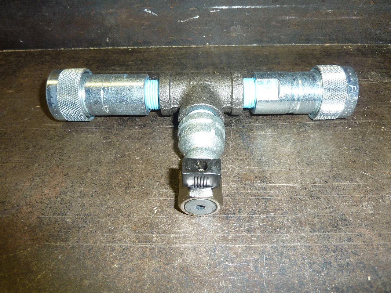

It appears that everyone who is familiar with FF couplers has a different opinion of their performance.
In my case, I switched from FF to Pioneer Ag type. I use female couplers on my tractors and males on my implements. Yes, they leak some oil but not much more than the FF's when you have to crack the fitting to relieve the pressure.
I have no problems with pressure binding on the tractor side since for me, it is easily relieved by working the joystick and 3rd function switch with the engine off. I do however have the problem with every hydraulic implement I own. On one, it's easy to relieve the pressure by tapping the ball end of the male coulper on a hard surface. On implements with larger hyd. cylinders, this trick needs to be done repeatedly and loses quite a bit of oil. For those, I use this simple manifold with bleeder valve:
A cheaper solution is to use male Ag couplers with no ball check valve. Keep a supply of zip top sandwich bags around and hold one under the coupler when you disconnect it to catch the leaking oil. Then hold the bag in place around the coupler end with a rubber band.

I have mine with both male and female on the attachment and tractor so I never worry about crossing up the hoses. The issues I have are either ice induced, or from pressure in the system with nowhere to go.
Something that has been in the back of my mind is to put a "tee" in the line at the fitting with a pipe plug in the end instead of using my right-angle fittings to make the corner. Then if you're fighting a high pressure situation you just need to back off the plug.
