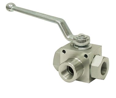

I'm probably going to install one of these to relieve pressure on the line so I don't have to always crack the line open - not very good for that connection really. These are good to 5000+ PSI and are only $40 at Surplus Center.
I've heard of others here on TBN doing such a thing.
