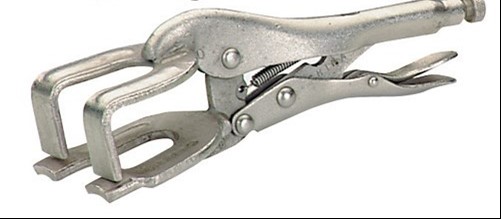

Yes, I don't know why it's true, but it is. I can't say it is a "feature" of FF couplers because I have had occasional residual pressure in ag style as well but the FF are certainly very consistent in this regard. As I said, relieving the pressure in the ag style is very easy, a tap on the end of the male, and a dowel in the female and a tap and the pressure is gone. No such possibility with the FF, but the pressure is slight and can be overcome with a mechanical advantage, just not with my apparently puny hands/arms. I'm thinking a Vice Grip pliers sort of like this, sized to fit over both couplers and then squeeze might do the trick.

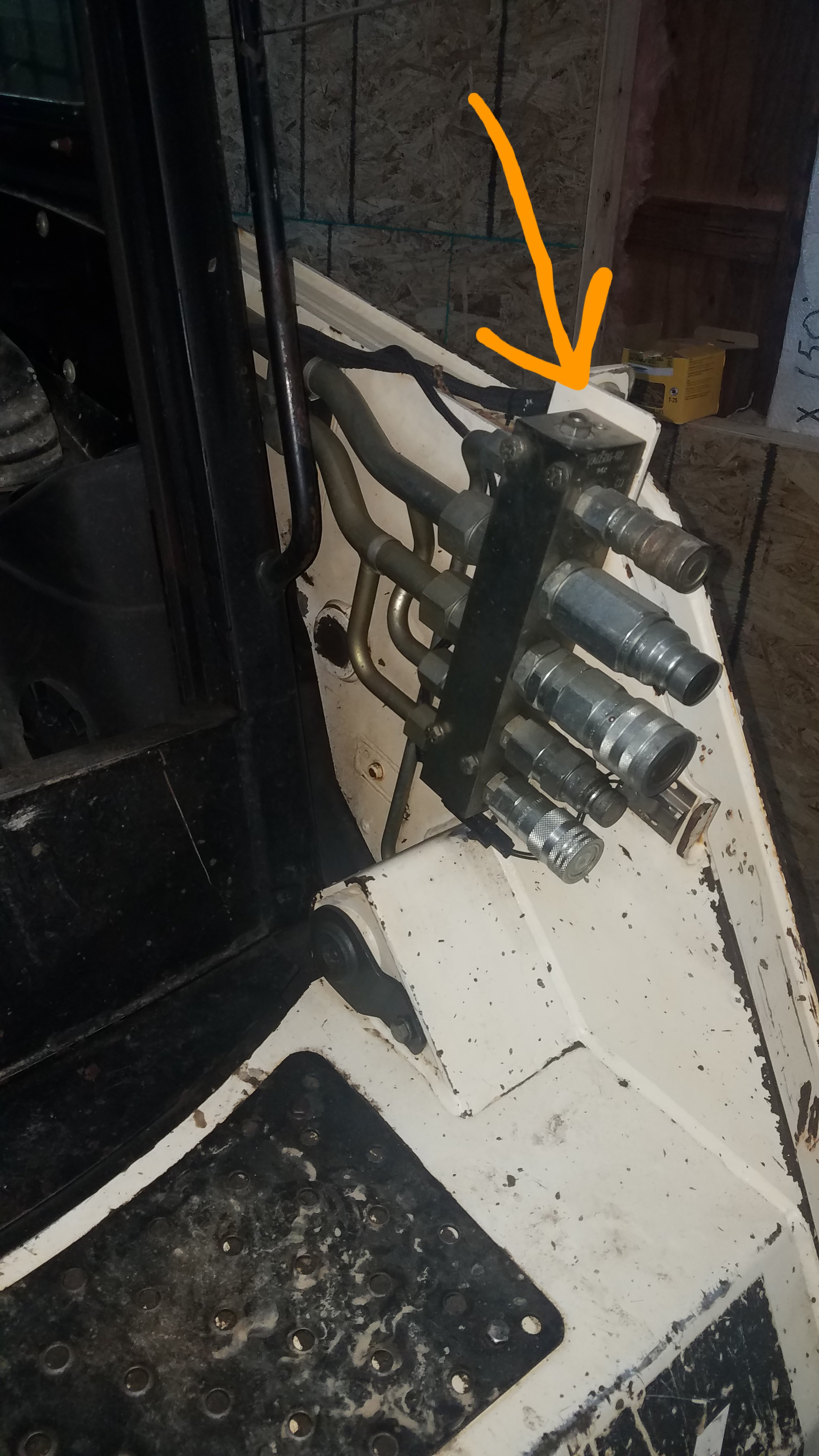

I have FF couplers on my Terex/ASV track machine. I don't have any problems with the connections and I prefer them to the ball Ag style couplers. Like others have already mentioned, I find them much easier to clean and they do seem to leak less fluid.
On that machine, I have a button on top of the hydraulic block that relieves pressure from the couplers. (See pic) It works fantastic and quickly relieves pressure on the machine side of the connection. The only time I have any issues is if there is still pressure in the line on the IMPLEMENT side of the connection. In that case, a few attempts to make the connection will usually bleed enough fluid out of the hoses on the implement side to ease up on the pressure and I can make the connection.
On my tractor, I have the ball Ag style connectors on my rear remotes. I don't mind them, but I wish there was a relief button because it is annoying to have to turn off my machine to relieve the pressure. My tractor also has the flat tappet style Ag connections, which are used on the quick disconnects for the loader circuits. I don't really like these as I find that they occasionally (rarely, but has happened) unseat themselves. I think they are there too limit the flow rate to keep the loader from moving too quickly. I have had thoughts about replacing them and experimenting with a faster connector, but haven't gotten around to it.
To the OP... I'm wondering if your problem doesn't have anything to do with the connections on the tractor side, but instead has to do with the pressure staying in the lines on the implement side of your setup. Maybe it would help if you try to relieve the pressure on that side of things first. Maybe get yourself a spare male and female connector that you can keep unattached to anyting, but that you can insert into the circuits which are under pressure, and let it flow out of the open-end to relieve that pressure....?
