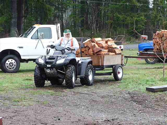

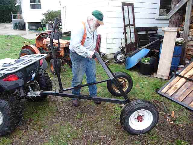

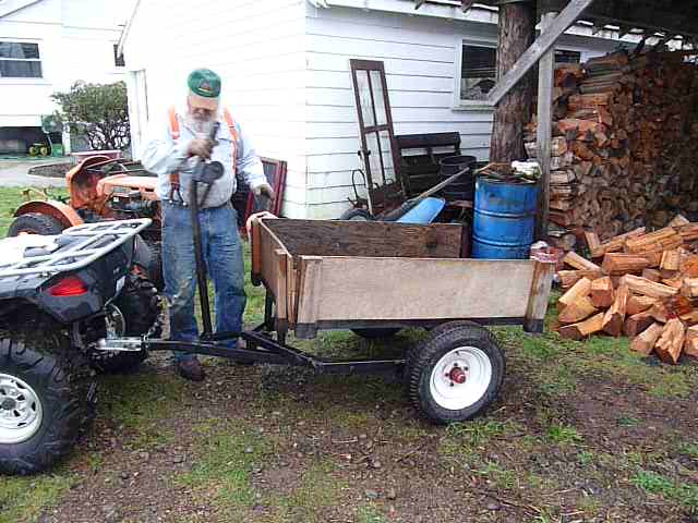

I built a trailer for my quad last winter. It has a dual purpose as it can be used as a flatbed and also as an arch for pulling atv size logs.
The winch for pulling logs also doubles as it will dump the trailer easily, or pull something into the trailer with the bed on.
At the base of the winch tower I have a chain that is adjustable so I can lean the tower somewhat as needed.
Will try to put some pics up. I am building some for folks in the area.
