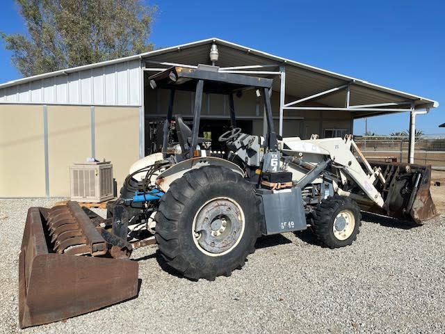

Being a Ca boy myself, you and I were raised around skiploaders primarily used for finish grading. I cut my teeth on a Ford 445D. My first tractor was a MF 30B. Followed by a Terex 640 and now the Kubota MX5200. All with a 3 function gannon. The 3 function gannon is the most versatile earth moving attachment with or without down pressure. The box scraper or gannon as we call them on the Terex machine had 1/2" thich sides it weighed in at 1000 pounds ... talk about down pressure - lol
