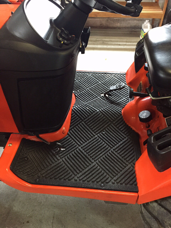

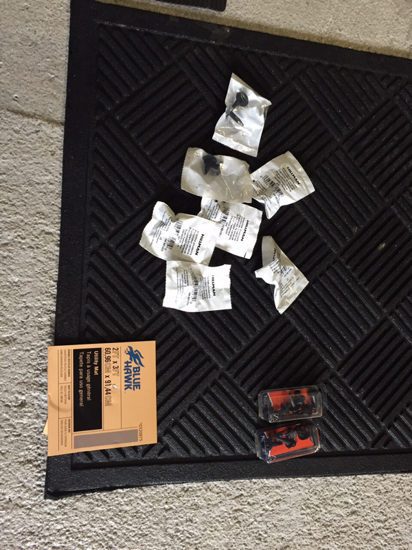

I used ribbed black vinyl found at Lowes in the flooring department. It is used for runners. I purchased plastic trim fasteners at an auto parts store. I made a paper template and used a utility knife to cut the vinyl. The whole thing cost me about $15 and works great. Sure beats the $97 Kubota wanted!:cool2:

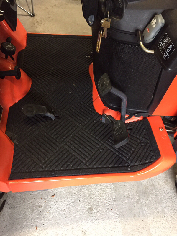

I also used a stall mat from TSC with great results IMO. I fastened them down, but you could certainly use just the mat as it is heavy enough to stay in place and remove when desired. Here is a link to the thread that has some pics.
I also added a piece to the center hump for additional coverage. That piece is attached with heavy duty velcro as I did not want to drill into the metal. http://www.tractorbynet.com/forums/kubota-owning-operating/337995-l3901-deck-mats.html?highlight=
The whole set up has worked extremely well for me and it provides a no-slip surface that is easily cleaned.
