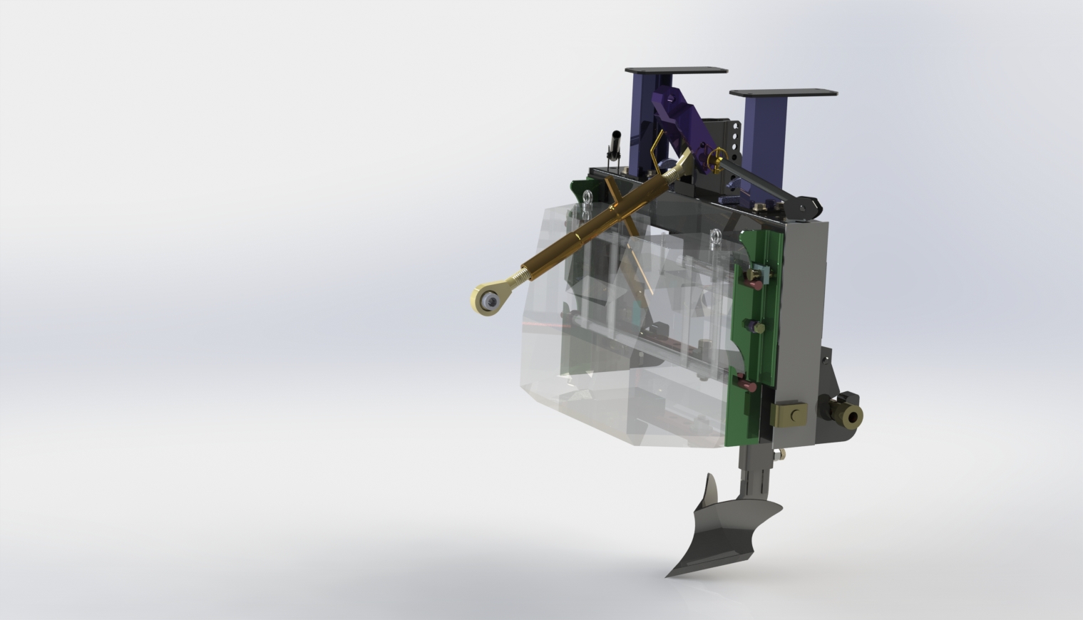

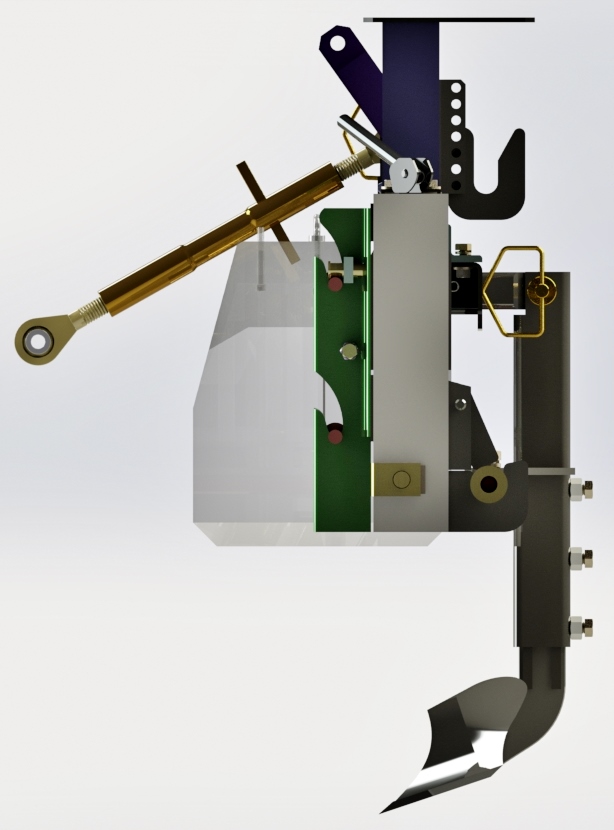

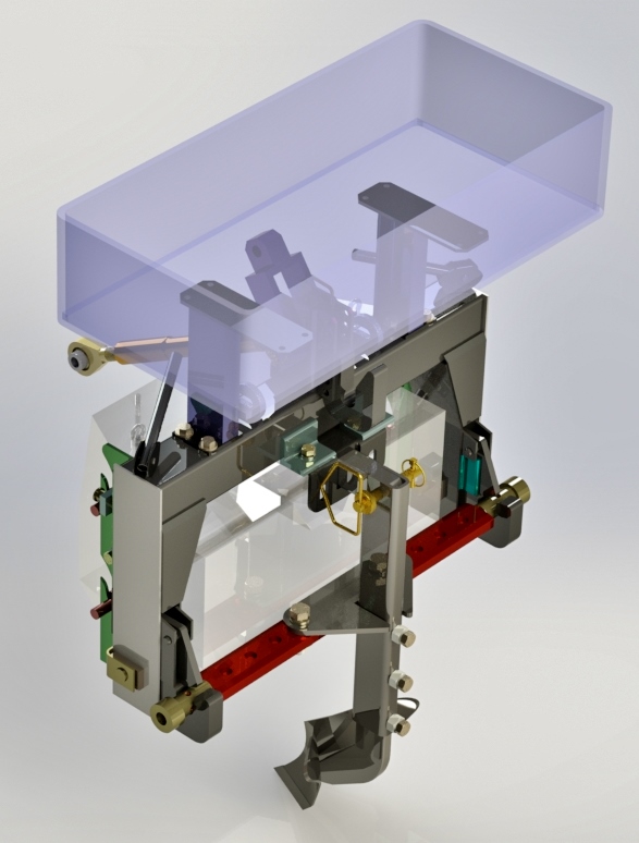

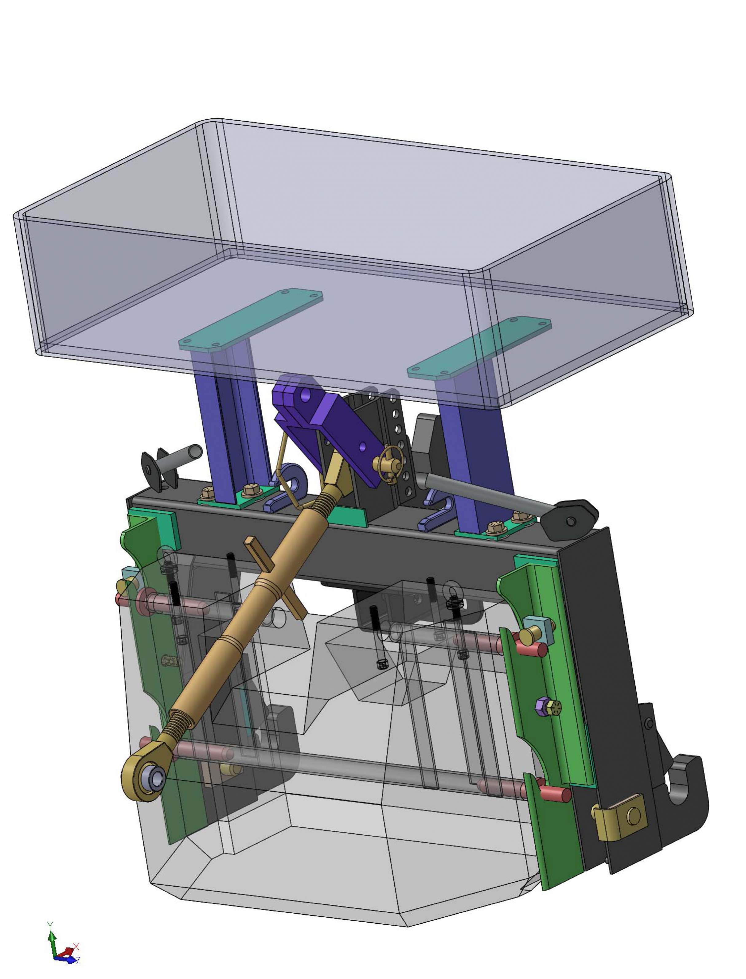

Re: Fluid or Weights??? My Solution
QA Weight on a highly modified Quick Hitch that allows 3 Pt use with weight still attached. Weight needs to be removed to use PTO.
