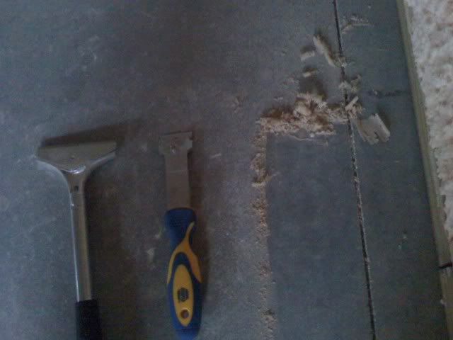

NO he hasnt done any scraping. He tried buffing it off but stopped instantly when he saw it was only burning it into the cement. The pic in post 15 is about 3' square, there's a lot of drops. When I get time, I might try sealing a spot we have scraped the best we can just to see if it will accept the sealer.

The overspray must be removed by scraping first. If you don't it will cause uneven sanding and you will go through hundreds of screnes. You can purchase floor scrapers from paint or construction supply stores.

Here is after a wide razor blade and a small blade. This stuff is quite the mess to scrape but I'll get it. Hopefully
