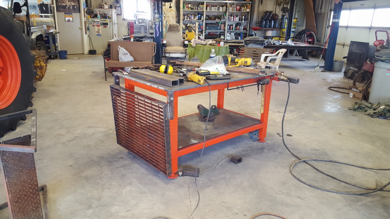

Hey guys, I'm stumped. Adding a cutting top to a welding table. It hinges so it can be folded down out of the way. Looking for ideas to latch it in the up position. Don't want to use wrenches. What do ya think??? Thanks in advance for any ideas. :)

Two triangles, hinged at the two nearest legs.

How about a piece of flat bar on each side. That goes from the square tube legs on the table, to the grate, at a 45-degree angle? Could use pins, and hair pin clips to hold the pins in place.

That was my original thought. Then I advanced to hinging the flat bar in the middle with a stopper so if couldn't fall below straight. Then just lift up on the bars to start them hinging and they would end up folded up between the legs and the top???

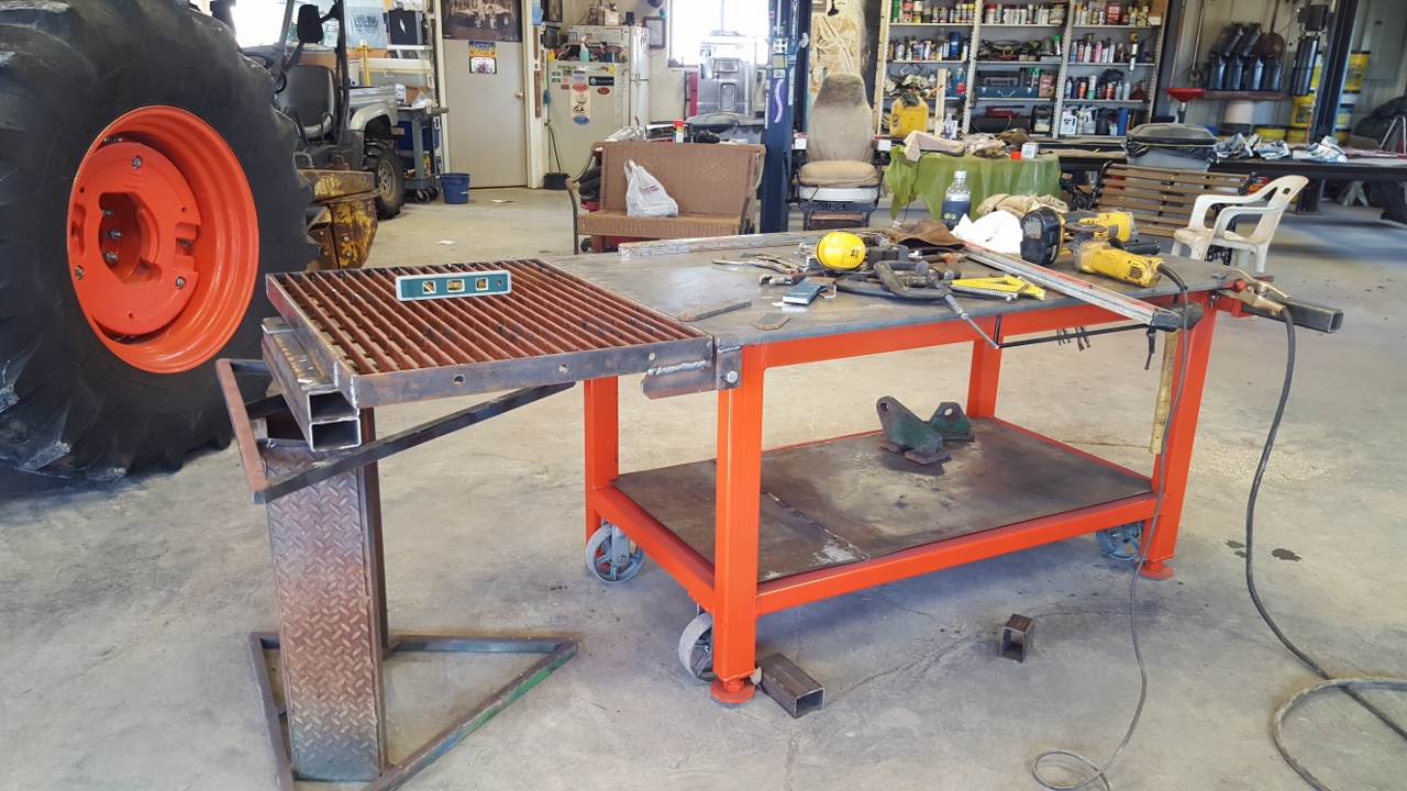

Very simple. Want it to be able to be strong enough that I could stand on it. Hmmmmmm...... I've got some rod that's probably 1/2" or maybe 5/8". If I trussed the triangle they'd be pretty strong wouldn't they??

On the table legs you could drill and tap thread. Use a bolt to hold the flat bar in place. When not using the burning table the flat bar could hang down out of the way.

Yes, I can see that. I gotta go under the cutting table and add some bracketry since the table outter edge is outside the table legs by about 3" on each side.
Oh I didn't see that in your pictures. You could weld a piece of pipe onto the flat bar to make up the 3-inches.

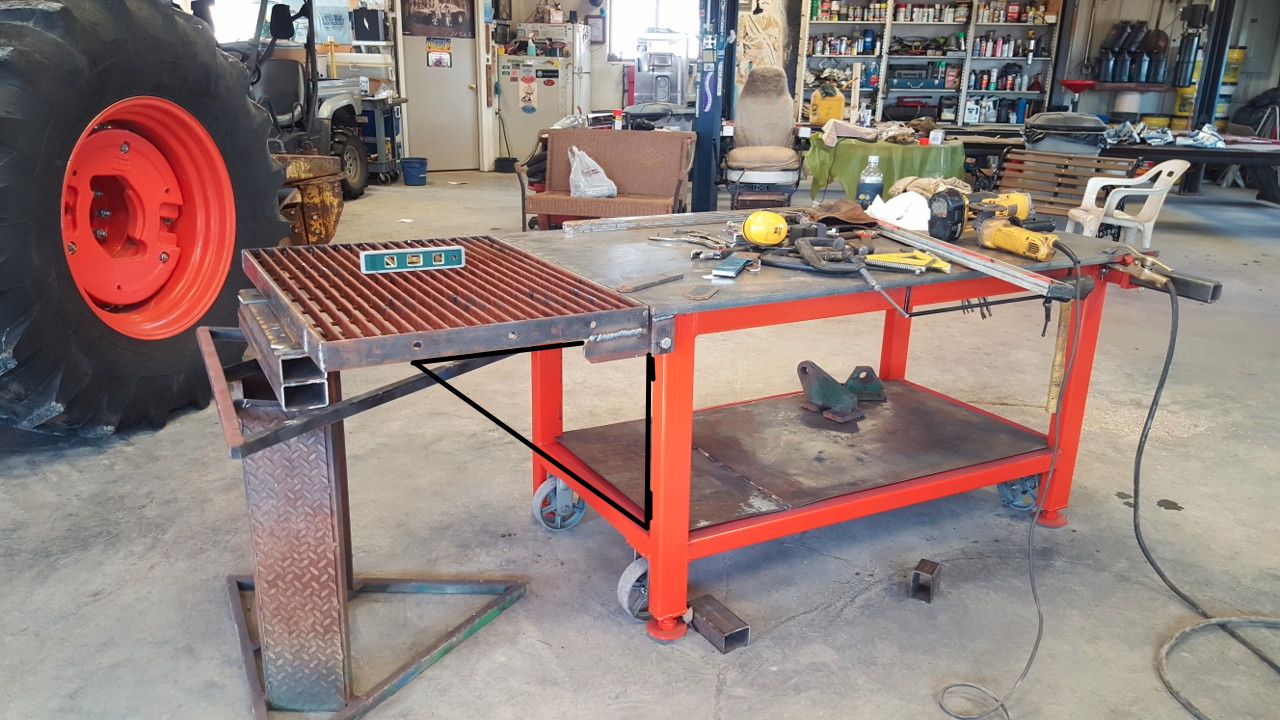

Maybe weld a couple of receivers on the underside of table and pull out a pair of horizontal supports for the extension? Maybe with a pull rope?

Yep. I can do whatever to make up that difference. I'm beginning to like your idea. I could bolt the flat bars to the top loosely so they'd swing. Add a pin sticking out of the leg for the braces to fasten to when up. Unfasten the brace on each side from the leg. Swing the top down. Have a J hangar on the horizontal lower beam of the table for the brace on each side to hang on while the top is down. Sorry for the poor description. That way my braces would always be with the table. All I'd hafta keep track of would be the linch pins used to fasten the top up.

Terry, I was just now drinking a Beer and looking this over. That came to my mind. A slider on each side. Raise the top, slide out one side at a time to hold it in place. When folded the sliders would be retracted out of the way.

Sliders would work best. Get or make some c-channel and the bar stays stored on the sides (orange part) and will be strong when applied.

If you DO go the slider route they would need to be 'shielded ' so that slag and dross don't inhibit the sliding.

I would do the folding angle braces mentioned earlier. Like those fold up tables use, that concept. No pins to pull, just lift up on the top, bump the braces in the middle, and lower the top... no tools, quick, strong. And less if not no slag issues.
